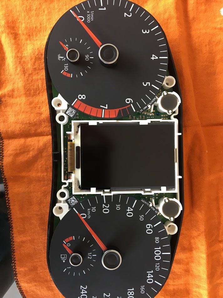

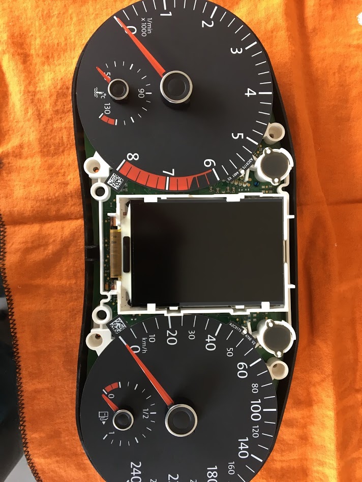

Re: ciclo's Polo. R-line 1.2 TSI 90hp 119gr.
EEPROM on the most MFA+ clusters:
Remove security clip on the bottom of the screen where the flat cable connects to the PCB
Remove all the needles (pull up)
Unclip the white plastic retention hooks at the back of the PCB
Then you'll find the EEPROM chip
Put the EEPROM clip on the chip and read with the CH341a.
If you do this, it would be interesting to have some pictures maybe?

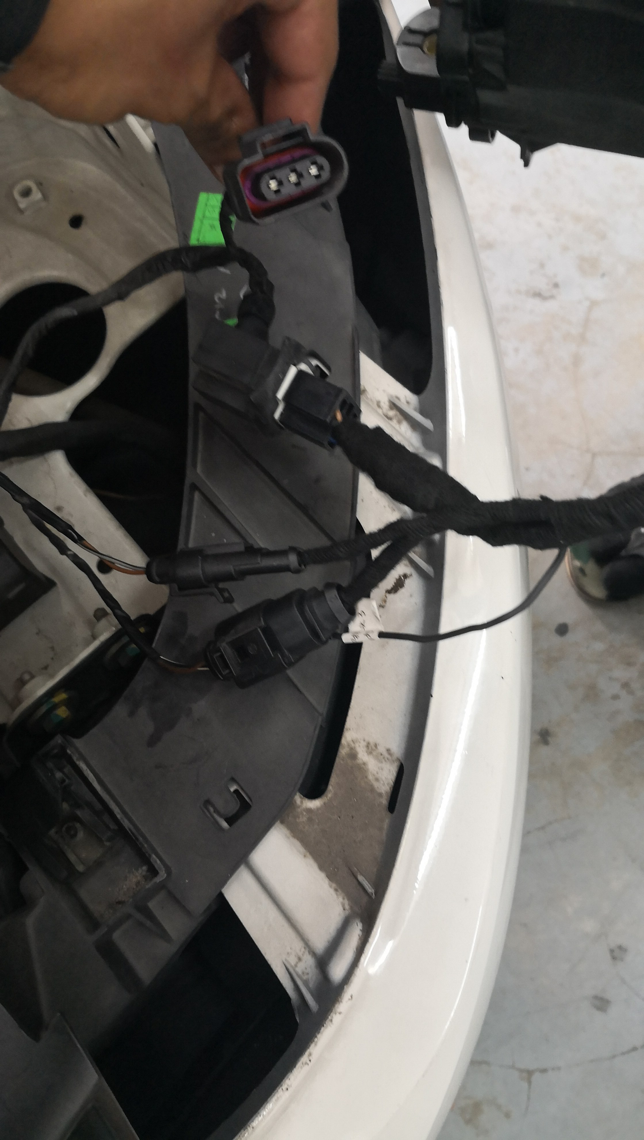

don kechick wrote:Hi.. i'm having a problem with my DRL lights, just purchased POLO GTi Headlights for my POLO SEDAN (2014) but after the installation the DRL lights its not light up. please help me out.. thanks..
You will need to share more information so that all of us here can help you better. The GTi headlights and the polo sedan (Malaysia made) really don’t go together well with the existing wiring and setup.
don kechick
Joined: Fri Mar 30, 2018 11:44 am
Drives: Polo Sedan
Location: Malaysia
Post by don kechick »
Hi ciclo
I bought a wiring harness from china due to different adaptor for the gti headlights, so after the installation only the bulbs are lit on except the DRL & HIGHBEAM.
What should i do to make it work, can i directly connect to the battery but i don't know which cable.
Please help. Thank you..
