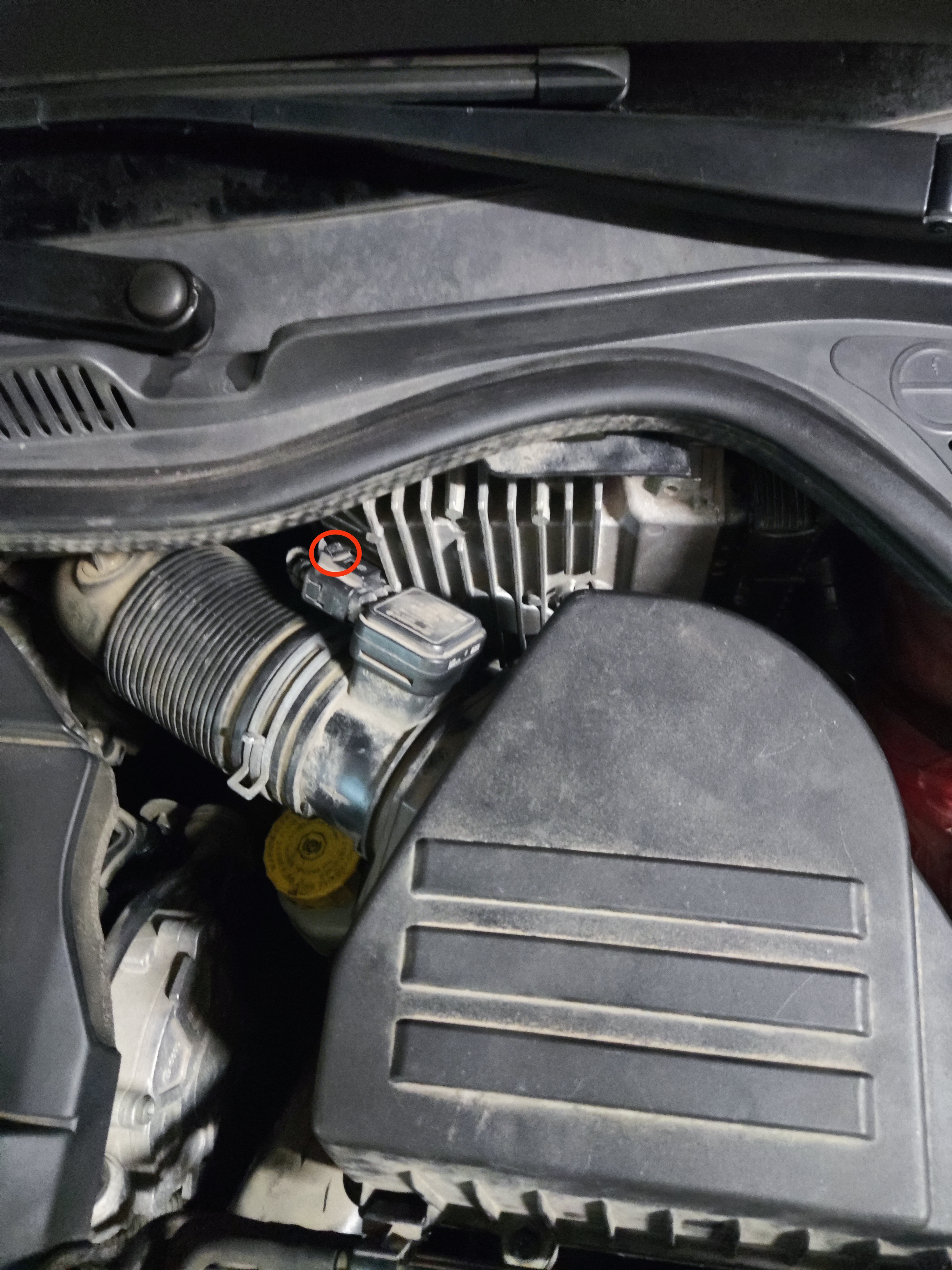

Hello everyone, first of all thank you very much because without this forum I would have been unable to install the cruise control on my Volkswagen polo 6R 1.6 tdi 90cv. The truth has cost me a lot of work and although I have managed to get it to work if I do a scan with VAGCOM I get errors that I did not have before, they appeared after verifying the connection of the ECU cable that the first time I had not gotten it right at all, I also had a bit of a bend in the tab on the air filter connector, although I don't think that's the problem. I am worried if these failures cause any problem in the car, the car works perfectly and the dashboard does not show any error while driving, the air conditioning also works well. I need your help. Thank you.
I attached a photo of the tab that was bent but I think it works well

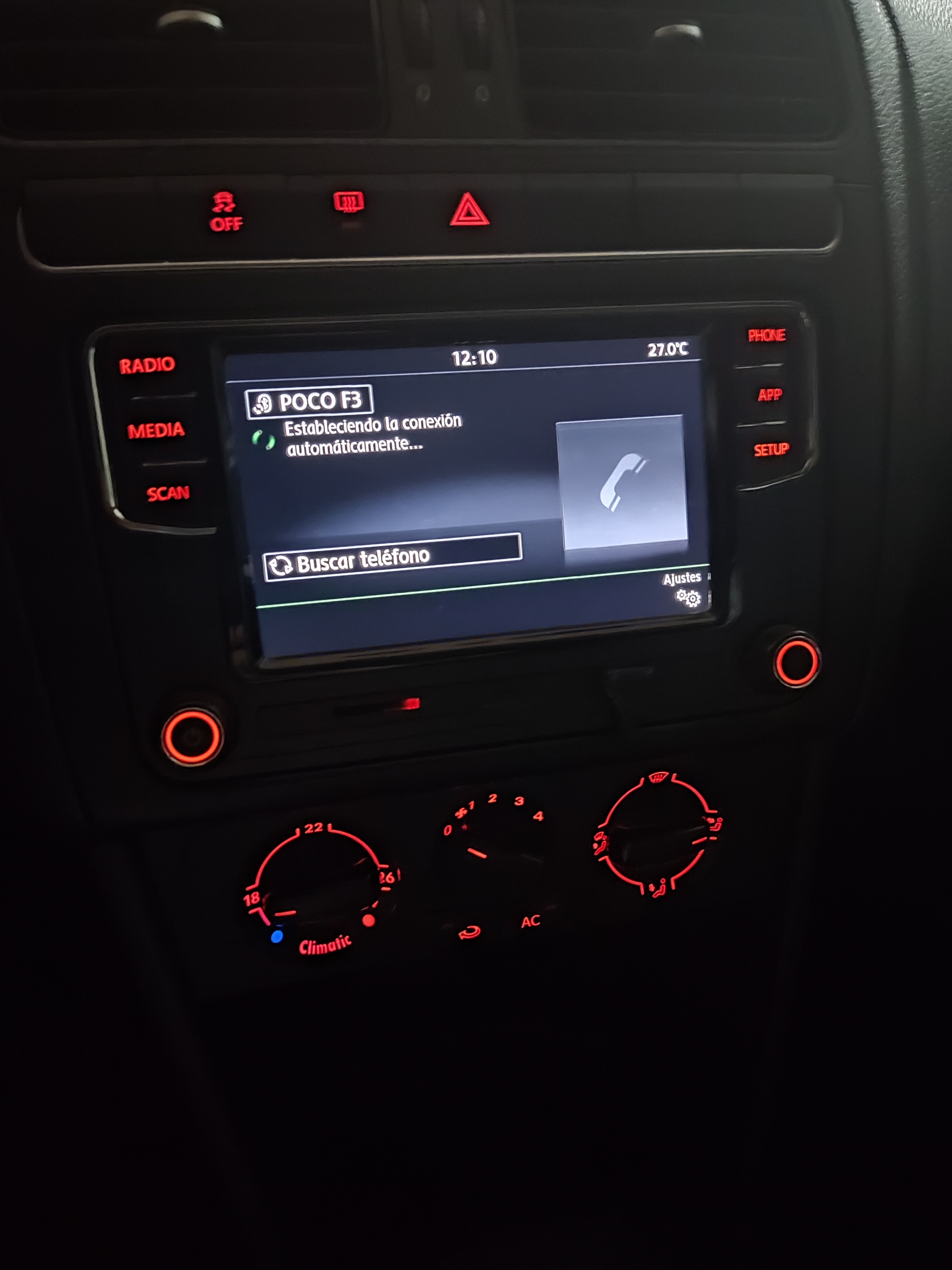

Button lighting works fine:

by ciclo
Ritxi wrote: Thu Sep 01, 2022 10:07 am
One question, if I connect T73a/44 directly to the SB11 fuse, would it still solve it? I would work more comfortably with this repair, the only problem is that the cable that comes from E102 would be left unconnected and I don't know if that would cause any failure.
Click :arrow: Stop inventing! :lol:
The contact terminal of the wire that reaches T73a/44 must be inserted in T73a/44 in a mandatory way.
It is an MQS contact terminal.
You can easily fix it:
