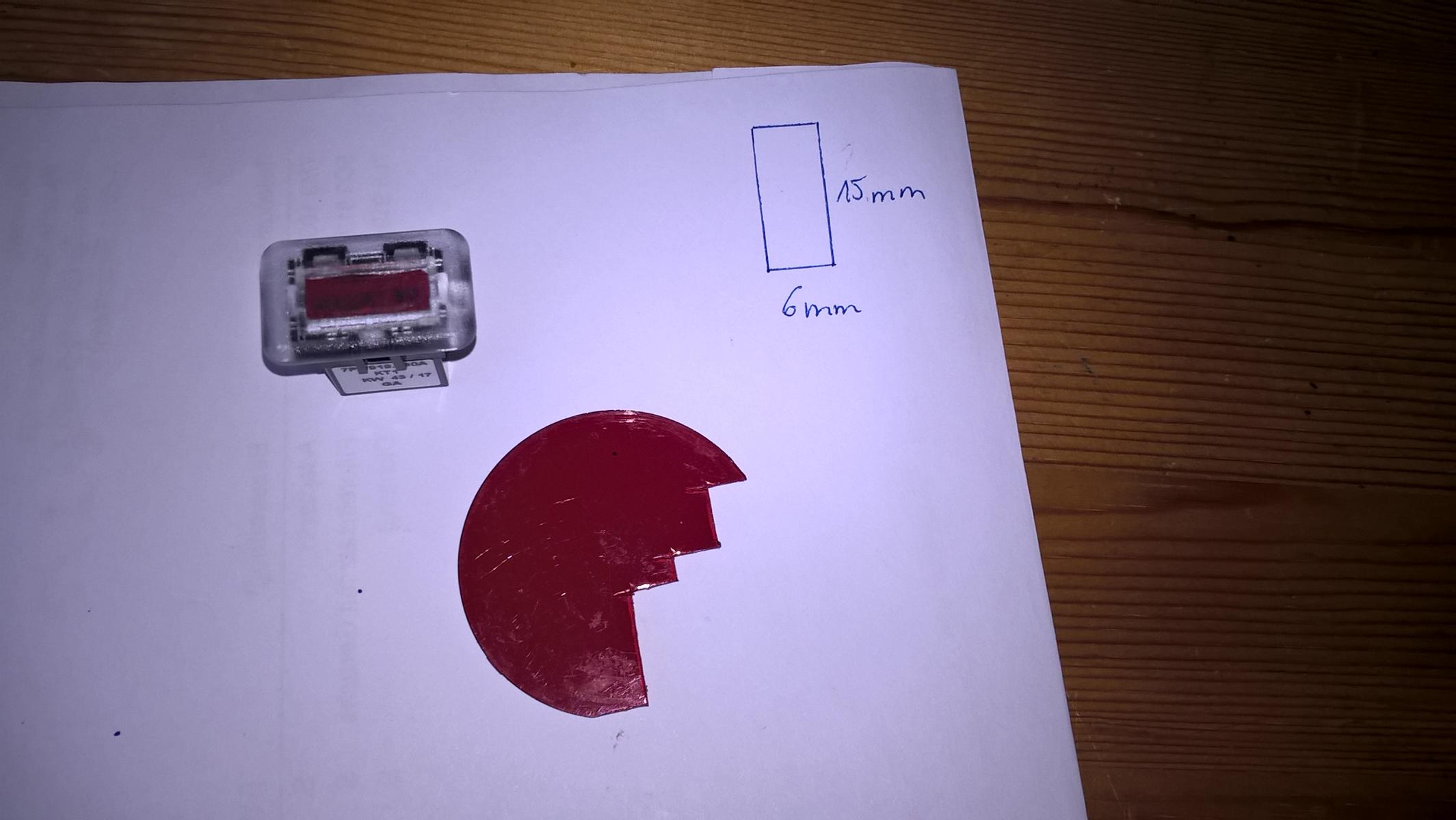

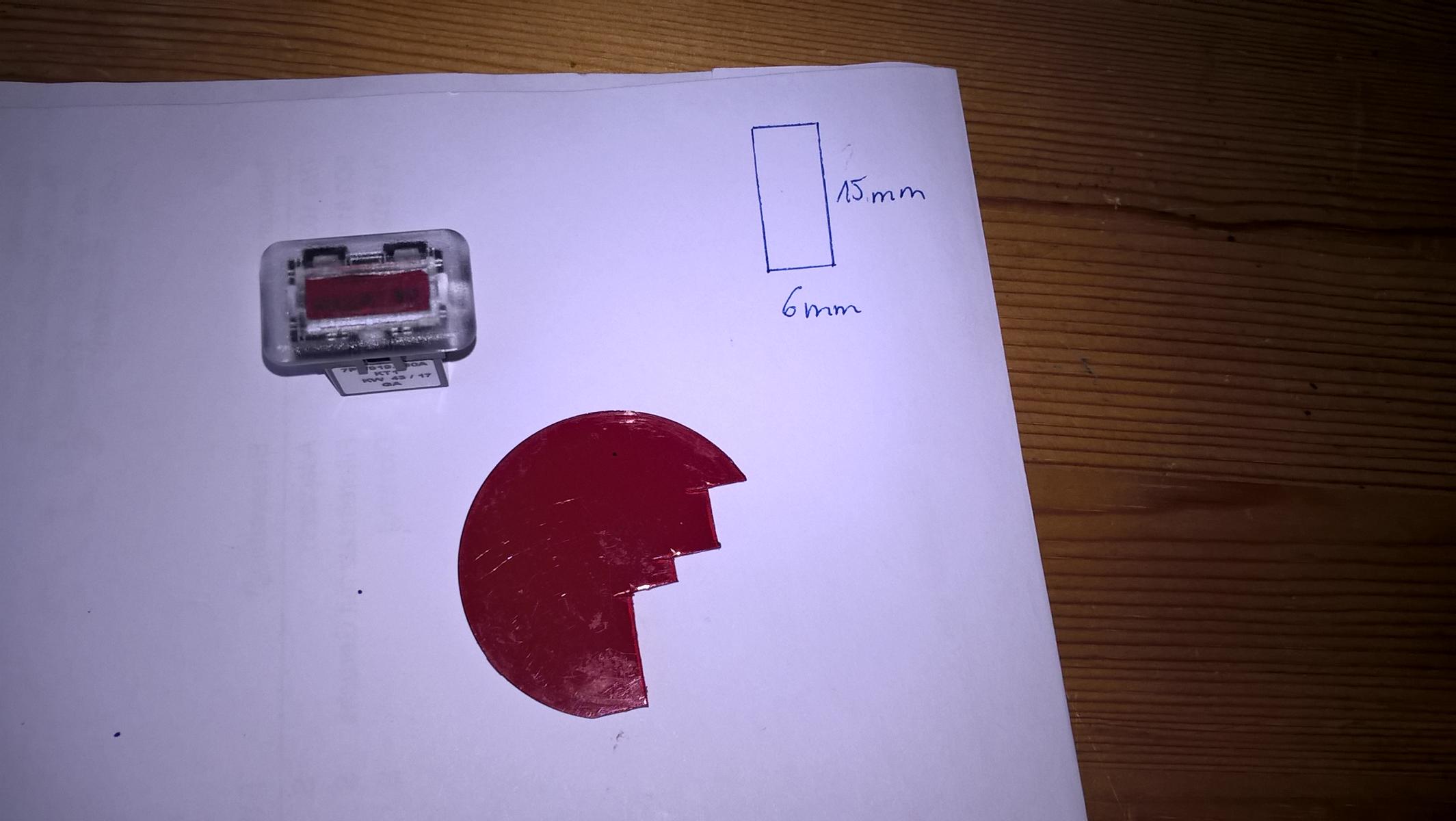

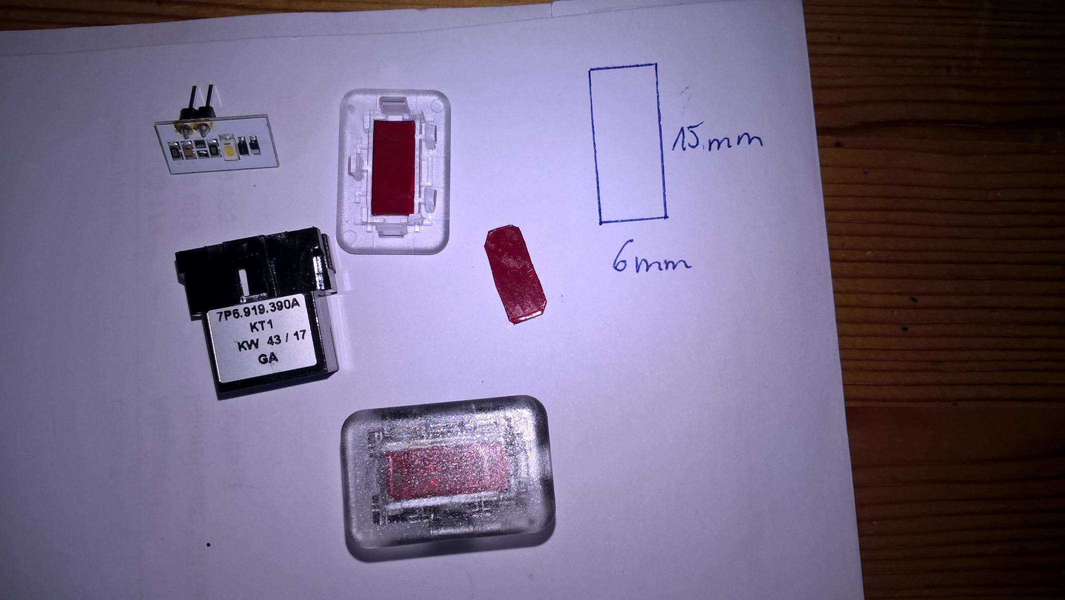

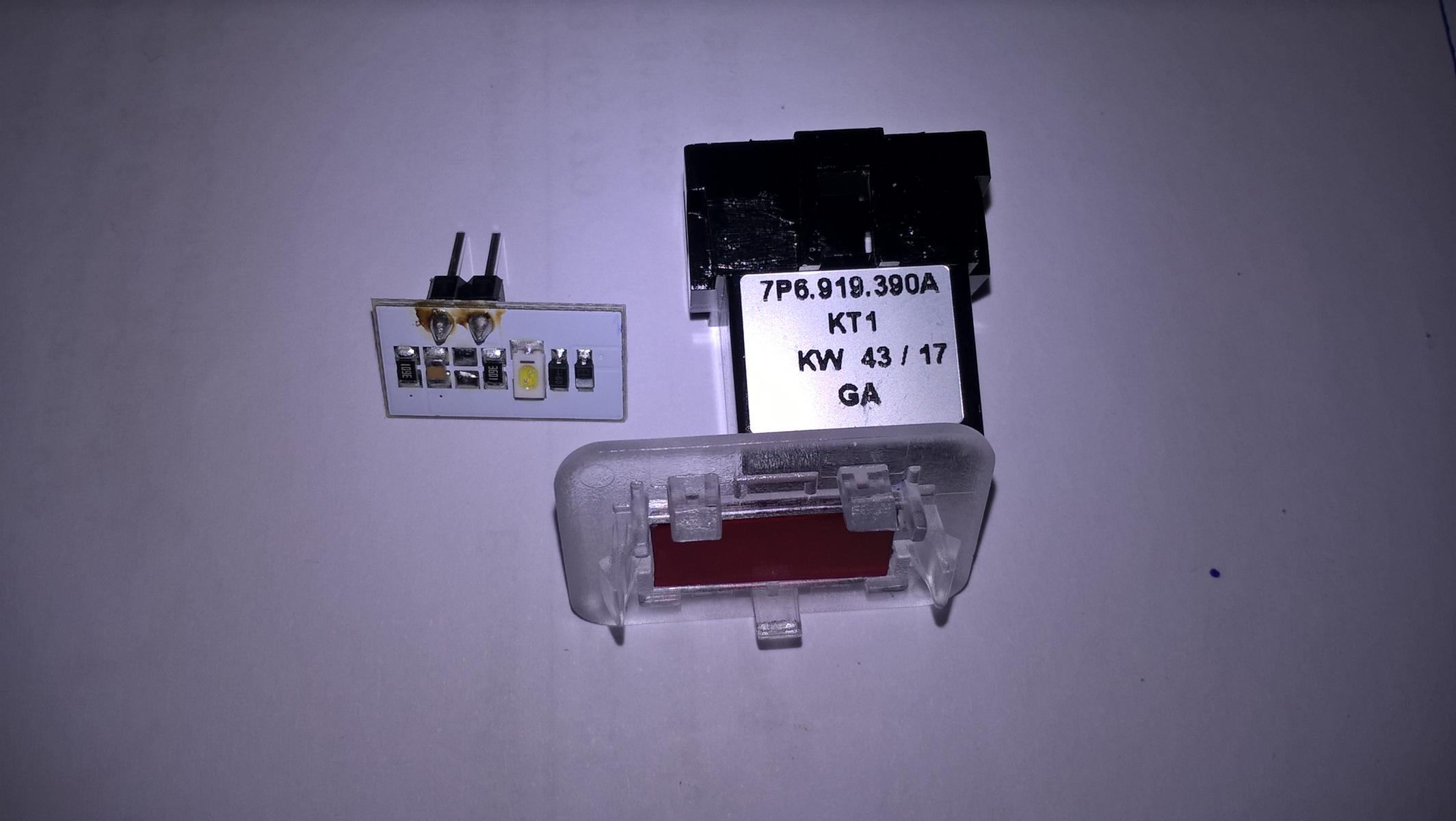

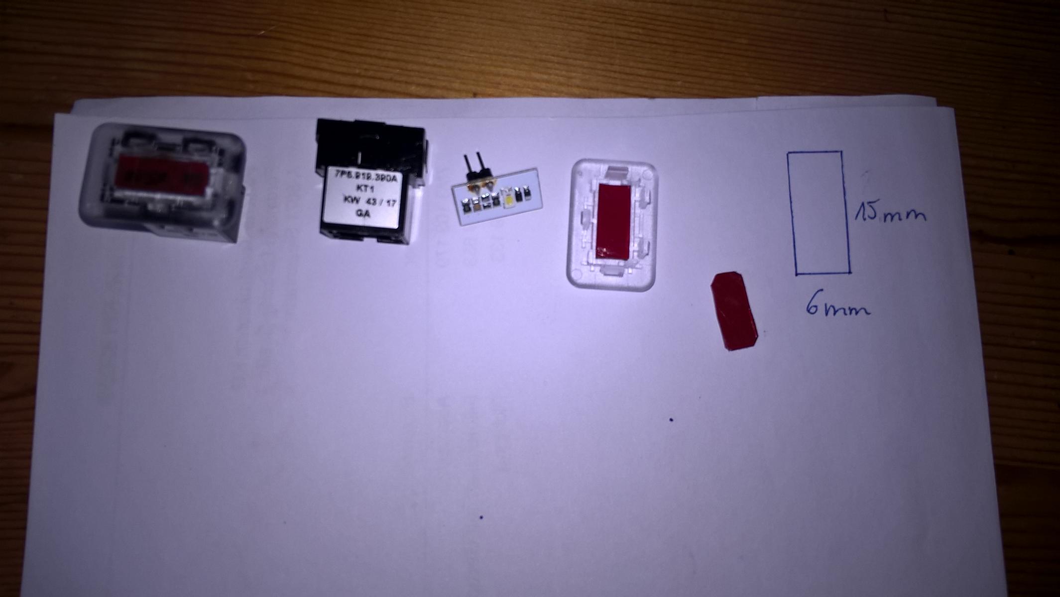

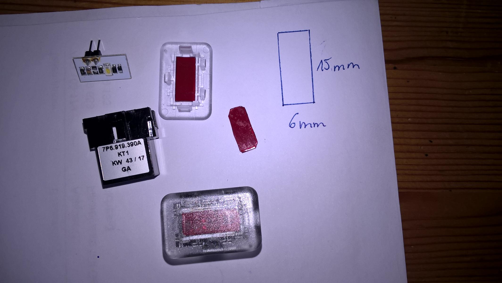

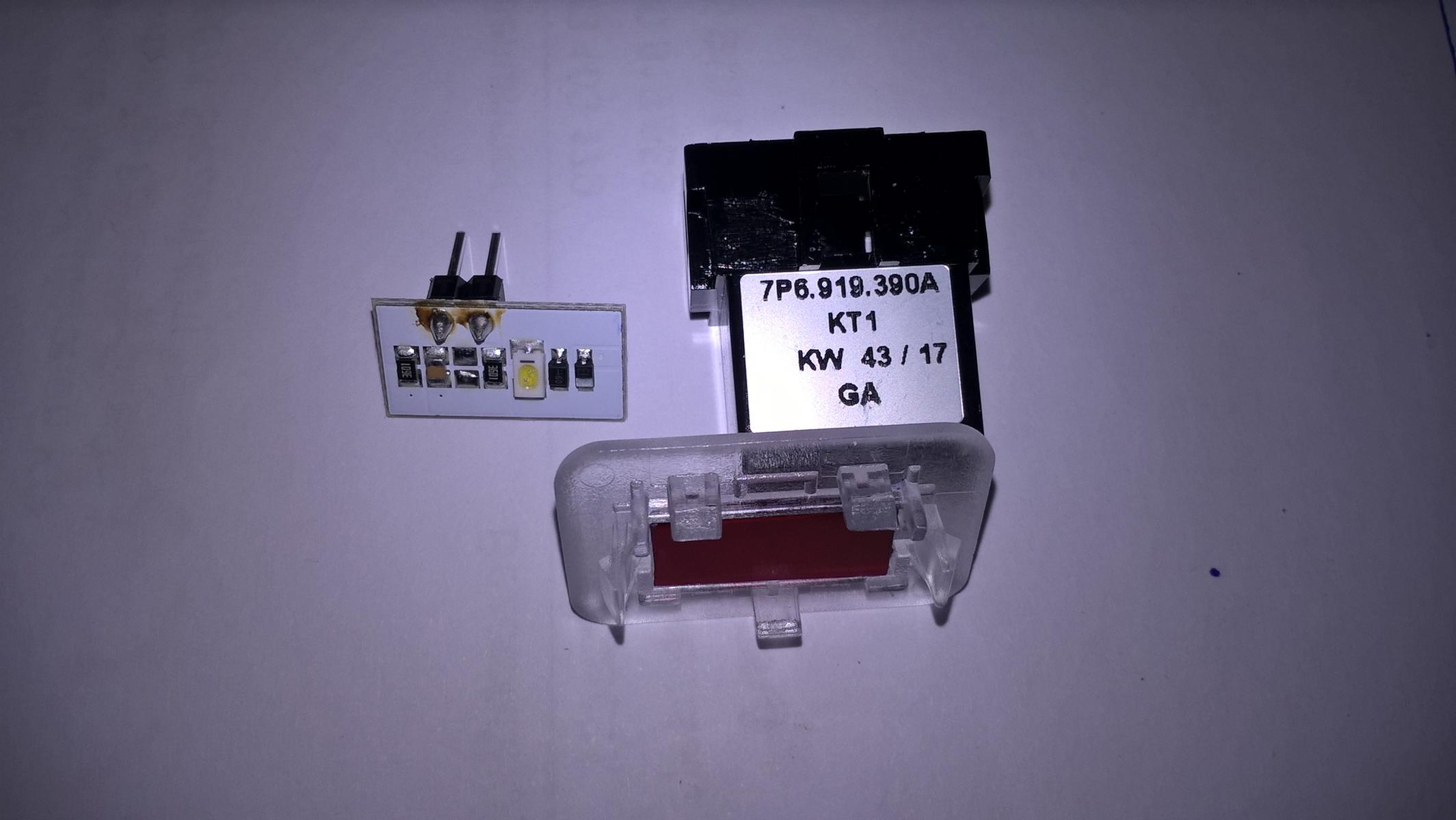

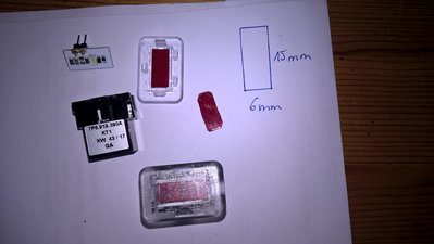

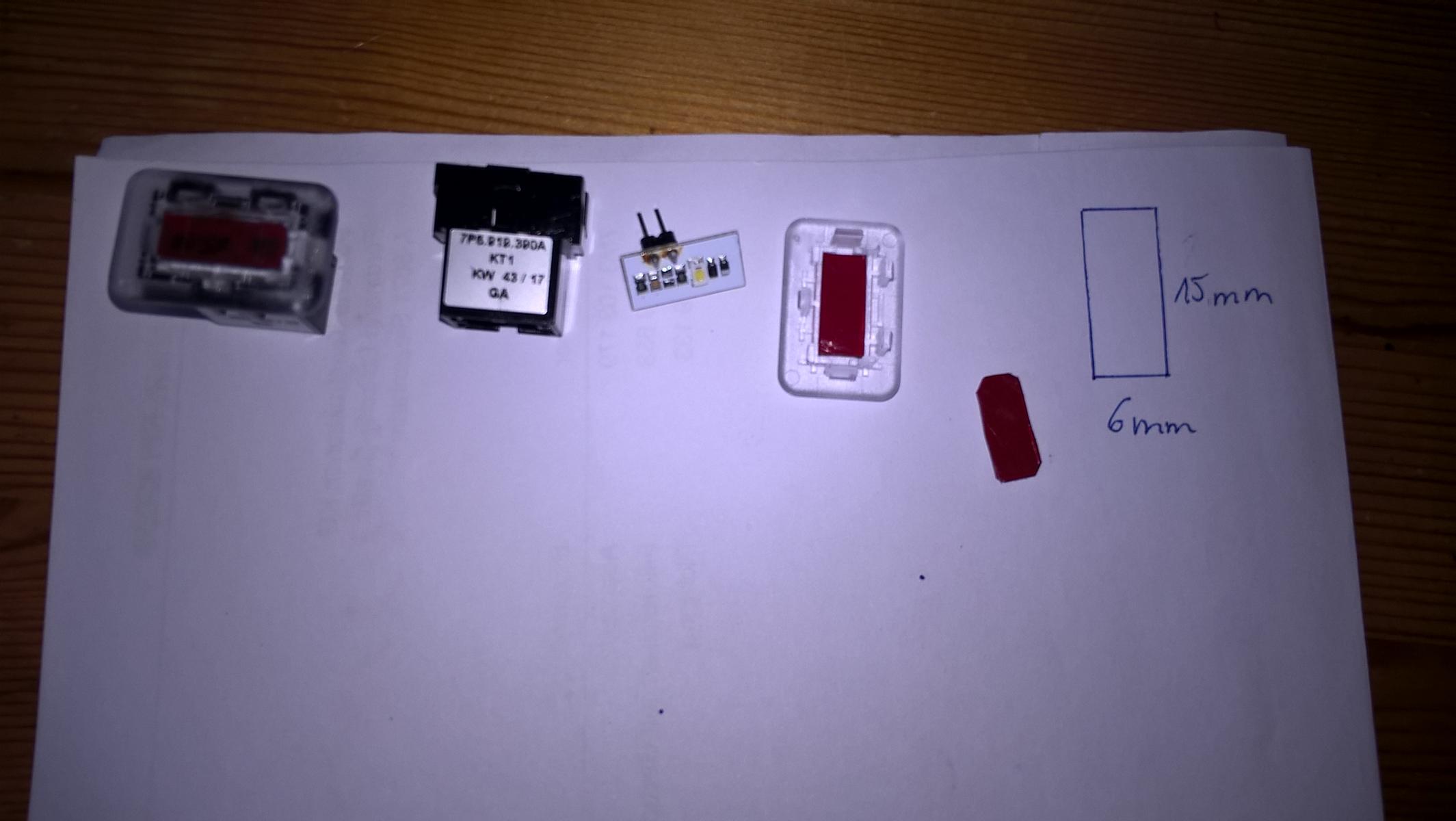

Hey Guys,
Today I reveiced the lamps 7P6 919 390A KT1. :D
I have planed to use this lamps for door warning lamp (ala Audi A1) in my polo 6R.
They are small enough for the door panels in the polo. :D
Now I have modified the lamp, change the colour to red --> look at the pictures.
The qualitiy of the lamps are very cheap about the price of these lamps :x .
The KT1 lamp is the brightess version, had only one LED/SMD and ist very dark.
The conector have 4 pins but only 2 pins are in use (pin1 is ground; pin2 is +).
Now I am go to vacation so I have no time to install the lamps (need a working car :roll: :lol: ), I hope after end of the holidays.
with kind regards
master
