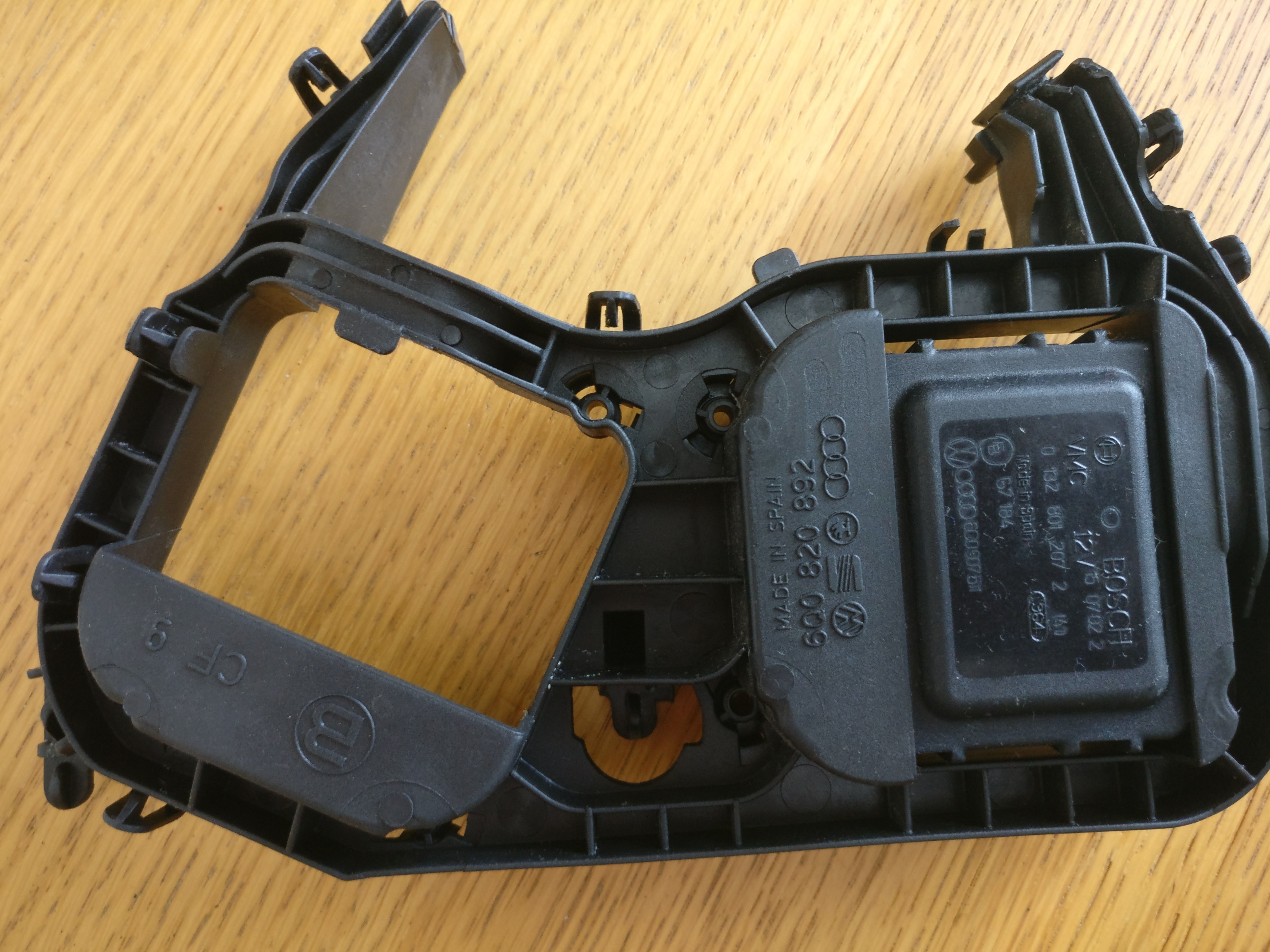

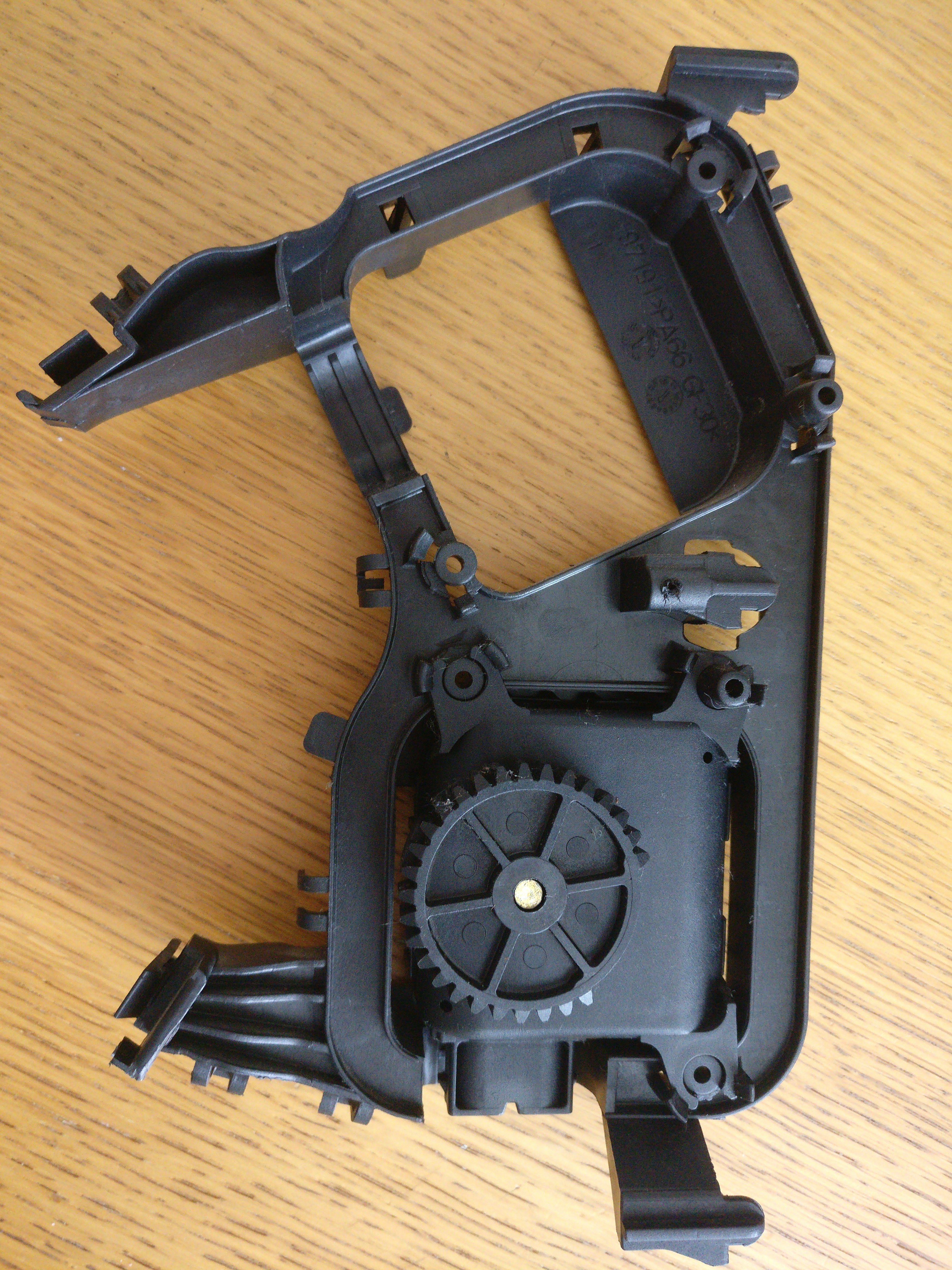

Some progress, but now there's a problem.
Original motor bracket and motor assembly.
New motor
Side by side - the gear is different!

The part which I removed is Bosch 0 132 801 207. When I Google this it comes up as a headlight control motor AND a heater motor flap control. I'm guessing its a general purpose item.
Not sure what the new unit is for, but where can I get a replacement Bosch 0 132 801 207?

6Q0907511 is the part for the motor itself
The actual motor is the same. You should be able to just switch the gears over providing the home position is the same on the new one so it lines up correctly

I thought about that but it looks like the gears are riveted on? Do you mean to disassemble the motors and swap them?
Re: Air con not working right? Replace the V68 motor - HOW TO.
Posted: Sun Jul 21, 2019 1:18 pm
by alexperkins
Yes disassemble the motor

I'm not overly enthusiastic about open motor surgery. Maybe I'll plug the old one in and check and mark its angular rotation, then do the same for the new one to see if I'd be starting with a chance to avoid complications arising from problems in that area.
Posted: Sun Jul 21, 2019 7:36 pm
by alexperkins
You’ll see inside it’s quite straightforward. It can only really go one way
