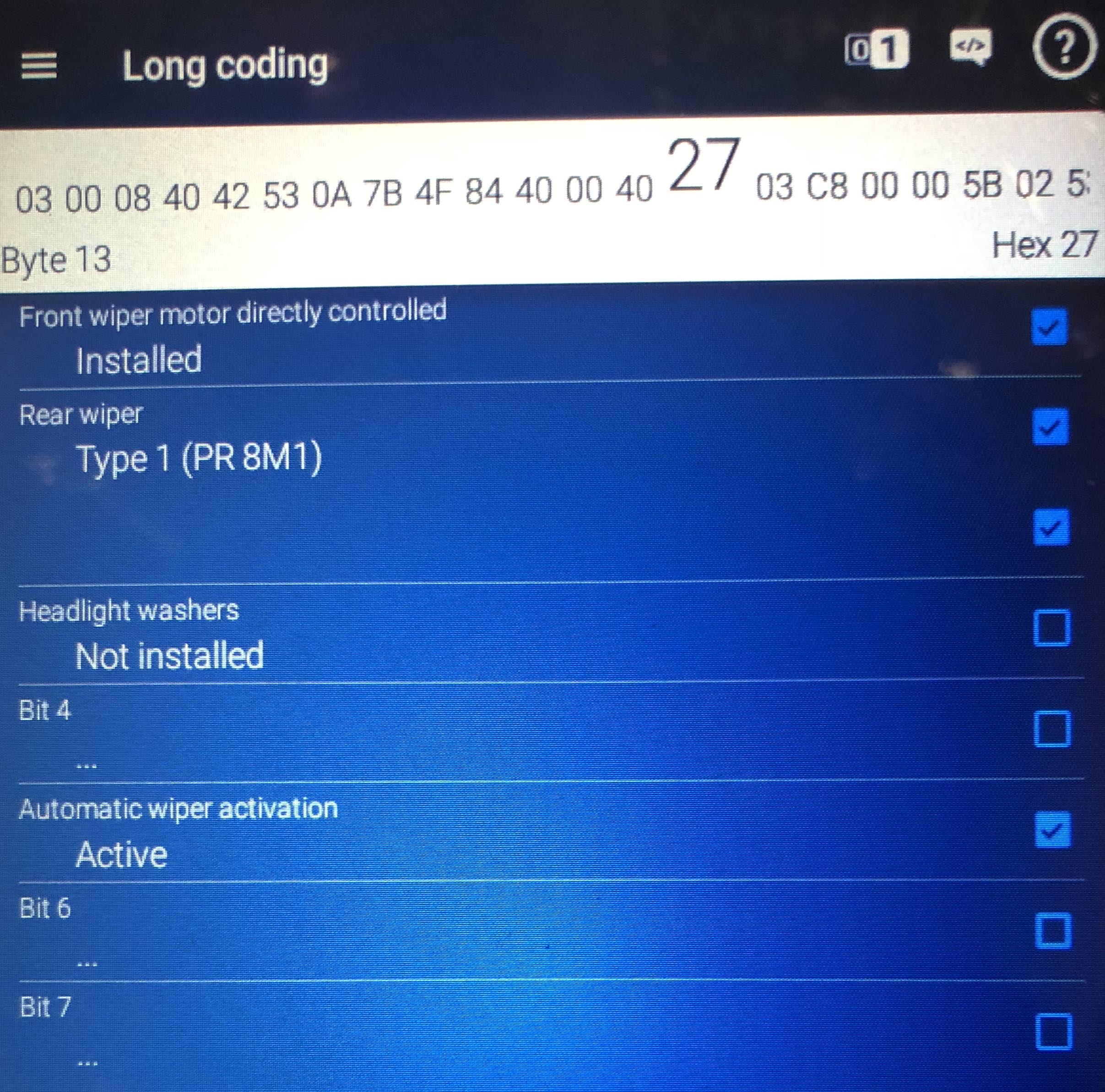

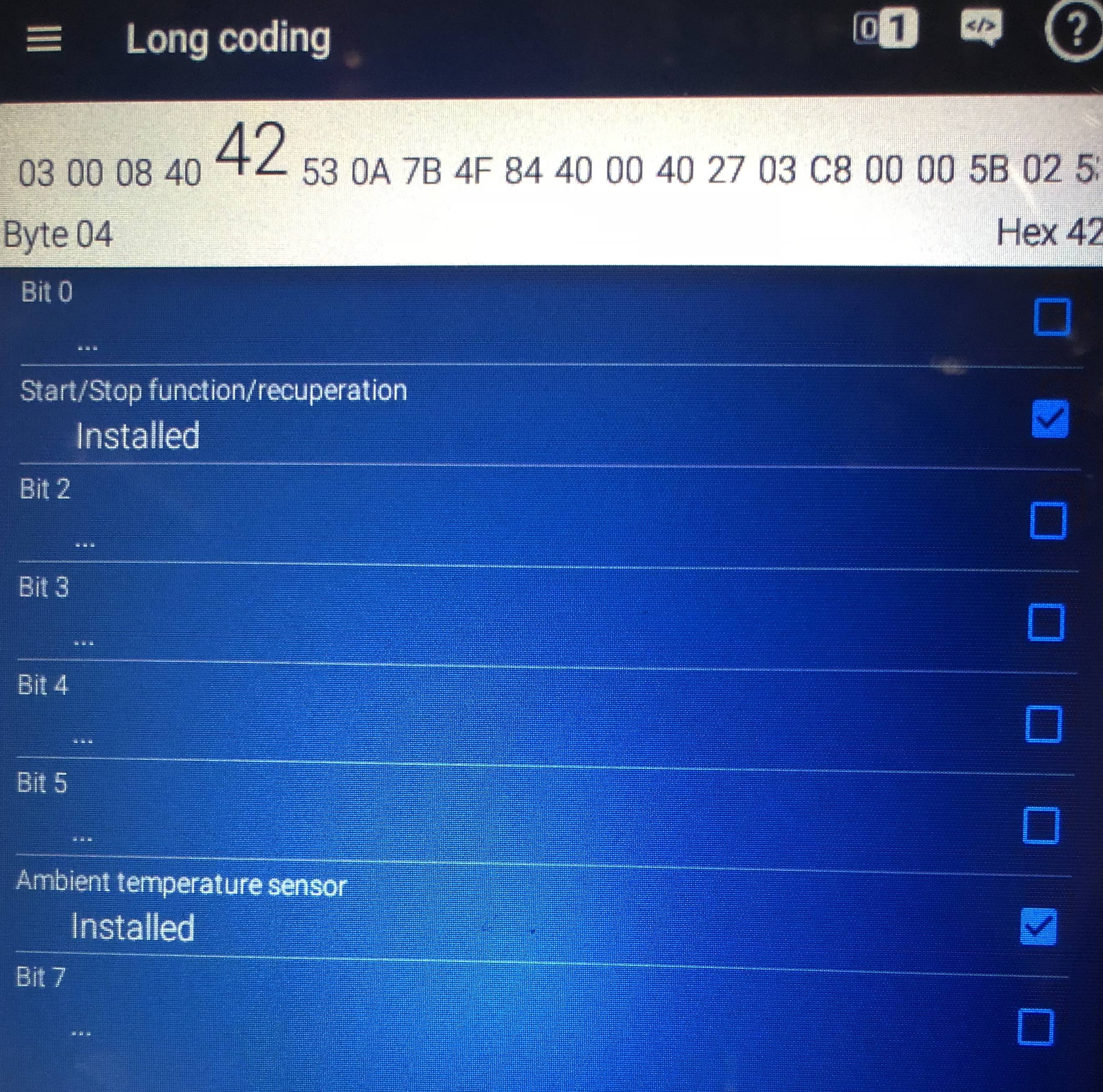

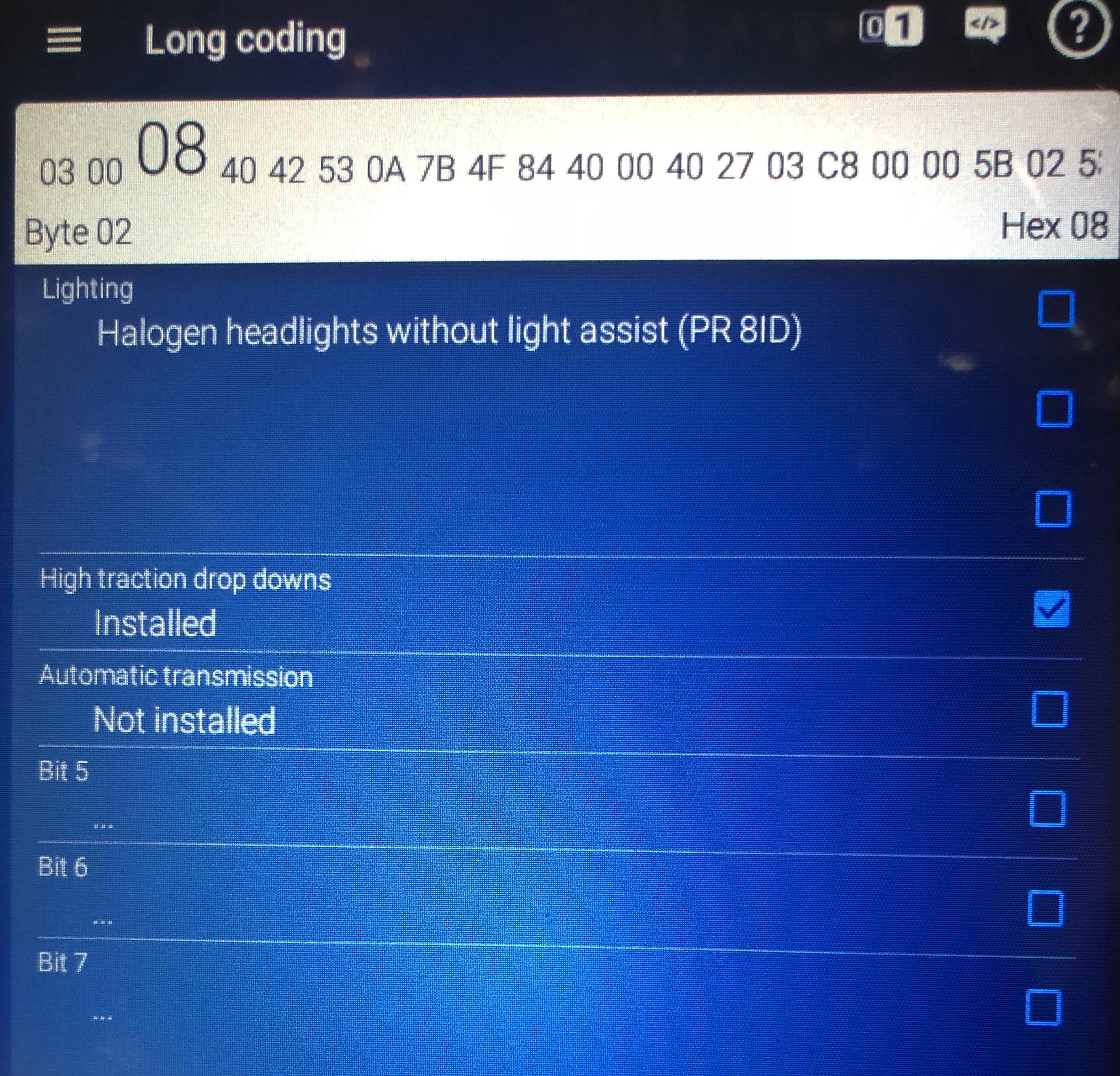

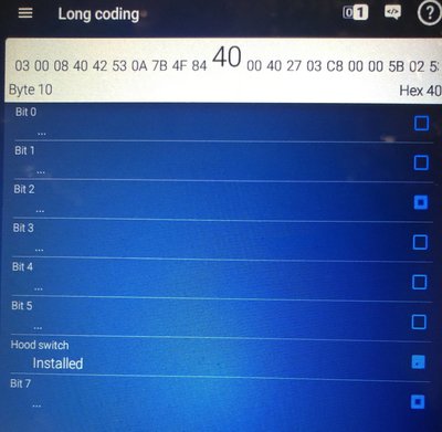

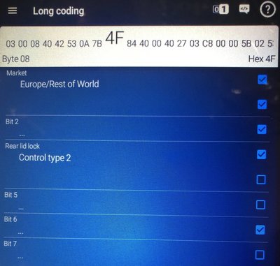

hi Fatih. Are you able to see your rls in subsystem 09?
i am wondering if the odbeleven is not recognising it.
i wanted to change bit on rls for close windows on rain.
Also if you see subsystem in 09 do you have other items also.
Can i ask, with long coding helper you see description of bit of all items in 09 central electric?
i am missing bit descriptions in different parts. Maybe yours is more complete

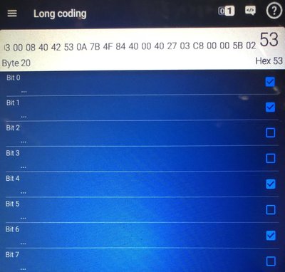

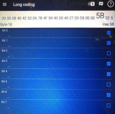

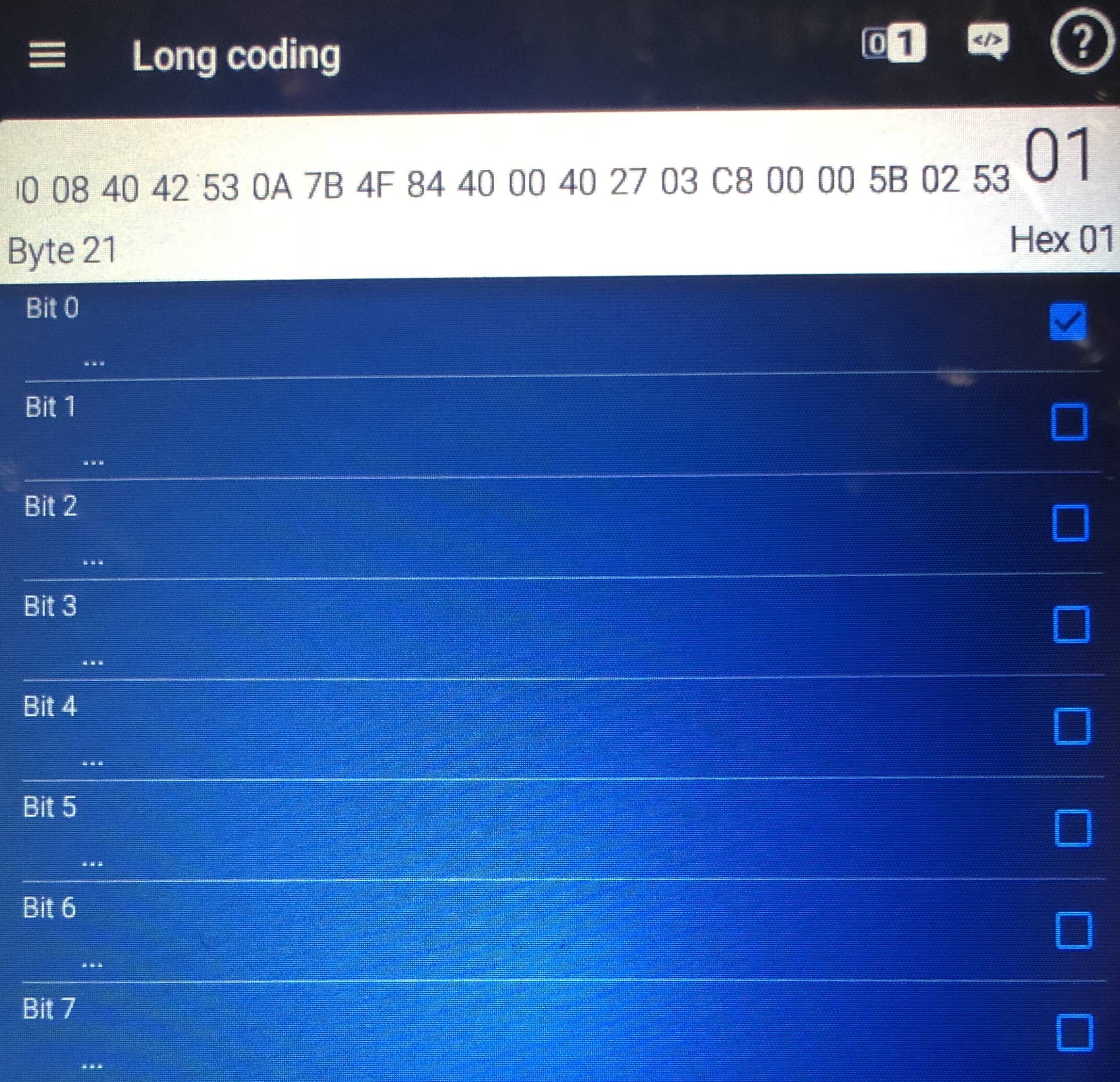

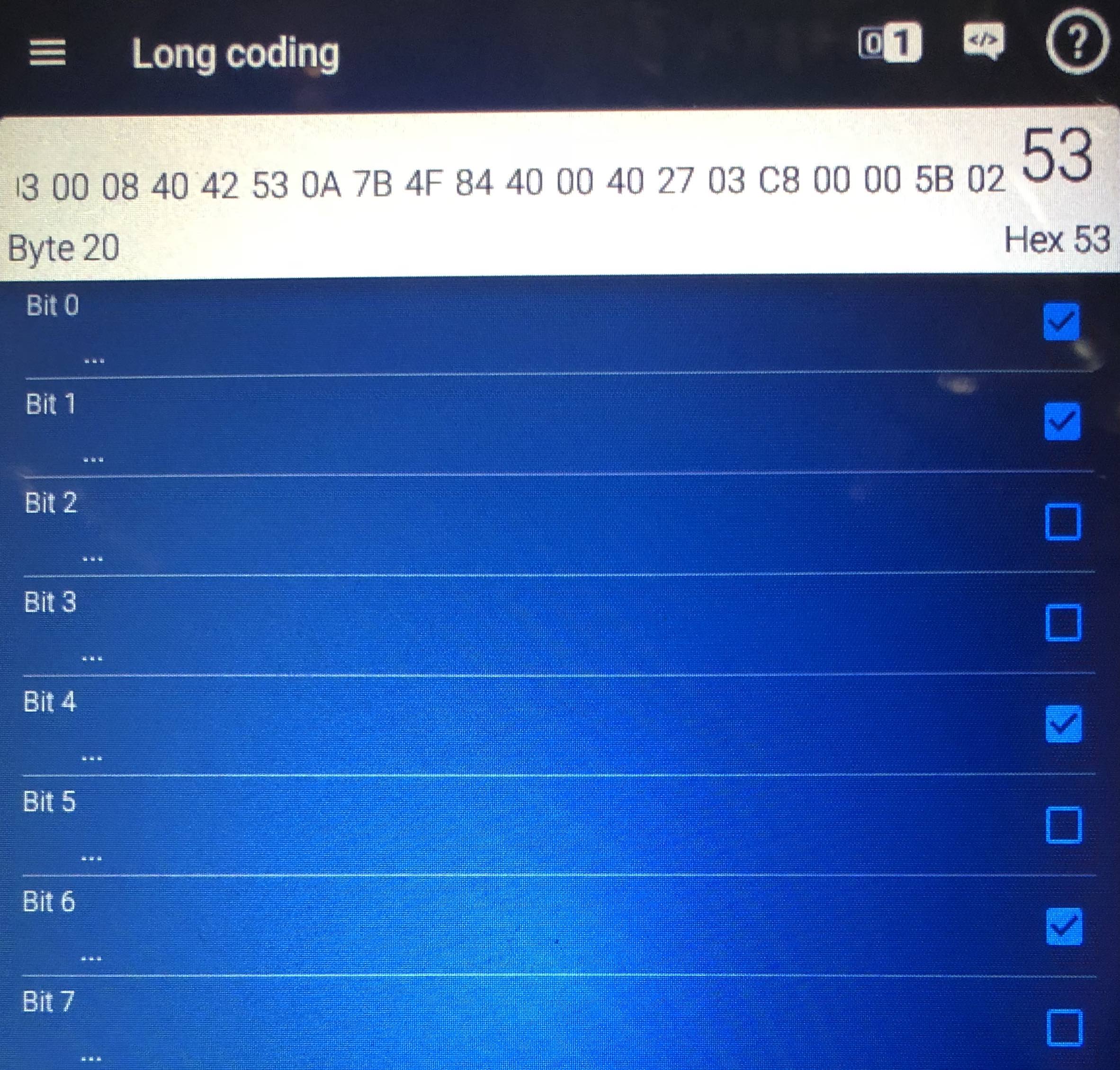

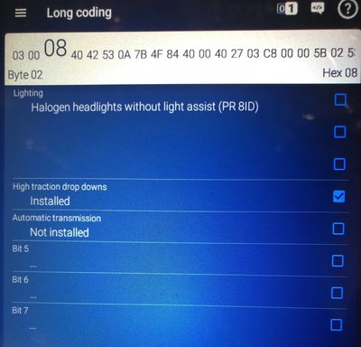

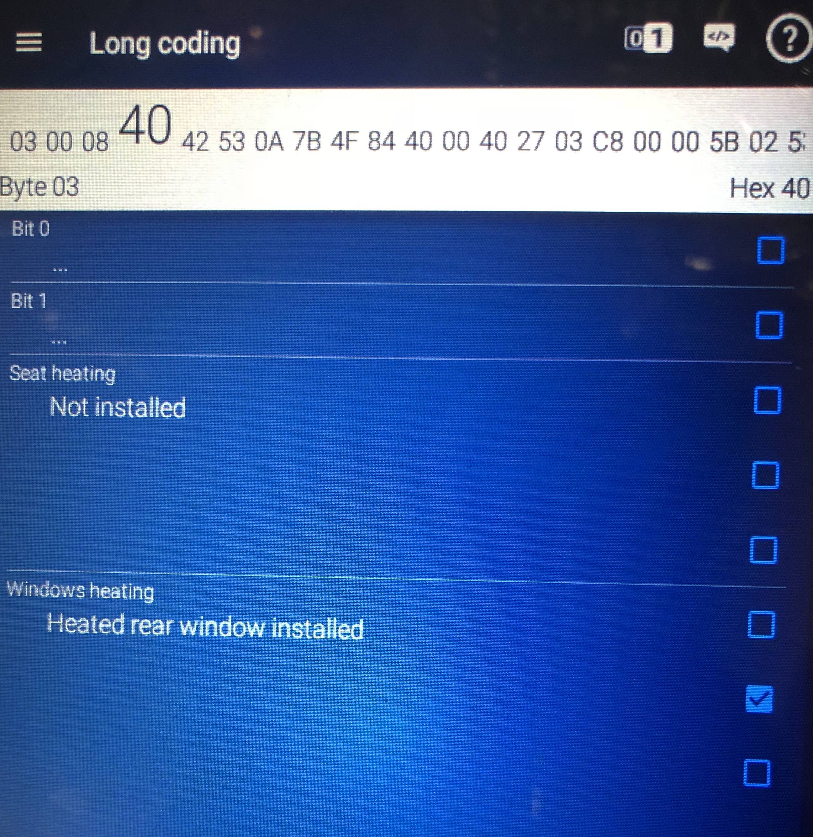

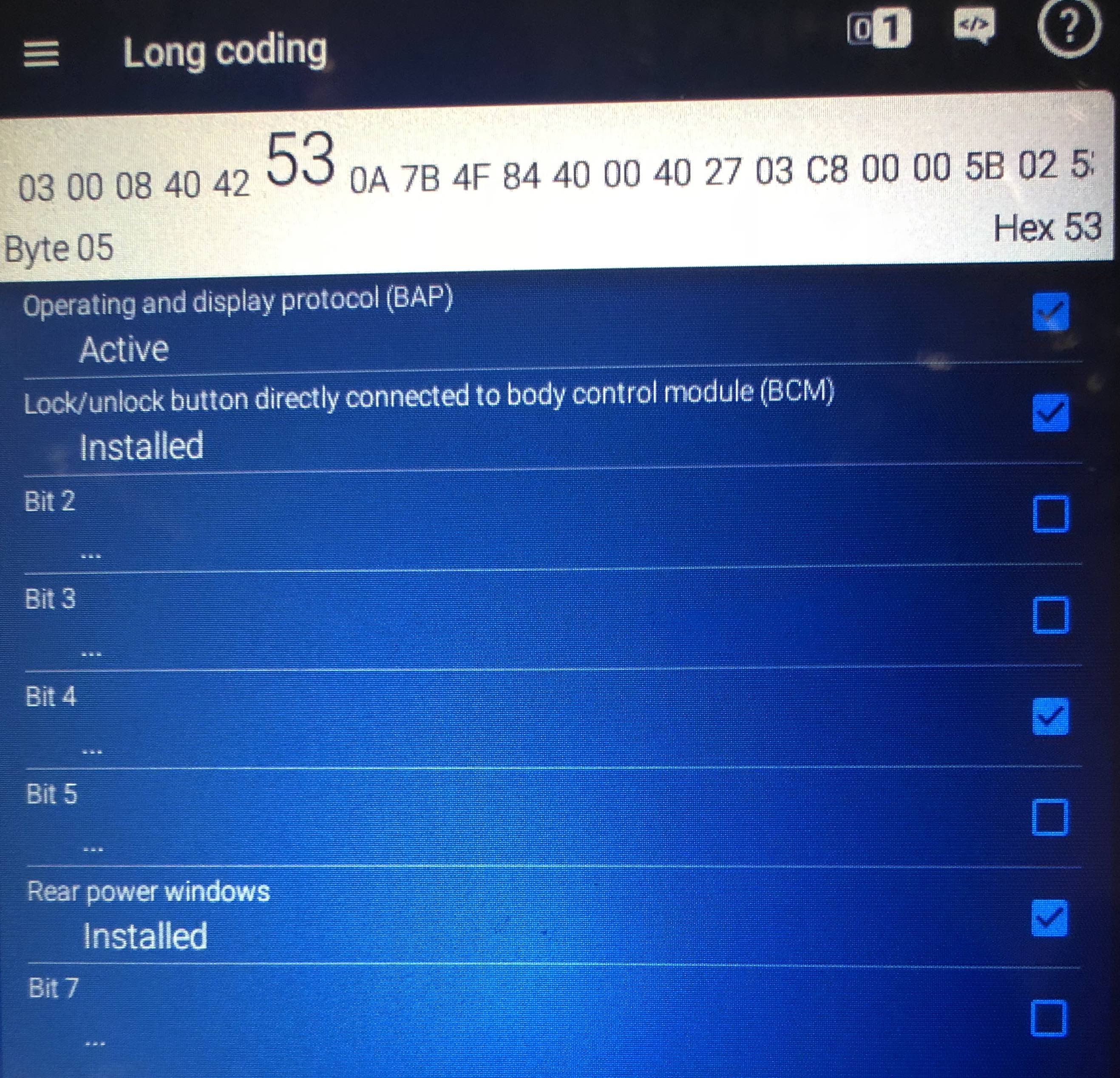

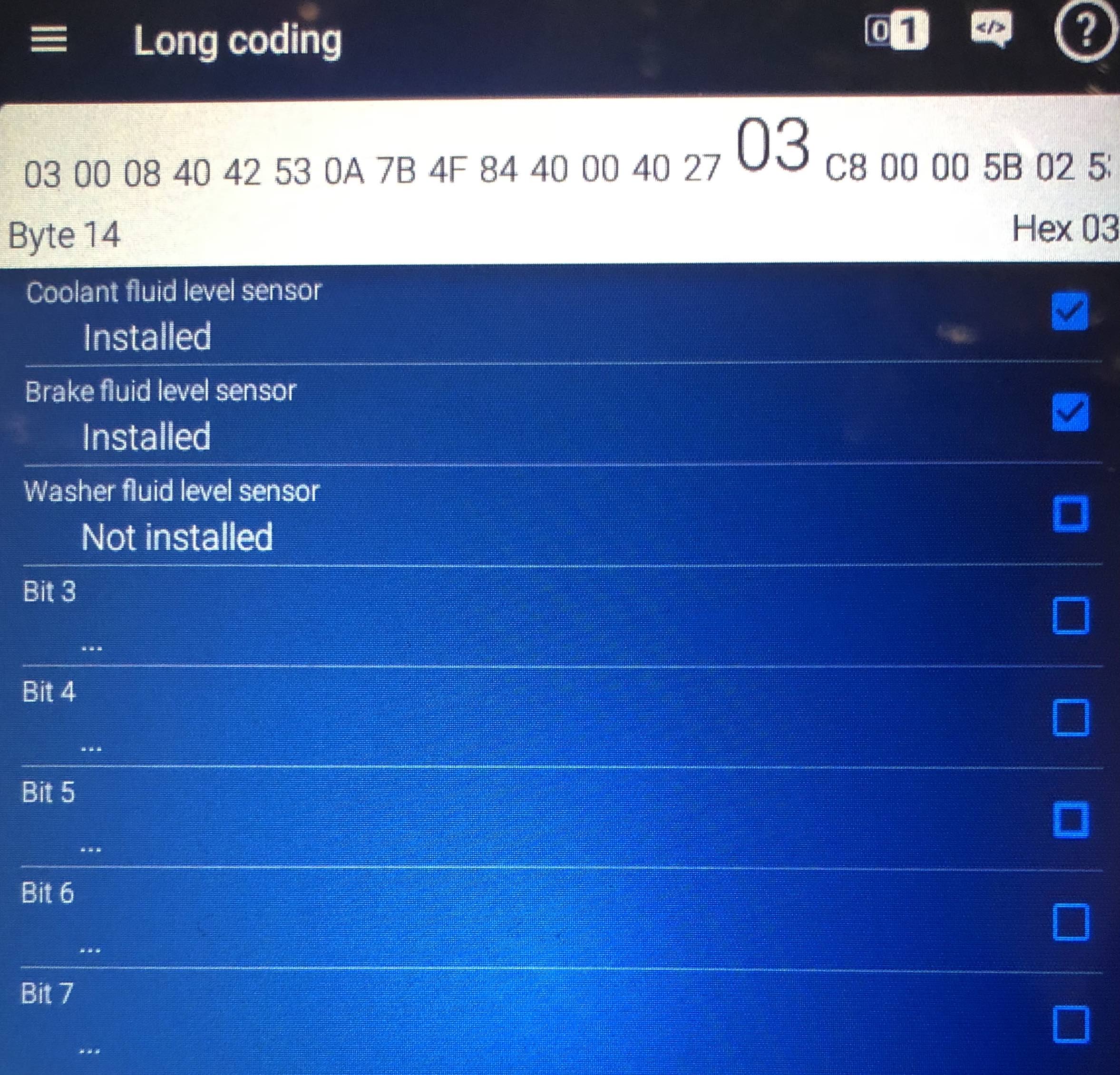

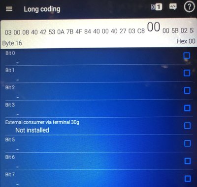

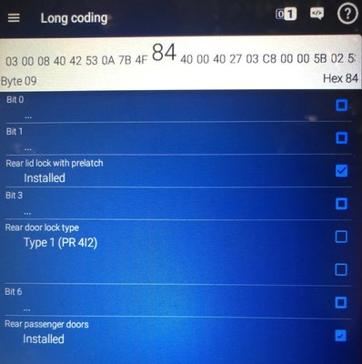

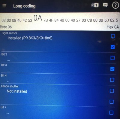

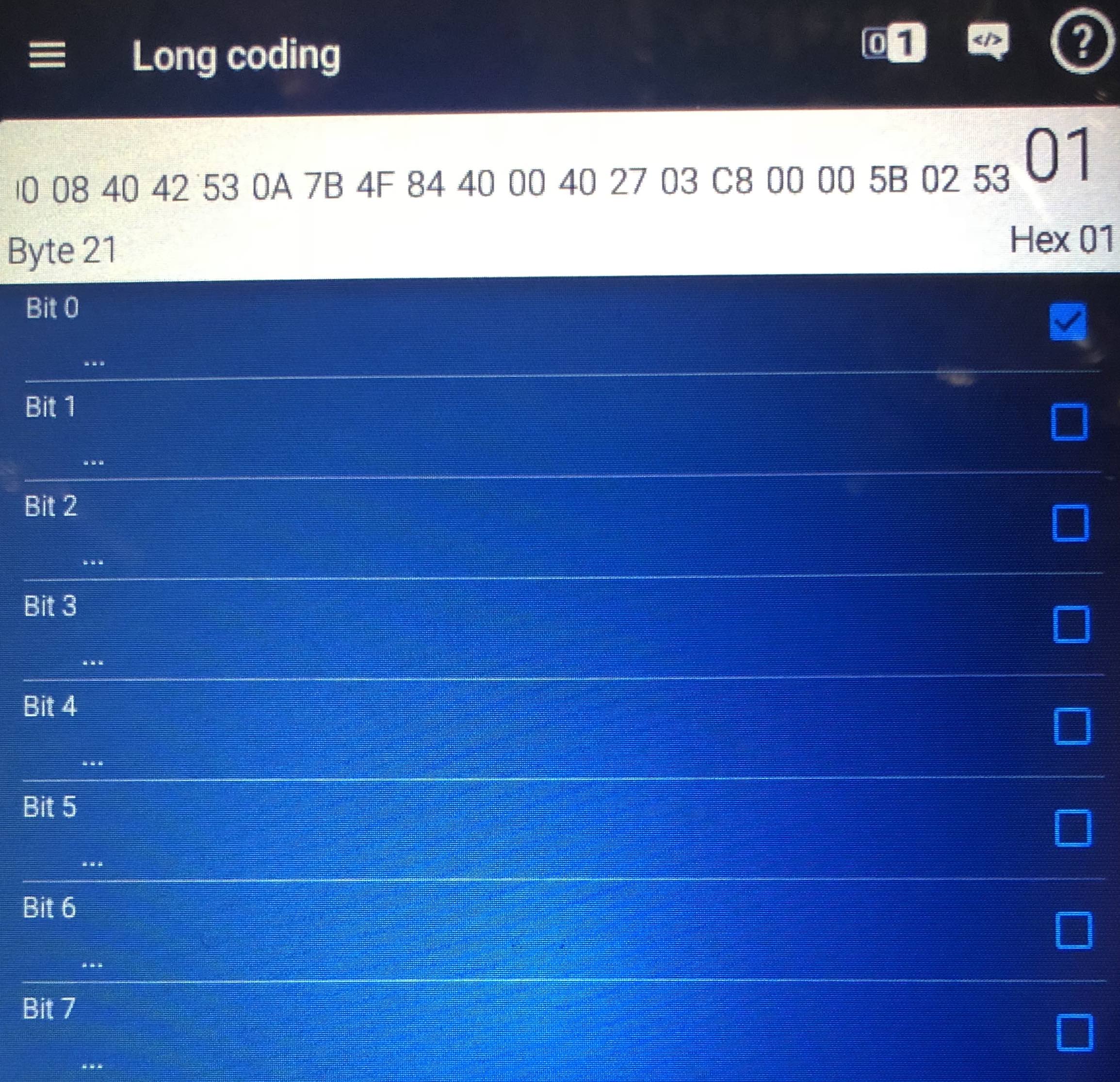

massimo23
- Posts: 128
- Drives: Polo Beats 2017
- Location: Ireland

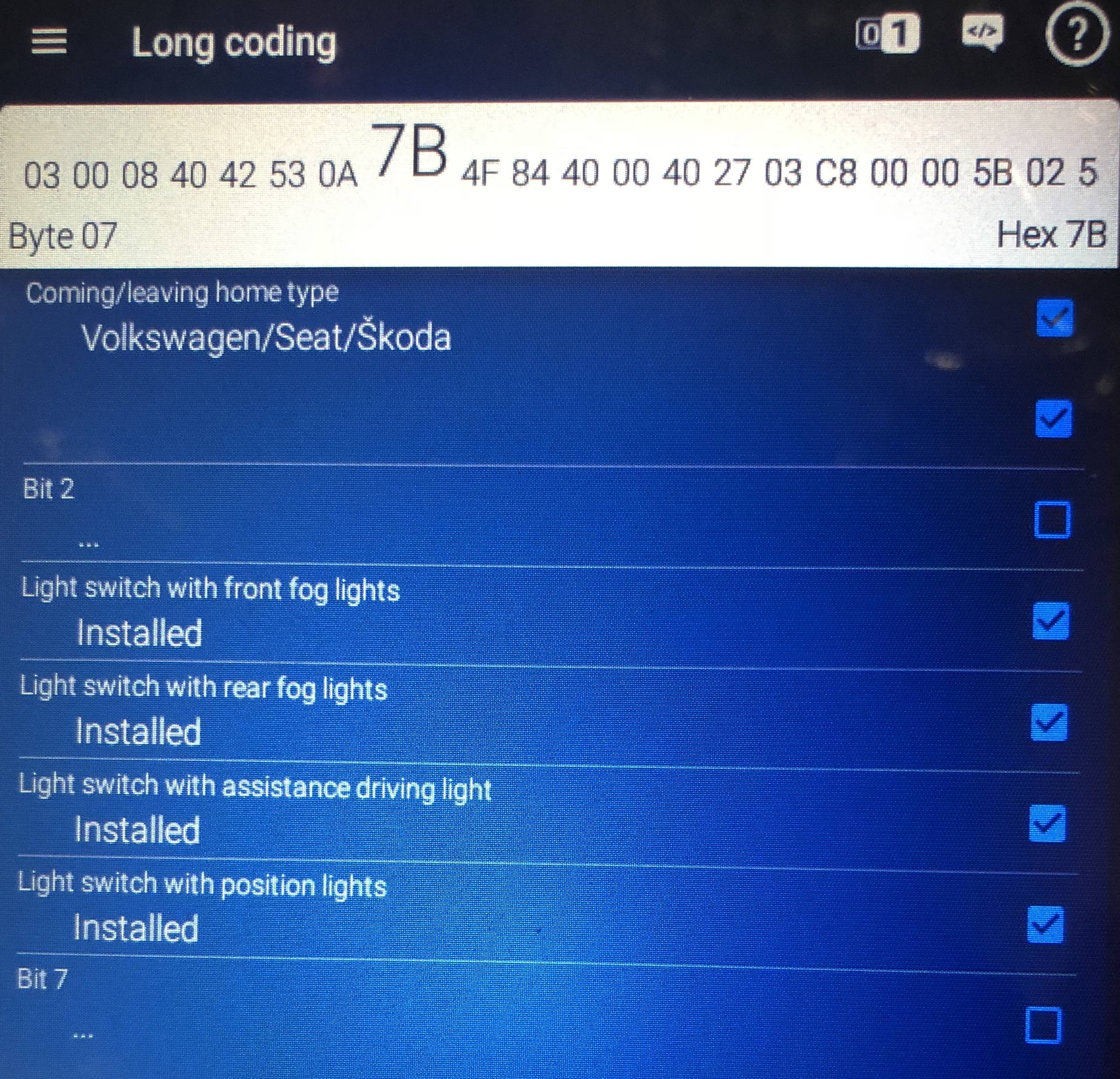

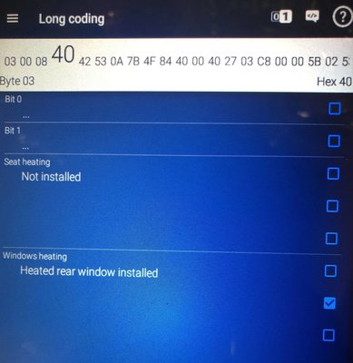

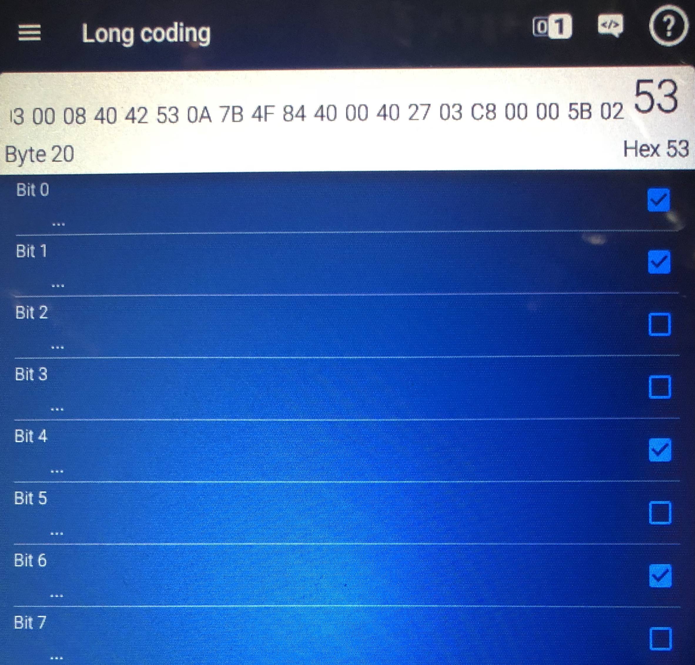

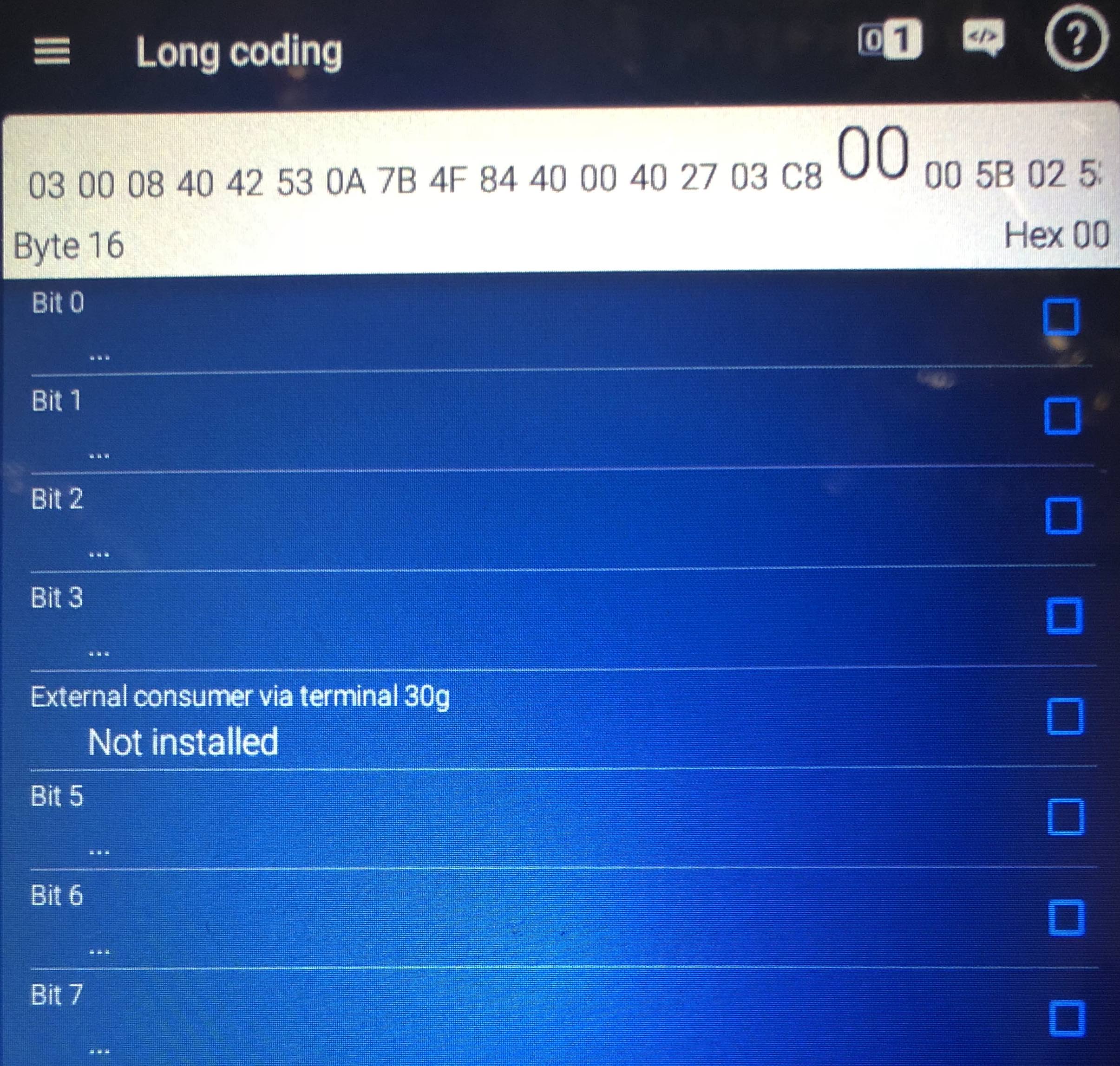

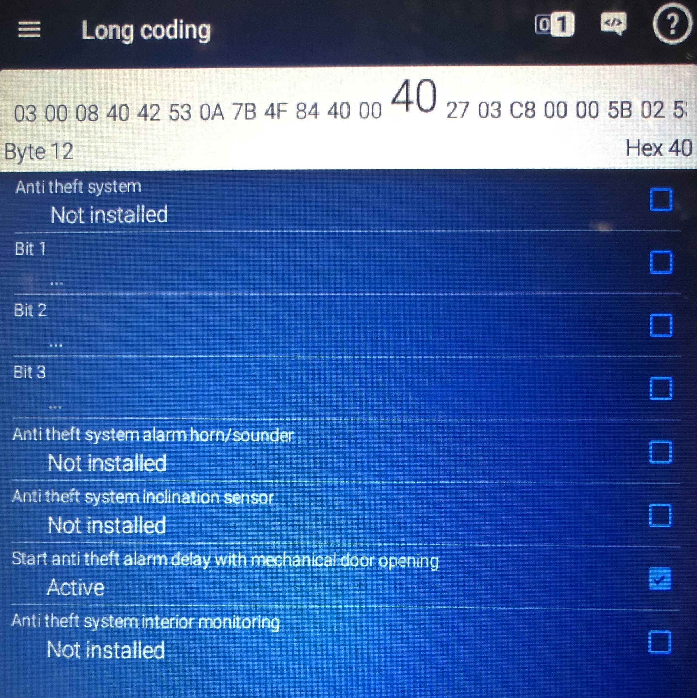

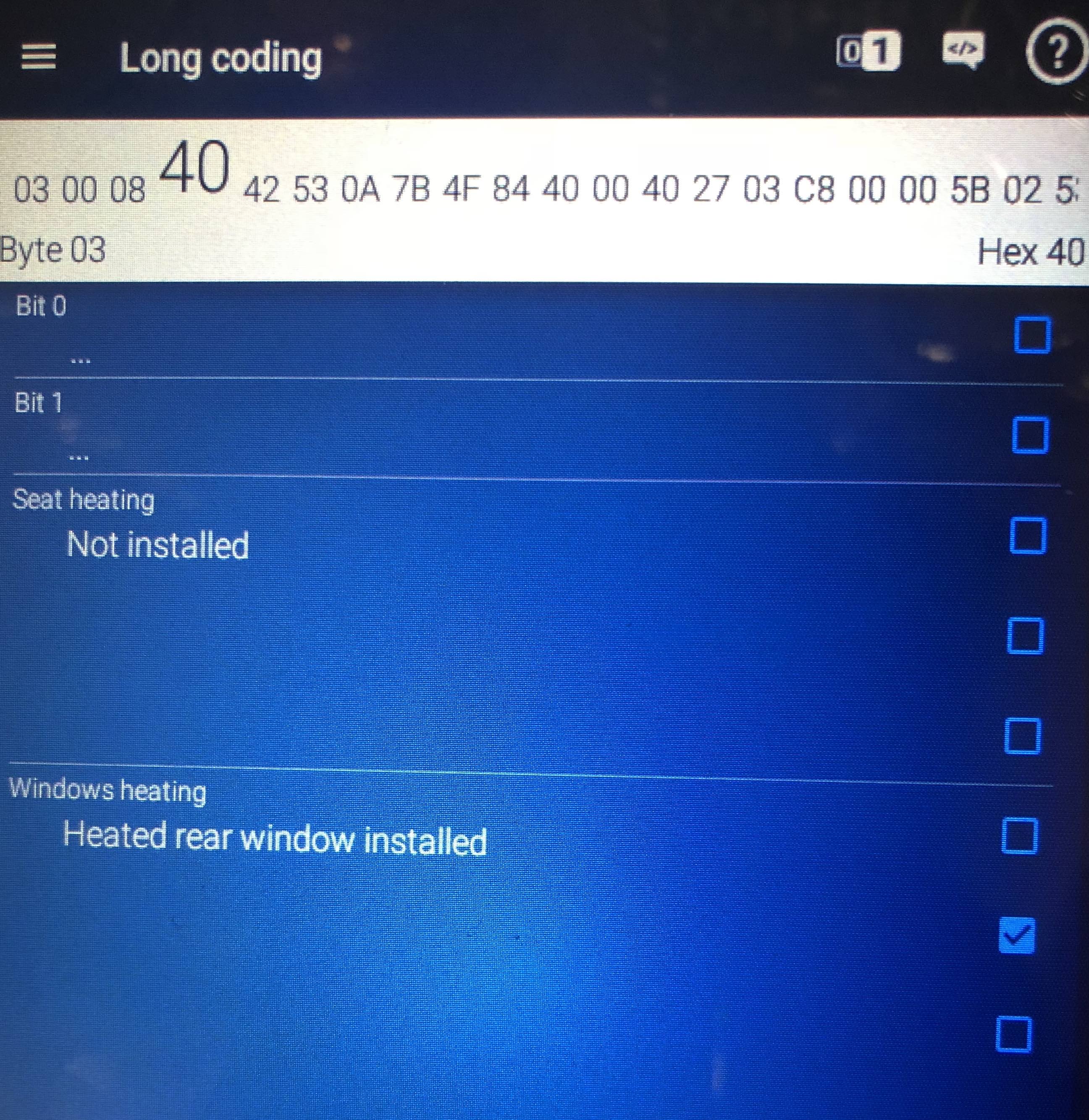

Re: Polo 6C Rain Light Sensor DIY Help

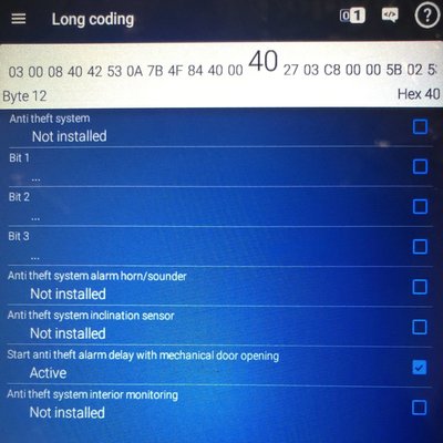

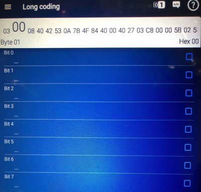

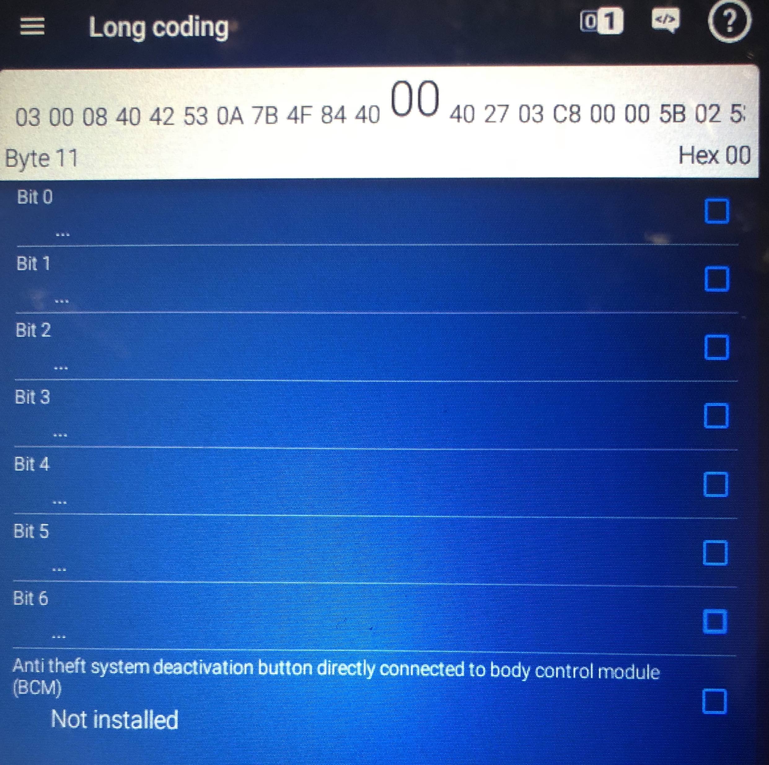

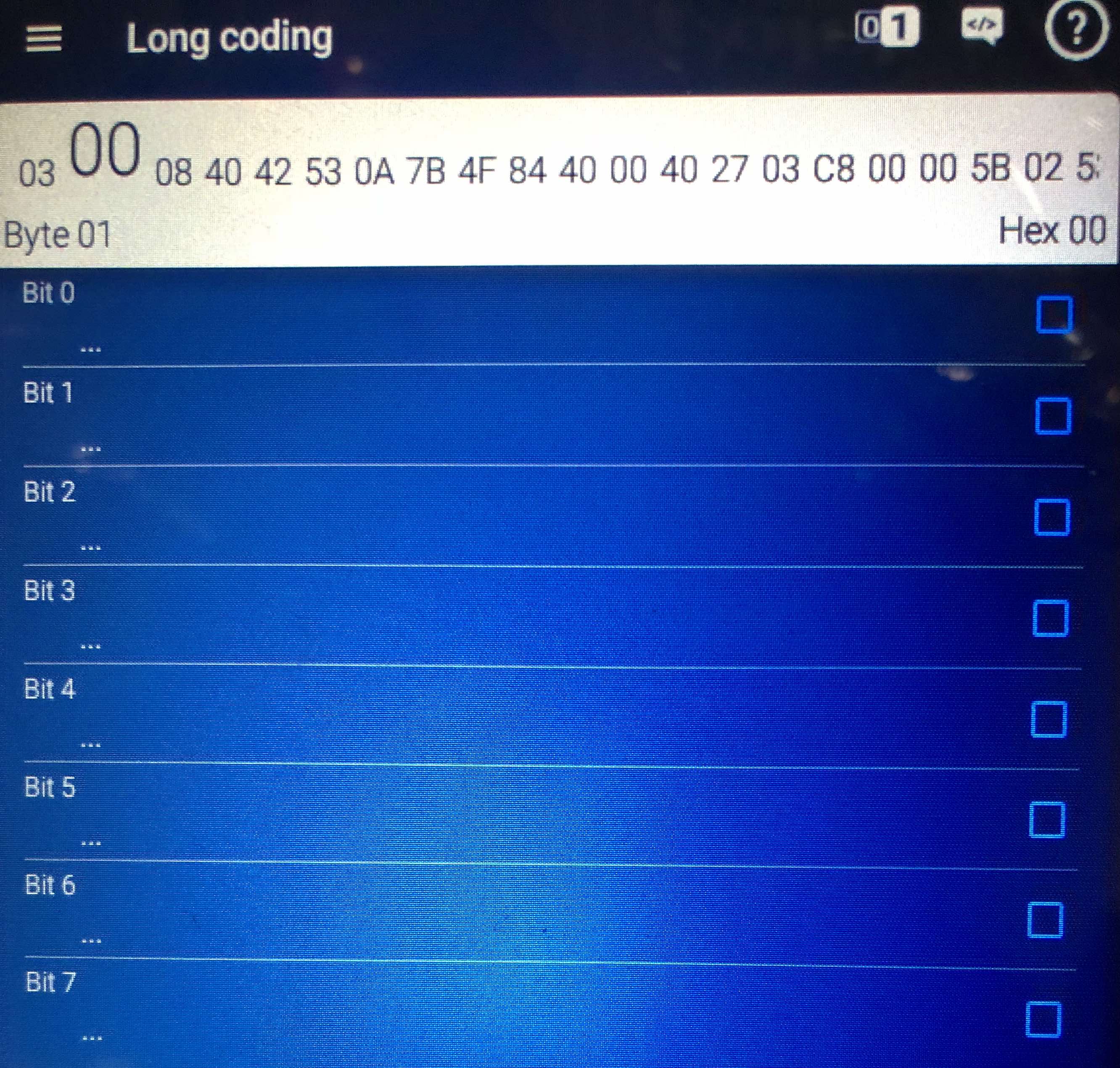

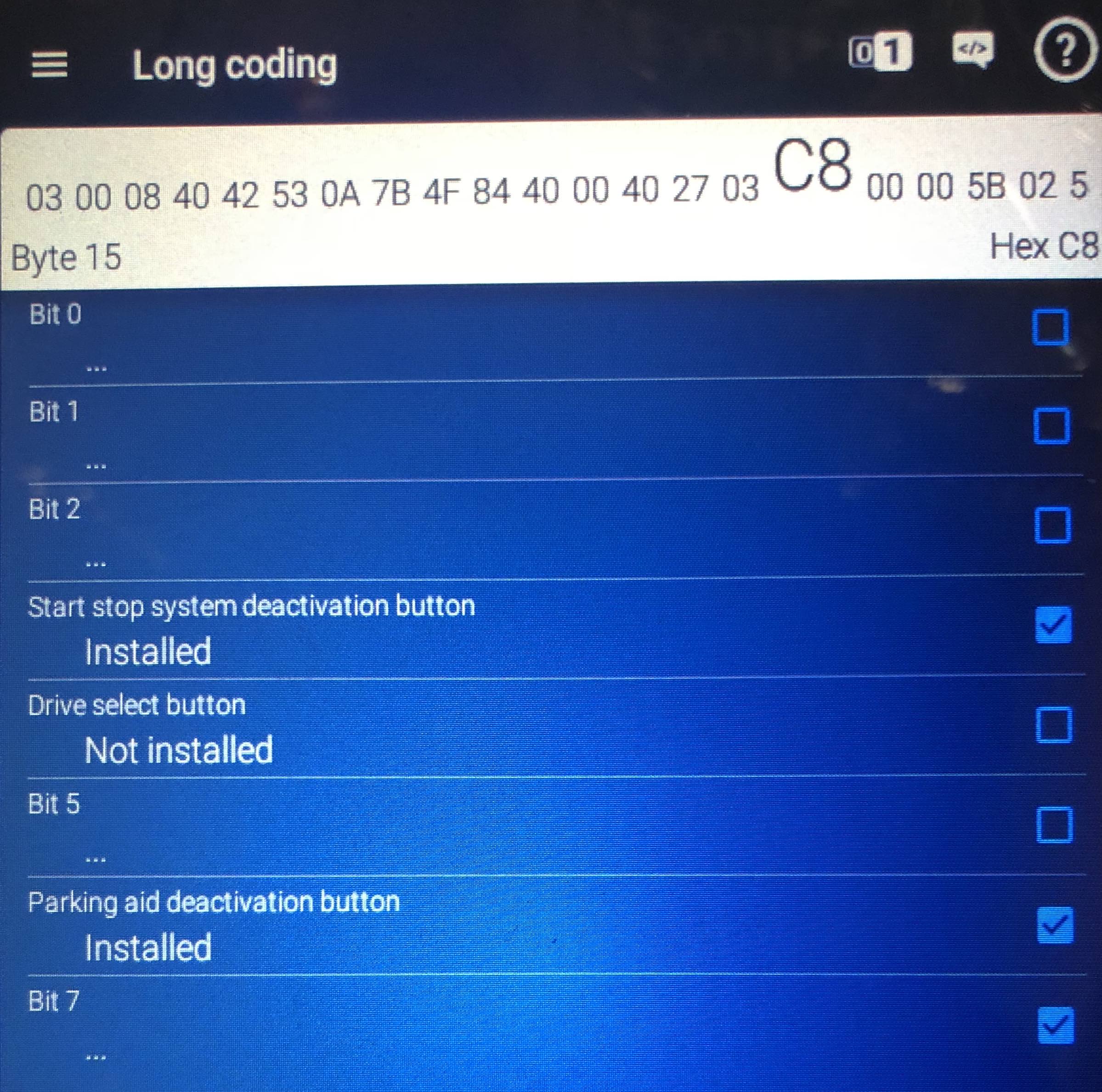

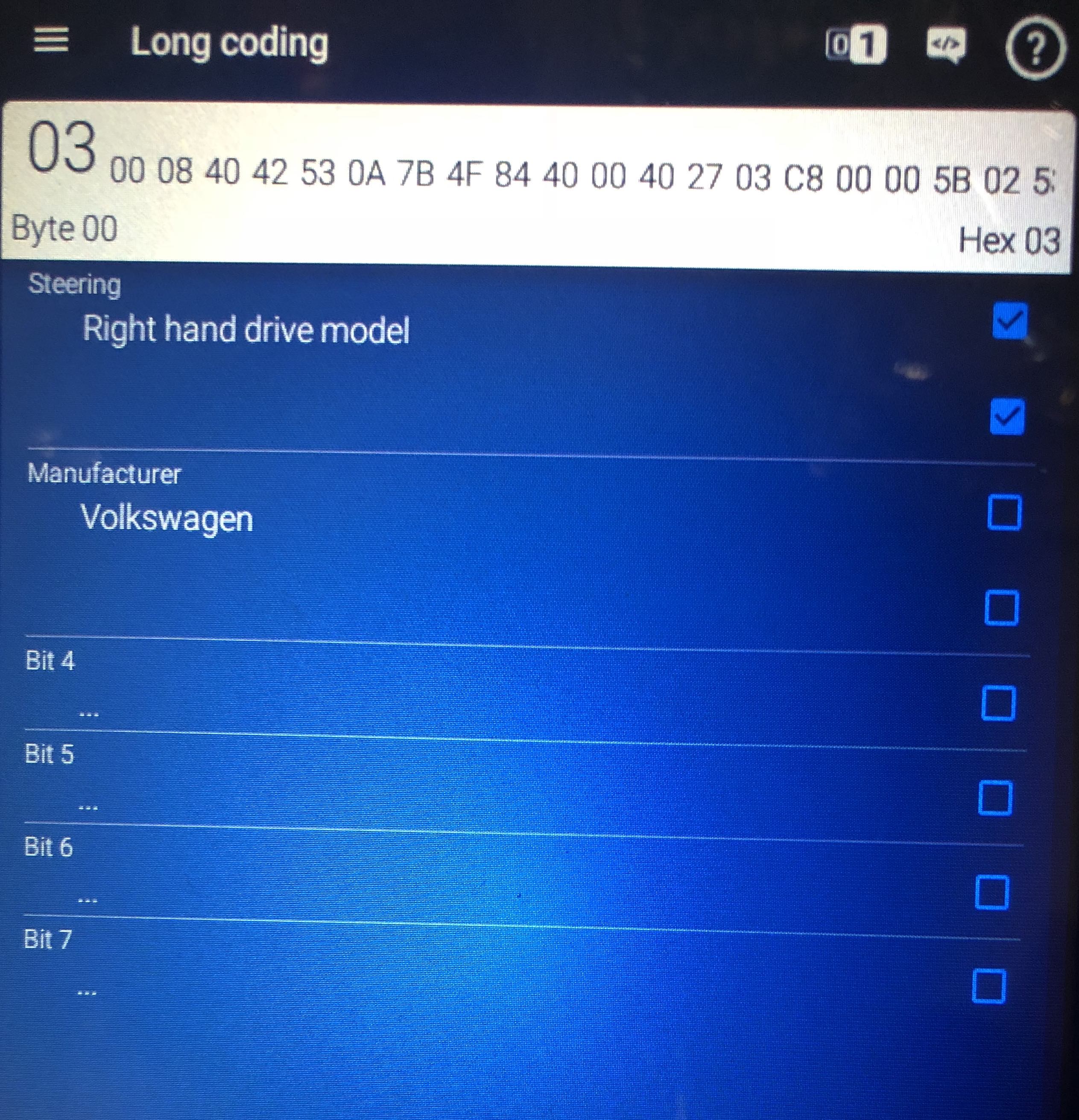

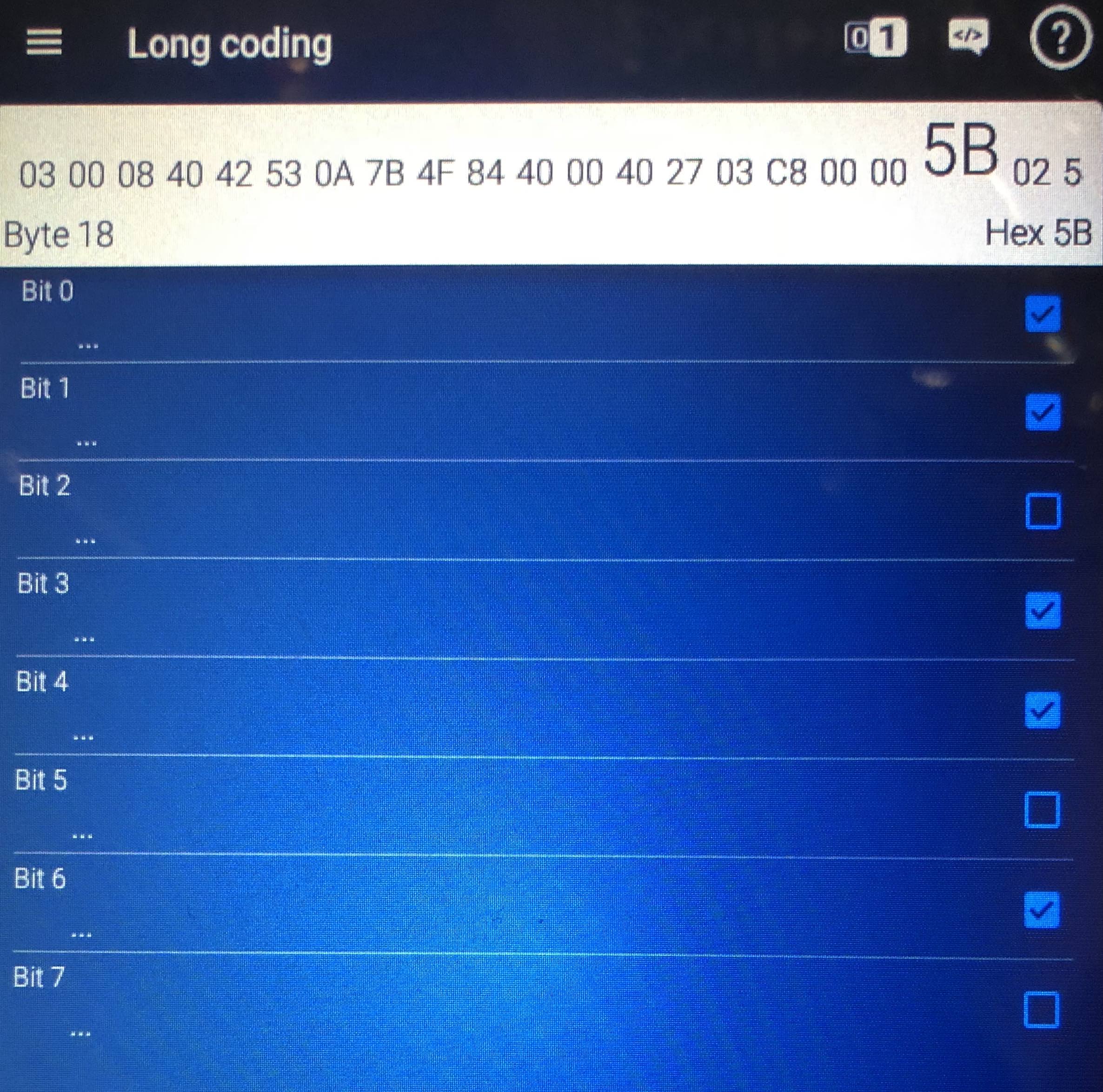

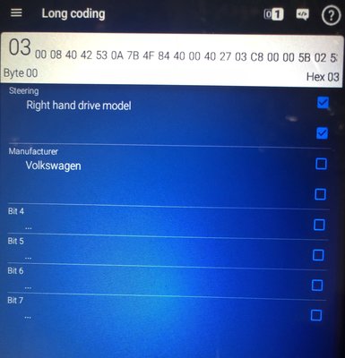

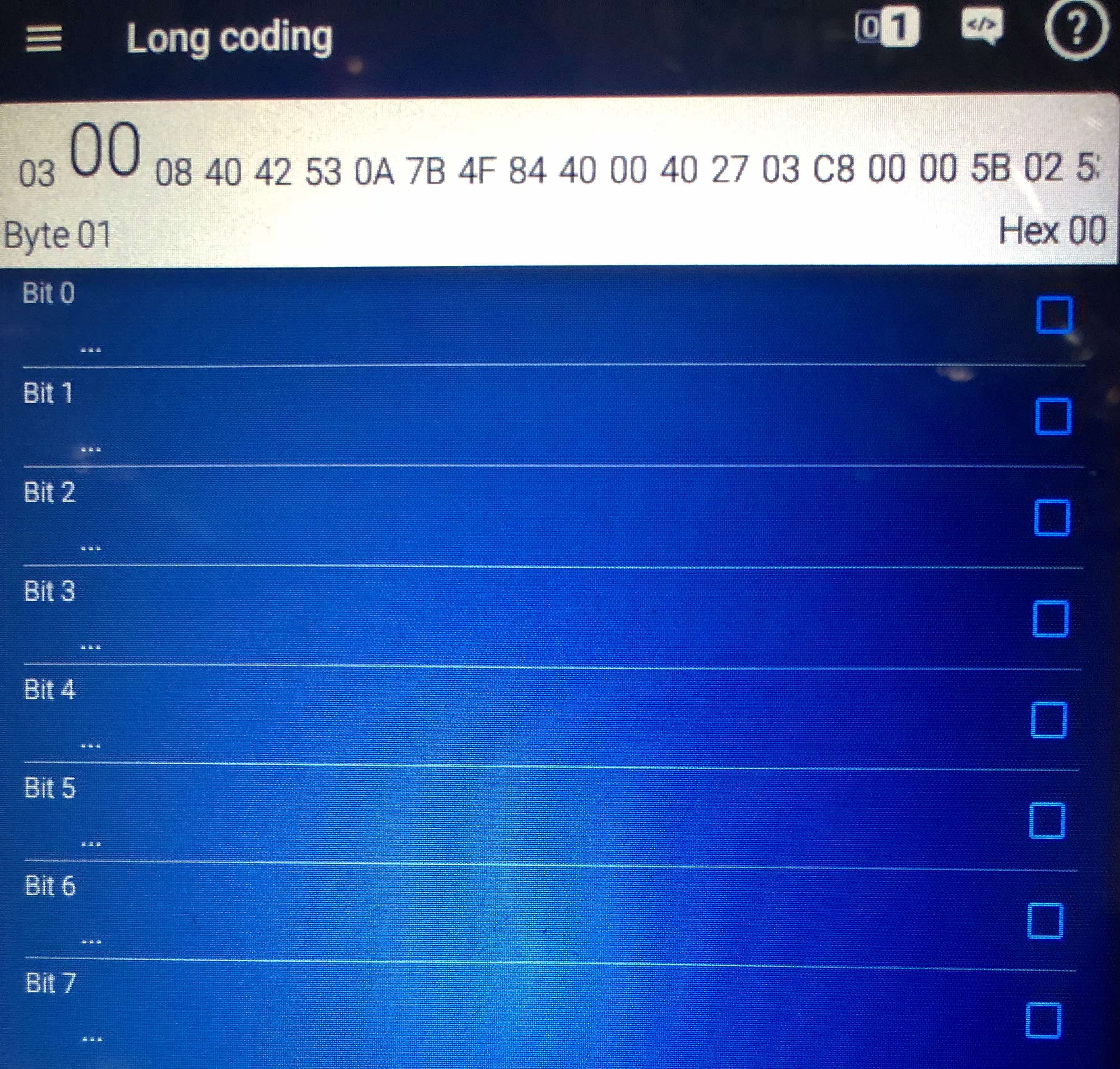

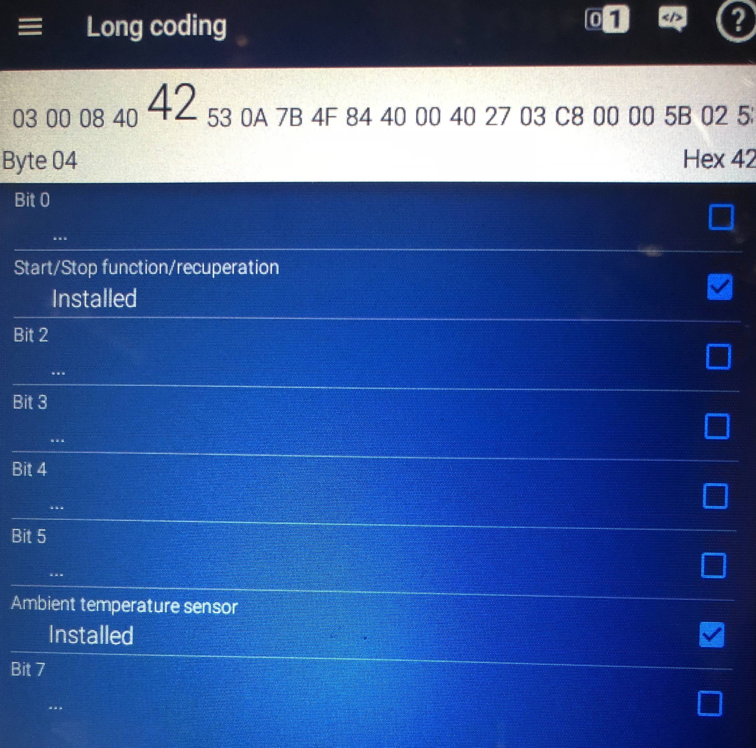

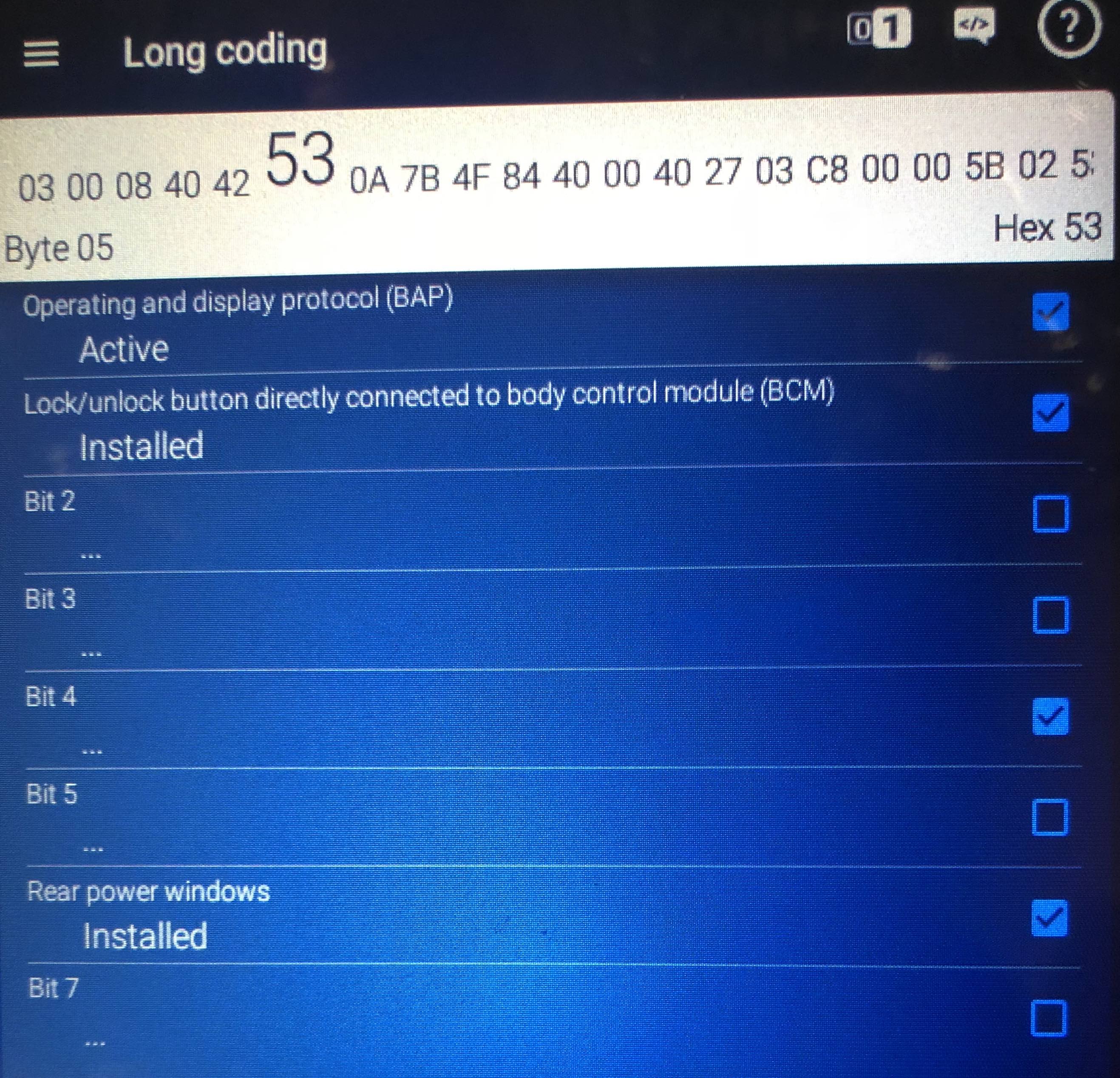

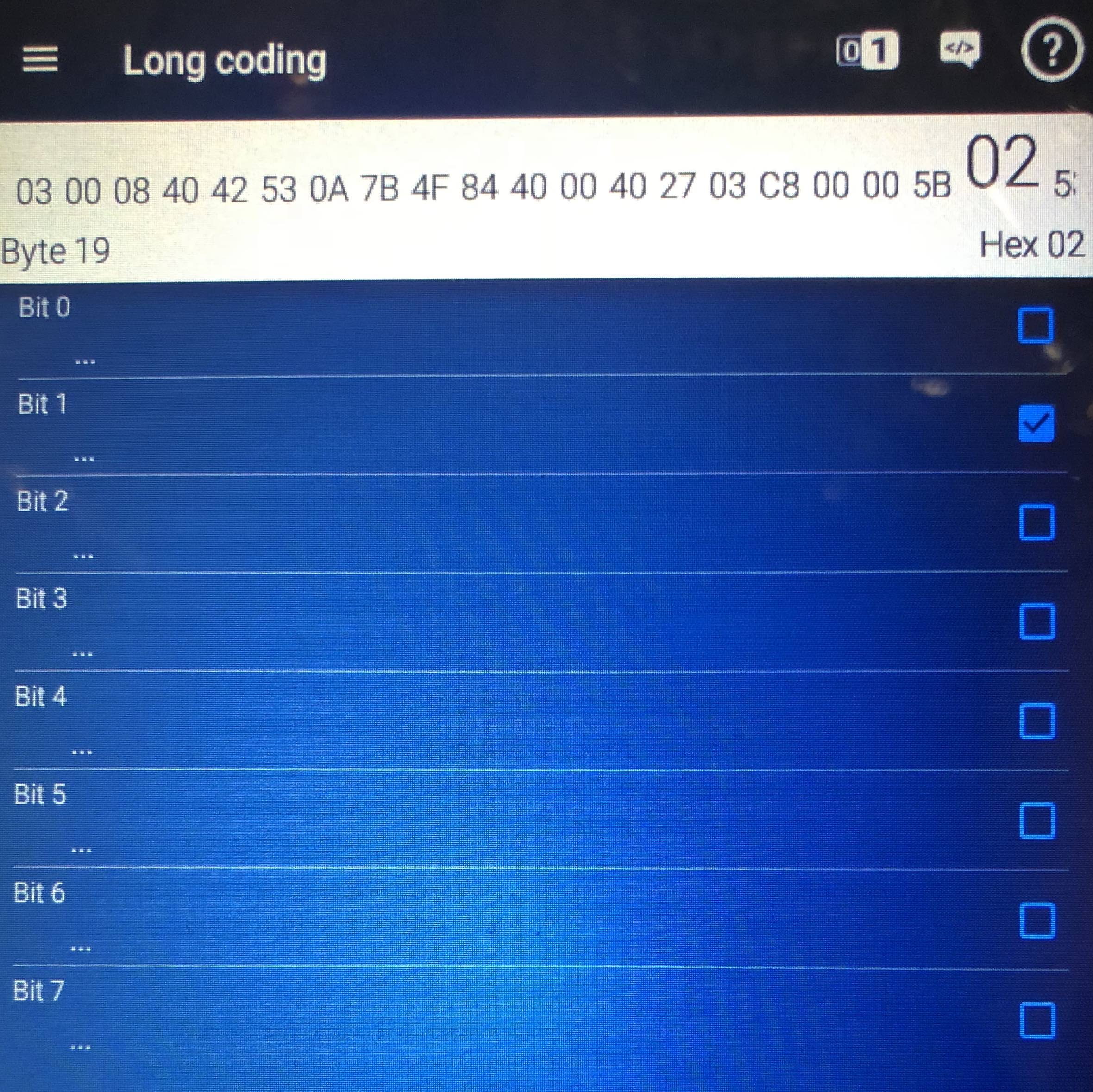

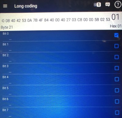

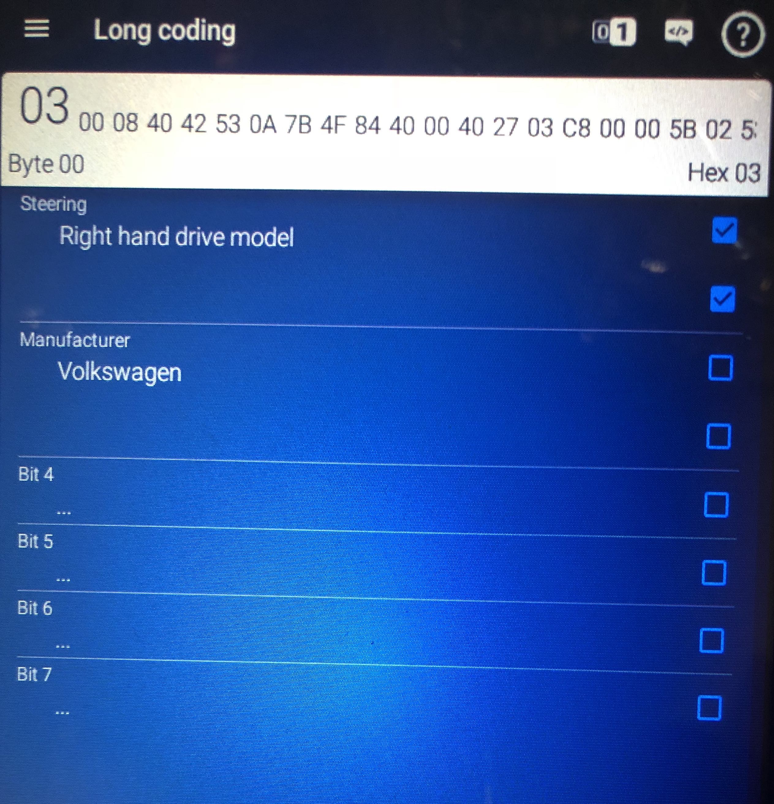

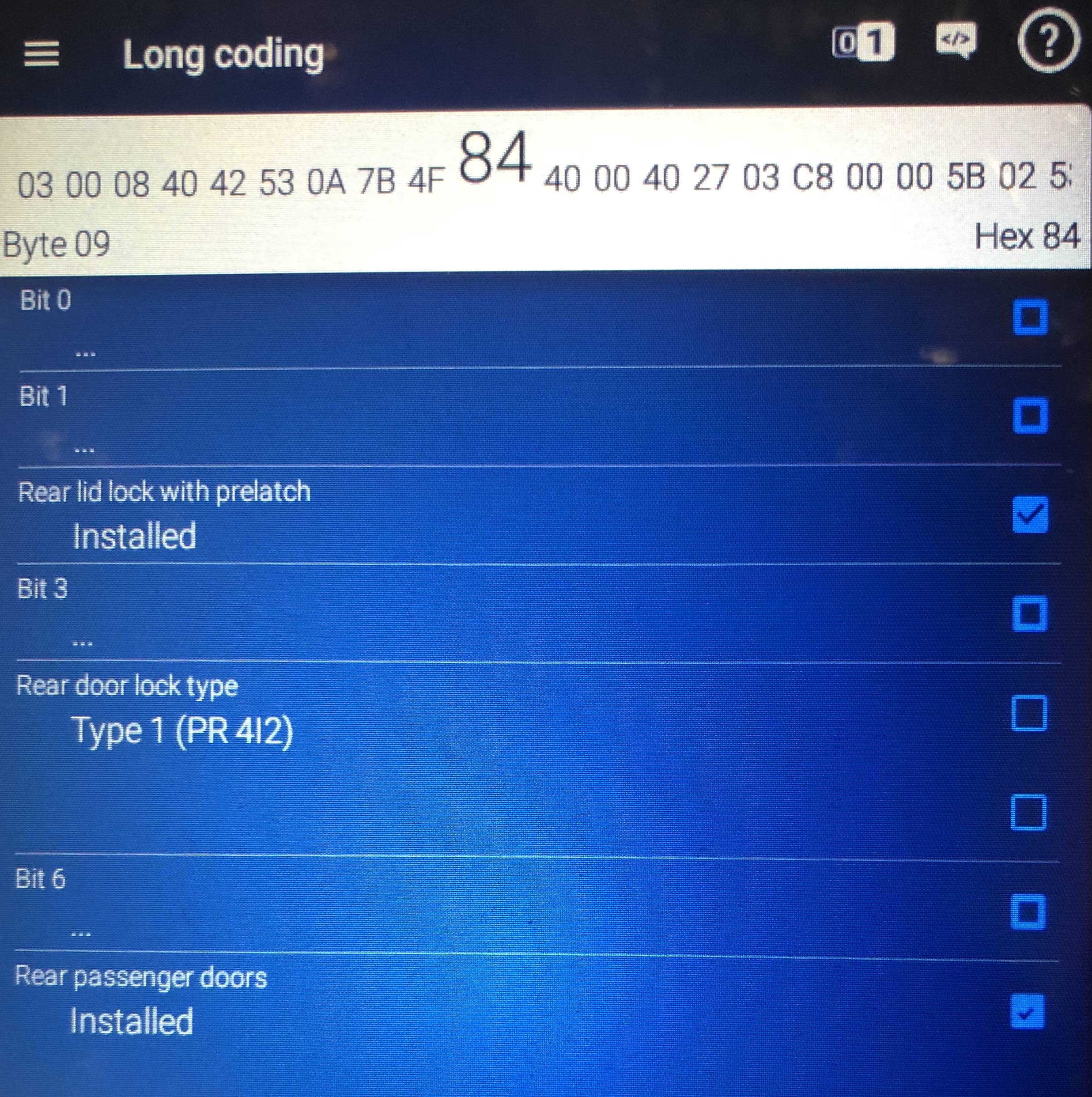

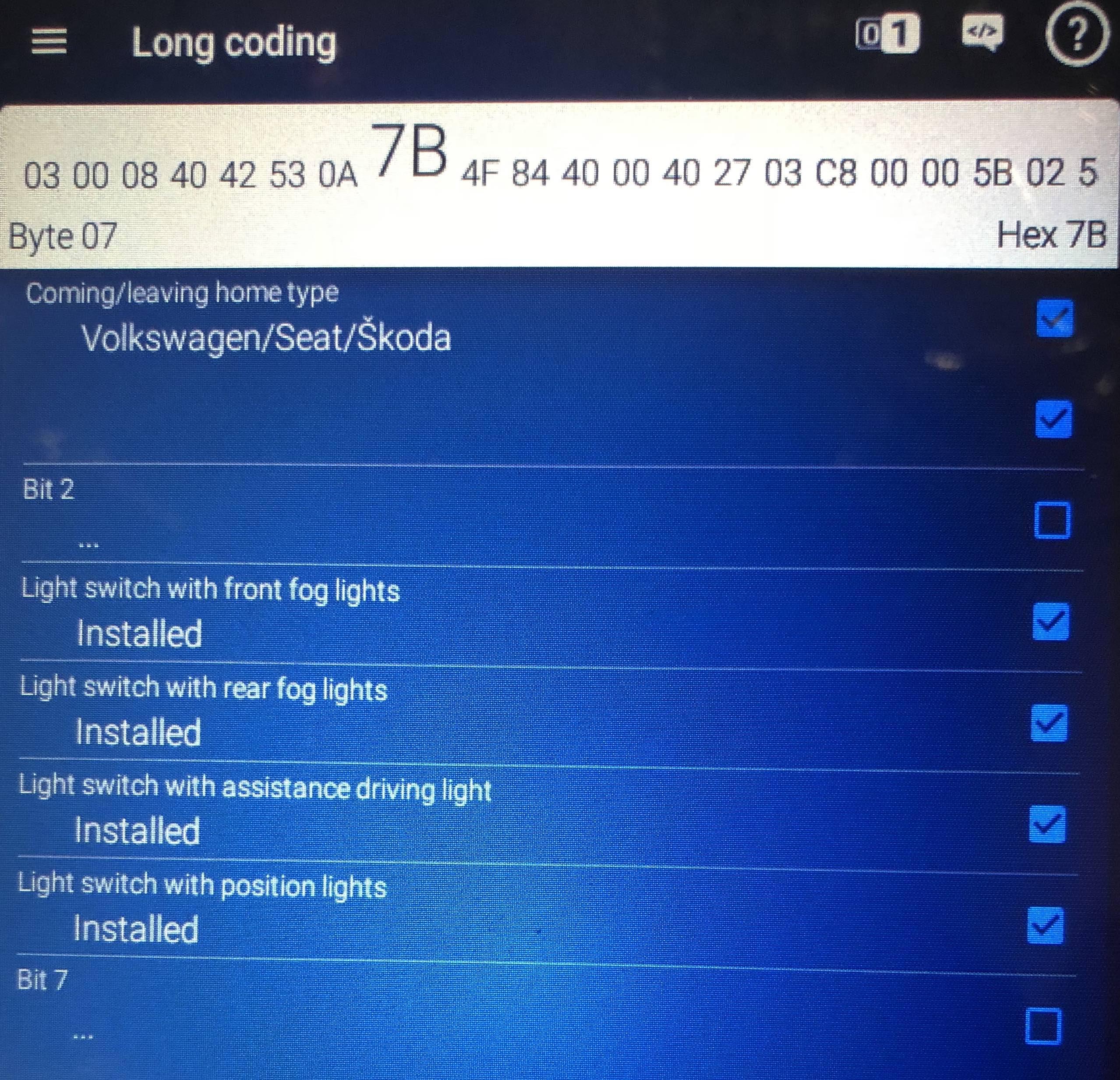

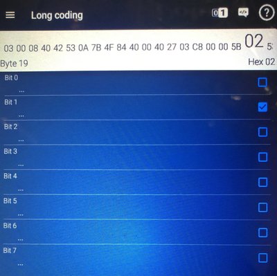

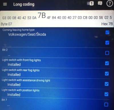

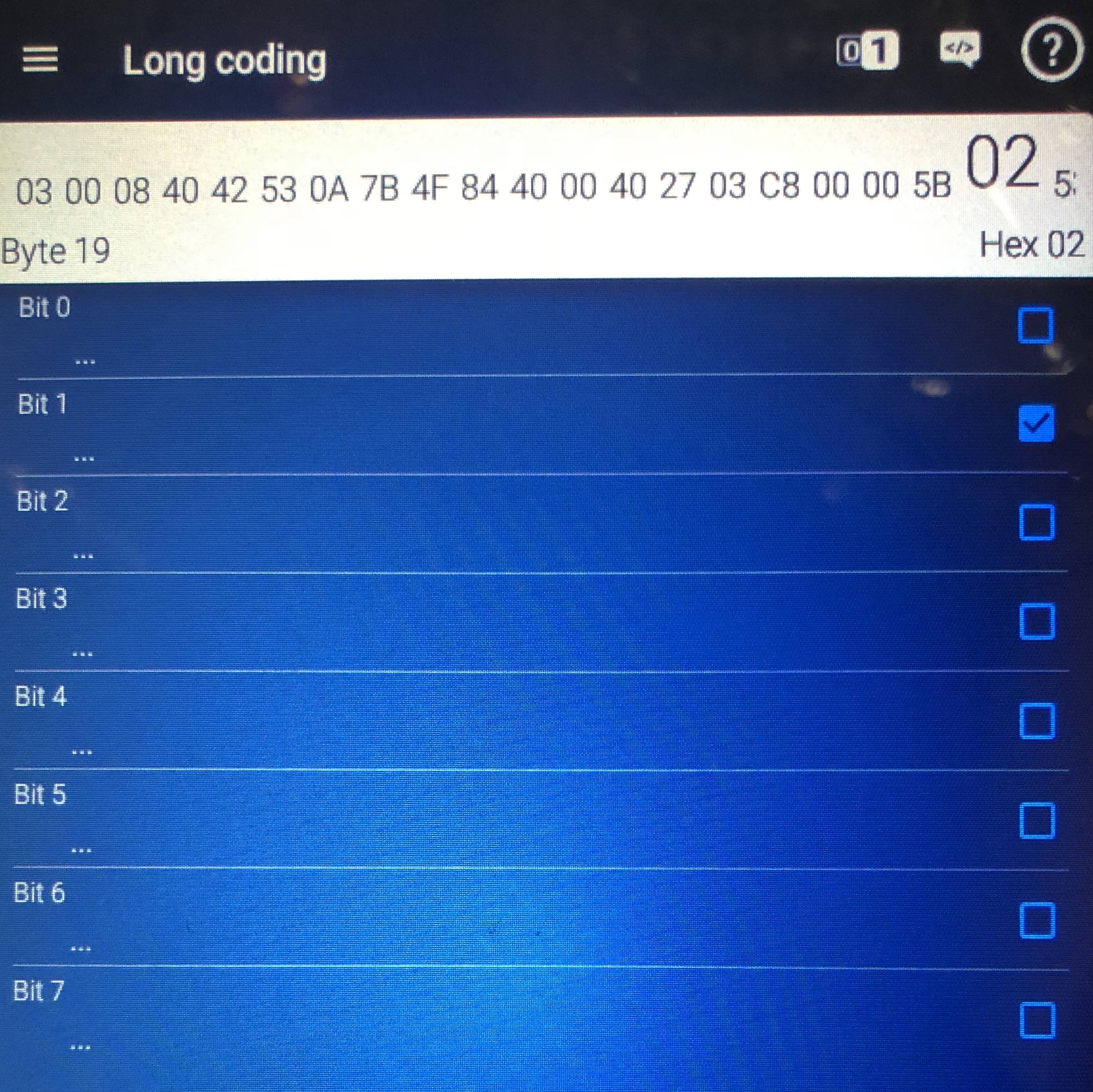

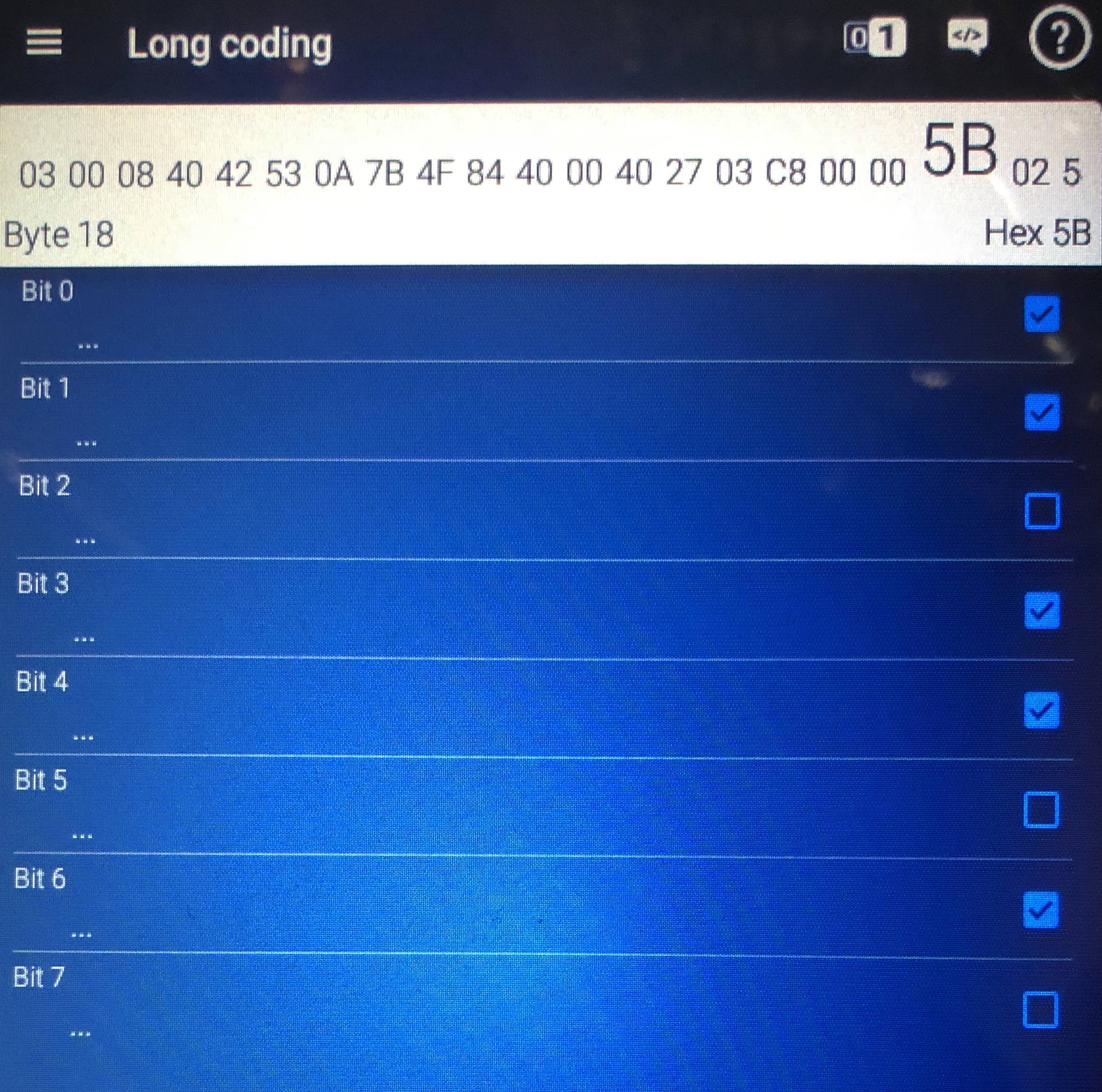

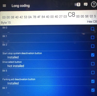

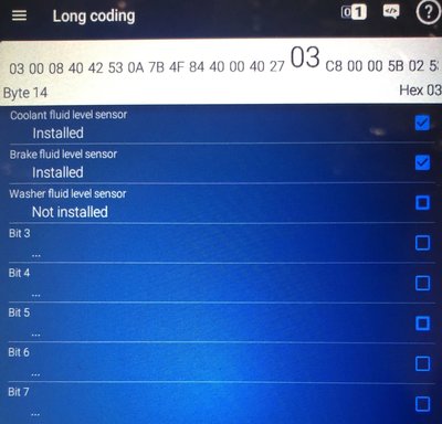

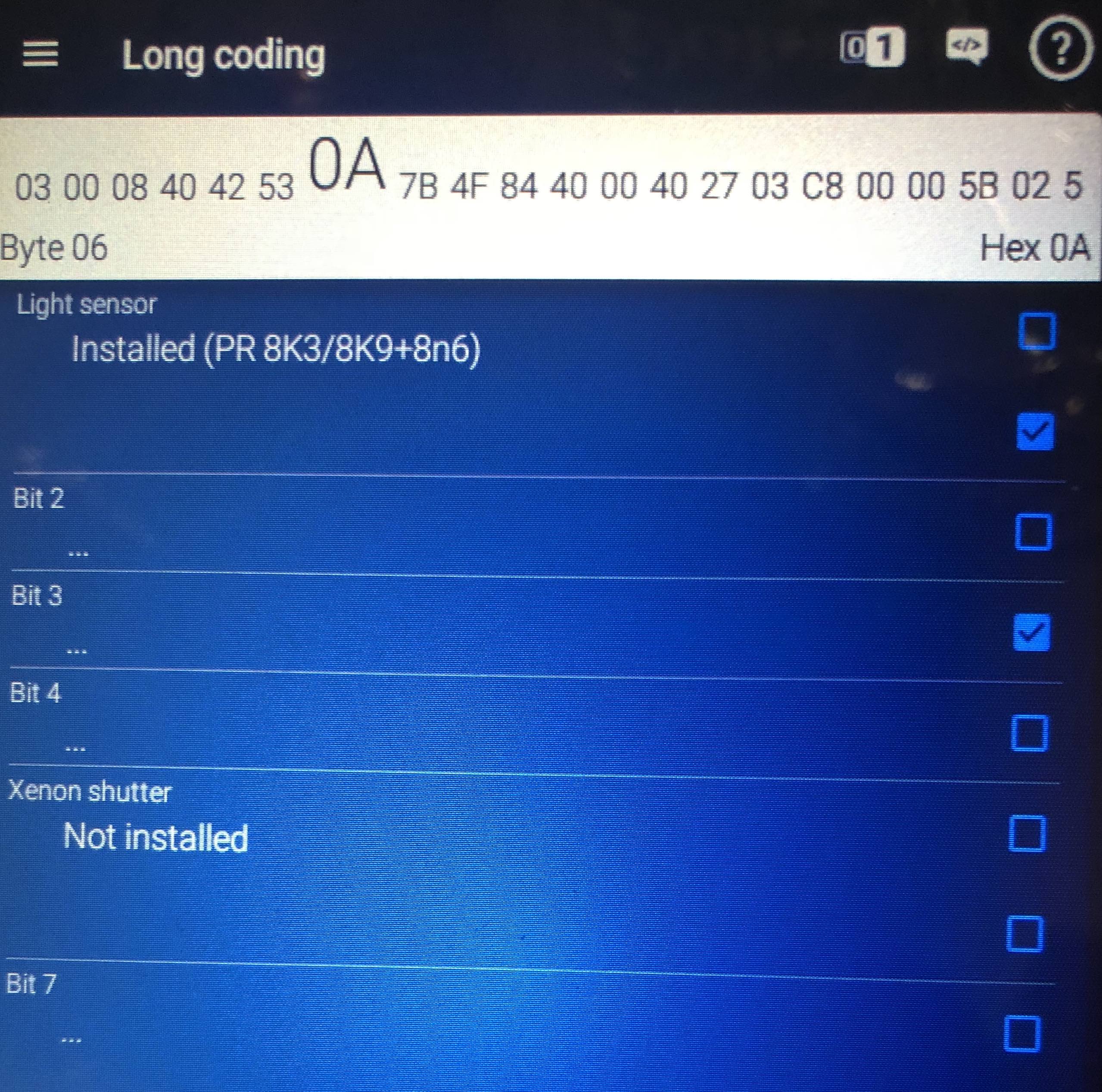

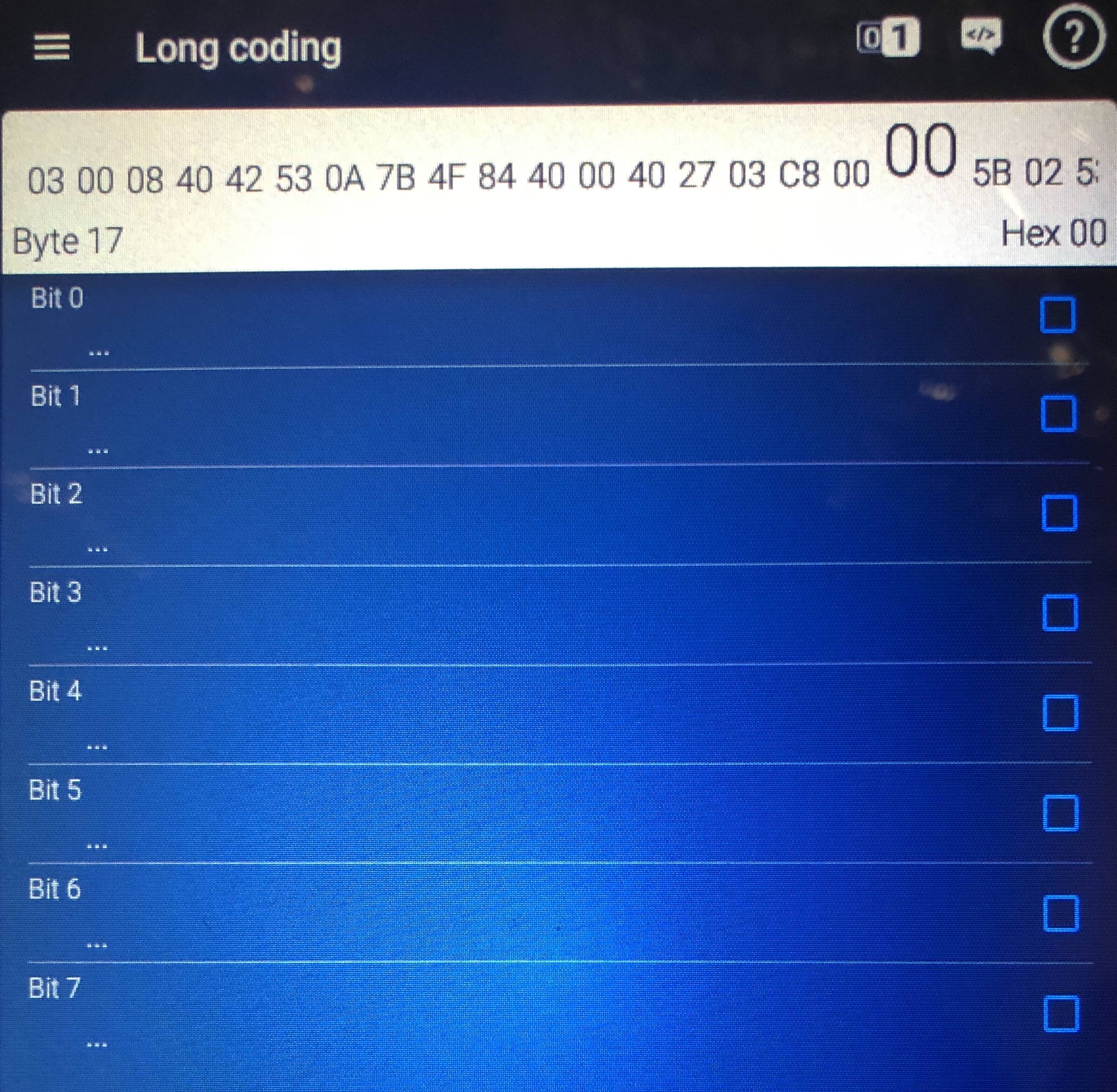

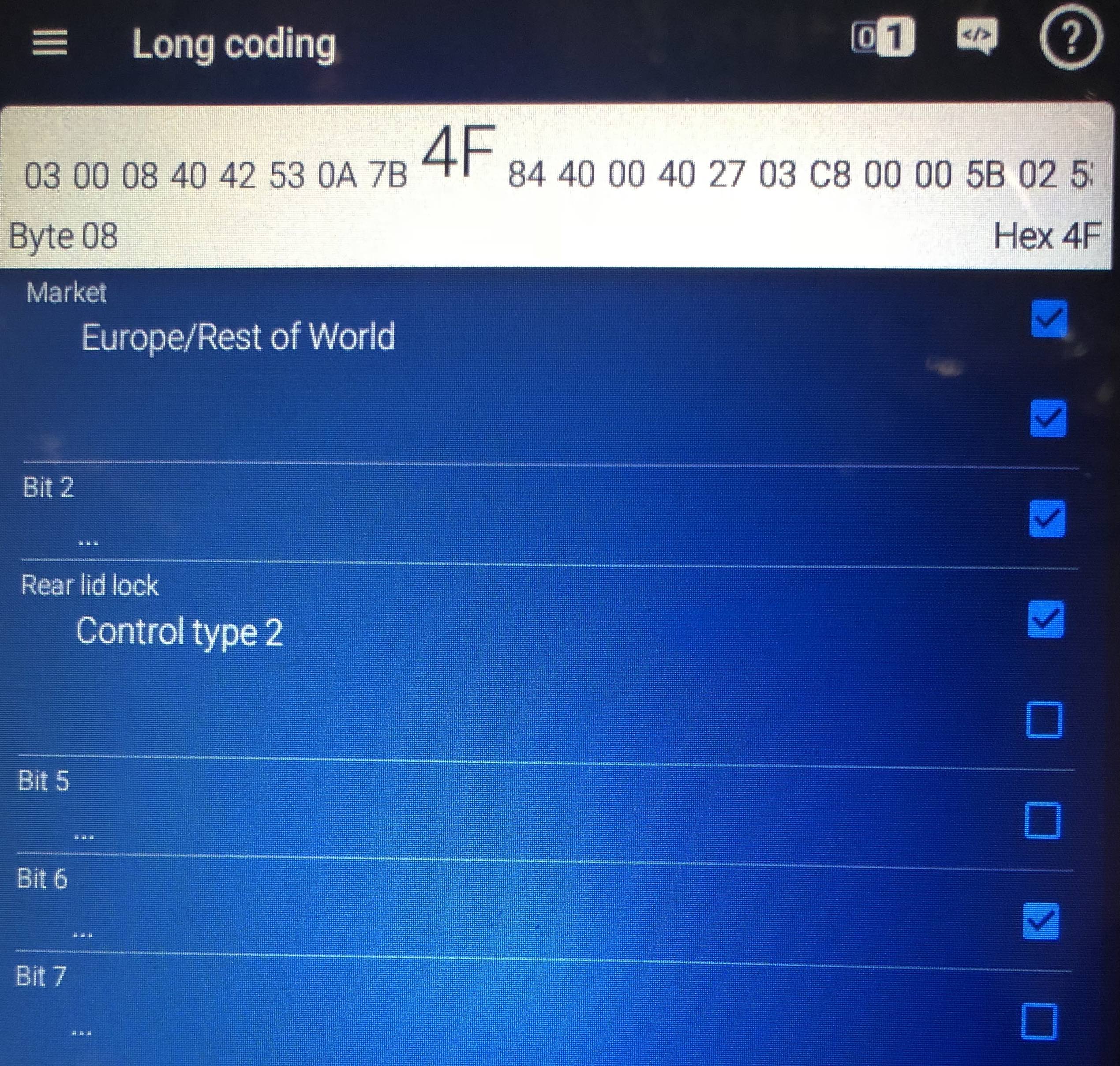

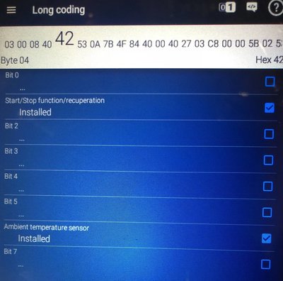

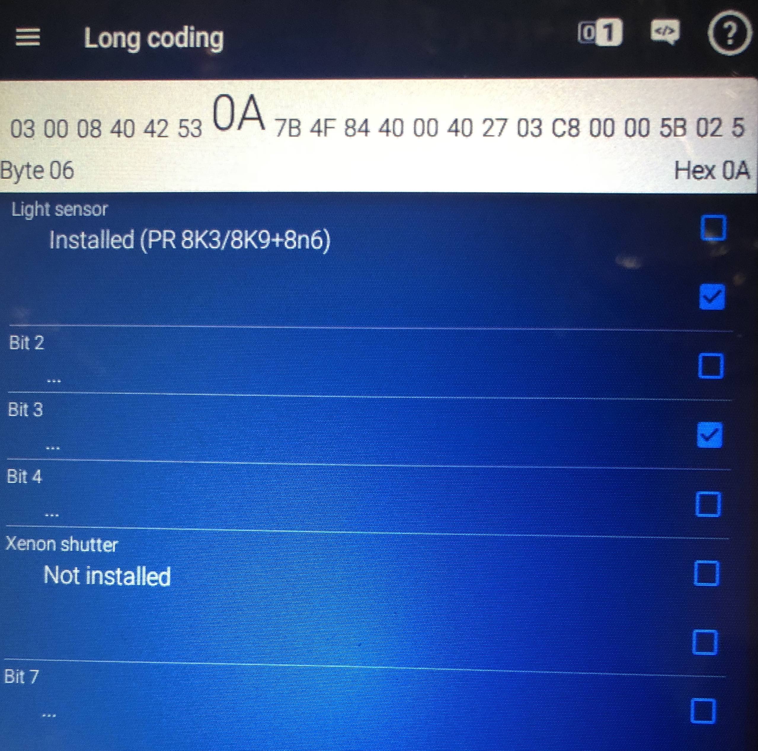

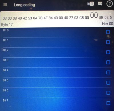

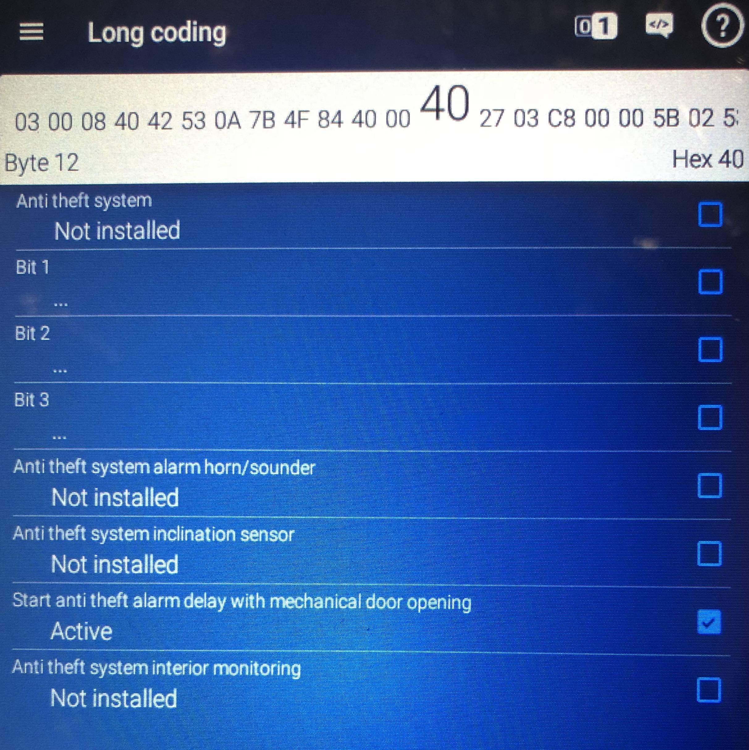

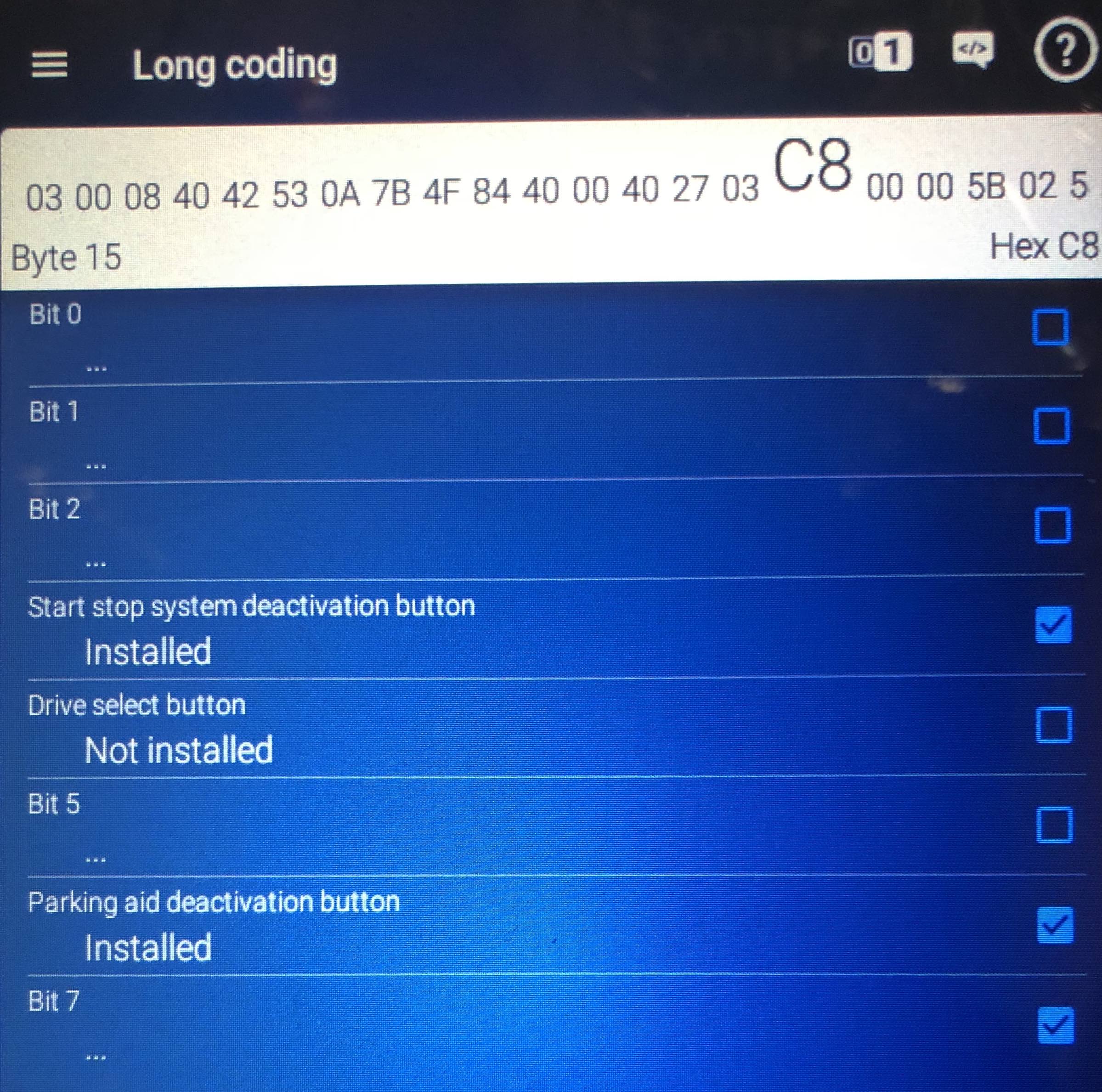

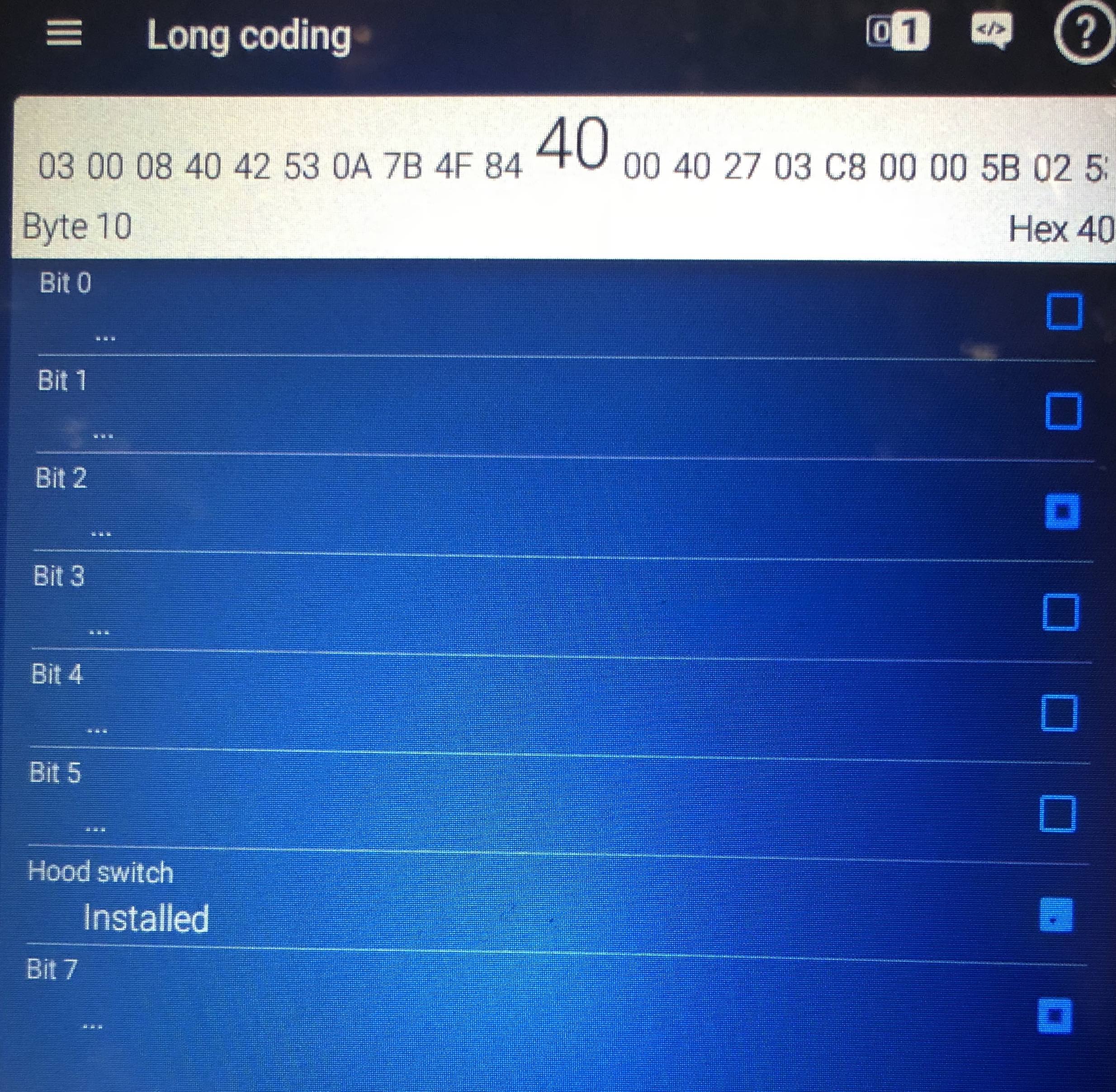

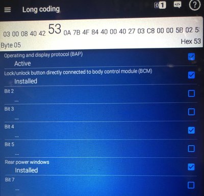

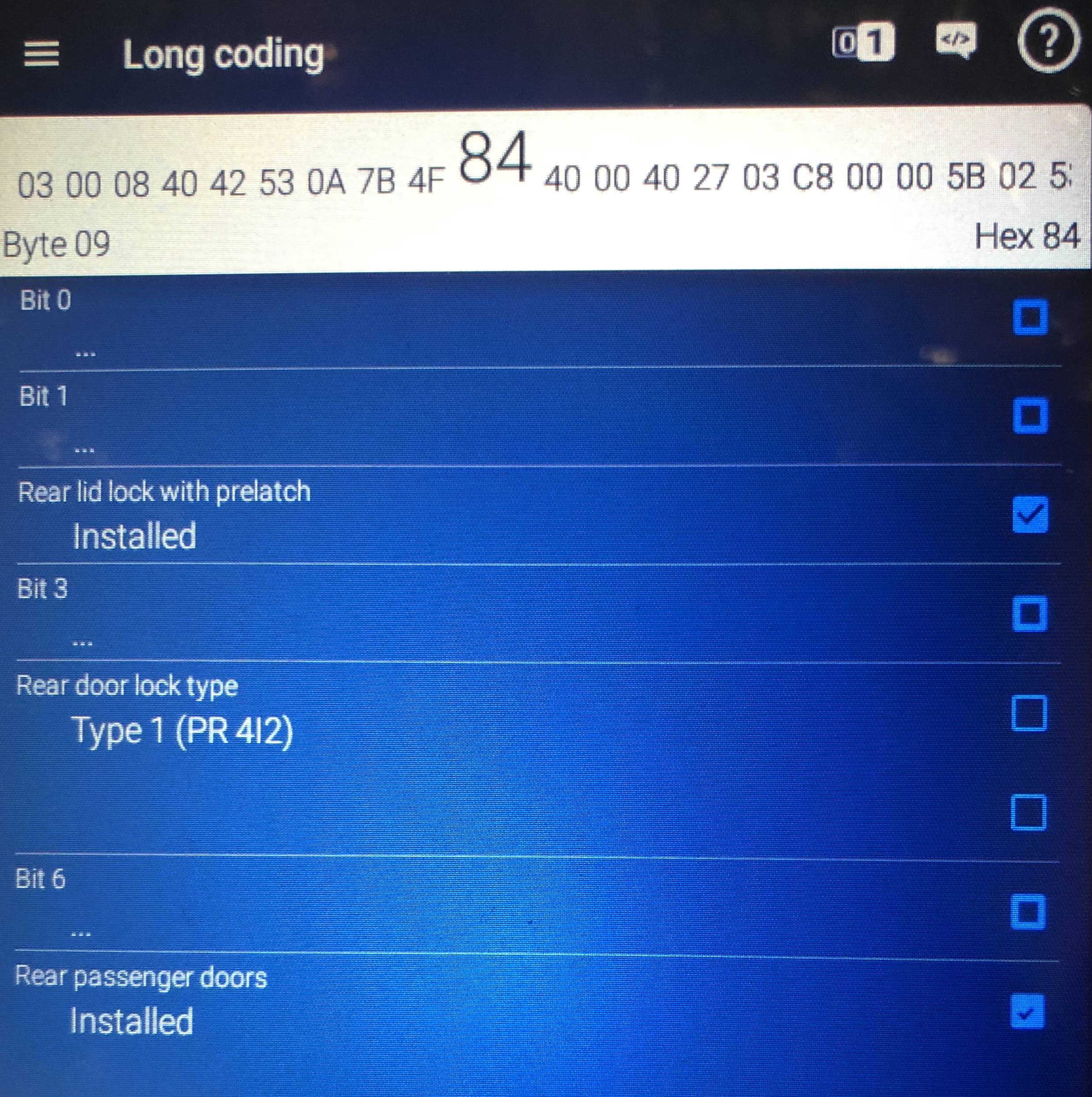

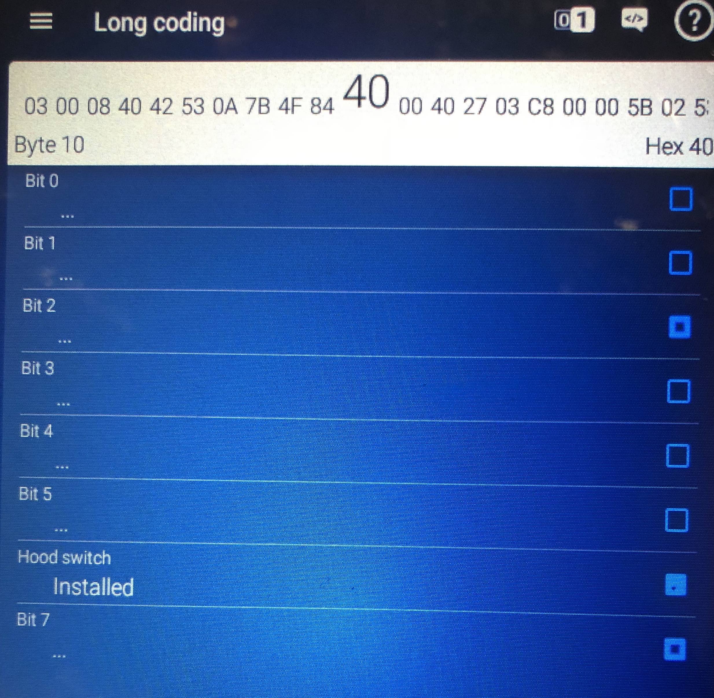

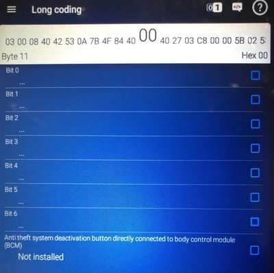

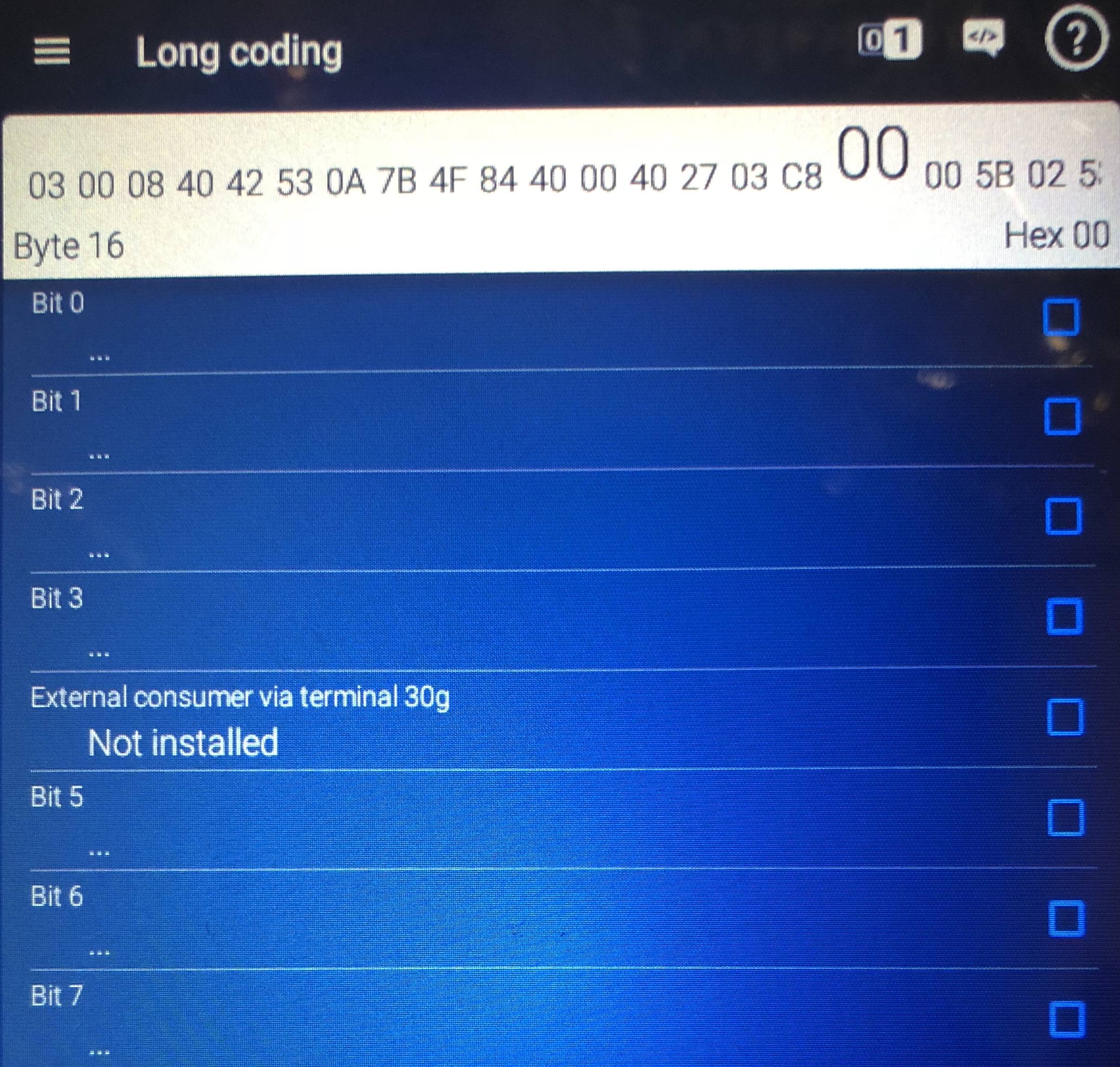

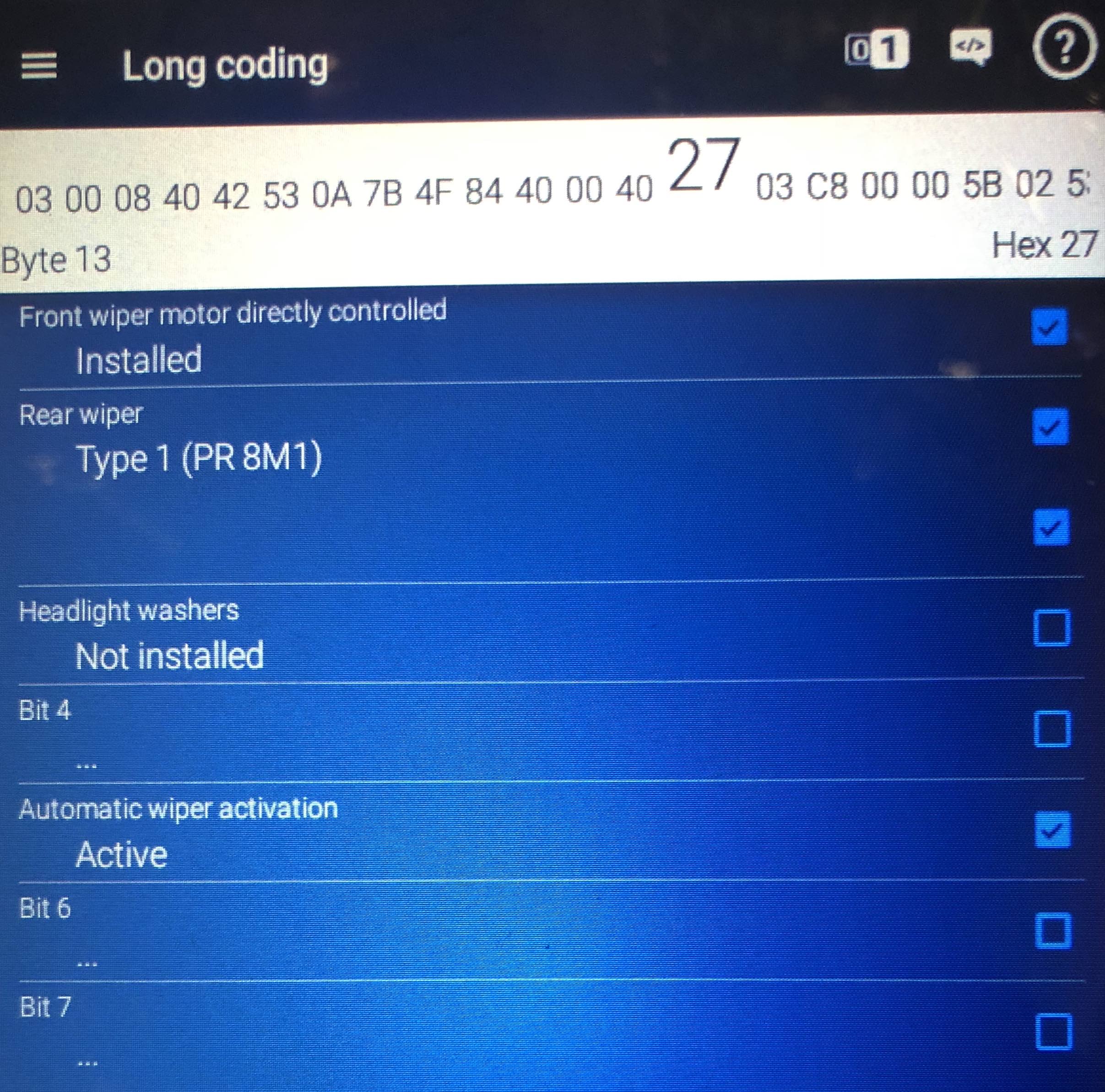

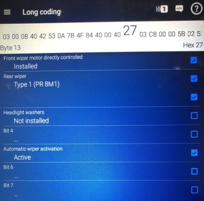

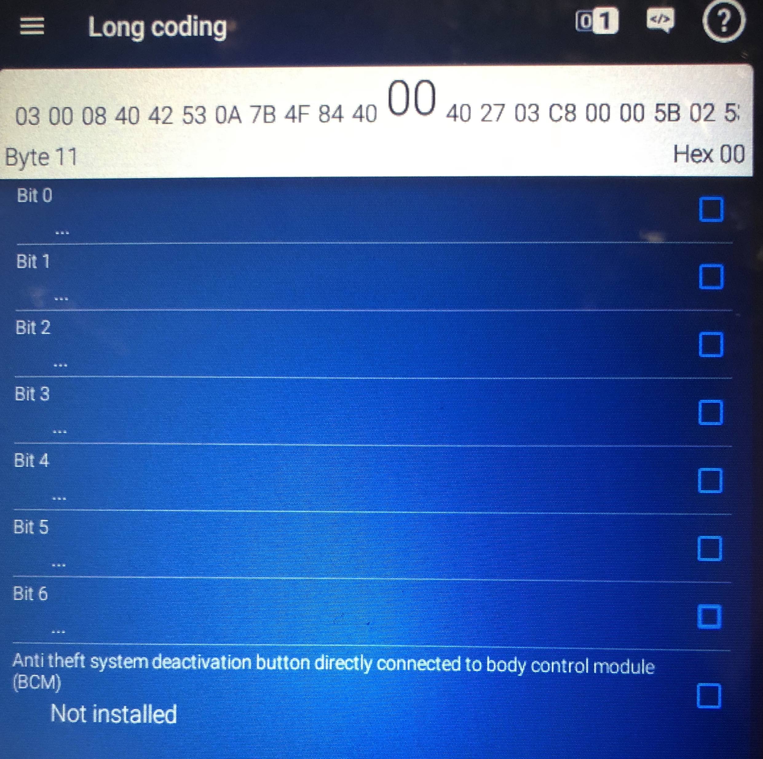

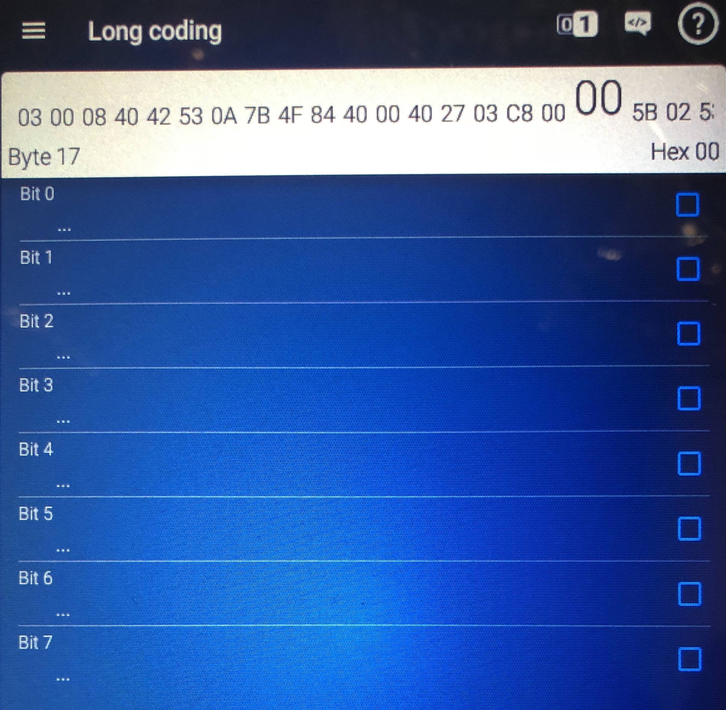

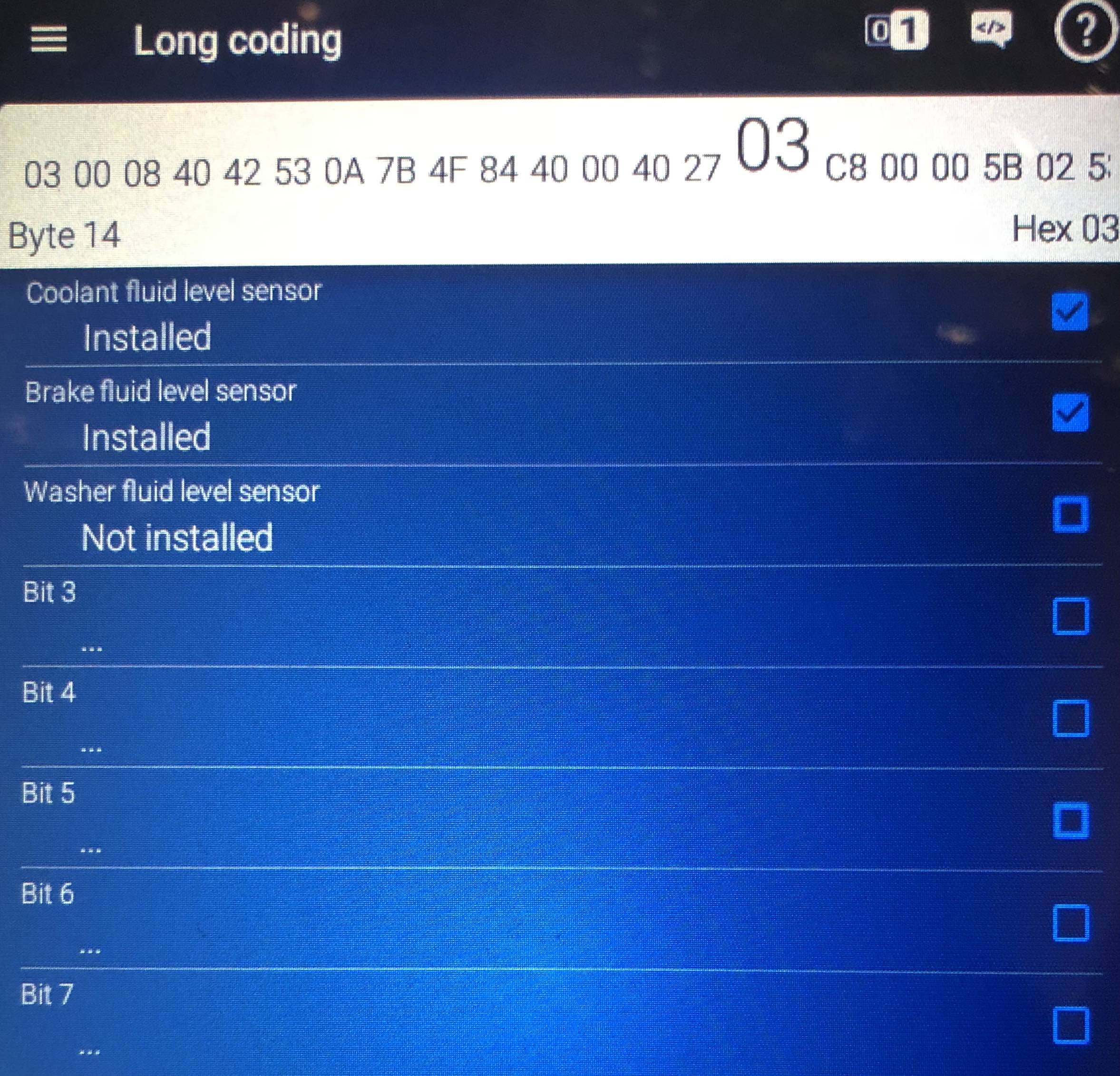

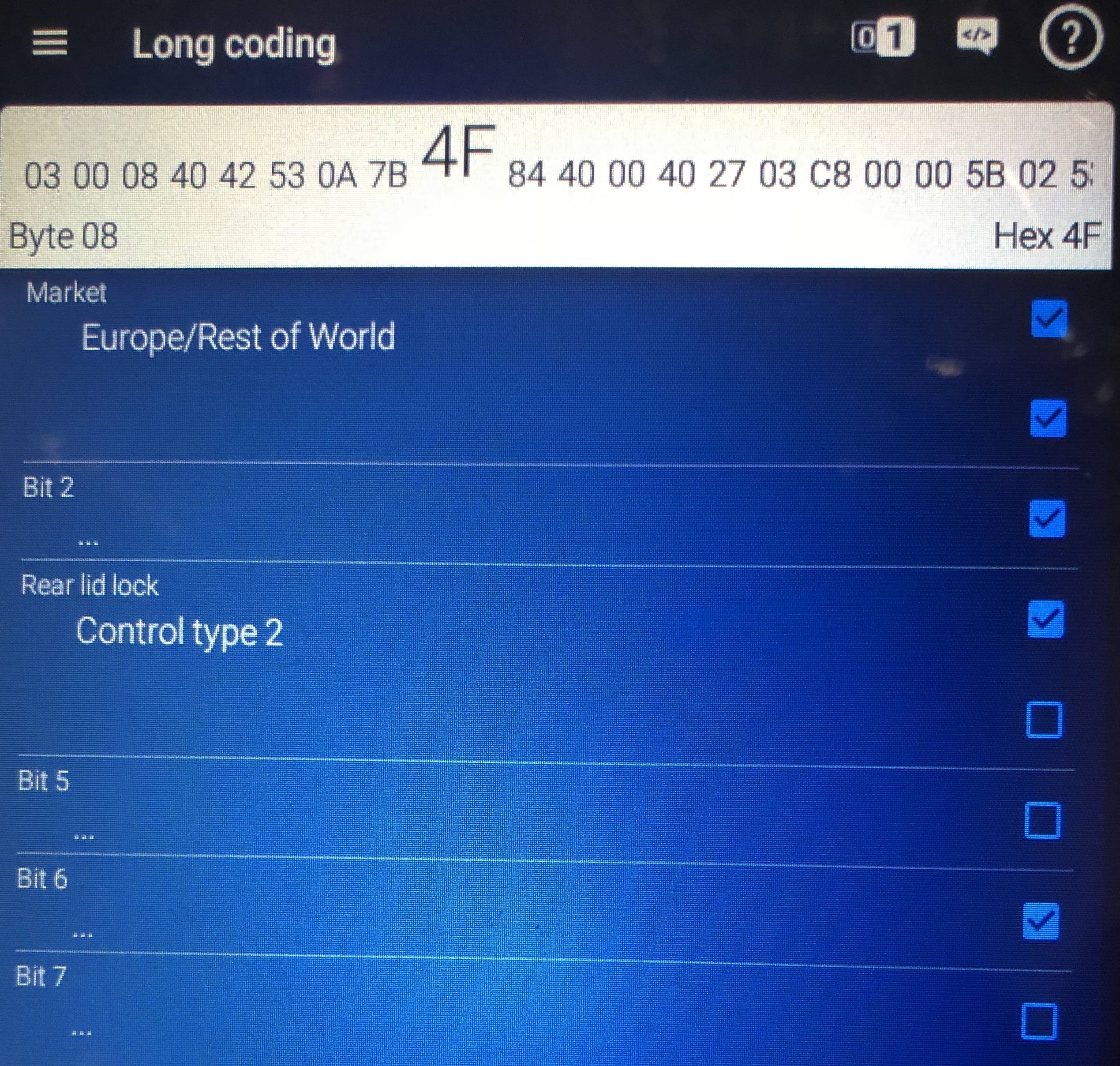

here are descriptions of bit coding for 09 central electric that i have:
massimo23
- Posts: 128
- Location: Ireland
and after this last byte the rest they are all set at 0.
