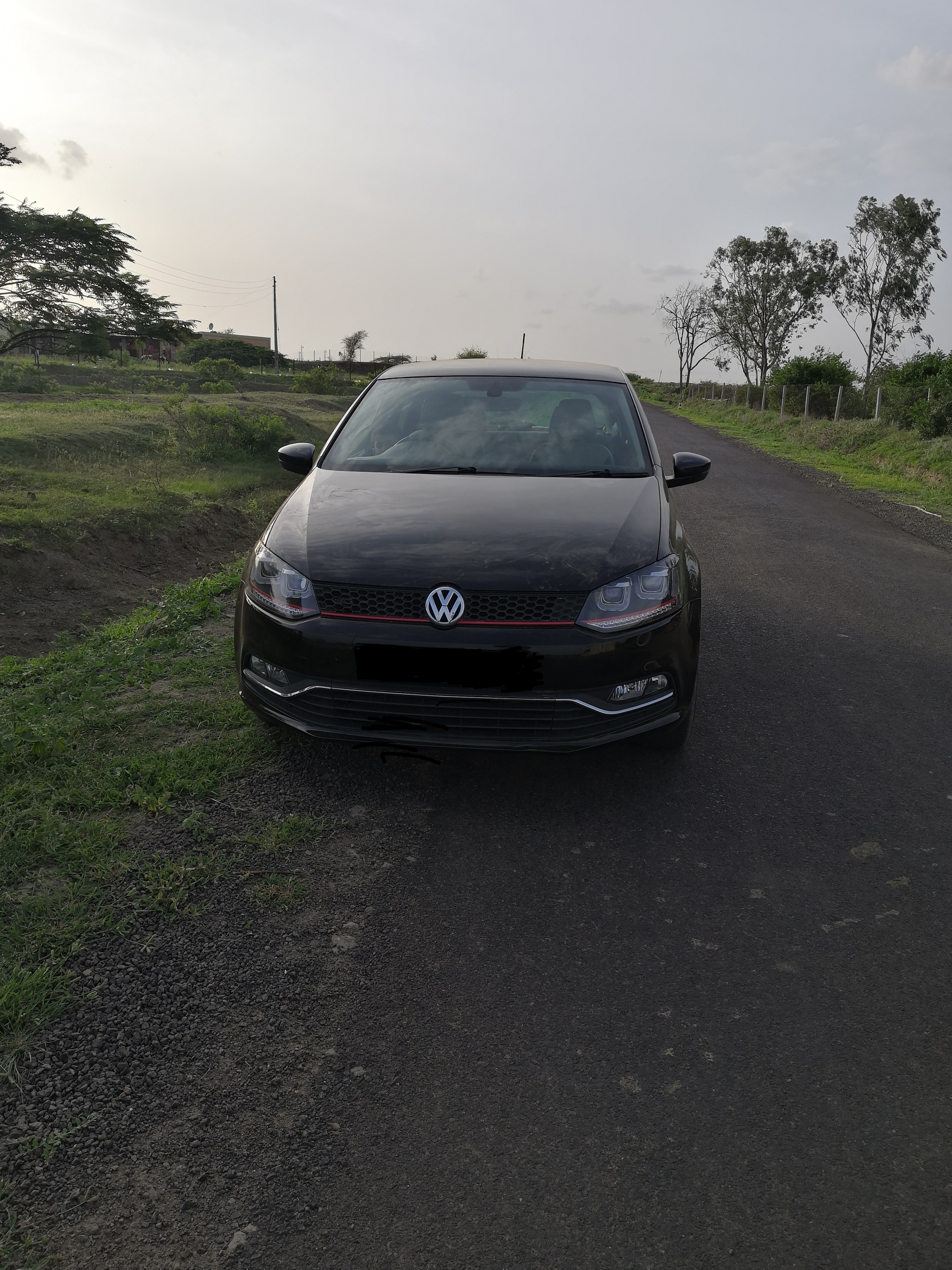

Ok thanks alot. Can you please share the part numbers of switch and dimmer? So it will be easy for me to find. Sending another pic of car. here it is.

Nice headlights, thank you for the picture of your Polo.

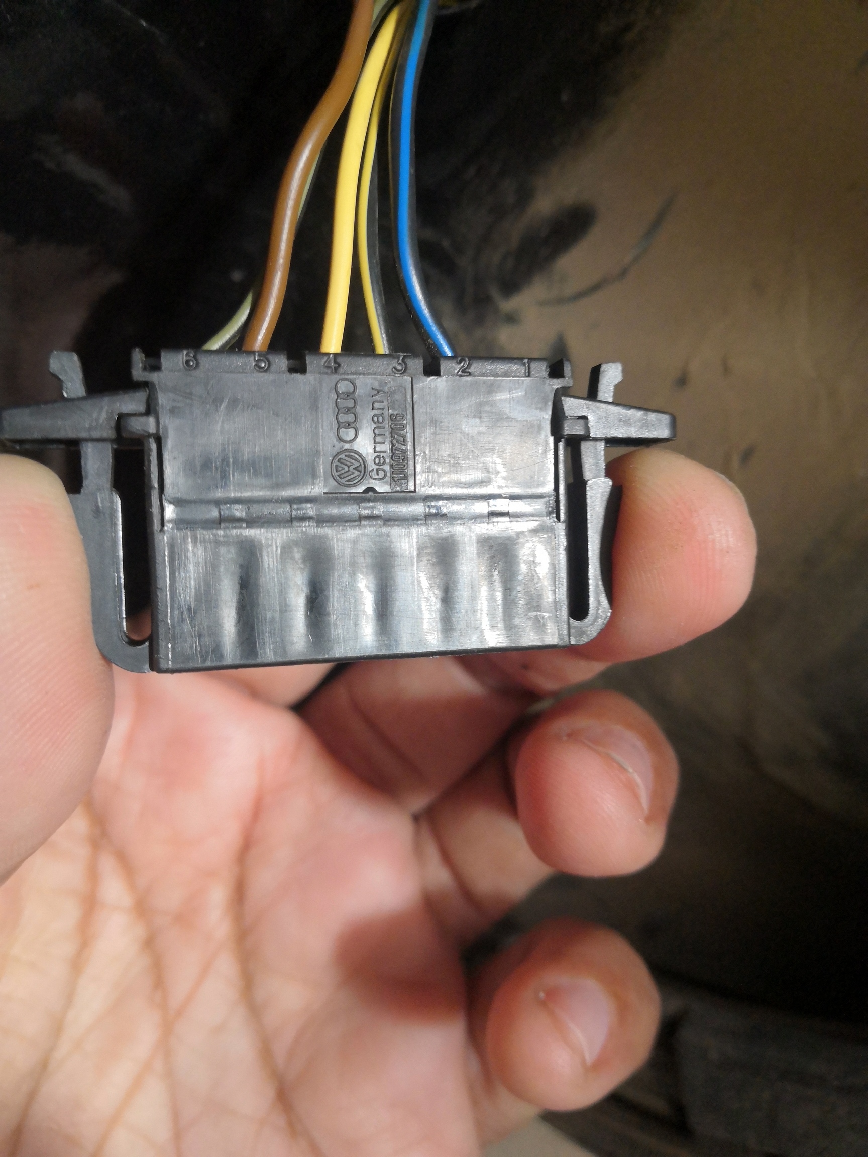

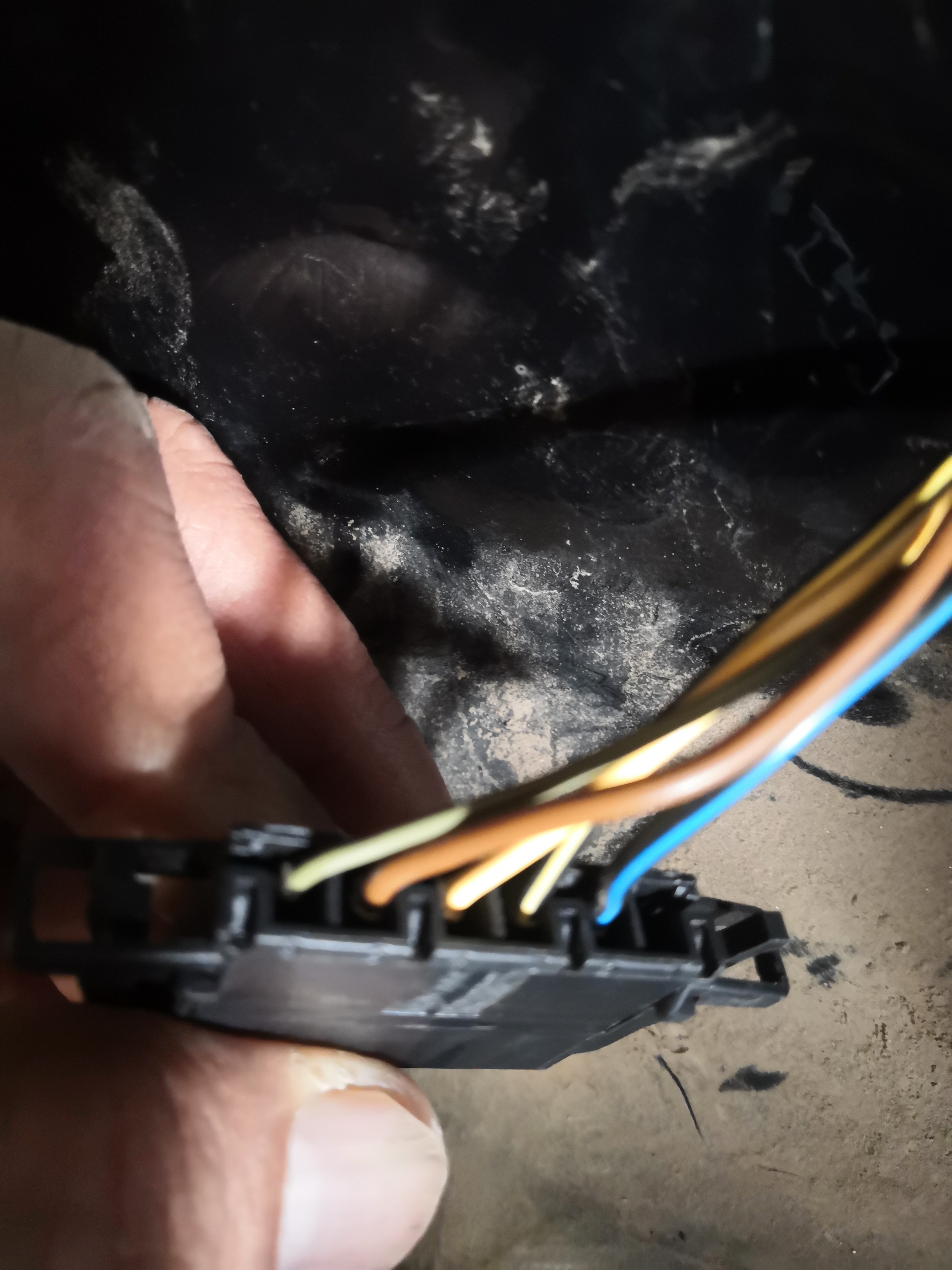

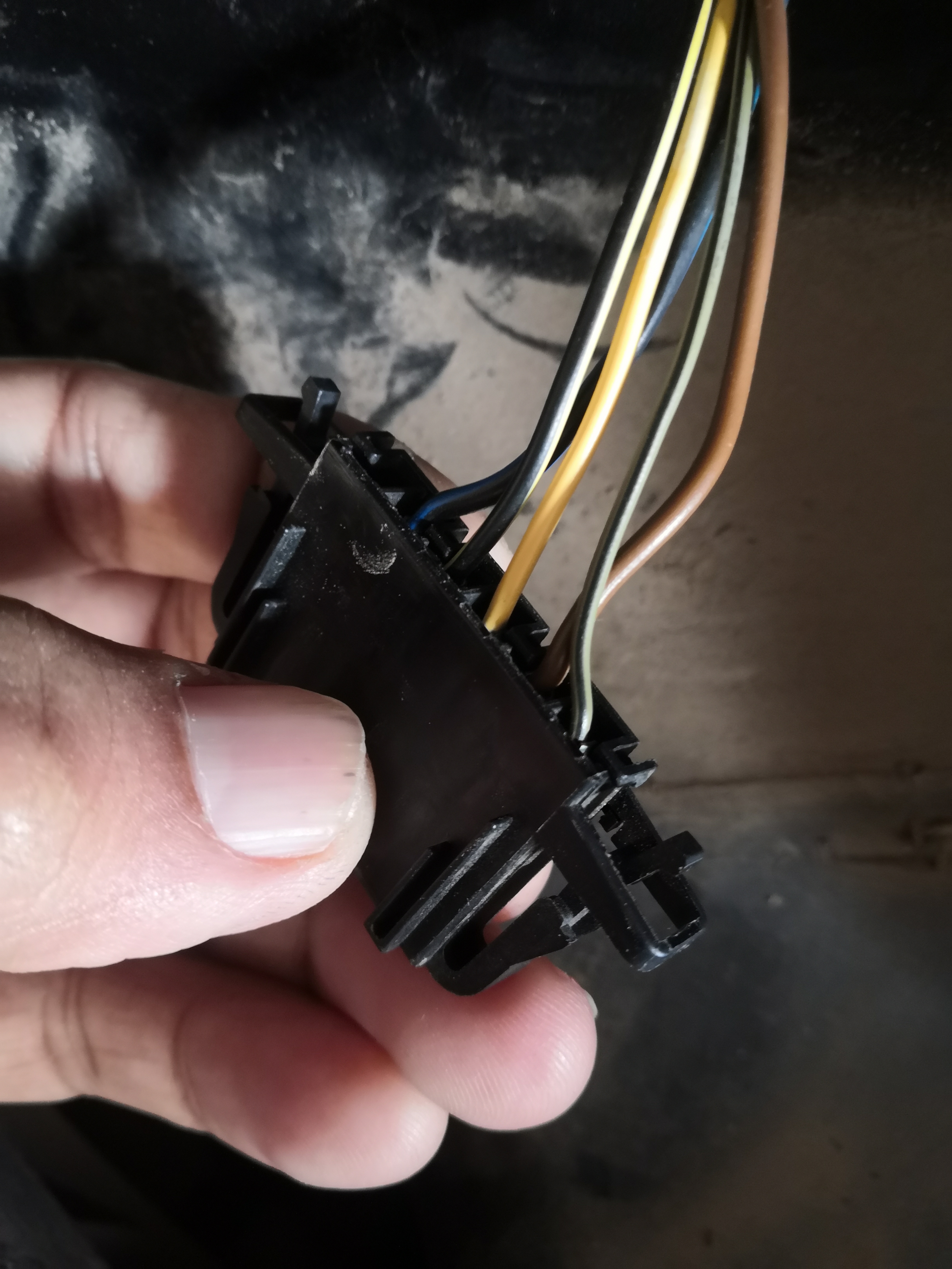

2-You must take a picture of the left taillight connector so I can see the colors of the wires and the connector model. It is related to the reversing light.
Please ASAP, thanks in advance!

2. I am sending you the tail light connector photos. they are attached below. please have a look.
sorry for attaching too many, i just wanted to provide a better view.
