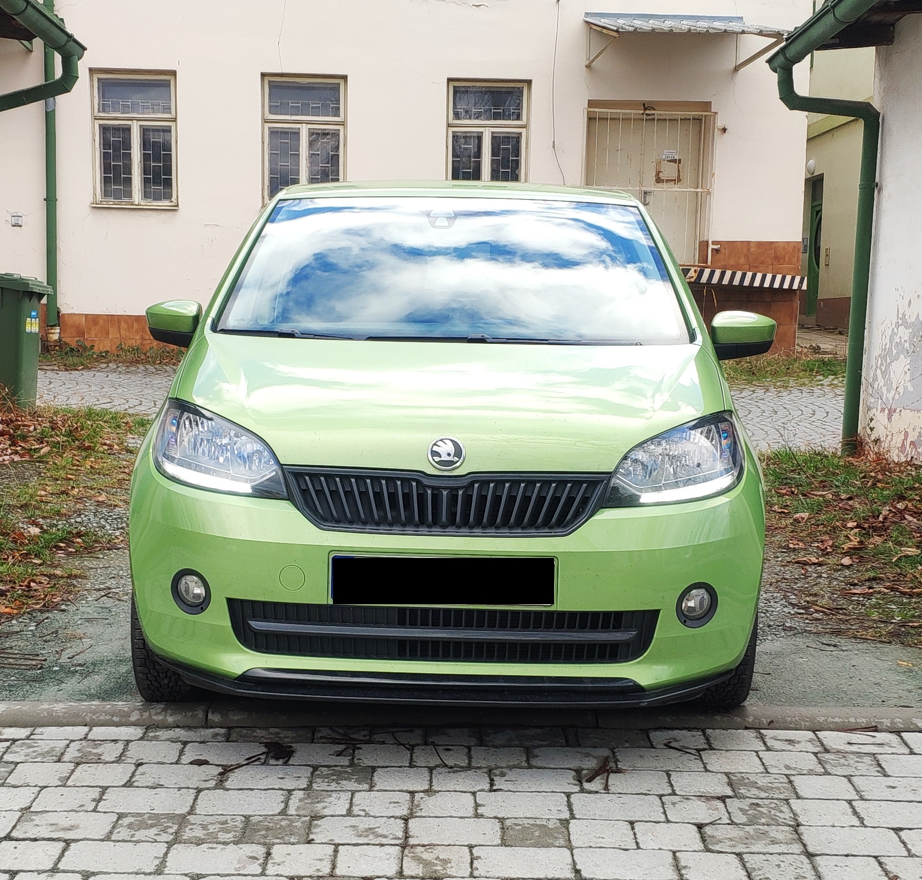

danikd wrote: Thu Dec 06, 2018 9:15 pm Seem sto be OK, man have to look at DLR from little distance ...
:? .. take a picture and show us here your new DRLs... please...

DLR seems to be OK ...

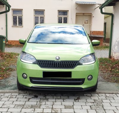

Main reason was light output - old H1 headlights - only low or beam was working ... New 2xH7 - both bulbs are lightning in highbeam, so its much better ... And they looks better ...
