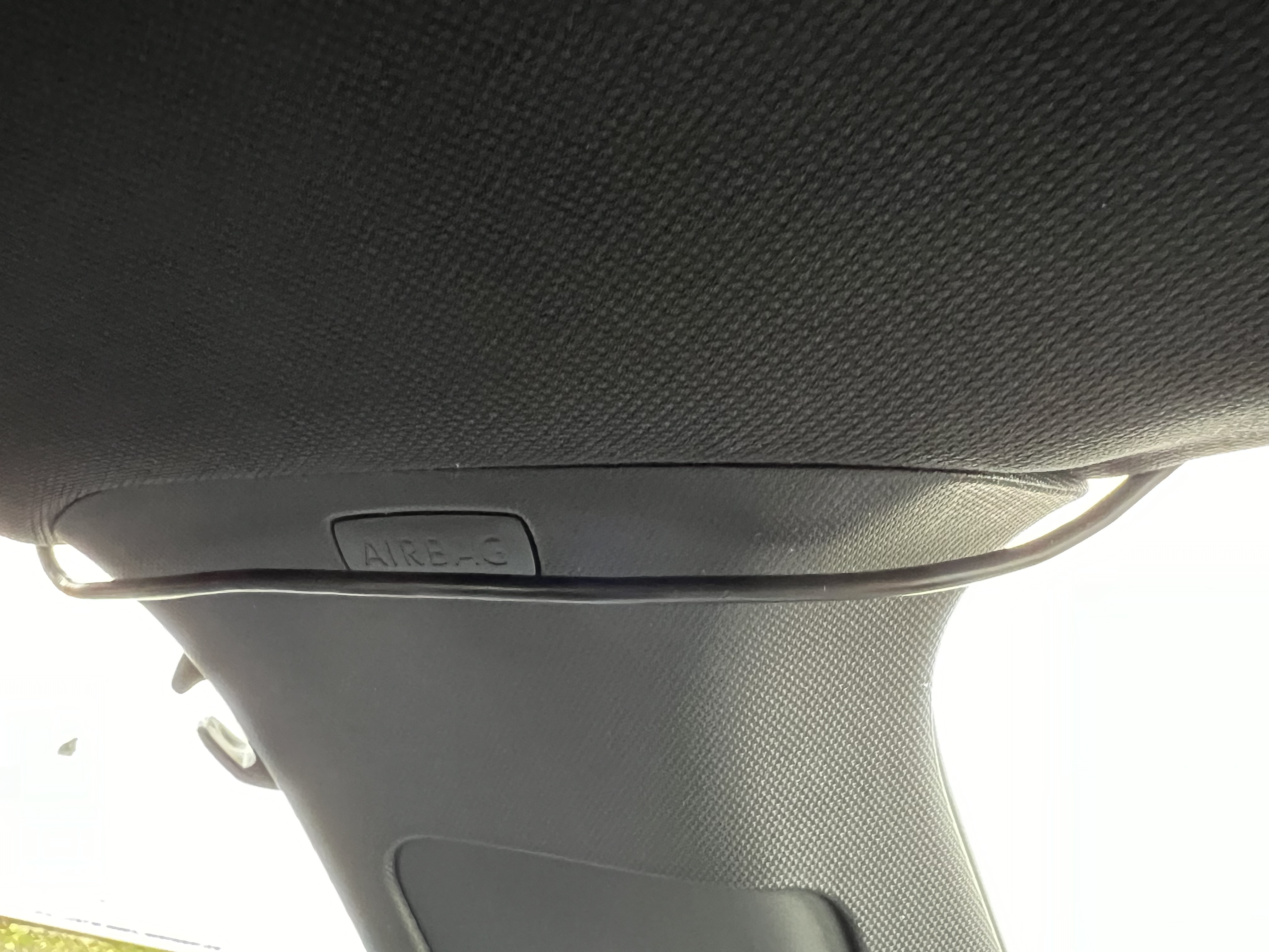

Posted: Sun Dec 31, 2023 3:24 pm
by Alex_p
I'm finally getting around to installing my rear dash cam, but having trouble routing the cabling around the top of the b-pillar. Photo attached. I just can't get it tucked in between the plastic of the pillar and the roof lining.
Any tips at all? I don't want to leave it hanging like this. And I'm guessing having it hanging in front of the airbag like this would be problematic if the bag deployed.
Is it possible to easily unclip the pillar trim to get the cable properly in behind?
