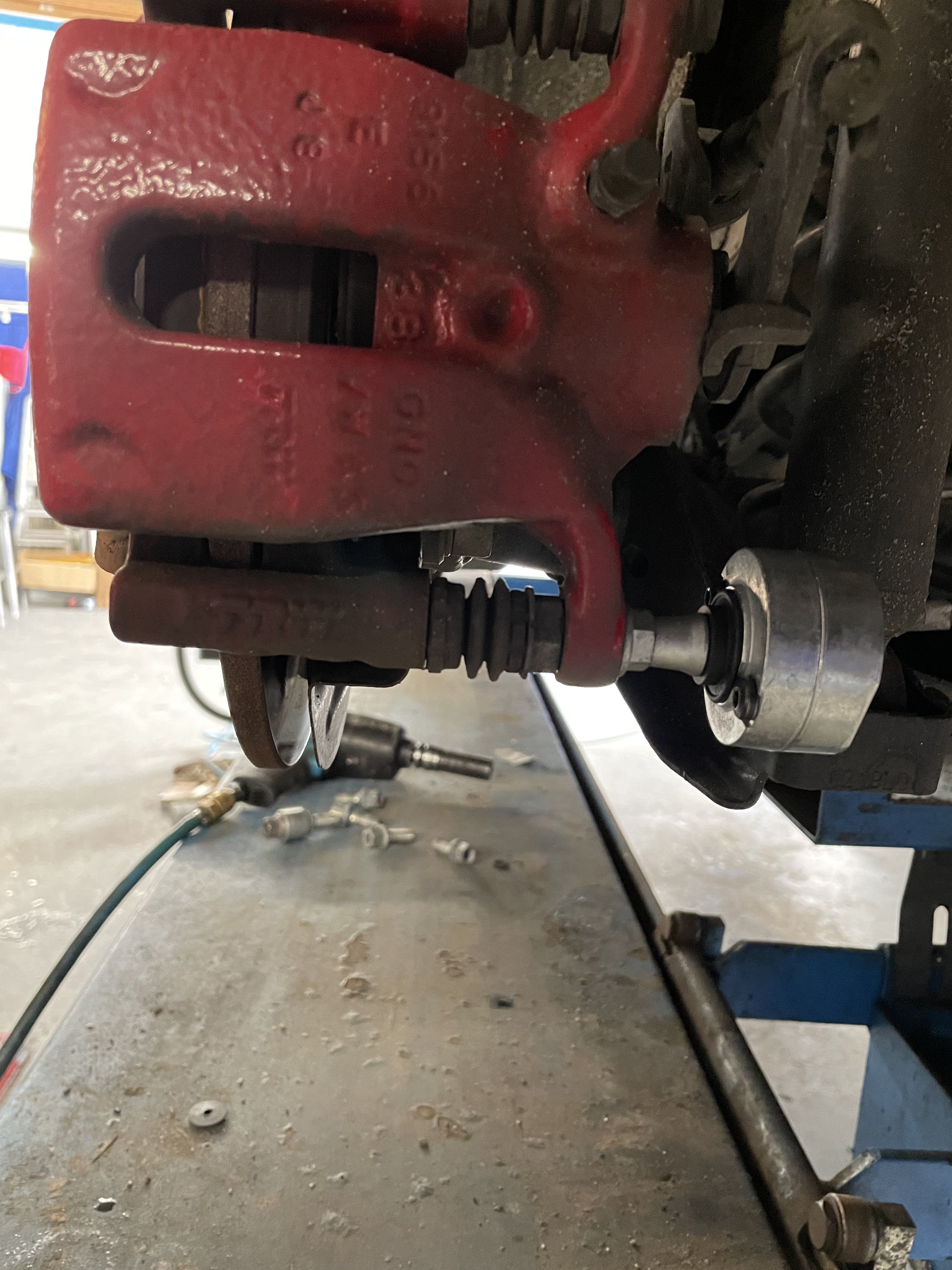

This is a very common complaint. As I understand I am one of the very lucky ones not having this problem. In the Netherlands some have resolved the issue by having placed some demper at the breaking disks.
This is what you'll need: 2x 2Q0615413 trillingsdemper en 2x WHT010011 spec. boutje
And this what it looks like:

@Richard kinver; If you Google ‘mk7 and mk7.5 golf leaking thermostat housing and water pump failure’ you’ll see this is a cause of coolant loss (and quite common) with the Golf GTI and R models which also have a version of the 2.0 EA888 petrol engine. With the Golf, there have been cases where there aren’t any visible signs of a leak.
Have you had the dealer pressure test your car’s cooling system? Are you able to smell coolant when the engine’s hot and the cooling system is up to pressure? Replacing the thermostat housing / water pump is a quite an expensive job (I’ve seen figures of £750+ quoted on forums for the Golf), so I’d be getting the dealer to investigate whether or not this is the cause of the coolant level drop in your car. At least that way if this is the issue, there’ll be a record on VW’s system to show that this problem occurred within the warranty period so you shouldn’t have to pay for it to be replaced.
@Rosinfield; the issue that @Richard kinver and @Stuart_Rendall have seems to be squeaking / knocking rear suspension, rather than the moo-ing noise from the rear brakes, although it’s possible that they also have that issue with their cars too. On the subject of moo-ing rear brakes, it seems to have gone very quiet on the forum on this issue considering the number of forum members whose GTI’s had this issue. I’m wondering if it’s just stopped happening, if owners have just learned to live with it or if they’ve had the dampers / weights fitted to their rear brake assemblies?

Rosinfield wrote: Fri Apr 16, 2021 5:50 am This is a very common complaint. As I understand I am one of the very lucky ones not having this problem. In the Netherlands some have resolved the issue by having placed some demper at the breaking disks.
I managed to find some shop from which I can order those parts, but before that, do these fit any GTI 2018+? Mine is 2020
