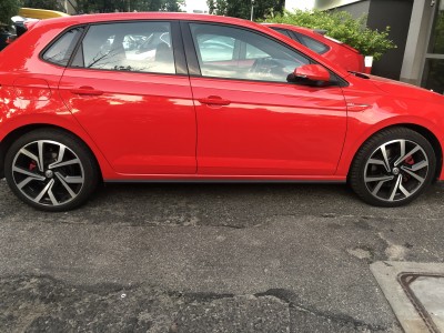

Re: 215-40-18 or 225-40-18 tyres on Polo GTI
Missed your post earlier on...
But here it is.
An unusual picture
Front 225/40/18 Michelins PS4, rear 215/40/18 Bridgestone T001

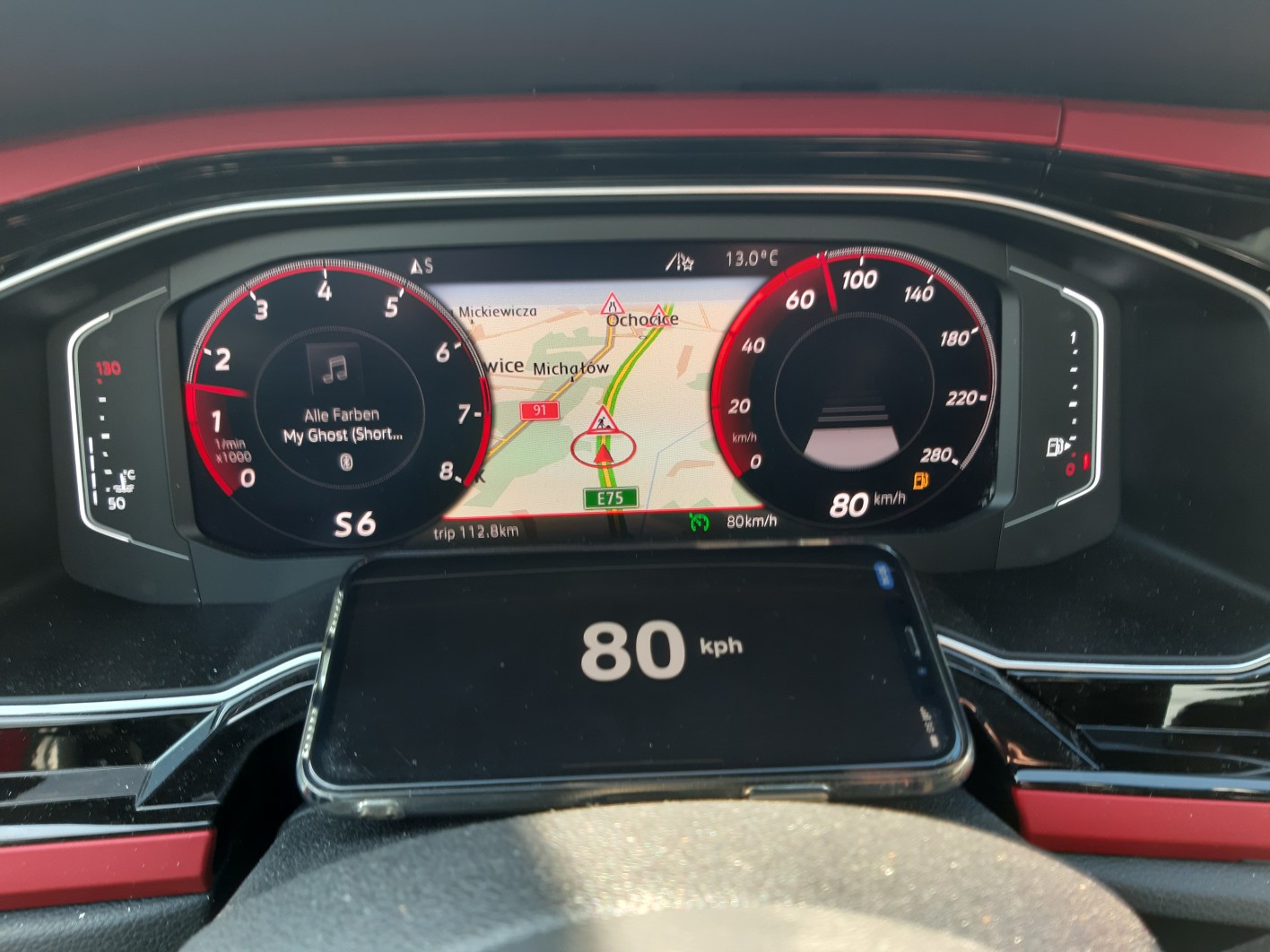

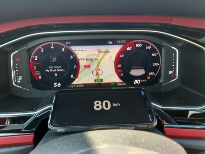

Here is also a speedometer vs gps reading on the 225/40/18 if anybody was interested...
Adding width to the tyres wont change speedometer readings as you aren't increasing the circumference. If you put 225/50/18's on the front then you would affect the speedo.
The 225/40s do have a bigger circumference as the height value of a tyre (40) is a % of the tyre widthstuartrendall wrote: ↑Sat Jun 13, 2020 12:19 am Adding width to the tyres wont change speedometer readings as you aren't increasing the circumference. If you put 225/50/18's on the front then you would affect the speedo.
40% of 225 is more than 40% of 215
