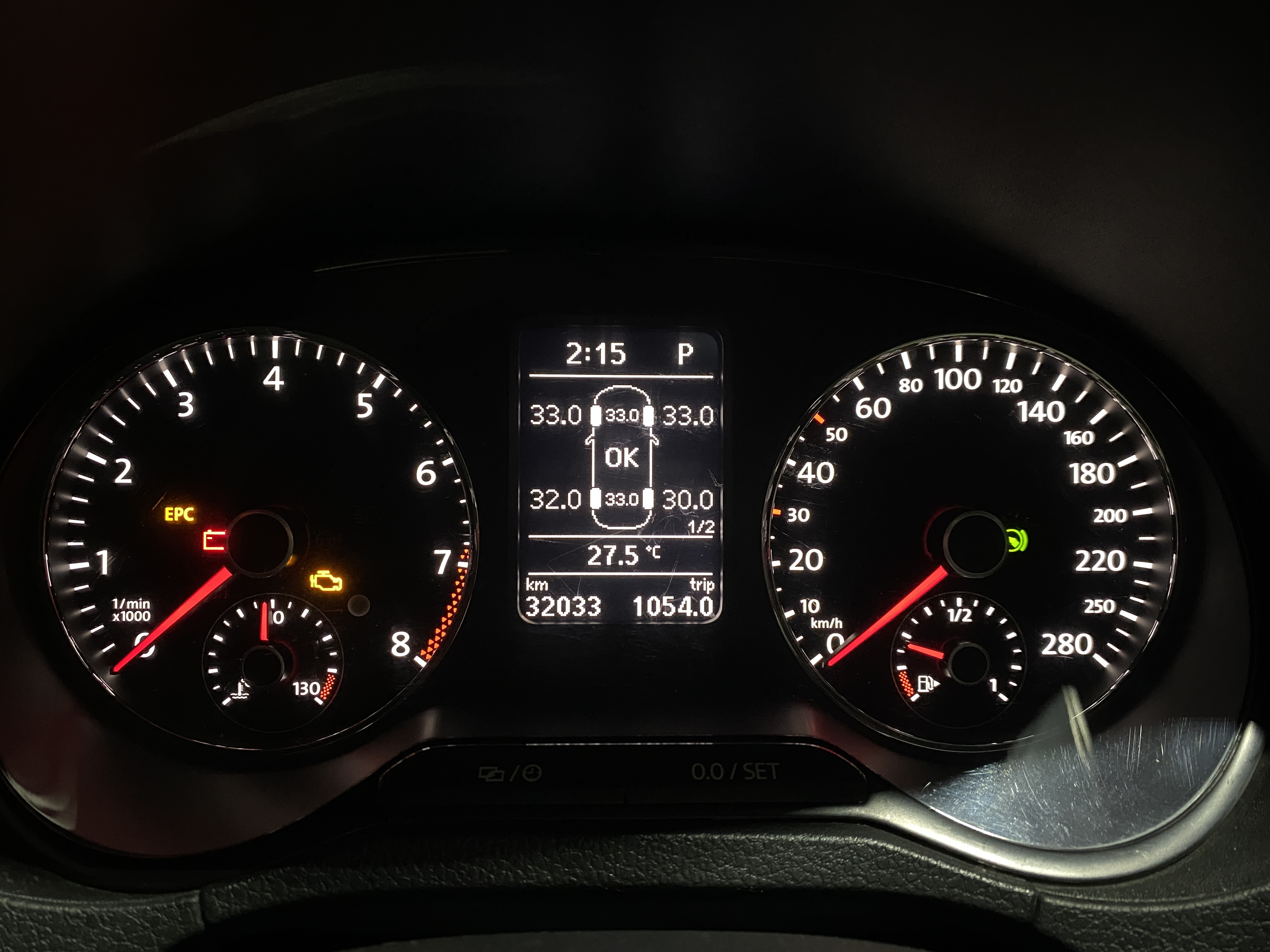

Btw used your guide and installed tpms and heated ovrms. Now my car is 2 years old and 32000kms. Recently had to change the steering rack and water pump (manufacturing defects) thankfully it was covered under warranty. Donβt get why such inferior quality parts in India.
Anyways here are the pics of the tpms and I know still have to parameterize the unit. Must say DIY are fun to do
Hi ciclo, hope you are doing fine

Hi adityagttsi. Looks great! Enjoy it!
I could no longer live without the TPMS, the tire pressure is the first thing I check in the MFD after traveling about 100 meters, it gives me peace of mind
to face any trip without worries.
Once the tires have warmed up, I again observe the increase of pressures. It's great to have this data!
- For me it would be great if the tire temperature was also displayed, since it is also monitored.

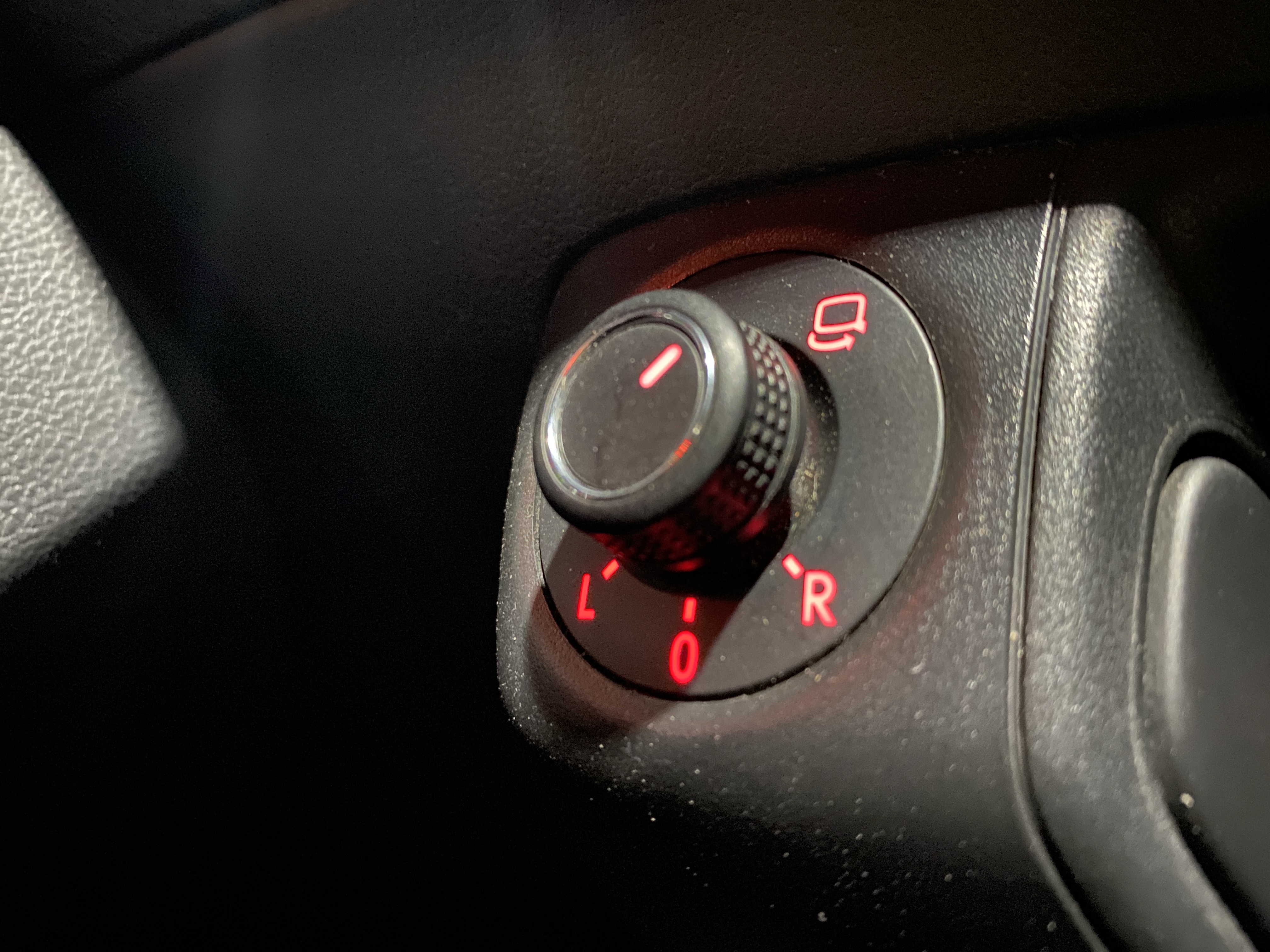

I was hell bent on getting the auto folding mirror function on my POLO. But then there were only two options, the first one being the Oem option (Replacing the wrms which are very expensive) and the other option was to get an aftermarket kit which I wasn't keen on doing it.
Luckily I found that T6 which have BCM - 090D get auto folding mirror functions. The way it works is that mirrors fold on long press of lock button and unfold on ignition. And this function is supported by Channel 84 in Central Electronics. Also the channel is available on 089D BCM only.
And to my surprise it did work on my car. Mirrors fold on long press of Lock Button on keyfob. (This has a success rate of 100 Percent). Mirrors also unfold on ignition (But then this doesn't seem to work always, as in sometimes it will and sometimes it wont)
Can the experts of this forum help me with unfolding function, do i need to adjust some code or adaptations.
Thanks.

- Channel comparison between BCM MAX models C, D and E from channel 75. (84,85)
My 6R currently has the E.
My folding mirrors worked with all of them the same way you describe, 100% folded and unfolded. I did not change the values of the BCM adaptation channels for the folding mirrors. https://www.youtube.com/watch?v=AryMyadL8bg
With the information you provide it seems that the way of making folding mirrors work has changed. I'll do some testing with channels 84, 85 as soon as possible, although I don't expect any different results on my folding mirrors.
On the other hand, there is the coding of the WRMs, but it is a mystery if the following coding table is applicable to all the WRMs models that exist (HW/SW) from 2010 to 2019 in the PQ25 family.
... as you can see in the table, Byte3 Bit0 and Bit1 are dedicated to the mirror folding function... maybe it is necessary to also activate Bit5 for PQ25.
As you already know, once the coding is done, it is necessary to reconfigure the window comfort function again so that the changes in the WRMs coding take effect.
Please keep us informed of your tests. Thank you.

I tested channel 84 on my BCM 'E' from 0 to 1, it has effects on the folding mirrors function, but in my case (with WRMs with SW for folding mirrors) the mirrors do not unfold when turning the ignition switch.
I recode the channel from 1 to 0 and the folding mirrors work fine again, both remote fold and auto unfold when I turn the ignition switch. 100%.
I also tried channel 85, it has no effect on folding mirrors.

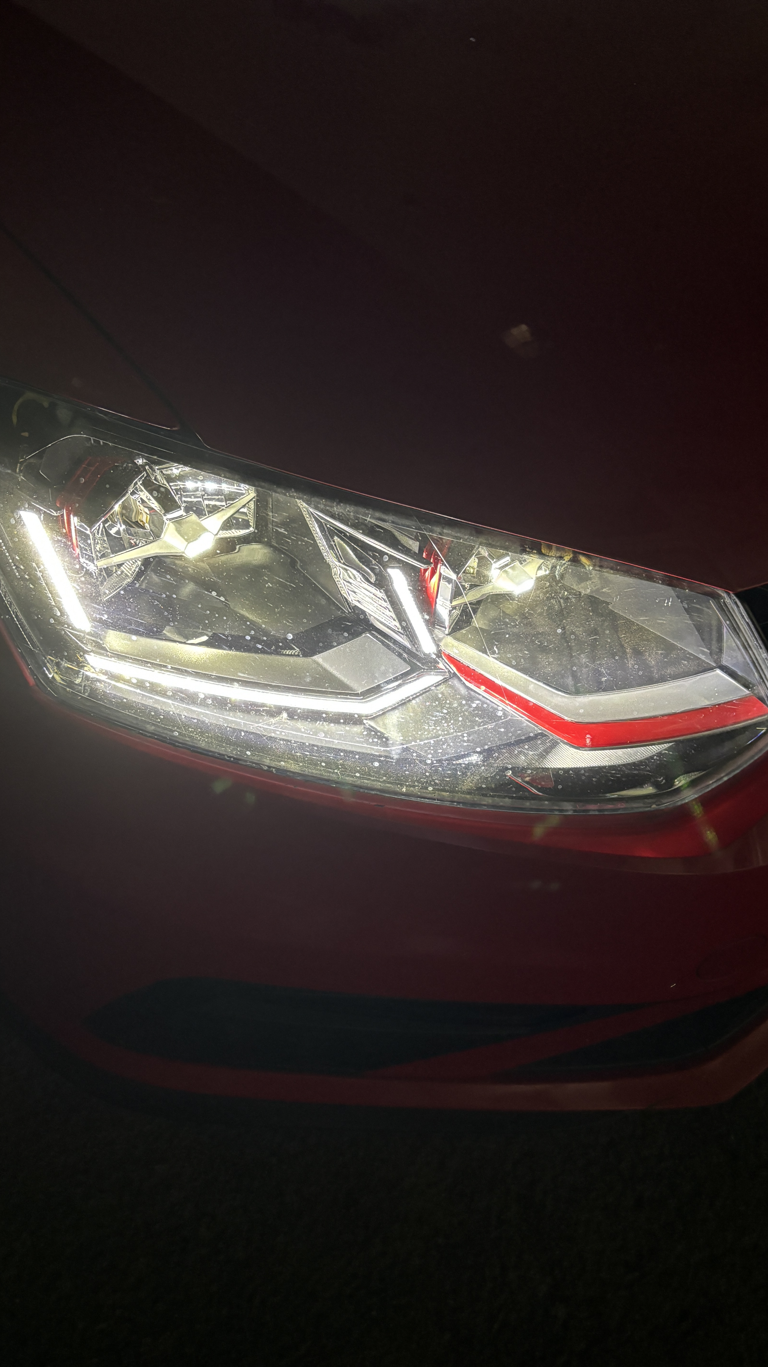

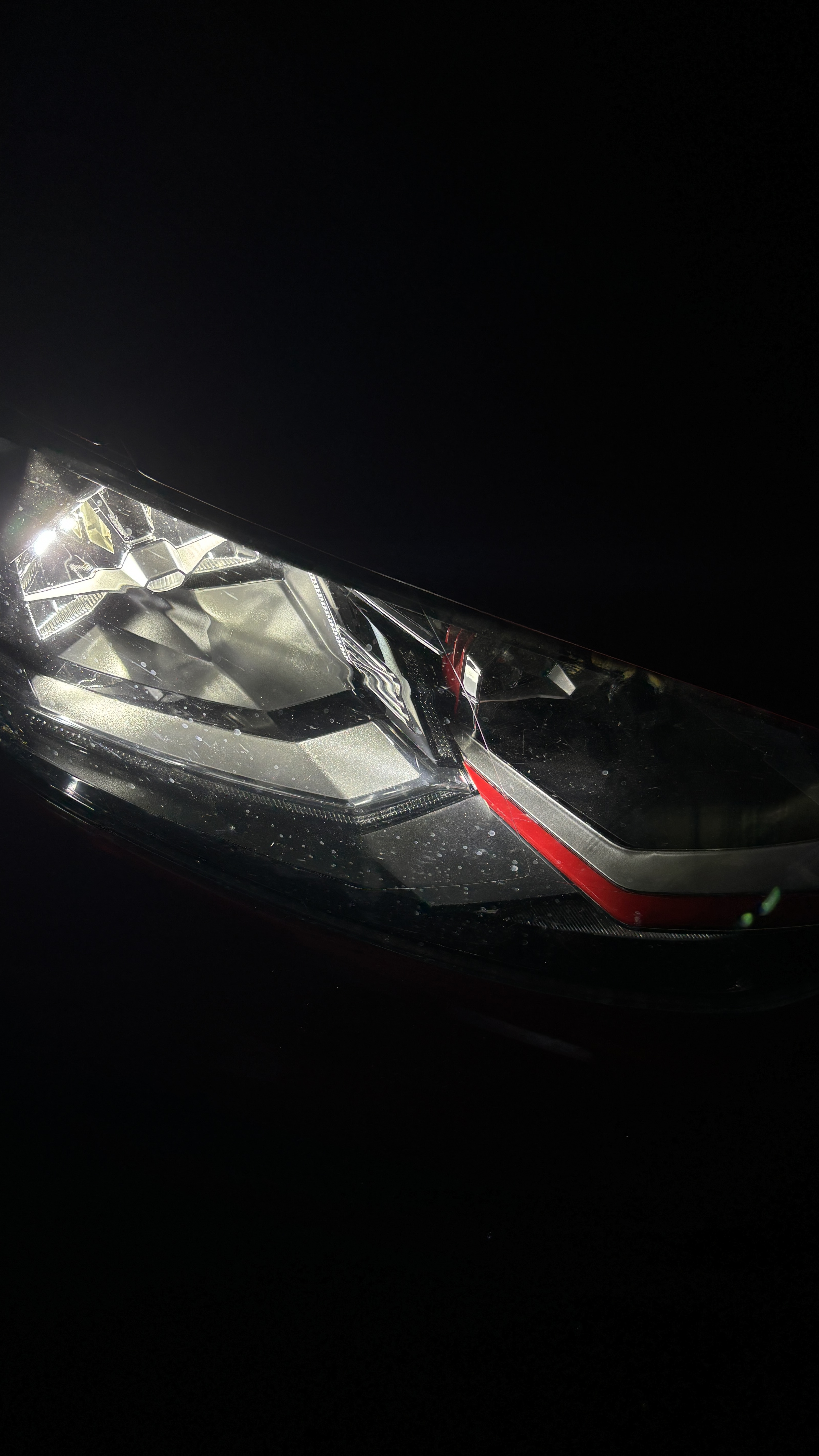

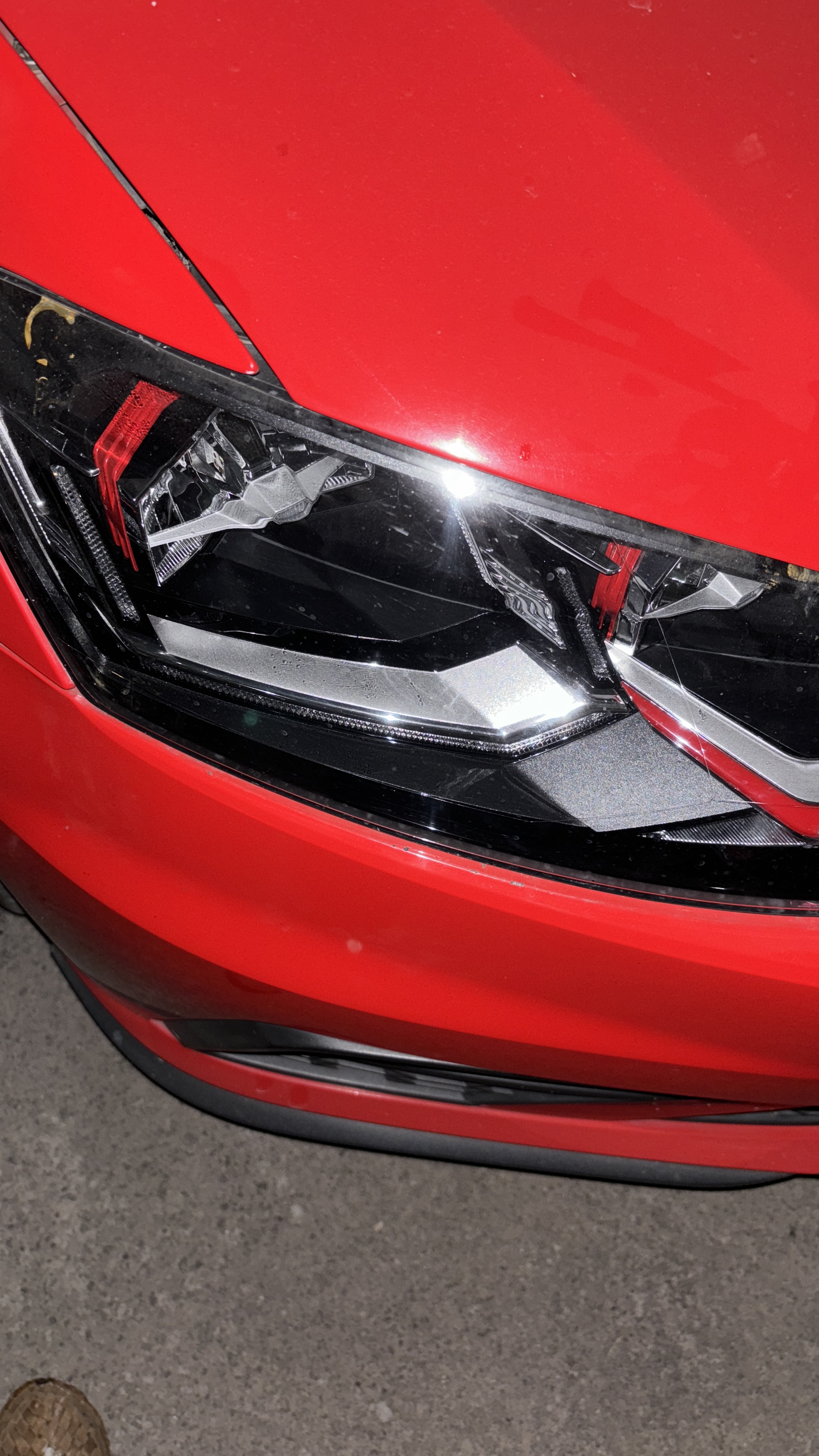

So i today did the installation of 6C GTI Lights, along with T10 to T14 harness. Connected the necessary wires to BCM.
Tried to do the coding, but there is a problem the Parking Lights are working in the DRL(When headlight switch is off)
Second problem proper parking lights are not working when you turn the headlights on or when you keep the headlight switch in parking light position
Here is the auto scan, if you guys could help me that would be great.
Thanks in advance
Thanks in advance

Three scenarios best way i could explain it
Headlights switch 0 position and DRL are on
Headlight switch parking lights position
Headlights on(Auto and manual) and parking lights are off

From what i could read on this forum about led headlights. I have come to know this that you need BCM 8IT for Led headlights or you need to parameterize it.
If you donβt then the Parking Lights wont work with Headlights and Parking Lights.
Also if my BCM does not support LED Lights then can i parameterize using ODIS?

Re: Aditya's Polo 6R GT TSI 1.2
First I checked your new BCM coding comparing it to 6R IND with LED headlights from the factory.
I have modified some Bytes...
Please try this new BCM coding and report the results. Thanks!
3AB82BFF48B30400013806307CEF9ED002C0604F60CD39F1230000030020
Faults may arise, but we need to know this. Don't worry if this happens, they will be corrected.
From what you say about the current operation of your new '6C/6R' LED headlights, it is highly likely that you need to parameterize your BCM (PWM value for position/parking/side lights), which can be parameterized with VCP and ODIS.
It is explained in the firegrafik thread on Drive2.ru https://www.drive2.ru/l/489696641561919499/ PWM Value with POS/TFL lights and activited Pos-lights...new value = 28
