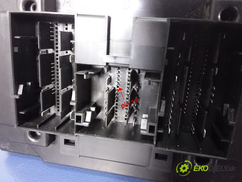

I collected all the materials for the Washer fluid level sensor. Looking for other people who have done the same retrofit, i discover that the 6C0798087C BCM doesn't have the pin 14 on the T46 connector (connector B on BCM)

I found a seller at Poland, who claimed that he has a new BCM. The code for this BCM is 6C0937090E
There is a guy from Drive2.ru who has done the same procedure on the same car as mine.
This is the newest version of BCM exists for PQ26 platform.
I am willing to buy it and try to install it to my car. Are there any suggestions ?
