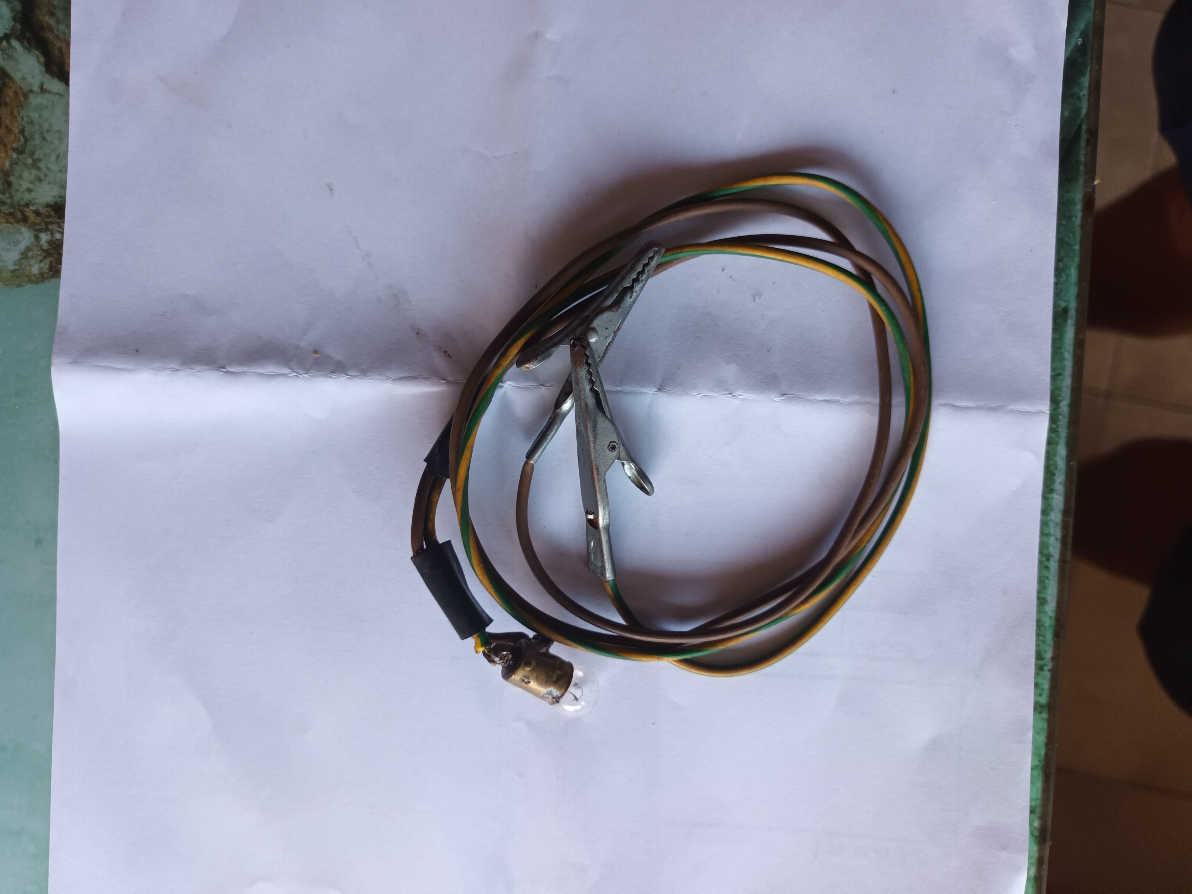

You are looking at history below, a 55 year old timing bulb that I used on literally dozens of cars and still use it to set up the static timing on some of my daft friends ancient cars, if you set up the static timing correctly as per the manual then you can forget about the dwell angle as long as the points gap is correct.
