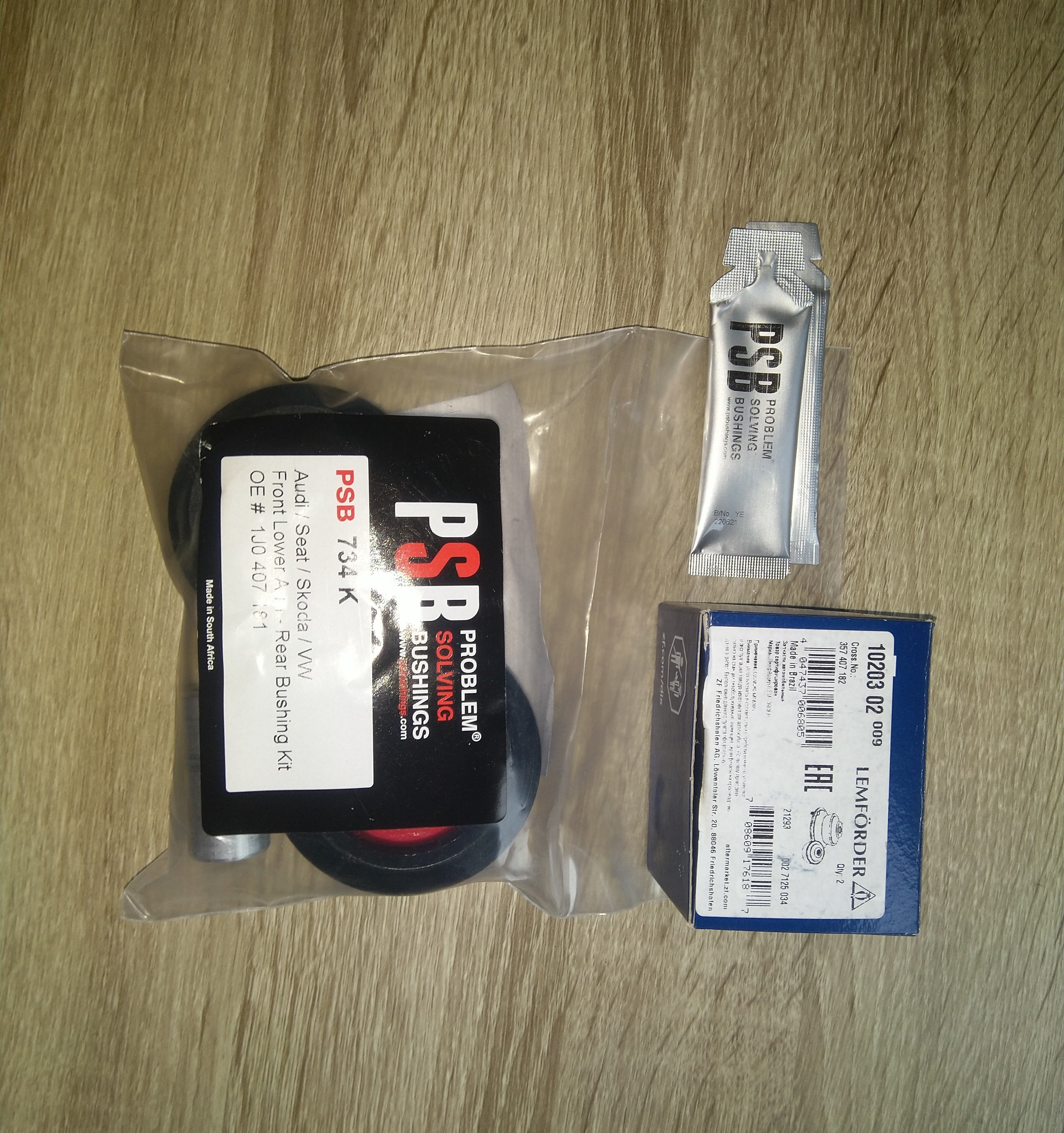

I'm interested in which PSB bushing model you purchased.
Do you recall the part number?
Re: Control-arm bushing
IMG_ 20221212_085427_2.jpg (1.78 MiB) Viewed 3011 times
PSB 734K
Total for me was 25.62£ with shipping
https://psbushings.co.uk/product/2-x-vw ... 0-to-2014/
It comes with 2x grease packs. In each of them there is more than enough grease ( its silicone paste/ grease)
The Lemforder were the two small bushings - Cost 11 Eur
Ps: I see you are from same place of origin where they are made maybe you could source them even cheaper or with free shipping...

Mine is this one
https://psbushings.co.za/audi-a1/
Audi A1- (10-18) Front arm rear mount
https://psbushings.co.za/ibiza/
Front lower arm rear bush – PSB 734
Same as for MK4 ibiza
The one for the 6r polo on their site is yellow and solid. ( they the same part number)
They state "Lifetime Warranty"
