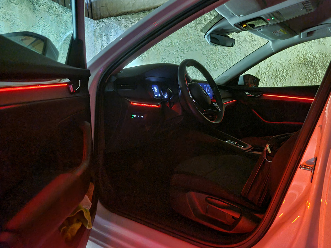

Ambient lights
Project is over. It took many hours and a lot of effort. About 4 hours for each door.
It was worth the effort, the result is perfect.
I only hope that the Chinese materials will stand the test of time.

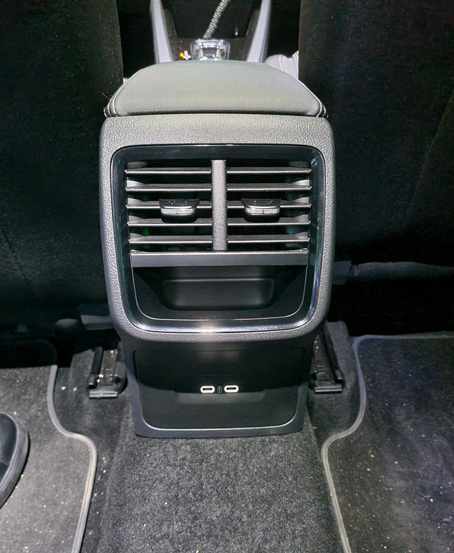

OK, I bought a used unit from T-Roc and it works. Of course the plastic face is different from the Octavia, so I used the Chinese shell and electronic board from the T-Roc and made a working unit. Then I proceeded to install it in the car.
This is the final result.
Thank you for your help. I will post a guide for this installation.

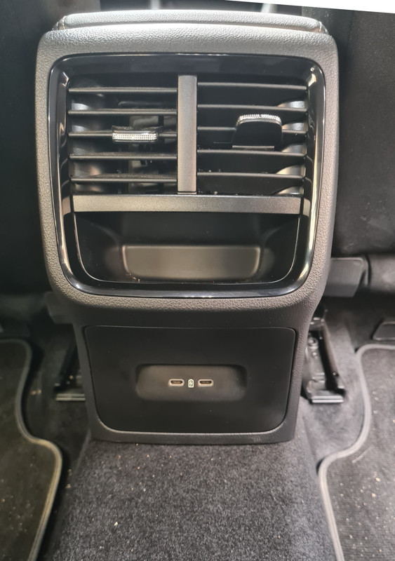

As i mentioned i bought the plastic trim with the USBs holes. (5E3863618 (9B9)
The USB module with 2 USBs - C ports is the 3G5035954A
An cheap sourch is from a Poland site named SkodaParts   (https://www.skoda-parts.com/spare-part/ ... 38659.html)
I did the wiring. I bought some plugs for this purpose. The black to connect the wiring to the car's (needs a little modification), the red to connect the existing contact of the front seats and the brown for the rear seats USB.
The black plug (female) needs a bit of cutting to get the male red plug in. Please see the photo below:
And this is the wiring
Each plug has 4 pins. Connect 1 to 1, 2 to 2 and 3 to 3 to all plugs.
No4 only needs to be connected from the black female to the red male. The new USBs that we will put back do not need to be connected to No.4
This is the result of the preparation.
Installation:
Some plastic parts need to be removed.
The right side panel of the central console.
The rear plastic (along with the air ducts) of the central console.
Looking from below you can see the plug of the front USB ports. It's the red one with the 4 wires.
It must be removed to make the new wiring. It's a bit difficult because of the limited space. A small tool with a turned nose that I had helped me a lot. If someone doesn't have it, he can make something similar with a thick wire
With this tool one can press the plug button to unclip and come out.
Time to wire. We need to run the new wiring through the center console and bring it to the back. A plastic fish tape wire puller helped me with this.
 Then we connect our new wiring to the red plug, arrange the connection (I also put some soft material) so that it does not knock and make noise.
The side panel can go into place, we're done with that.
USB ports installation
This is the plastic we removed from the back side. We need to remove the part that is the ashtray and replace it with the USB base
With a plastic tool or a small screwdriver, press the plastic pins (there are 4) and the ashtray comes out easily.press the plastic sheets (there are 4) and the ashtray comes out easily.
In the opening created, put the plastic with the USBs and make sure it clicks correctly.
We connect the brown plug in place and fasten all the plastic to the center console.
We are done!!!
Now we can enjoy our new USB ports.
