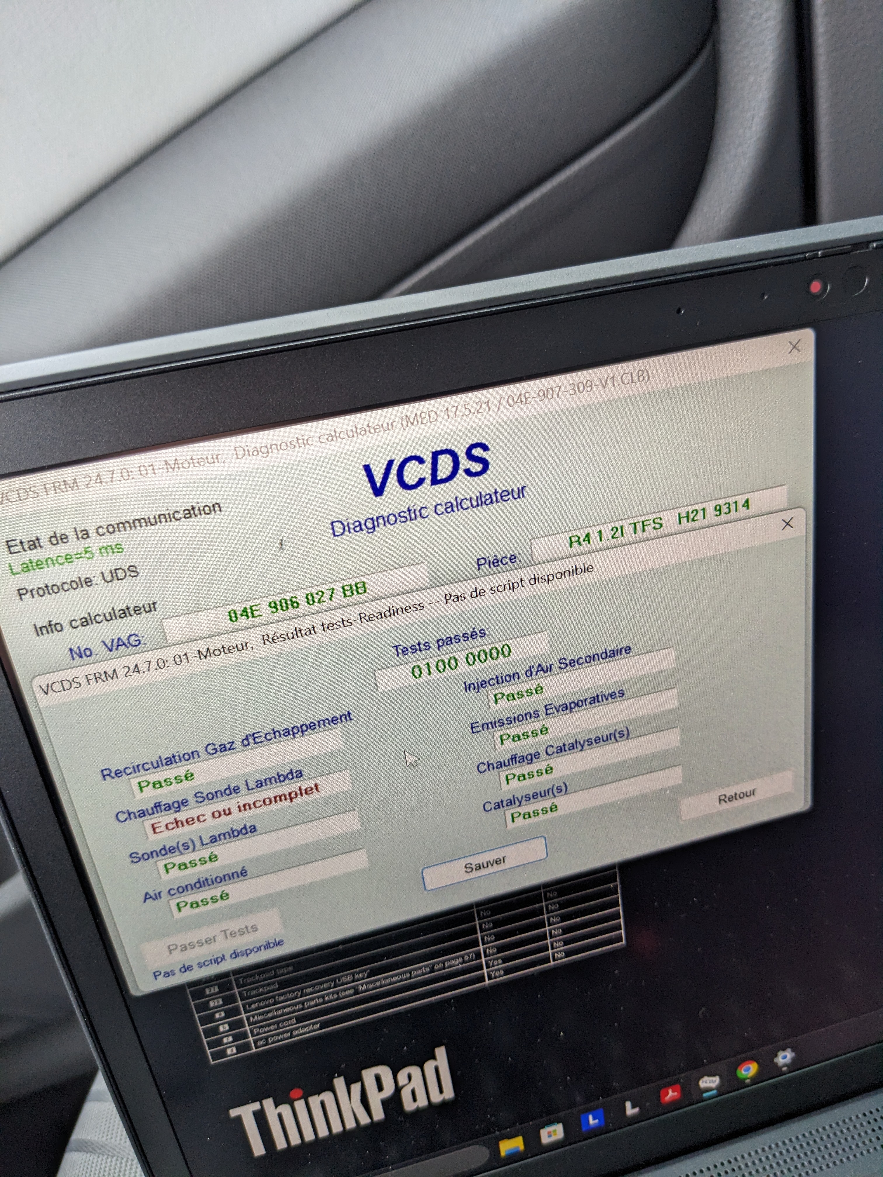

Hello everyone,
Today was D-Day for the Polo.
Appointment this morning at 8am to update the engine ECU to the latest version available.
A very warm welcome from this dealership, light years ahead of my usual dealership.
Warm, attentive and friendly.
The hour's drive in thick fog (visibility less than 20m) and on an icy road was well worth it.
1h30 later, the car was returned to me with the following version:
9314
In the VCDS scan, there were a few errors due to a loss of connection between the car's various modules, but nothing surprising or alarming.
I erase everything and set off for my hour's drive through the countryside, which still wears its veil of frost:
PXL_20250117_091446729 (1).jpg (2.69 MiB) Viewed 8747 times
Arriving home, a final full scan: CLEAR except...one small point concerning the lambda:
Impossible to pass the tests and/or adapt the lambda, the car refuses because of this defect.
So far, I've come to no conclusions.
The car behaved as usual.
The engine was still warm when it left the dealership after the overhaul, so I wasn't able to experience the symptoms I often describe.
However, on initial start-up this morning (-3°), these were significant and chaotic.
It felt like the engine was suffocating and fighting against something.
Translated with DeepL.com (free version)

Did they give you an invoice? If that's not a problem, could you please tell us how much they charged you?

ciclo wrote: Fri Jan 17, 2025 6:50 pm Did they give you an invoice? If that's not a problem, could you please tell us how much they charged you?
Yeah no problem, they ask me 150 euros. No more.

As I already mentioned, in my opinion they shouldn't have charged you since your engine is included in the TPI. I'm not blaming anyone for anything, I'm just expressing my opinion.
It would be appreciated if you could report your observations on the operation of the engine with this new update, I suppose it may be useful for those who are in the same conditions.

ciclo wrote: Fri Jan 17, 2025 7:37 pm As I already mentioned, in my opinion they shouldn't have charged you since your engine is included in the TPI. I'm not blaming anyone for anything, I'm just expressing my opinion.
Hopefully everything will work as it should from now on.
It's your opinion but I accept it and, to be honest I'm quite on your side.
But I prefer the 150 euros from this dealer than the 320 euros requested by the other dealer :roll:
Engine was operating normaly as it was still warm after 1h-1h30 in the shop.
So nothing to report in term of feeling.
Just the "Lambda warmup fail/incomplet" on the VCDS.
The true test will be tomorrow when the engine will be dead cold (-3°C).
Posts: 9037
Re: Cold weather, engine runing rough
I can recall very few times that engines I've owned passed the VCDS test when readings were taken, they usually pass the test under ideal operating temperatures (0000 0000). I've never had to worry about this.
I also updated the ECU on my 6R to the updated version, but that's because I'm a capricious person, everything worked fine before and after.
Then the ECU reprogramming, which is one of the great improvements in my 6R, is very noticeable in these small engines/cars, the acceleration is spectacular. Very happy for many kms/years now, from 90 turtles to 125 roadrunners... beep beep!😄

So small update, temp was higher than expected (2°C).
I had the feeling the issue was still here but to confirm temp need to be lower.
Btw, after 1h of highway, all engine passed.
02 sensor heating too also.
