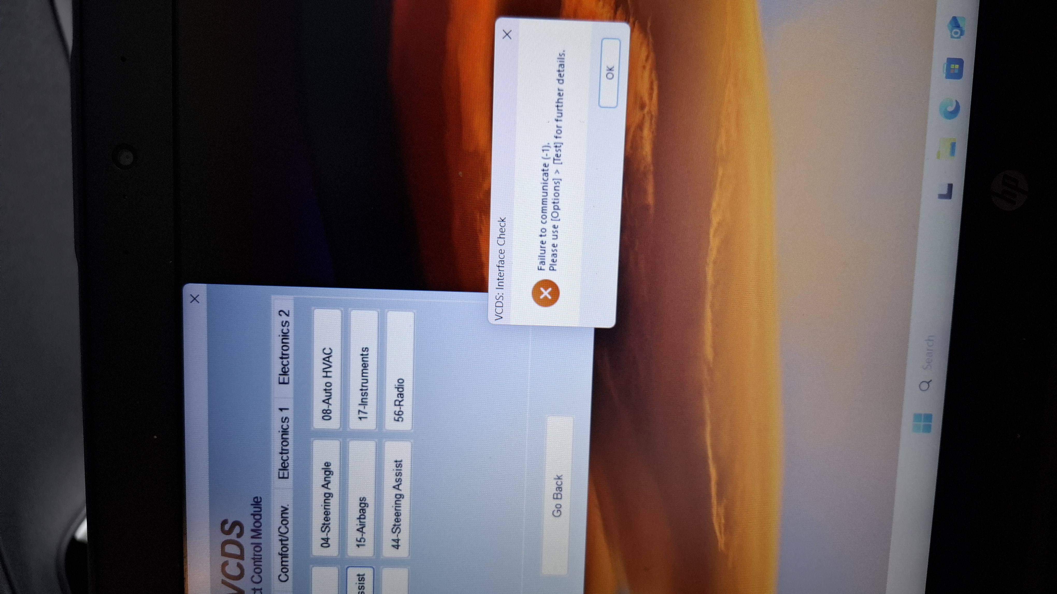

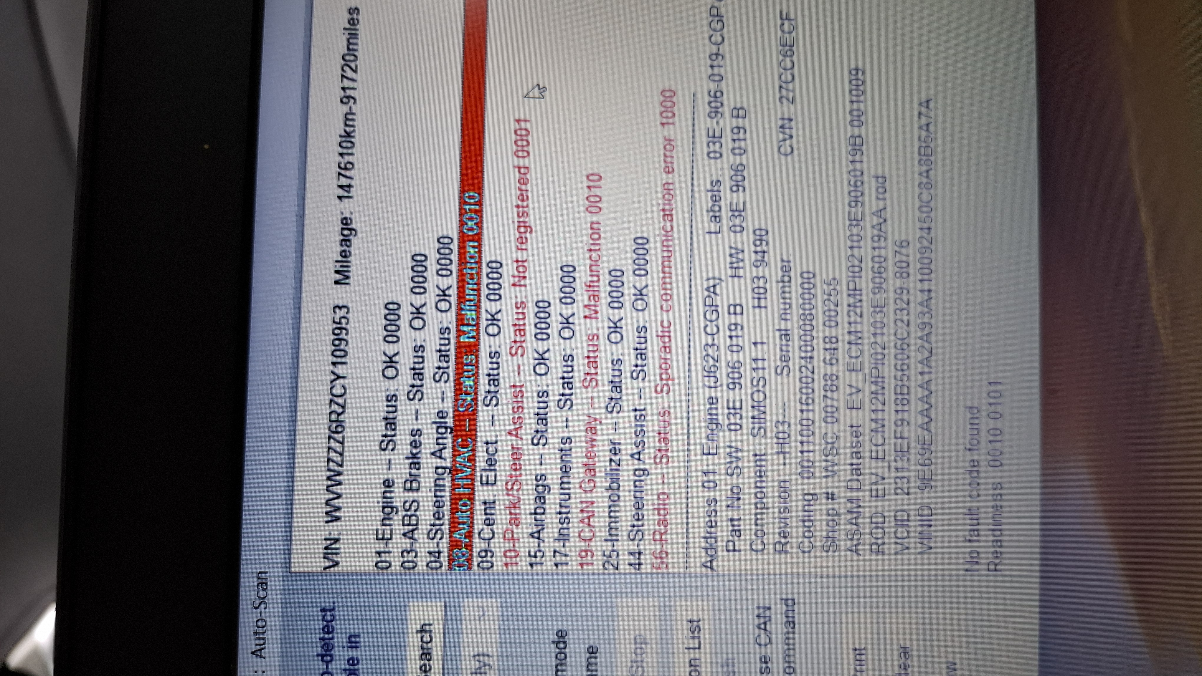

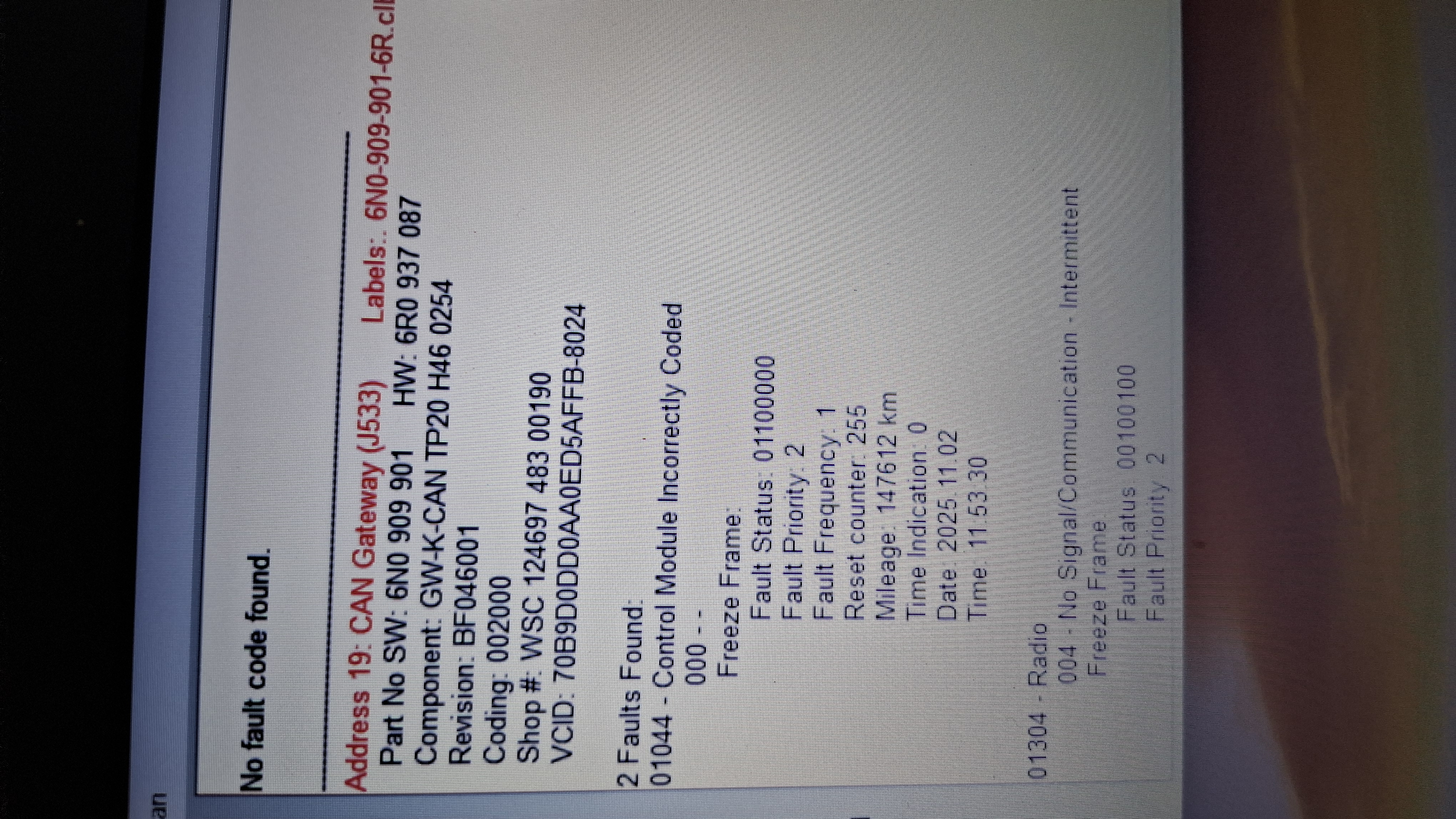

I connected everything, bcm can high.low, fusebox 15 5A, and rear senzors. Vcda scan says this. Disregard Hvac error. I did not code anything in vcds yet. What is the first step? Did i connect it right way to can high or low? I can code anything because it says gateway not respoding error.

When I disconnect the pdc modul evwrything is ok and I can enter the gateway and I have no errorsBuci wrote: Sun Nov 02, 2025 11:07 amOk I checked. It is on the right side of the trunck and also bracket for the modul fits there great.ciclo wrote: Sun Nov 02, 2025 9:47 am Take a look at the PDFs I provided for free, they have all the information on how to completely disassemble a 6R/6C. They also include wiring diagrams for both vehicles so you can do/create your own electrical installation.

The first step is to activate/register module 10 in the Gateway installation list.
- Gateway 19 --> installation list --> check/activate 10 in the list... do it.

Ciclo I sid it in total. Now some coding was needed with long coding on adress 10... It says automatic transmission. I unclick it. Save.done. Now I scanned again and there is no error. Is there any need for some other coding that I did not think off? The radio is showing ops senzors, and senzors are beeping when I move to them.ciclo wrote: Sun Nov 02, 2025 12:22 pm The first step is to activate/register module 10 in the Gateway installation list.
