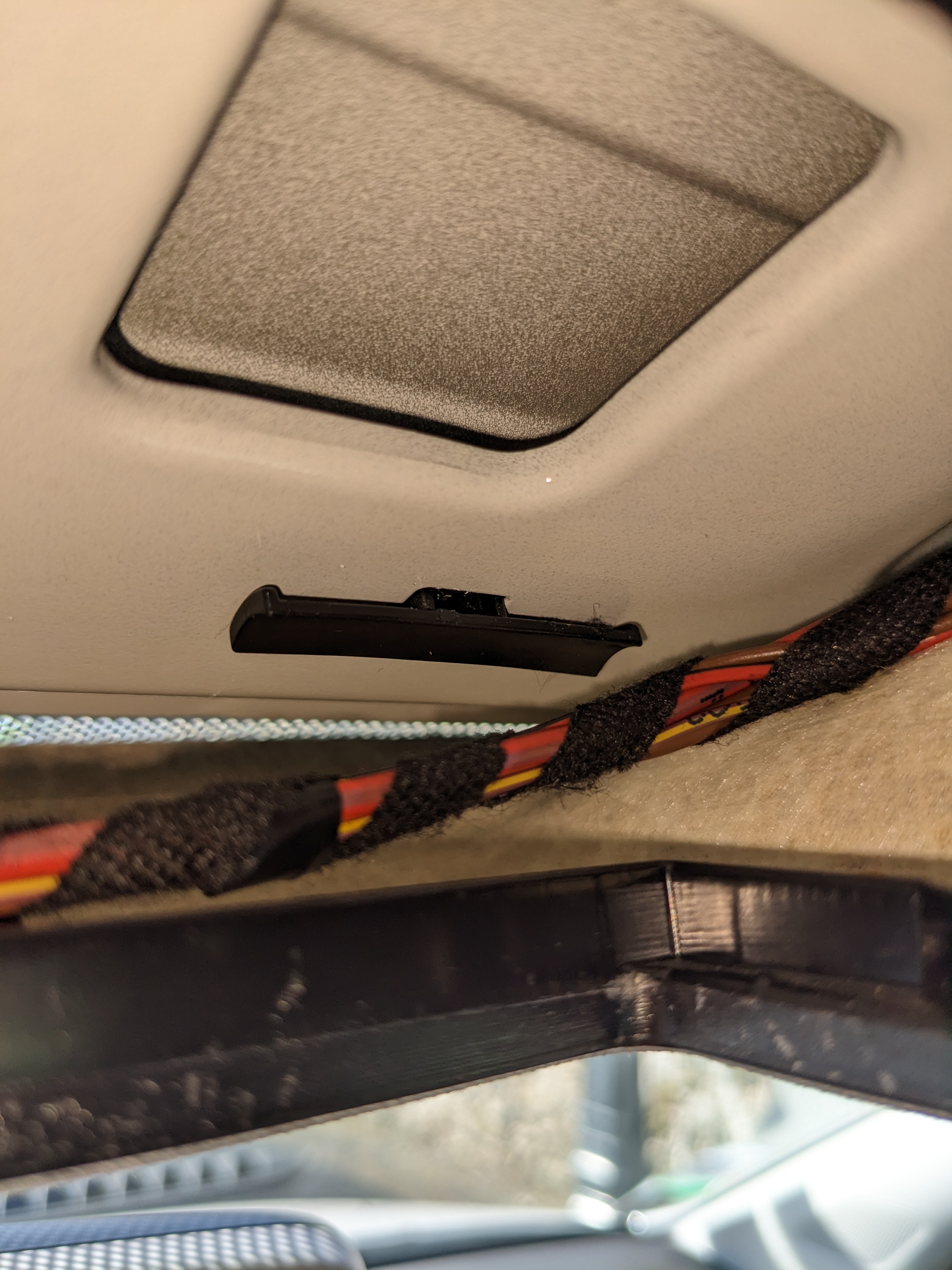

On ETKA I was loocking for the wiring support clipsed into the roof of the Polo 6C (over the passenger/conductor) but impossible to found them on ETKA even after 2-3h of searching.
One looks like this:
and the other, more "classic"
Thank your for your help :D

Try using etka- common parts section of catalog. There are many clips and you have to go one by one. Only issues on these free etkas pictures arent available :/

Yes It's what I did but even here, impossible to find something, or maybe I missed it.
On a paper, I noted all part number without any picture and I made research on ETKA to find them (no matter the car, just to see it's shape) but no.
I have to see, if by removing some parts (sunshade, screw) I can lower the headliner enought to get access on the upper part to see if there is any part number.

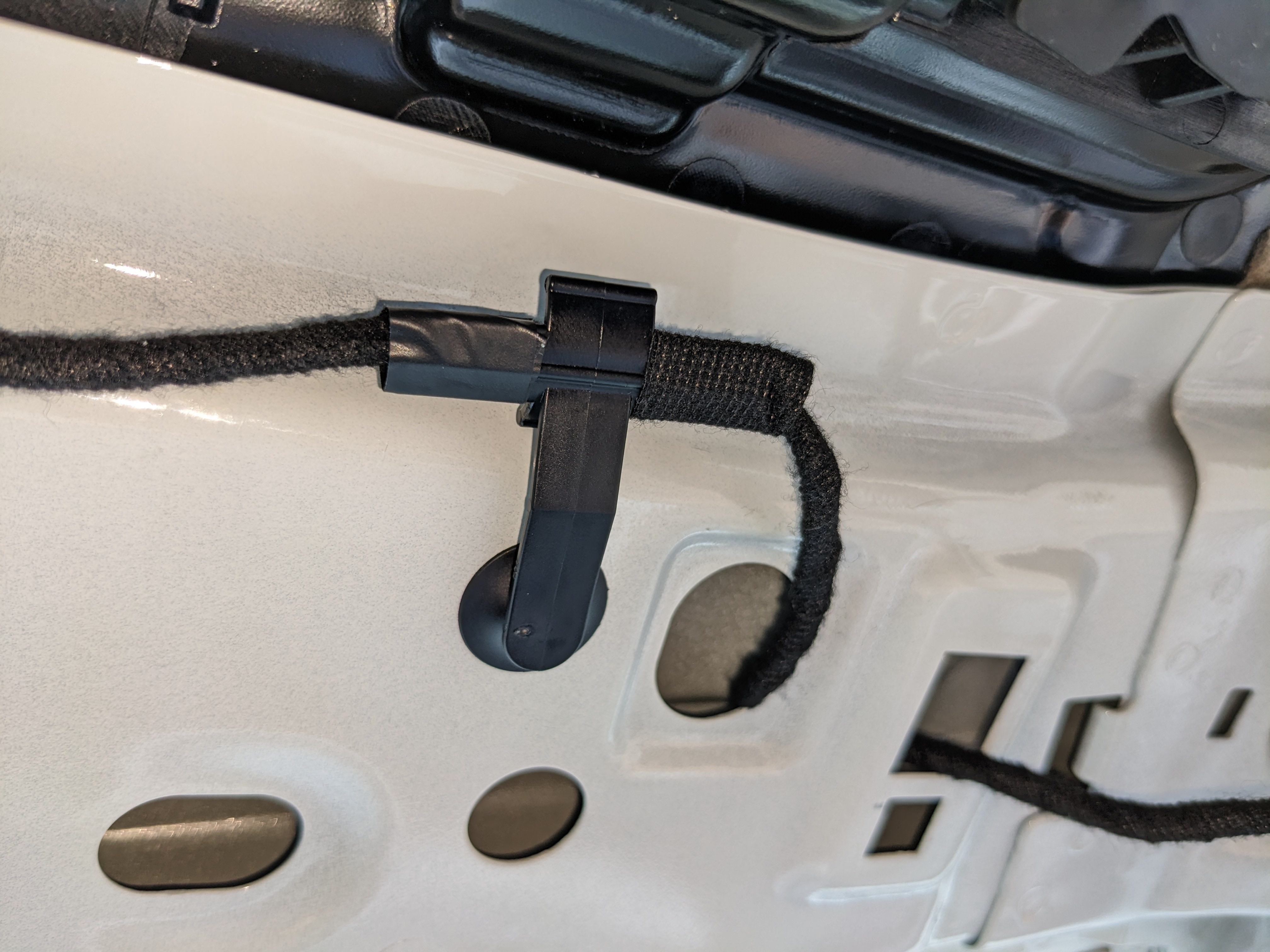

This one is similar, but shorter
WHT004916
4B0 971 848
N 91115901
6Q0971848P
1T0971930A
1J0971445C
Please check these with underline. The round hole one i cant seem to find identical (your has a bend)
is it perhaps 3B0971848F?

Unfortunately nop :oops:
Almost the same shape but the lenght is too short.

3d print one and forget about it
( Just use cloth tape, and stick the loom to the body. )
Or get the one without a bend and use heatgun to form the bend.
1K0971930C?
and
6Q0971848P?

iichel wrote: Wed Jun 11, 2025 10:40 pm 1K0971930C?
and
6Q0971848P?
6Q0971848P yeah for the "straight" one :D
1K0971930C looks almost the same, maybe a revision ?
yeah if this isn't the one then that cable clip can go fck itself :mrgreen: :wink:

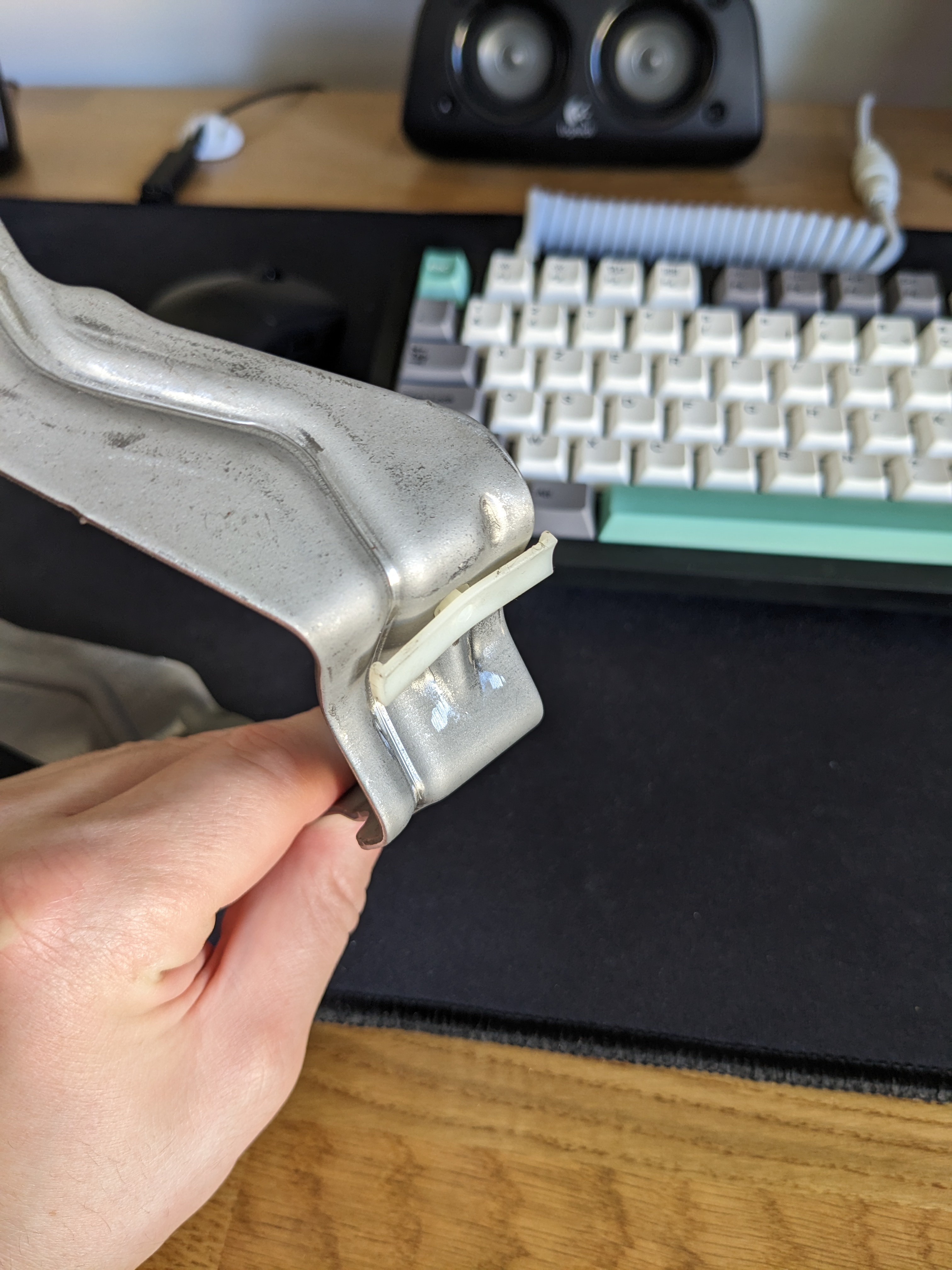

New day, new part I'm looking for.
Man, I'm complaining about IPC (Illustrated part catalog) from Boeing sometimes (I'm aircraft engineer) but the VW's one it total s**t.
This one now:
This metal part is the main bracket for the lower center console.

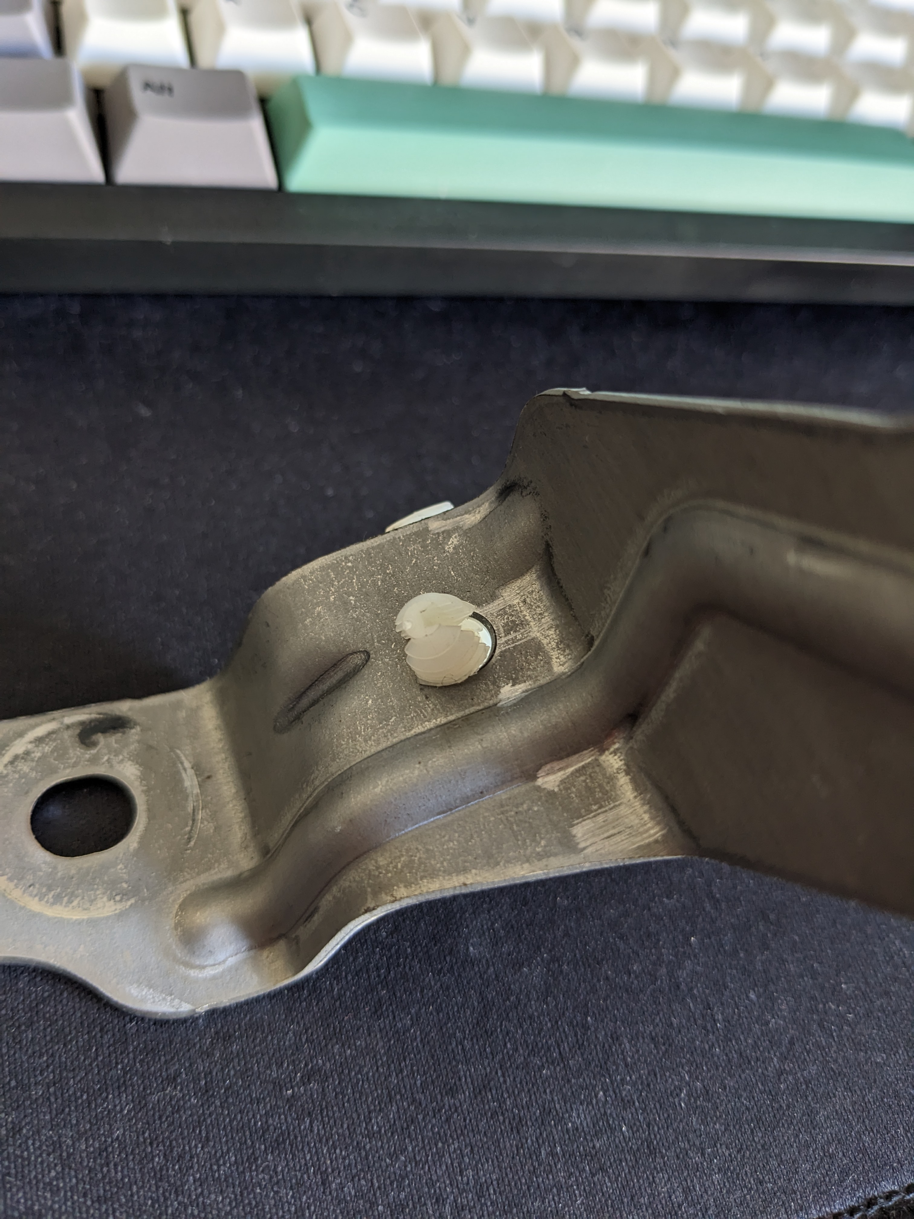

I don't know what happen when they built my car but:
-the part was slightly bent
and
-they forgot to install 2 screws
This is the main reason for why it was so hard to remove and install. But VW decided to install a little cable holder, white one whith the famouse Xmas tree.
Impossible to remove without destroying it.
And of course, not part number on it.
I know this one, they have been replaced with 4B0971848

iichel wrote: Wed Jul 09, 2025 6:48 pm I know this one, they have been replaced with 4B0971848
Oh man, If it's true I'm gonna give you a kiss.
Those little s**t are pain in the ass to remove.
