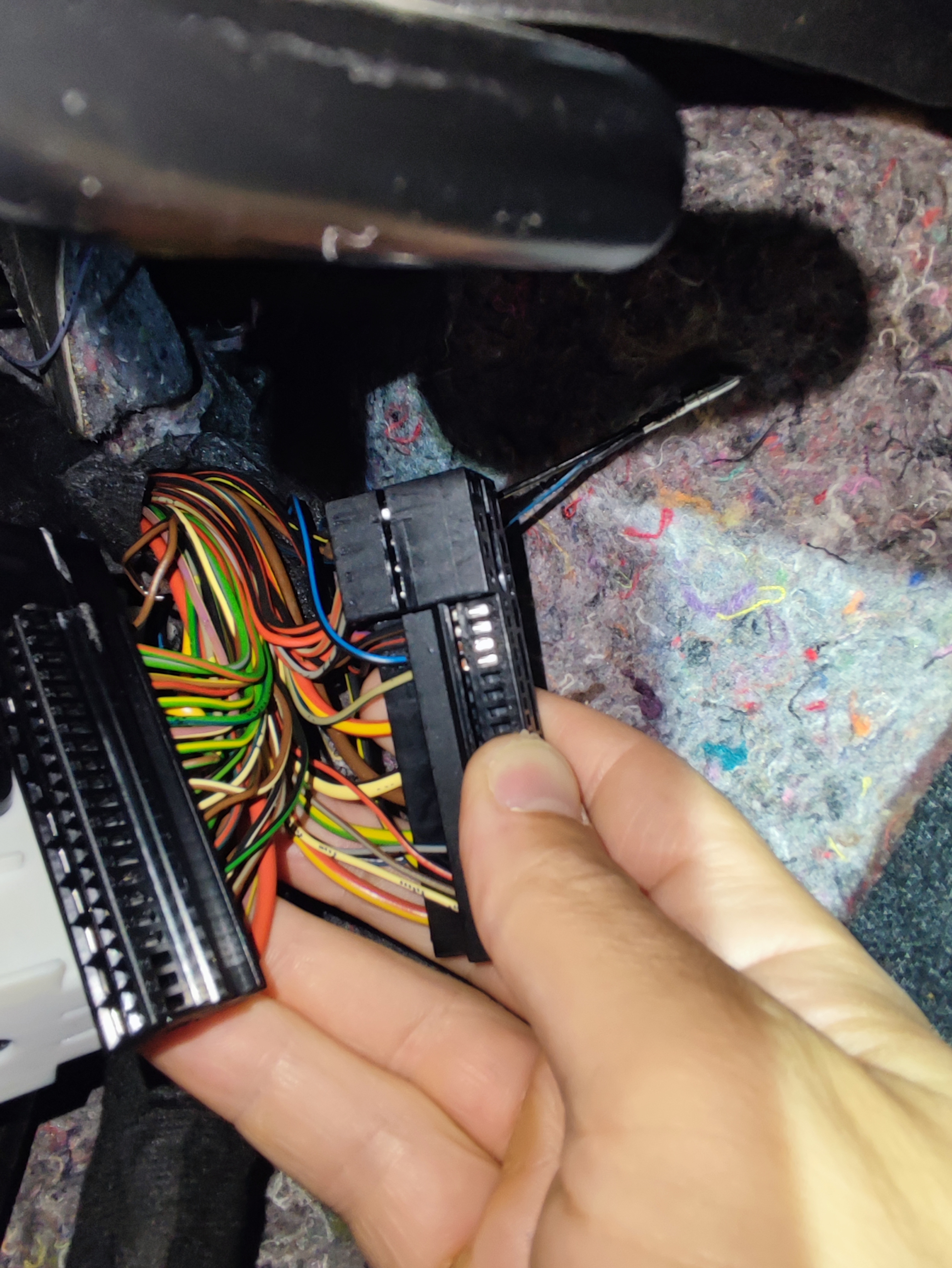

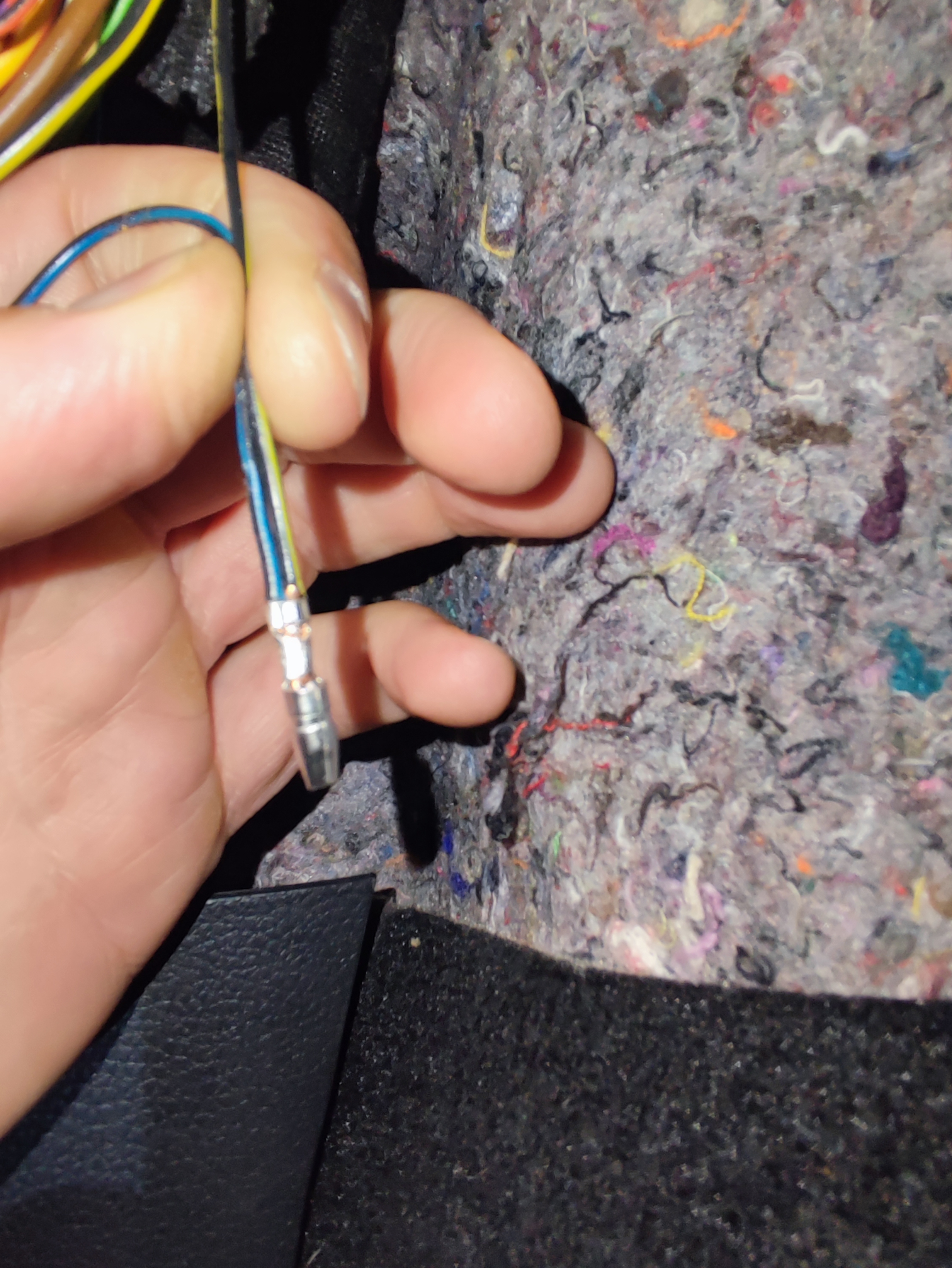

I just checked connection 73a/44 and it's ok, I want to check the continuity of the black and yellow cable, according to the diagram you've put, I would have to look from connector 4 of the head light control regulator to 73a/44, is that right? go if when manipulating the cable the fault is higher.
Can I use the car with this fault? nothing will break right? the backlighting of the radio and air conditioning buttons work well.
Posts: 8912
Since the faults are intermittent, it is possible that you take measurements with the multimeter and everything is correct. Wiggle the wires around the areas where you made the connections/repairs as you make the checks.
Please, take a couple of photos/pictures from the connections/splices you've made on the yellow/black wire and post them here.
Don't worry in case the repairs you did look awful, we love those pictures here, they are the best, and we can draw good conclusions and great ideas.

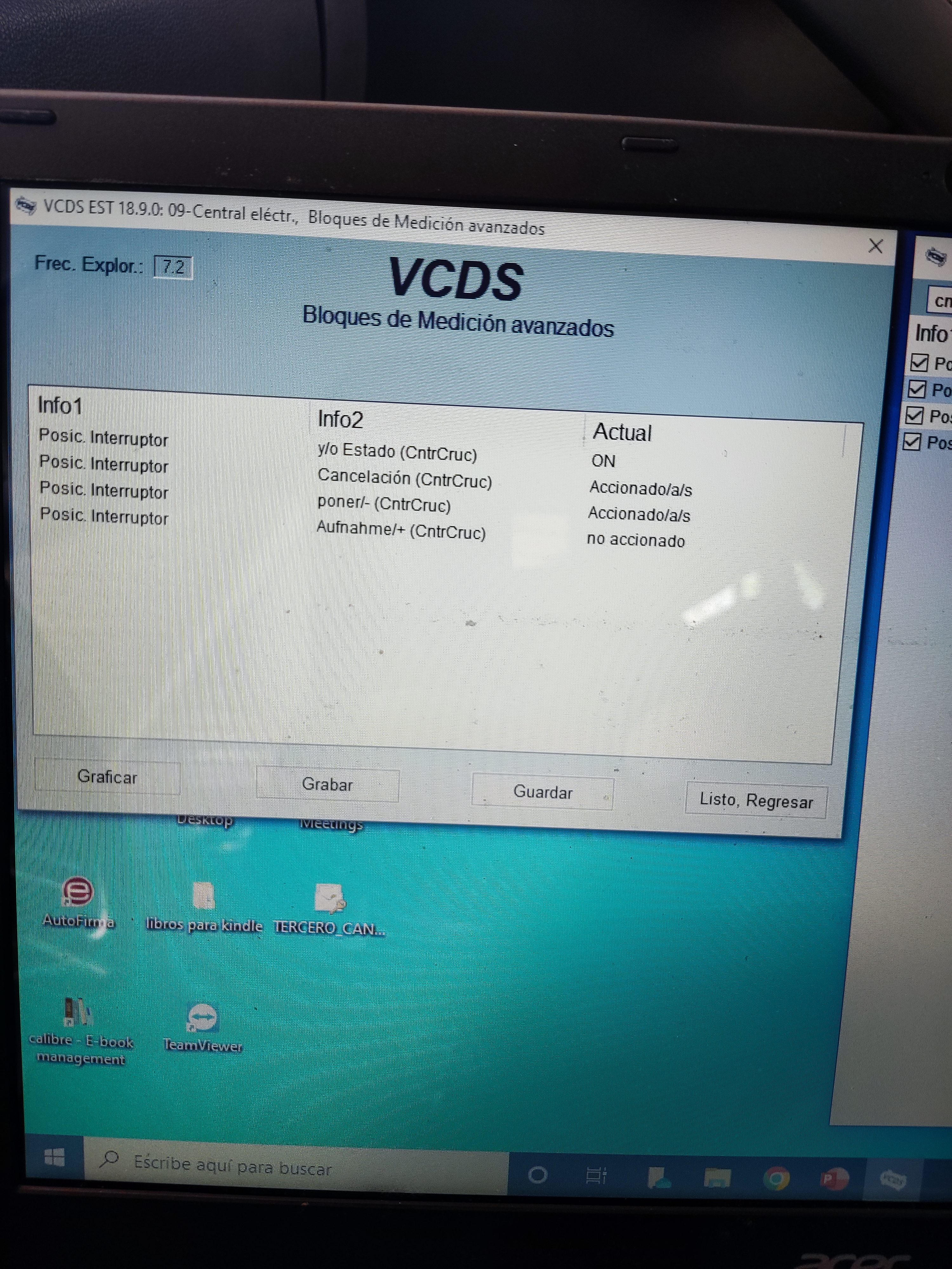

If you have VCDS, please go to 09 Central Electrics, code byte 17 bit 7 to 1, go to advanced measurement values, look for cruise control and tell us the values please.

It detects the 4 buttons well for me if you refer to this measurement.

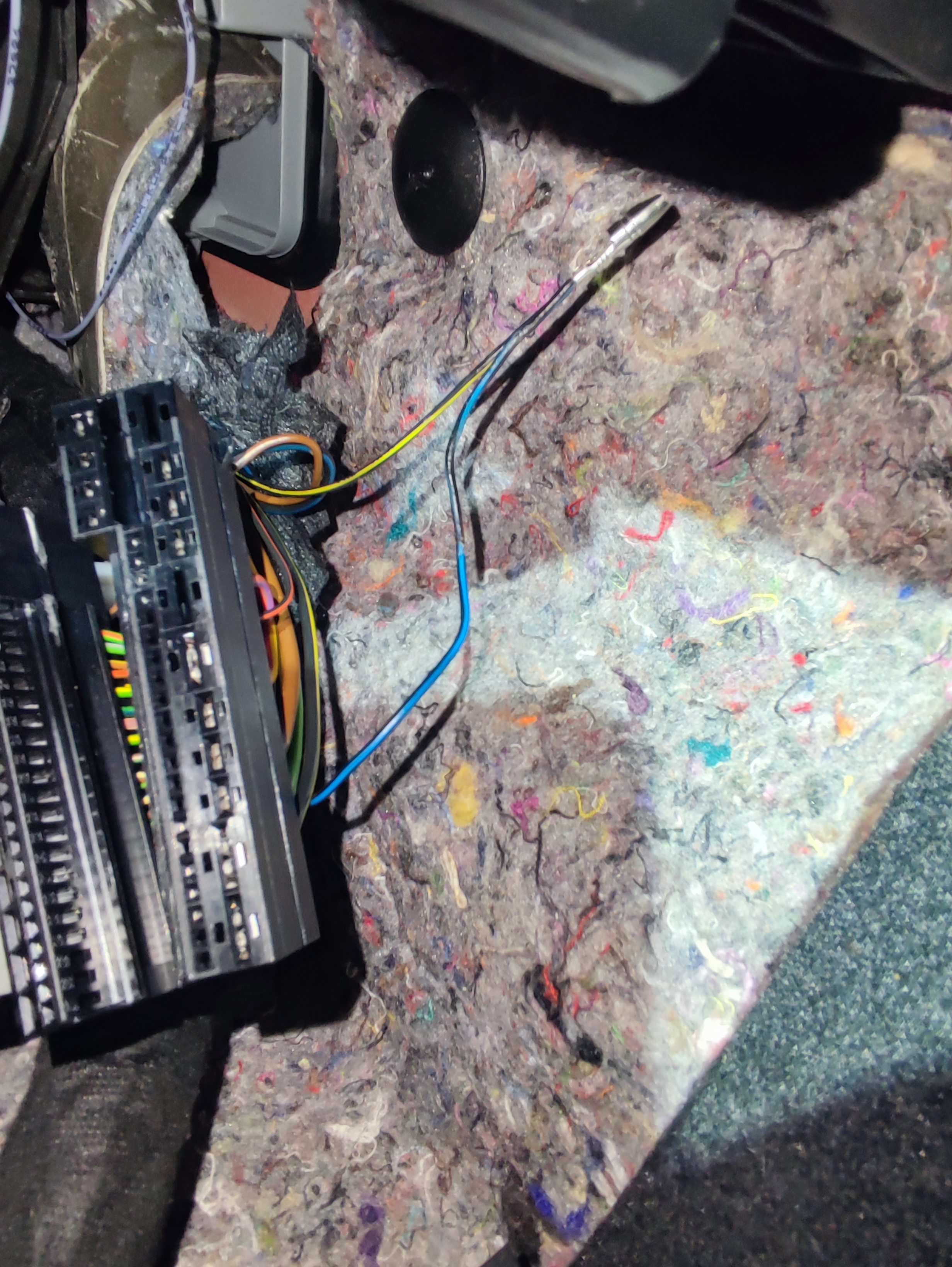

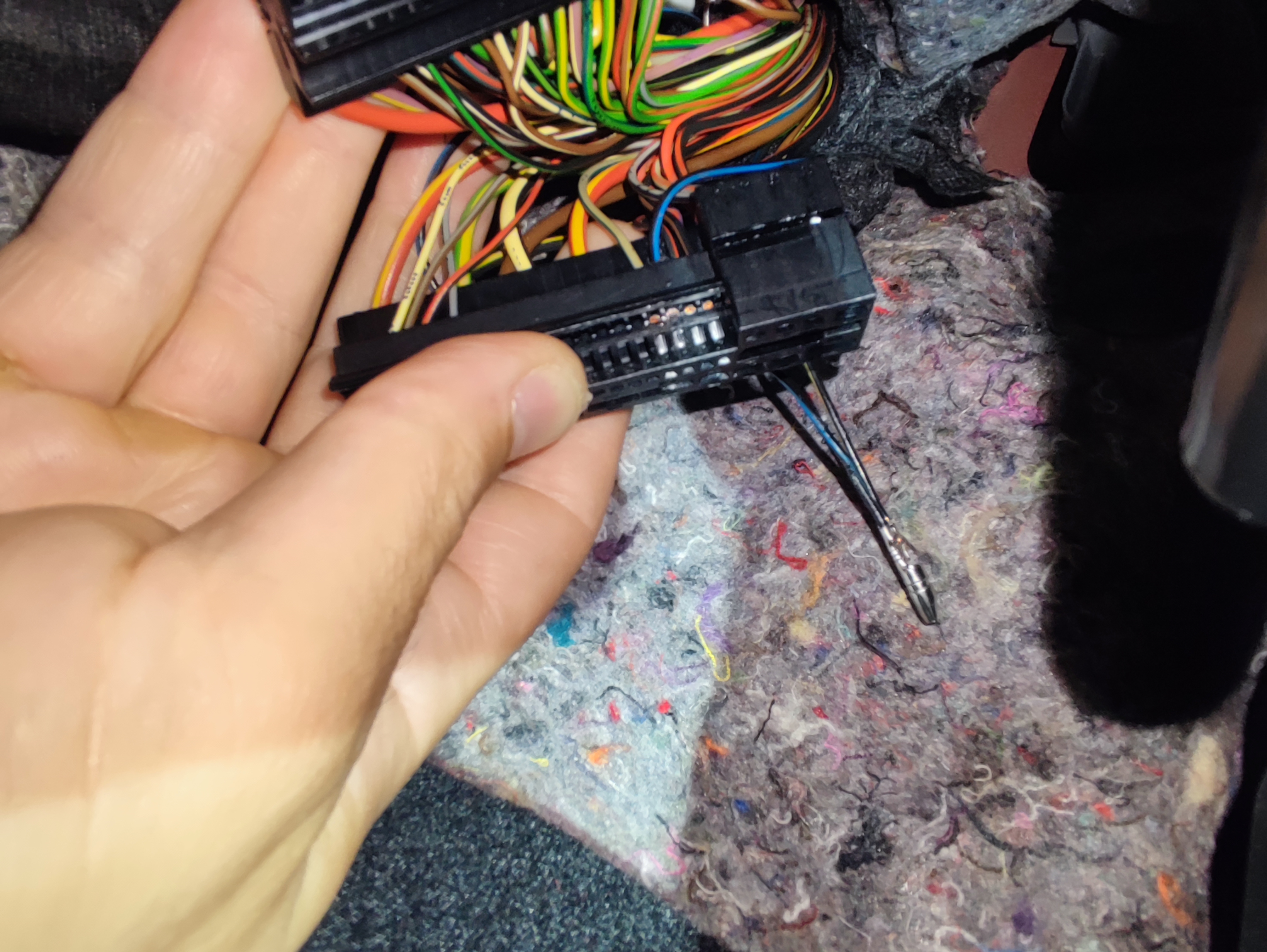

I put photos, right now the installation consists of an extension of the yellow/black cable with a small black/blue cable. I have joined these two cables with a connector that I had left over and it is very well protected with tape. The black and blue cable is connected to 73a/44 with the specific connector. With the multimeter mark continuity between
union cable yellow/black with black/blue and t73a/44.
I try to connect directly black/yellow cable to t73a/44? I have not done it already because the installation seems good and unmounting t73a/44 is complicated.

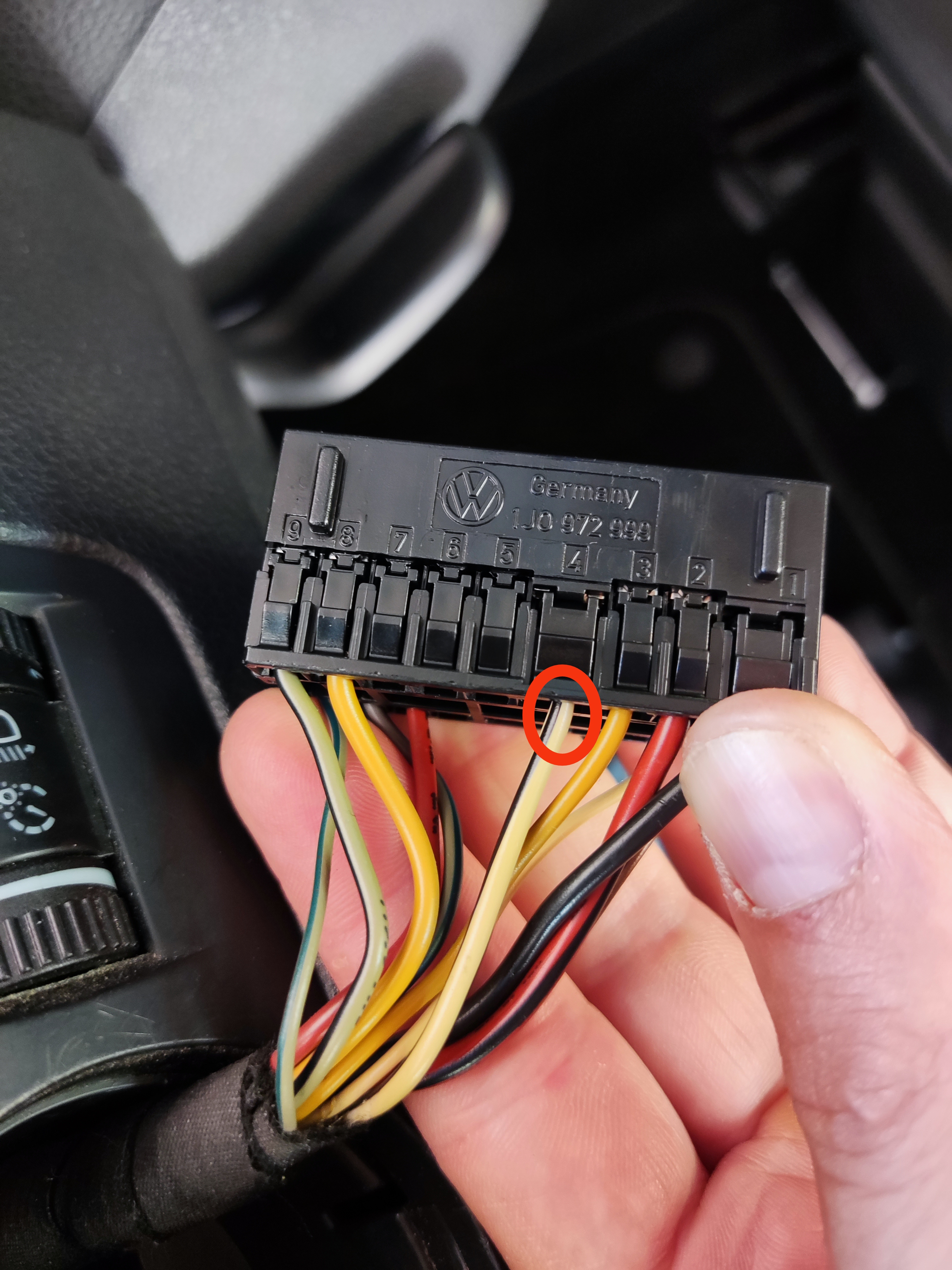

I have disassembled the light control connector, should there be continuity between this cable that I mark with the red circle and t73a/44?
Posts: 6689
No the circled t17/4 is to the stalks to operate the high beam switch. T17/1 (black) is +15

iichel wrote: Fri Sep 02, 2022 12:09 pm No the circled t17/4 is to the stalks to operate the high beam switch. T17/1 (black) is +15
What should be my next step?
Check continuity between t17/4 and t73a/44?.
Directly join black/yellow cable to t73a/44?.

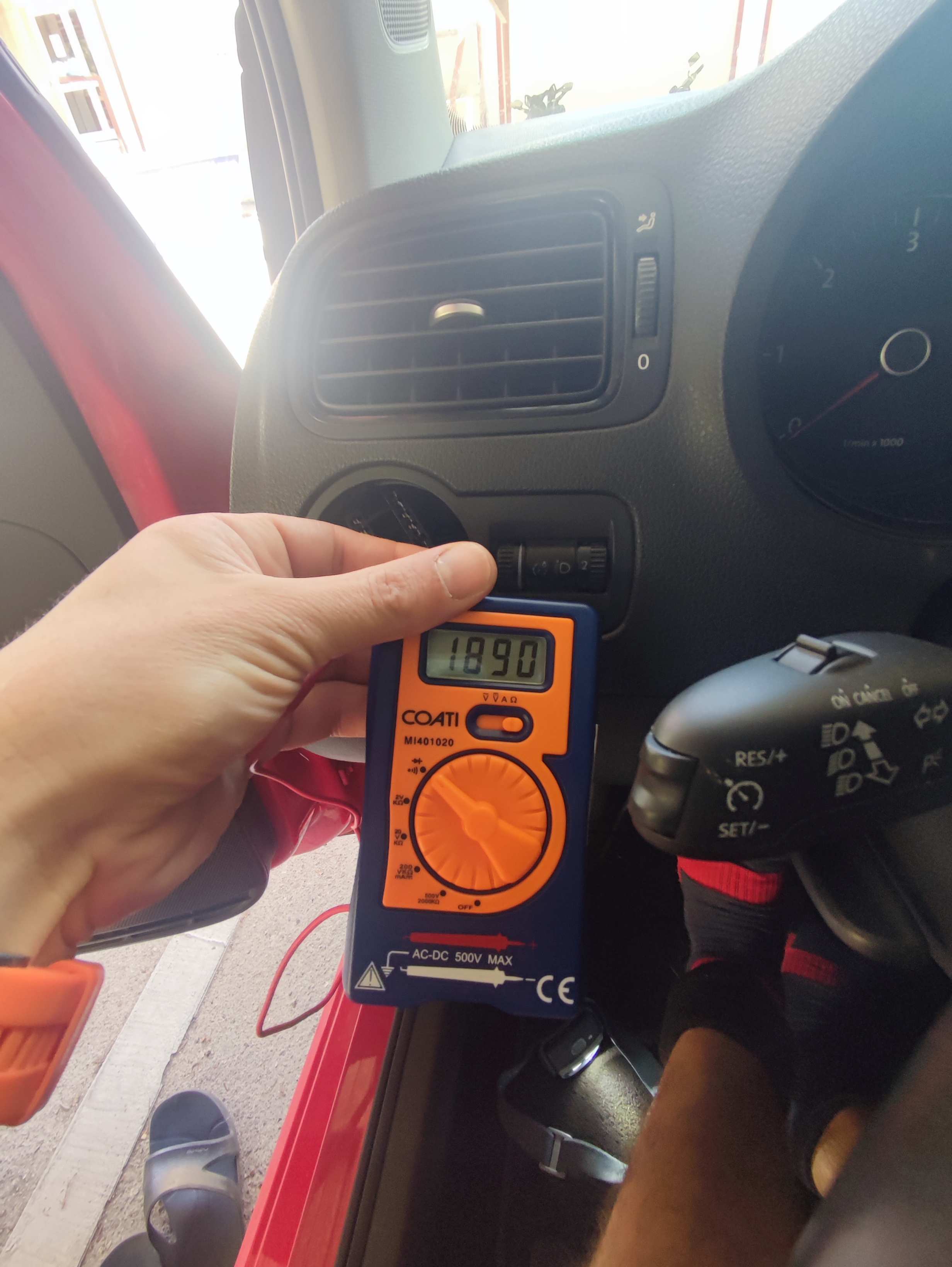

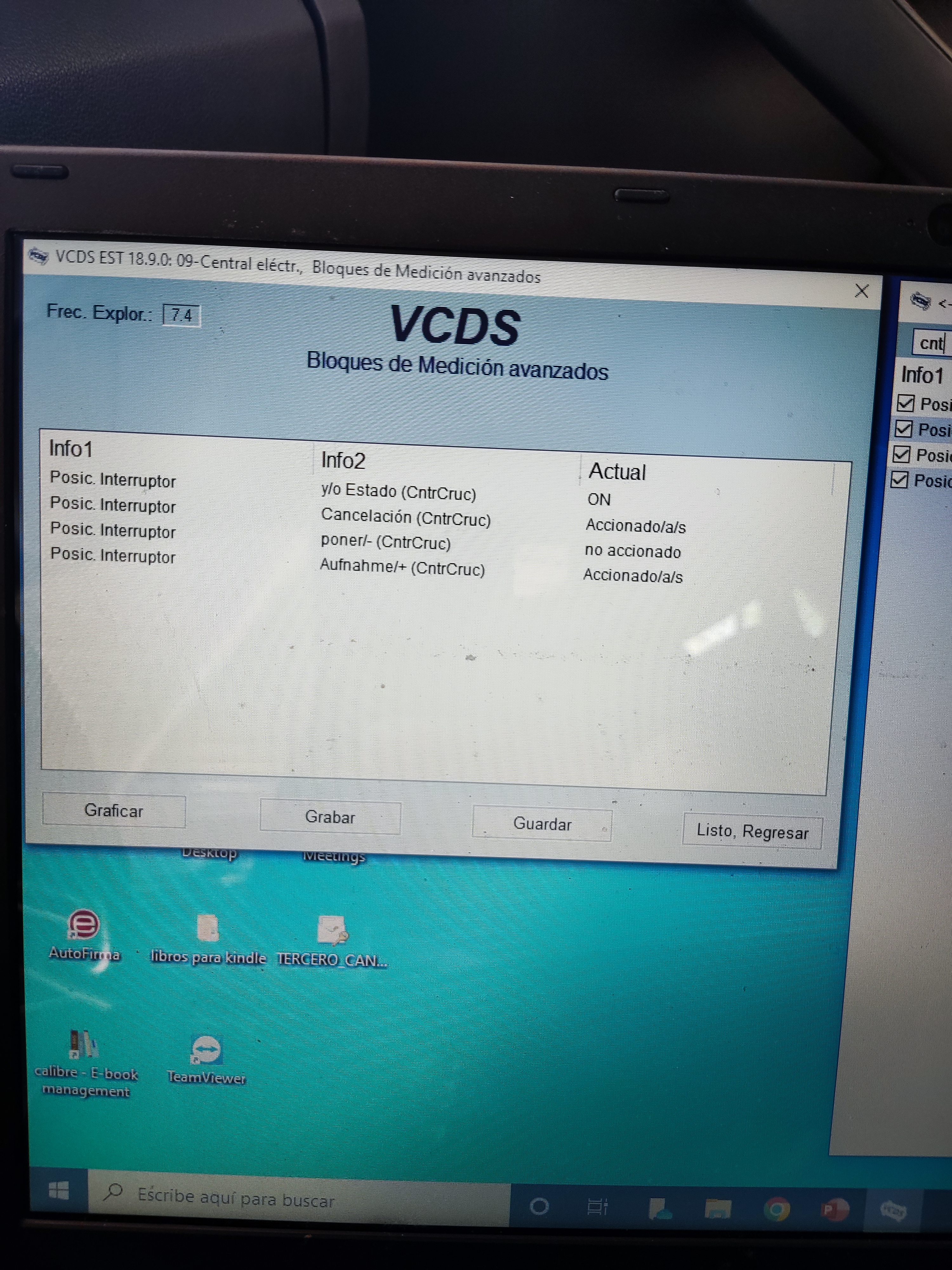

Post by Ritxi »

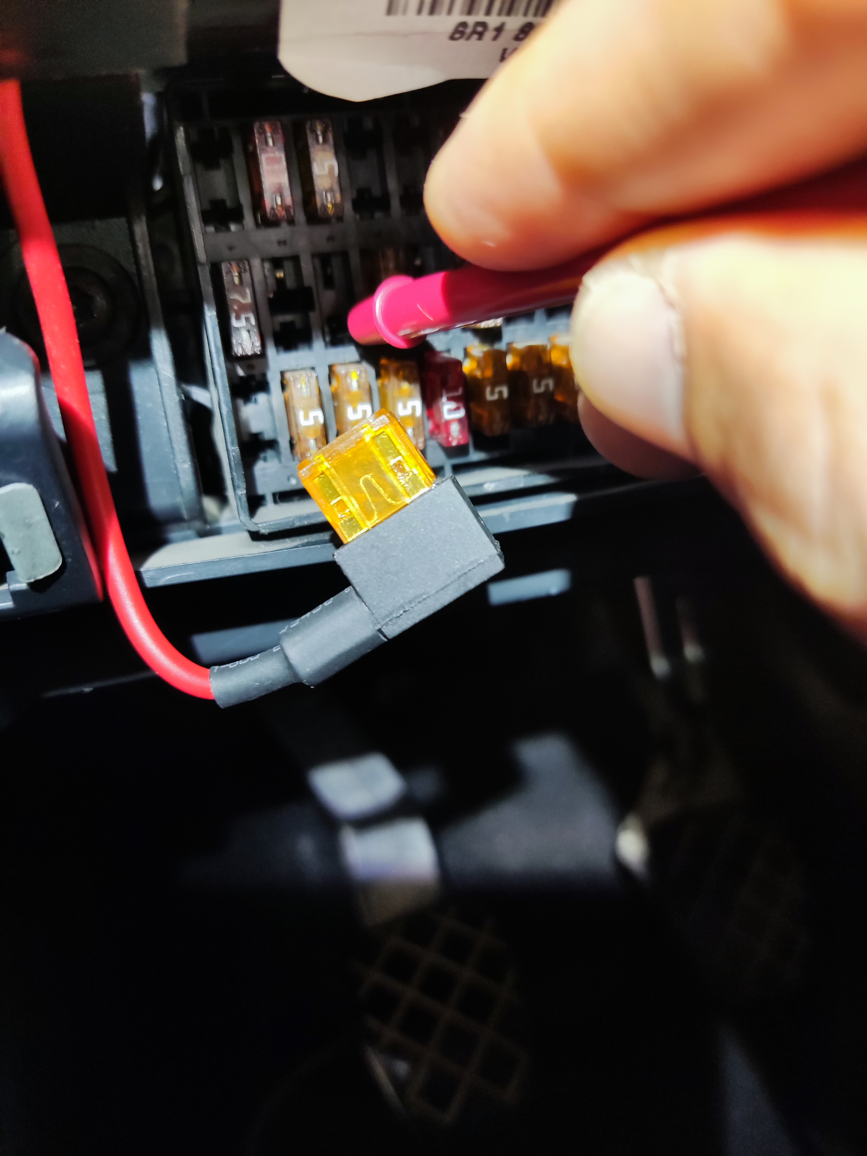

ciclo wrote: Fri Sep 02, 2022 12:35 pm Image
this is sb11b?
this measurement I get:
