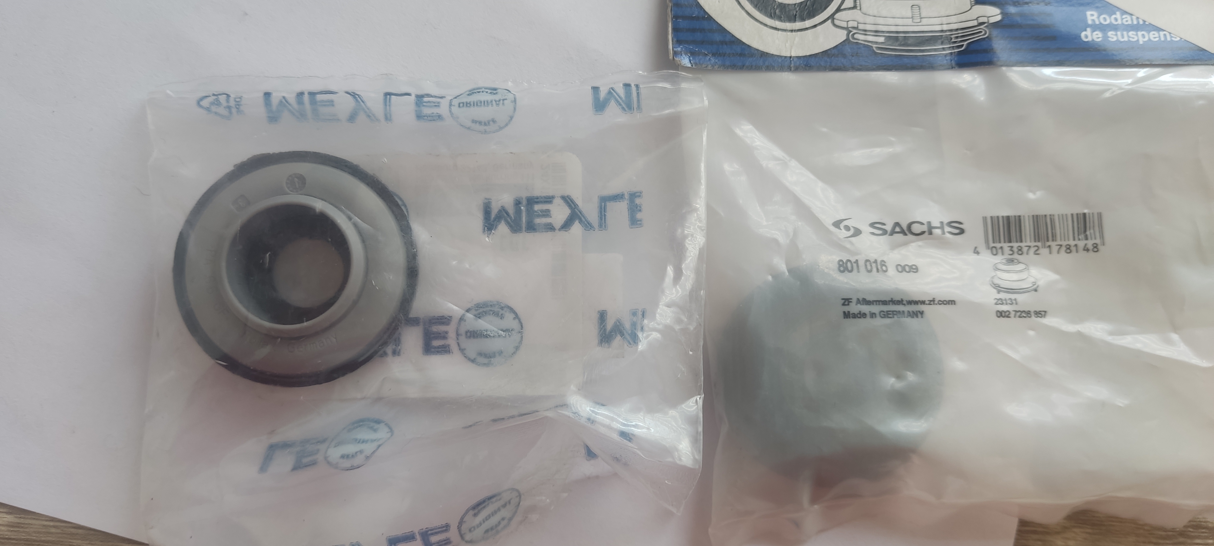

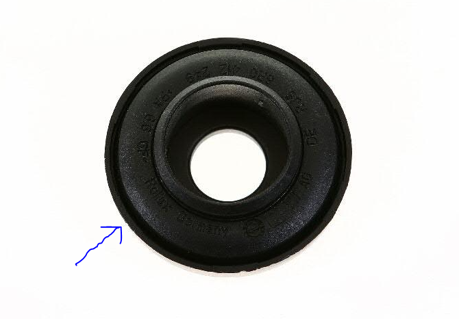

Strut bearing
Picture of OEM from etka
-Manufacturer Rollax Germany
Sachs
Weight 67 g.
-old version (mk4 golf etc.)
Part number: 801 016 009
Note: Sachs is actually incorrect ( no central locating ring) but can be fitted.
Meyle
Weight: 65g.
( On the bearing stamped Rollax Germany, same as the oem ( rollax) ). -
Part number: 100 641 0024
OEM:6R0 412 249
@CNK made a video explaining this
https://www.youtube.com/watch?time_cont ... th=MjM4NTE
But in my case, the first time i ordered Meyle, the "online parts" had issues with distributers. They gave me a call, i explained differences over the phone and why Febi, Sachs (golf version wont fit), they said we have Sachs it looks same as meyle and they delivered the wrong type...

it's annoying that these parts are theoretically replacements, but in practice tend to cause quite rapid squealing etc. strange noises when you install incorect set. I wrote an article about this once: https://polo.blue/choosing-the-right-sh ... w-polo-6r/
In my case, the Lemforder shock absorber bearing fitted perfectly with the plastic purple part from the KW V3.
