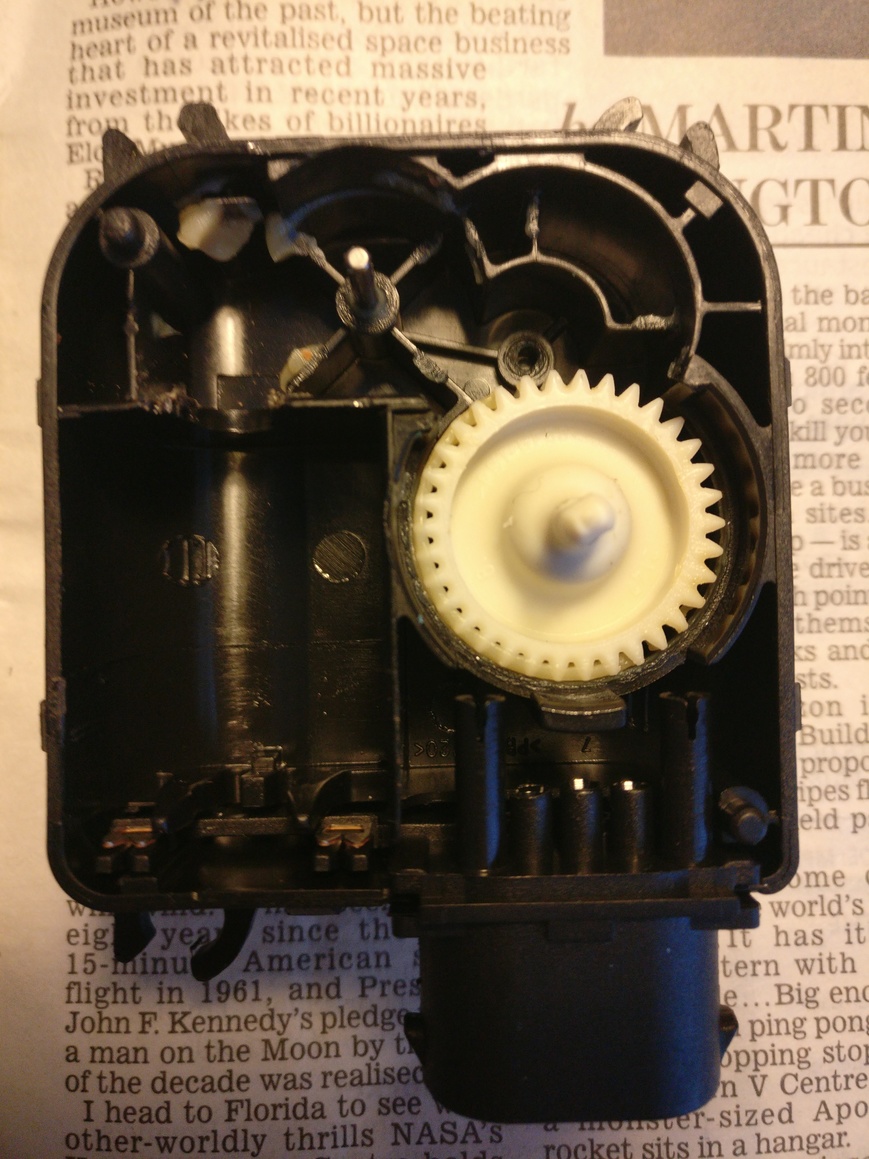

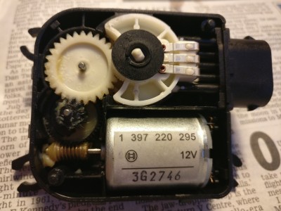

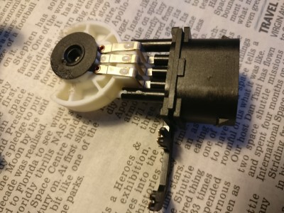

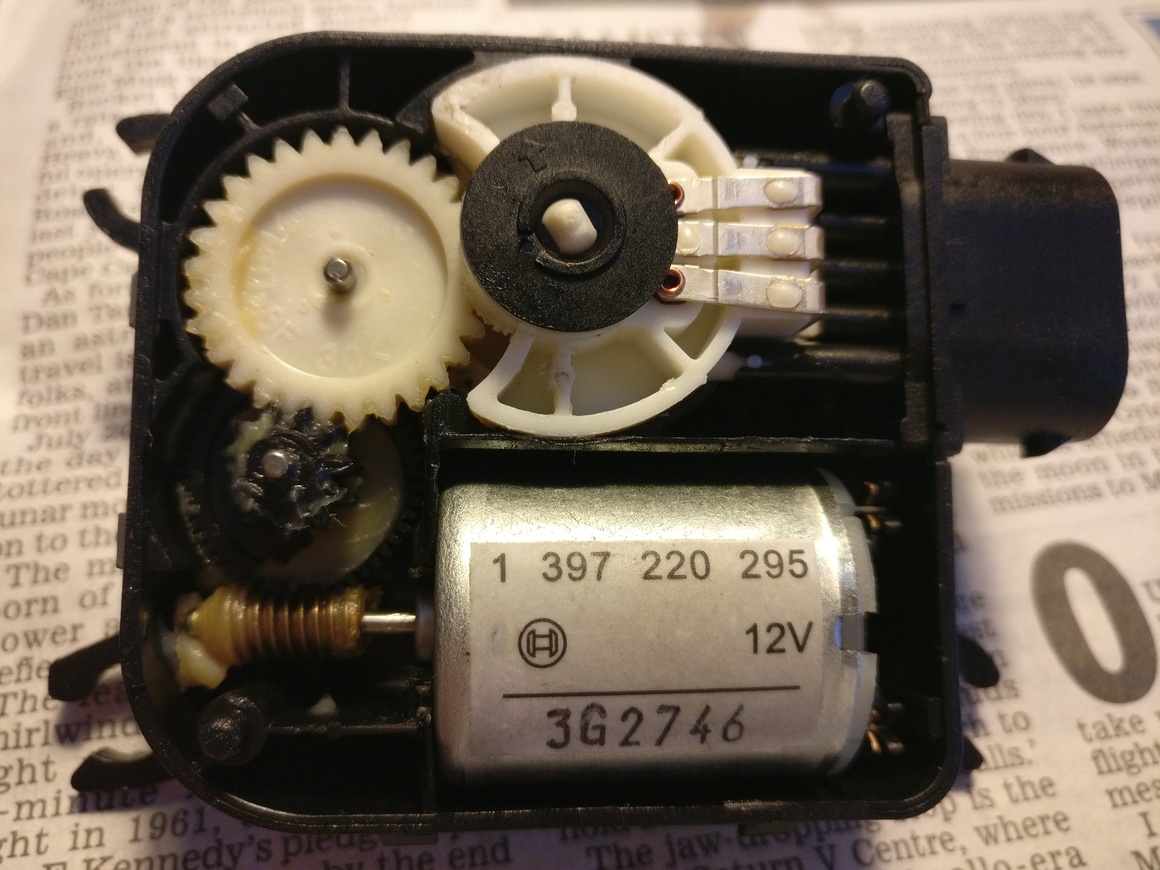

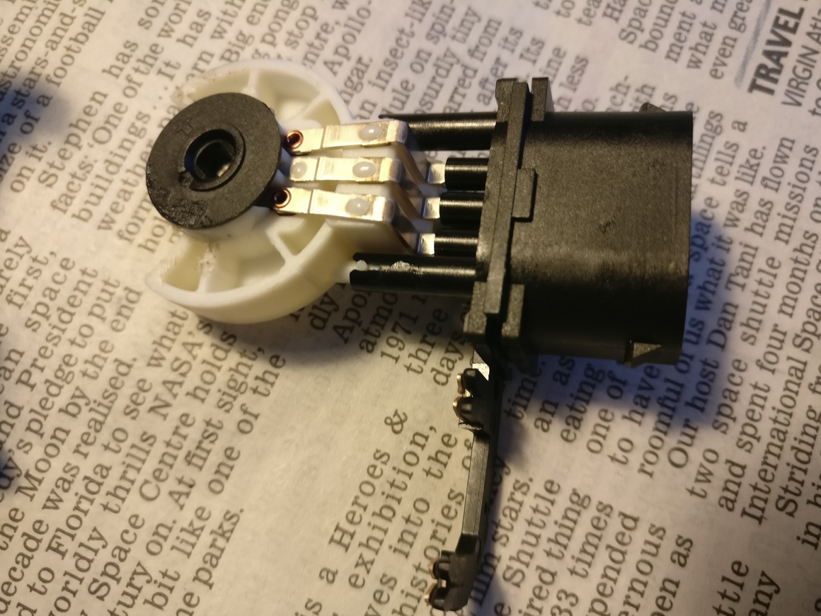

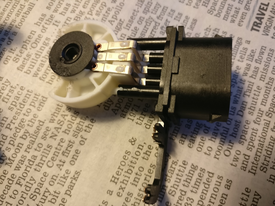

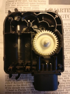

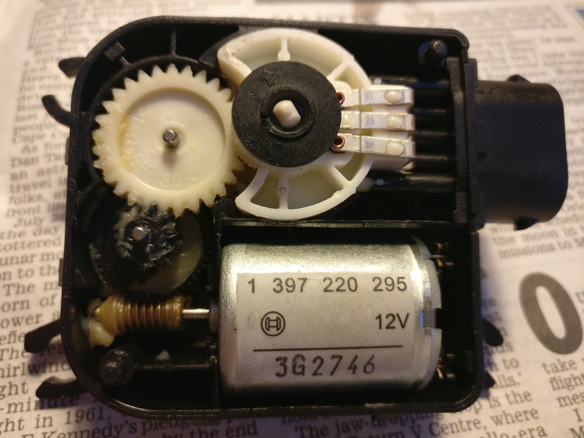

Surgery complete.
One thing to note is the connector assembly and pot can be lifted out together (see photos). I only discovered this after leveraging out the pot on the old motor. I used a marker pen to indicate the position of the gear on the original casing and ensured it was realigned on assembly with the new parts.
Reconnected the plug before reinstalling and checked operation. It appears the motor only goes from cold to open and nothing in between (at least I cannot hear it move in between those extremes). Is any kind of calibration needed?
Replaced the original large bracket without too much difficulty (the new one was not suitable at all).
- alexperkins
- Site Admin
- Posts: 14873
Re: Air con not working right? Replace the V68 motor - HOW TO.
Thats right. The air system on these is a bit of a strange beast
- Posts: 6079
You will need to "calibrate" it within the AC controller by performing "basic settings" using VCDS or similar, doing that lets the AC controller know where the mechanical endstops for that flap are, so it drives the motor to each end, ie until it detects no further change in the voltage on the feedback potentiometer, logs it as one end stop, then drives in the other direction, then logs the other endstop. From then on, the furthest it will command that flap motor to move is between these two endstop limits.

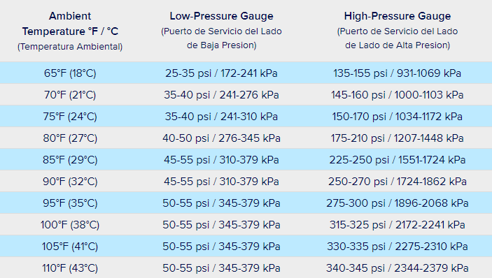

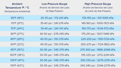

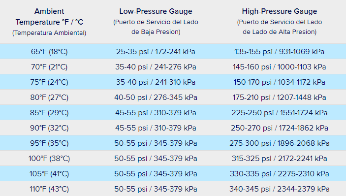

I could not find any info on what the correct gas pressures should be for the Polo, but did find the attached chart which is generic for R134a.
On this basis, the 4.2 and 5.0 Bar (engine off/on) I measured is low for the high side.
Going to book in with an AC specialist
