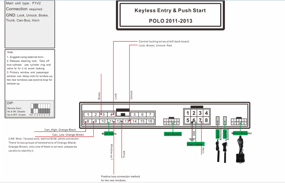

Two years back. when I saw KESSY working on Jetta. searched online. Found one link which took me to Ali Express. and in madness i bought PKE(Passive Keyless Entry system)for $300 :cry:
It is a canbus compatible kit. plug n play kit, only need to tape 5 wires
But i never dared to install it in my car. :|
can you please check this diagram and guide me? is this safe?
but now after reading your topic. again KESSY madness bite me. :D will really consider this.

it's a bit difficult to say whether it works. what happens to the immobiliser? what happens to the original keys? what signal does it use for authorization?

org key stay in car with coil
this is typical solution you can buy in china

yeah i figured so. not a good solution then.

If I ever plan for KESSY I will go your way. Source all OE parts n do. Not the PKE system. This kit I bought in temptation and hurry.
In above kit One original key should be kept in car always. We have to remove immo reader from key cylinder insert original key in it and hide inside the car near steering column because immo reader wires.
This kit comes with 2 seperate remote keys. We have to use that. This key will send authorisation codes to module inside car. If we go near car 2-3 meters car unlocks, same way if we go away from car it locks.
