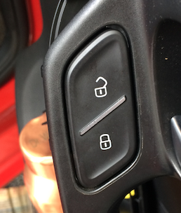

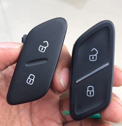

6C Central Locking Switch
6C and some of 6R have many parts that have additional details. One example being this central locking switch on driver door.
Existing switch looks plane Jane and 6C one has brushed metal as well as edges.
Here is how they look side by side.

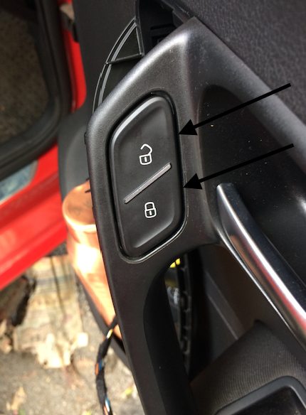

To change, you have to use the plastic trim removal to pull out door handle plastic trim. It is usual plastic clips lock mechanism.
No need to remove/loosen two screws.
Unplug the power connector.
Removing actual switch is bit tricky.
Access to one side of switch lets you remove two tabs that lets top part of switch which is a rocker get loose.
However there is no space to do same on other side. So use the plastic pry tools from top on inside/door side of switch gently.
Here is how it looks at daytime
Here is how it looks once illuminated
Part Number -- 6C2962125B

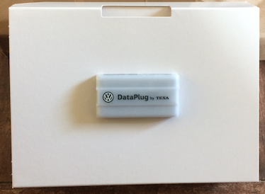

VW Connect Data Plug 5GV051629L
This was out of curiosity of "what does VW Data Plug would show?" (when you have VCDS ;) ) I bid and bought a data plug.
Ebay seller was selling 5GV051629J but surprisingly I got 5GV051629L.
Still I am not sure if I was/am fooled. But think L > J this is newer version I am keeping a smiling face :lol:
After plugging it in, got it working.
iPhone App - "We Connect Go" needs you to select "Service Partner" as part of application configuration.
Also you need to create an account and give consent to use Basic Profile, email, address and phone number.
Addition to bluetooth, mobile data or wifi, location should be on to get all things working.
Here are some pictures :
Neat Packaging from eBay seller
Front of Box
Rear of Box
Actual Plug
3 feet long/wide multilingual manual

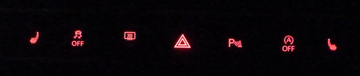

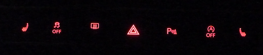

ag69 wrote: Mon Sep 23, 2019 12:19 pm Very honestly illuminates images (shared here) does not do justice. The color looks orange here where are in reality they are Red. To match rest of interior.
Assume this is more towards red ;)
Clicked with digital camera with forced flash off
with Panasonic digital camera

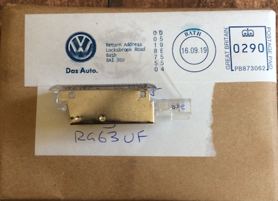

(Need Guidance) Rear Passenger, Boot and Glove box Light
My car has company fitted front foot well. They are under dashboard for driver and passenger. They are 7L0947415 which has 5W5 bulb.
Dome light (6Q0947105M) which has a single 10W bulb.
As i am bit fan of male female connectors and or have less guts to splice cables. I have made one so i can run these additional lights for rear passengers, boot and glovebox.
There are 5 numbers of 7L0947415 which i have procured.
Expected to behave same as existing lights ie light up on door open.
10W (dome) + 2x 5W (footwell) = 20 W is current total consumption
If i add additional 2 footwell, 2 boot and 1 Glovebox then consumption would be 45W odd -- recipe for blow fuse.
