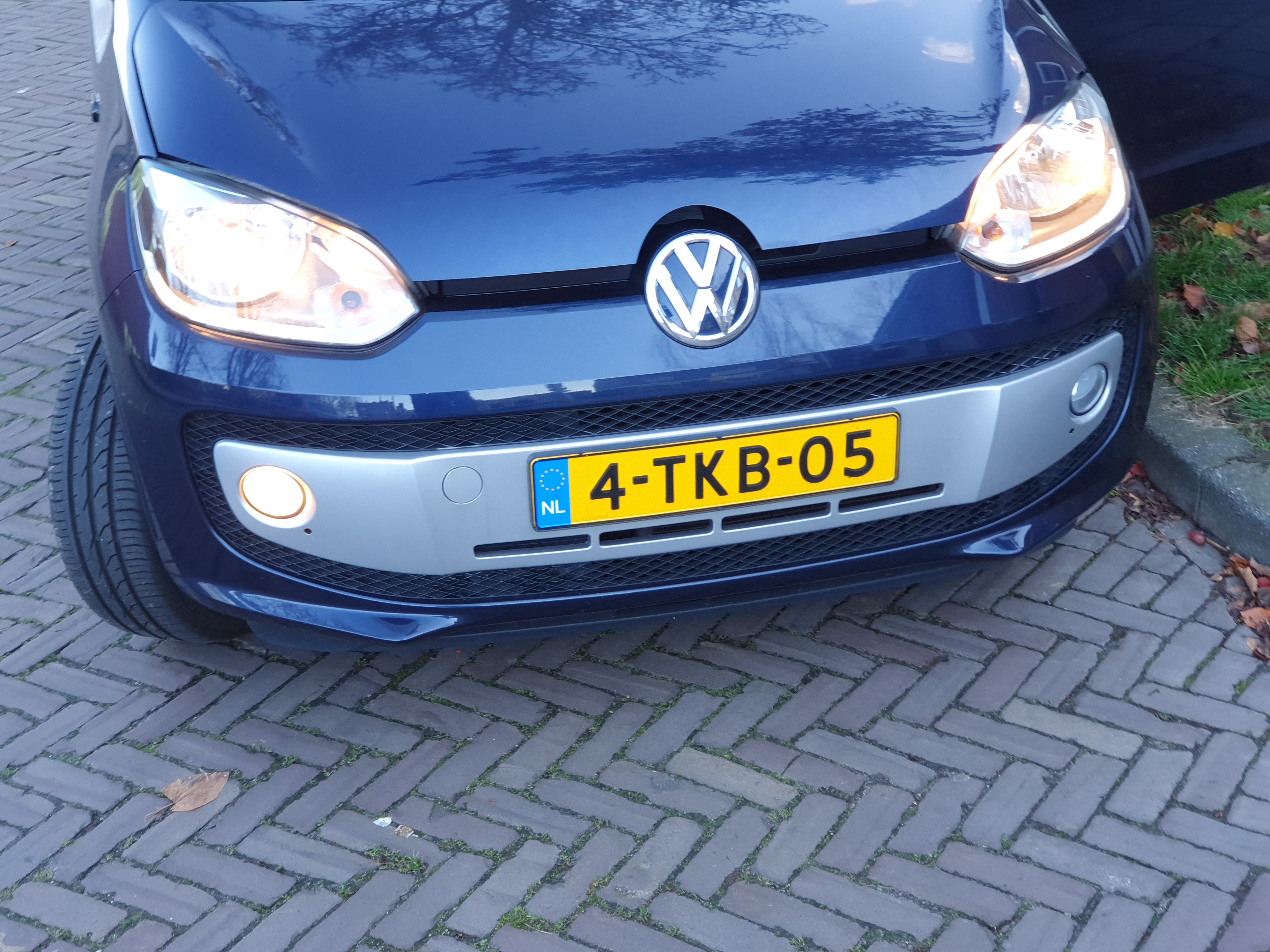

My car has DRL ?? I seem to learn new stuff every day ^^
I just checked my front lights and there are 3 bulbs:
- turn light bulb
- dipped/main light bulb
- parking light bulb
If I see it correctly this parking light bulb is a dual fillament bulb, so one of its fillaments is for the parking light and the other for the DRL ?
I just checked (by removing SC22) that indeed these bulbs burn brighter when SC22 is present and weaker when SC22 is removed.
But basically the DRL lights seem to have almost the same behaviour as the parking lights, but parking lights won't go off when low beam is active.
If I remember correctly the DRL fillament (brighter) does go off when low beam is active, and this behaviour is mandatory correct?
Okay, more to rewire then!
The rear turn signals can remain on pins T73b/5+6 ?
Rgs H2Deetoo

Yes your VW up! Does have DRL as it is mandatory here in the Netherlands. It indeed has a dual filament bulb with parking light and DRL.
Posts: 9037
Re: some errors after upgrading 1S0937087D bcm to 1S0937090F
Yes, it is the same bulb with two filaments, for parking/side lights (less bright) and daytime running lights (brighter).
- DRL ON only with the light switch in position 0, or lights turned off with automatic lights (AUTO switch, RLS).
- DRL OFF in any other position of the light switch, or lights turned on with automatic lights.
- Parking/side lights should remain ON whenever the low beam are ON, and should remain OFF with the light switch in position 0.
Yes, wires 5b, 6b will remain in place.

Finally had some time today, and luckily the weather was perfect also, to reconnect my front and rear fog lights to the BCM (instead of the light switch).
The front fog lights are now under BCM control and this allowed me to enable static corner lights through my fog lights.
Very nice :)
Basically I did the following according to the info provided on this forum (mainly by ciclo):
Fog left connected to T73b/9 (other fog signal to GND)
Fog right connected to T73b/10 (other fog signal to GND)
Light switch fog front output T17/8 connected to T73a/7
T73b/11 is the power input for the fogs and DRLS which was already present in my car (black/gray 1mm).
I left it as-is for now, but I plan to figure out where it comes from and how it is fused.
If I can't find out, then I will add a new wire from 30+ fused with 15A as recommended.
(Fuse SC50 was removed in the process, but can be used now for the 15A fuse I mentioned here above.)
