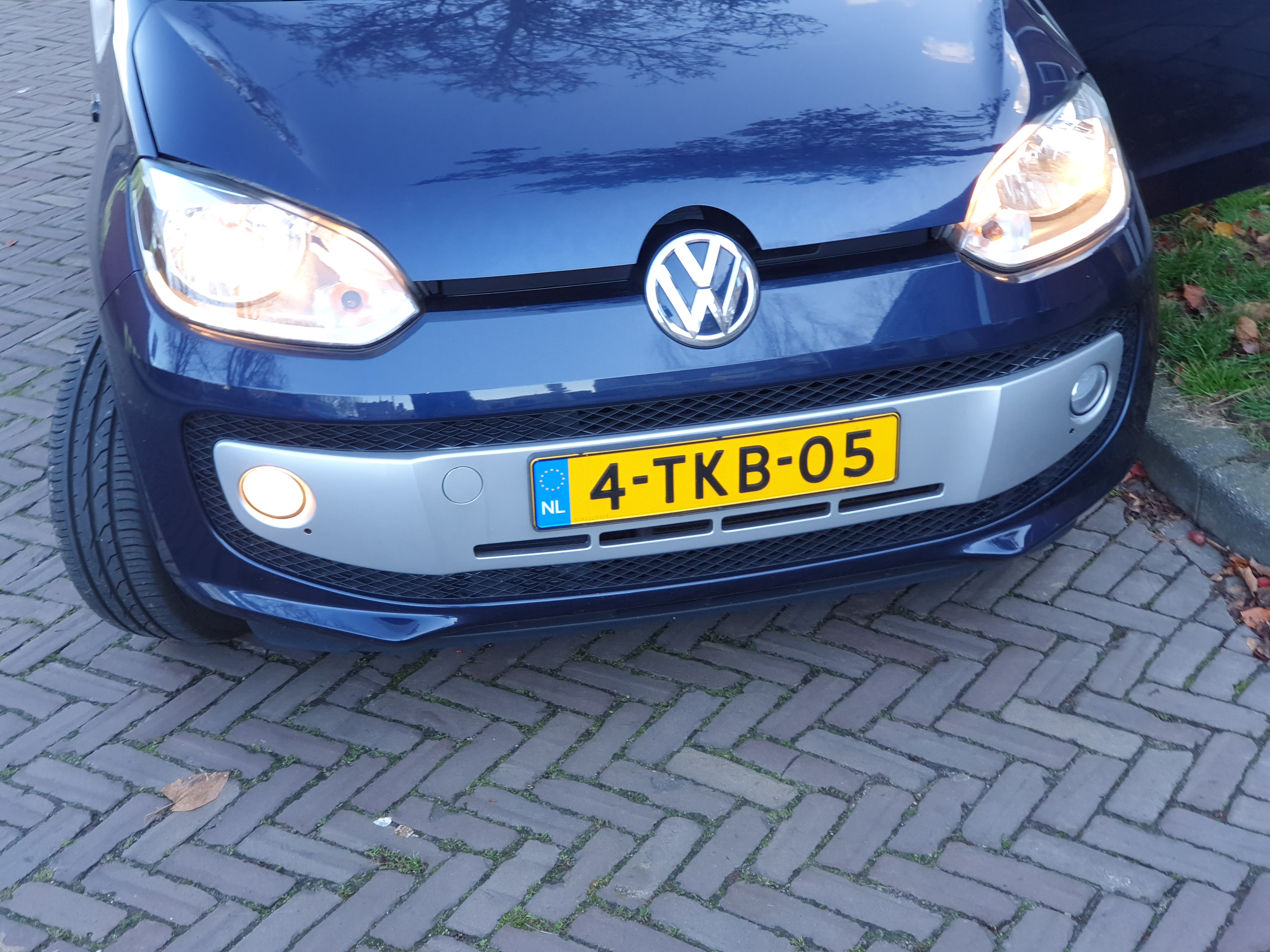

My car has DRL ?? I seem to learn new stuff every day ^^
I just checked my front lights and there are 3 bulbs:
- turn light bulb
- dipped/main light bulb
- parking light bulb
If I see it correctly this parking light bulb is a dual fillament bulb, so one of its fillaments is for the parking light and the other for the DRL ?
I just checked (by removing SC22) that indeed these bulbs burn brighter when SC22 is present and weaker when SC22 is removed.
But basically the DRL lights seem to have almost the same behaviour as the parking lights, but parking lights won't go off when low beam is active.
If I remember correctly the DRL fillament (brighter) does go off when low beam is active, and this behaviour is mandatory correct?

Yes, it is the same bulb with two filaments, for parking/side lights (less bright) and daytime running lights (brighter).
- DRL ON only with the light switch in position 0, or lights turned off with automatic lights (AUTO switch, RLS).
- DRL OFF in any other position of the light switch, or lights turned on with automatic lights.
- Parking/side lights should remain ON whenever the low beam are ON, and should remain OFF with the light switch in position 0.
Yes, wires 5b, 6b will remain in place.

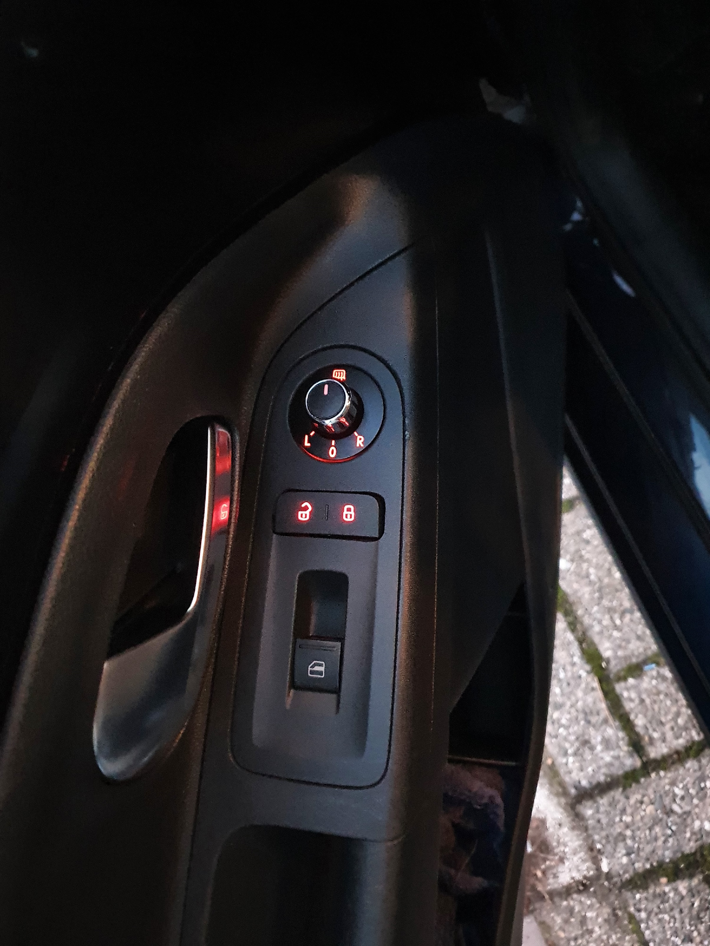

Mirrorknob and central switched illuminated already:
Now waiting for the rest of the parts...
Rgs H2Deetoo

The window switch backlight is missing, and the central locking switch looks like it came from other worlds ...
We deserve a slight explanation in this regard. :lol:
Re: some errors after upgrading 1S0937087D bcm to 1S0937090F
Posted: Fri Oct 23, 2020 9:06 am
by H2Deetoo
Yes, sorry, I only quickly updated this topic last night.
Here follows some more detailed explanation:
After doing some research it seems its fairly easy to fix button illumnination in VW UP and co:
- Mirrorknob -> Just swap it with that of a Polo, same connector so straight fit.
- Central lock switch -> You can use switch of a Transporter T6 7E0962125B, same connector so straight fit.
- Window switches -> Open them, solder missing led and resistor to pcb, and then use switch heads from Golf6 because they allow light through them.
Of course this can only work if you add +12v (either from ignition of from ambient light signal T17/16) to the various switches.
I used the ambient light signal.
The window switches I ordered for Gofl6 haven't arrived yet, that's why they're still dark (but the led is already in place and shining).
The T6 switch had me misguided a little... the connector does fit and it looks simimlar to the UP switch but it just won't fit properply.
Solution is to cut a little bit from the top frame.
It was my first time cutting/milling, so I am pleased with the result, however I'm sure with better equipment I can do a better job.
Regards,
H2Deetoo
Posted: Fri Oct 23, 2020 9:17 am
by ciclo
Excellent! thank you very much for the explanation / info. 👌

Finally had some time today, and luckily the weather was perfect also, to reconnect my front and rear fog lights to the BCM (instead of the light switch).
The front fog lights are now under BCM control and this allowed me to enable static corner lights through my fog lights.
Very nice :)
Basically I did the following according to the info provided on this forum (mainly by ciclo):
Fog left connected to T73b/9 (other fog signal to GND)
Fog right connected to T73b/10 (other fog signal to GND)
Light switch fog front output T17/8 connected to T73a/7
T73b/11 is the power input for the fogs and DRLS which was already present in my car (black/gray 1mm).
I left it as-is for now, but I plan to figure out where it comes from and how it is fused.
If I can't find out, then I will add a new wire from 30+ fused with 15A as recommended.
(Fuse SC50 was removed in the process, but can be used now for the 15A fuse I mentioned here above.)
The rear fog was even simpler to connect:
T17/9 is rear fog output signal is connected to T73b/43 (rear fog input signal).
T73a/6 is rear fog output power which is connected to the original wire which was connected to T17/9 (going to rear fog light).
Next job would be to reconnect the DRLS to the BCM.
After that mean beam using relay and auto light wiring as provided by ciclo!
Best regards,
H2Deetoo
