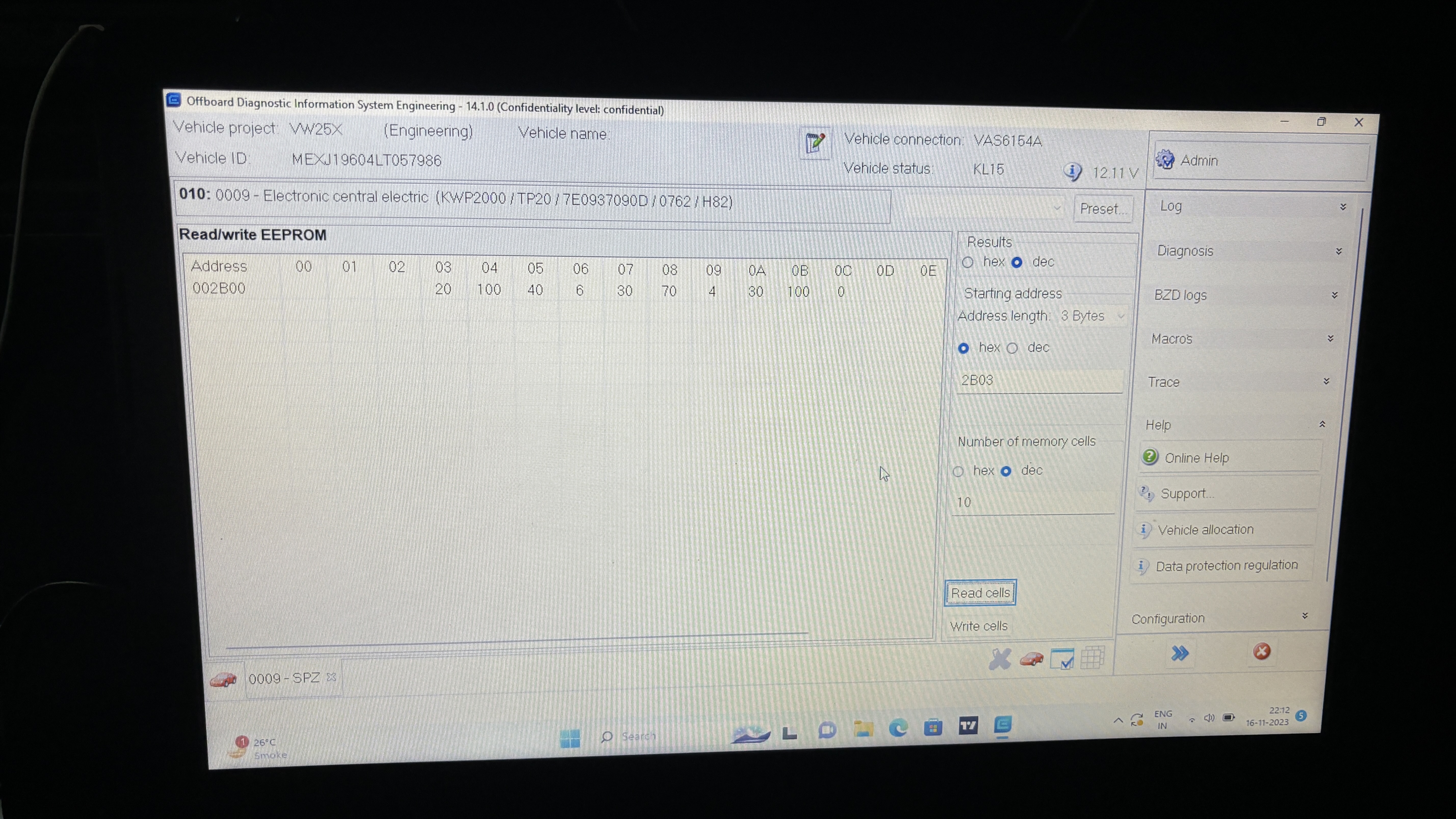

So i did try the above code you mentioned. Still no parking lights when headlights are on.
Also with the headlights on when I use highbeam flash function the low beam flickers once to twice. Sometimes the right side sometimes the left side.

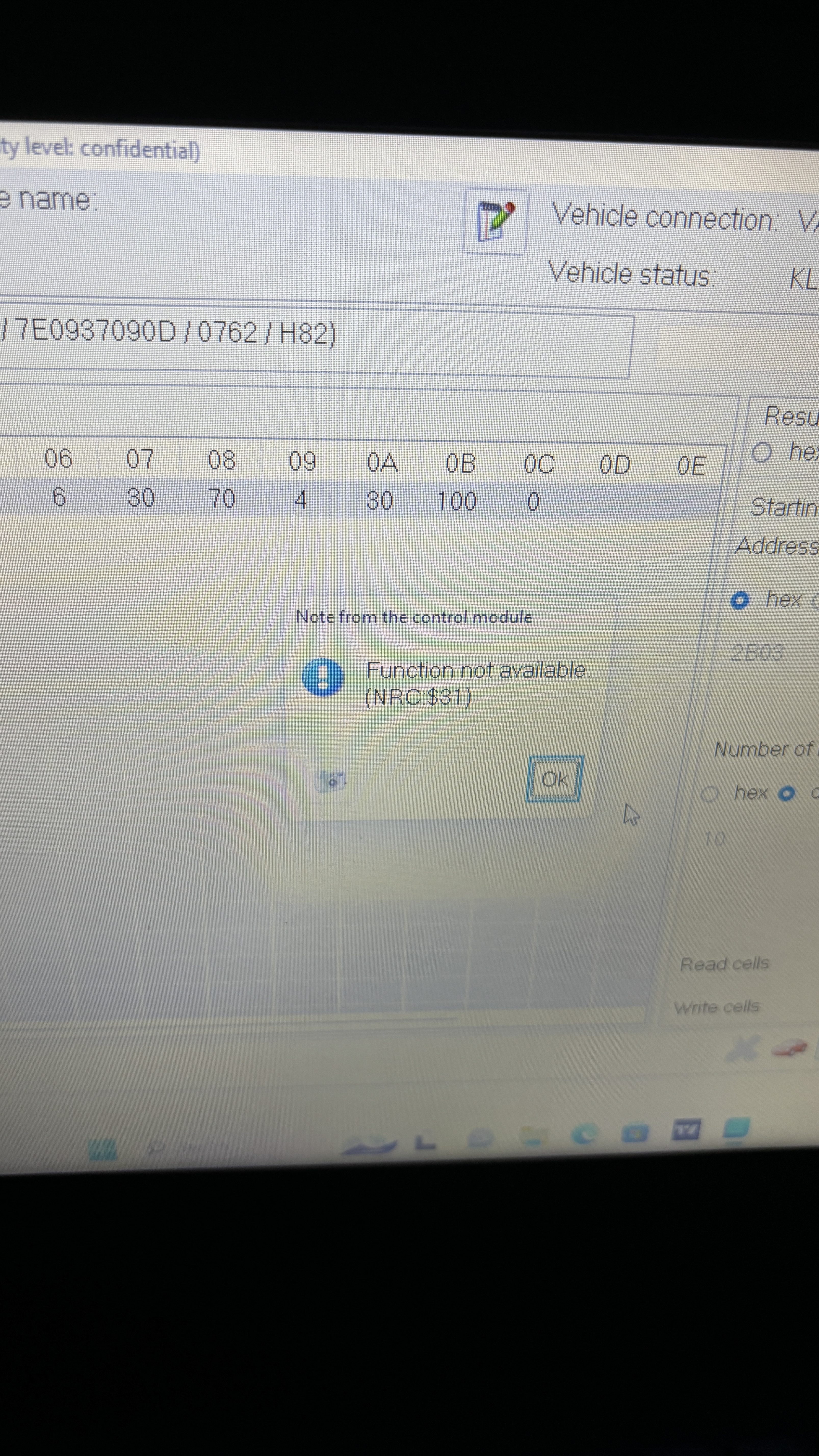

Also an update since I purchased odis for tpms and mke fatigue level, I was able to check the eeprom of BCM
Did use the following Security Access 84244
Checked 2B03 and the value is 20
But when i try to edit it to 28 and write it, it gives me an error. Have attached the pictures below. Please if possible check and let me know if i am doing something wrong
Software used is ODIS Engineering
Thank you in advance for your help.

are you sure you're looking at the right address in bcm eeprom?
viewtopic.php?p=591139#p591139

Hi iichel,
As per your thread which you have linked, the above address is for pwm control for parking lights and pwm control for tfl lights?
Sorry have no idea about eeprom stuff thats why so many questions.
Regards.
Re: Aditya's Polo 6R GT TSI 1.2
Posted: Thu Nov 16, 2023 8:53 pm
by iichel
i think this will solve the high beam issues you're experiencing
Posted: Thu Nov 16, 2023 8:56 pm
by adityagttsi
Ohh i dont have the high beam issue if i use 67 in byte 18.
The only issue i have is parking lights not working with headlights. The address 2B03 is correct the for pwm control of parking lights?
Since i had odis I thought will check the value of the same. As i read on this forum that if value is not 28 parking lights dont work properly with LED headlights.

Yes, address 2B03 is correct.
I have never written the cells in the eeprom of a control unit with ODIS E, however you have the manual on how to do it on your computer.
Find the manual on your computer:
By double clicking on a row or with the "F2" key the user can activate an editing dialog for the selected row... Keep reading...
Known security accesses for the BCM/GW: viewtopic.php?p=556619#p556619
30724
84244
The other addresses for the flickering lights issue indicated in the link posted by iichel.
Posted: Fri Nov 17, 2023 10:07 am
by ciclo
Functions to read or write memory cells are available in the list of control units in the "Diagnostic functions" section as input "010.02 Memory cells".
Example:
:arrow: :arrow: :arrow: https://www.drive2.ru/l/6279307/

Hi ciclo,
Yes i did use memory cell options 10.02 for read/write eeprom.
But it doesn’t seem to work. I am able to read eeprom with 84244, but not able to write it. It shows the above error.
Have used end of assembly mode also but no success.
Currently using ODIS E 14.1. Is this a problem? Should I use a lower version? With this version was able to flash the mke fatigue level and tpms dataset but not able to do this
Should i try different project? Current using VW25X
Regards

Function not available error pops up when necessary conditions are not met for that particular job. I too see it sometimes in my ODIS-E 14.1.
What I do when above error pops up is, restart the ignition ( engine off ), rerun the diagnostic session and repeat the process. Works for me. Sometimes it takes few attempts!
Plan B: Try to find original VCP near you, it's much easier with it. :wink:

Hi everyone,
Thank you ciclo, patil and iichel for all the help.
But unfortunately the ODIS Engineering I have is not able to edit the EEPROM. Maybe its because of the device or software, not sure about it. Now need to search someone who has VCP so that I can get this issue rectified as soon as possible.
In the mean time I was able to get a hands on BCM Max 090C that supports LED Lights. With this I checked the coding and everything works fine that means no issue with wiring or headlights.

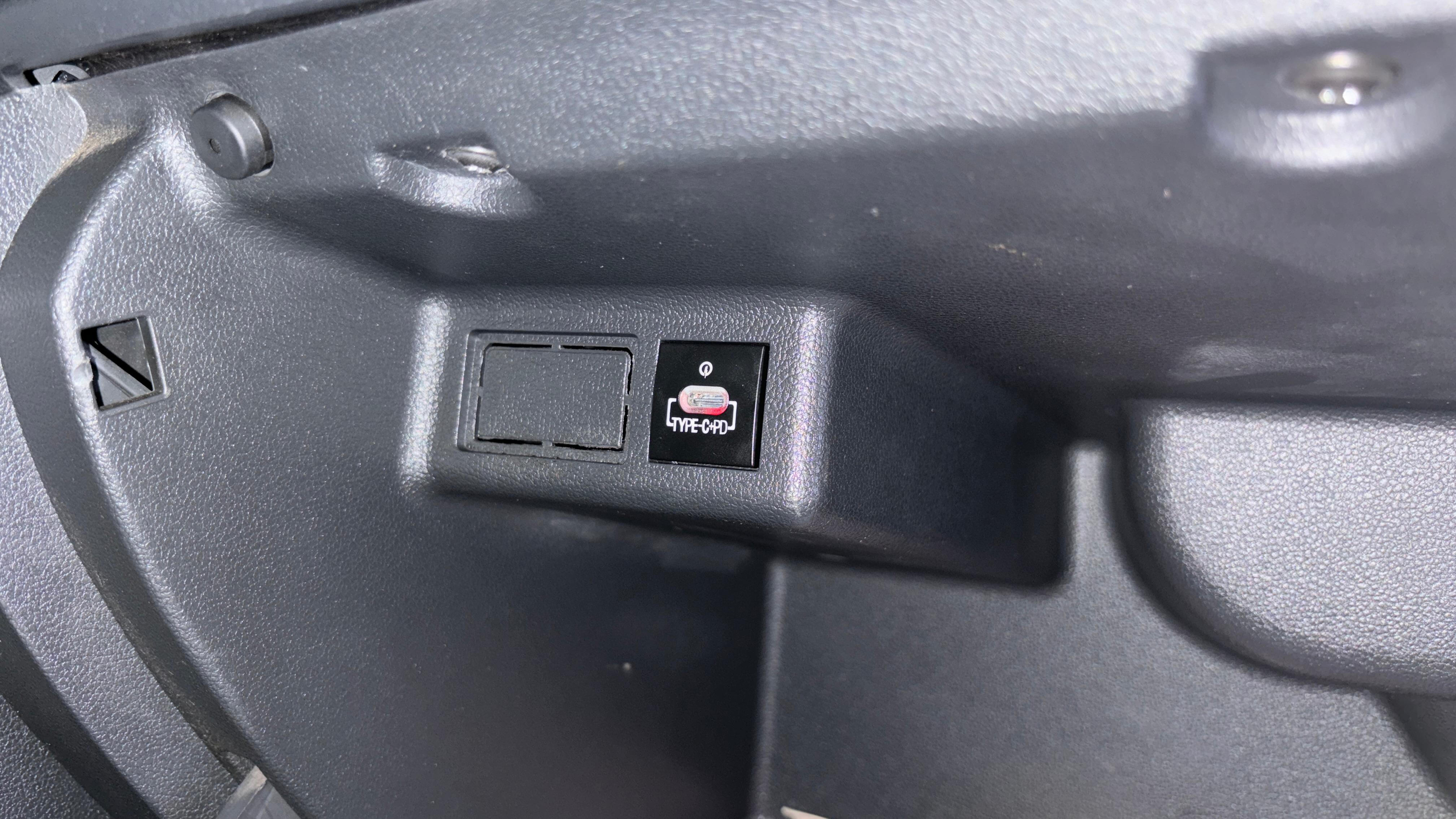

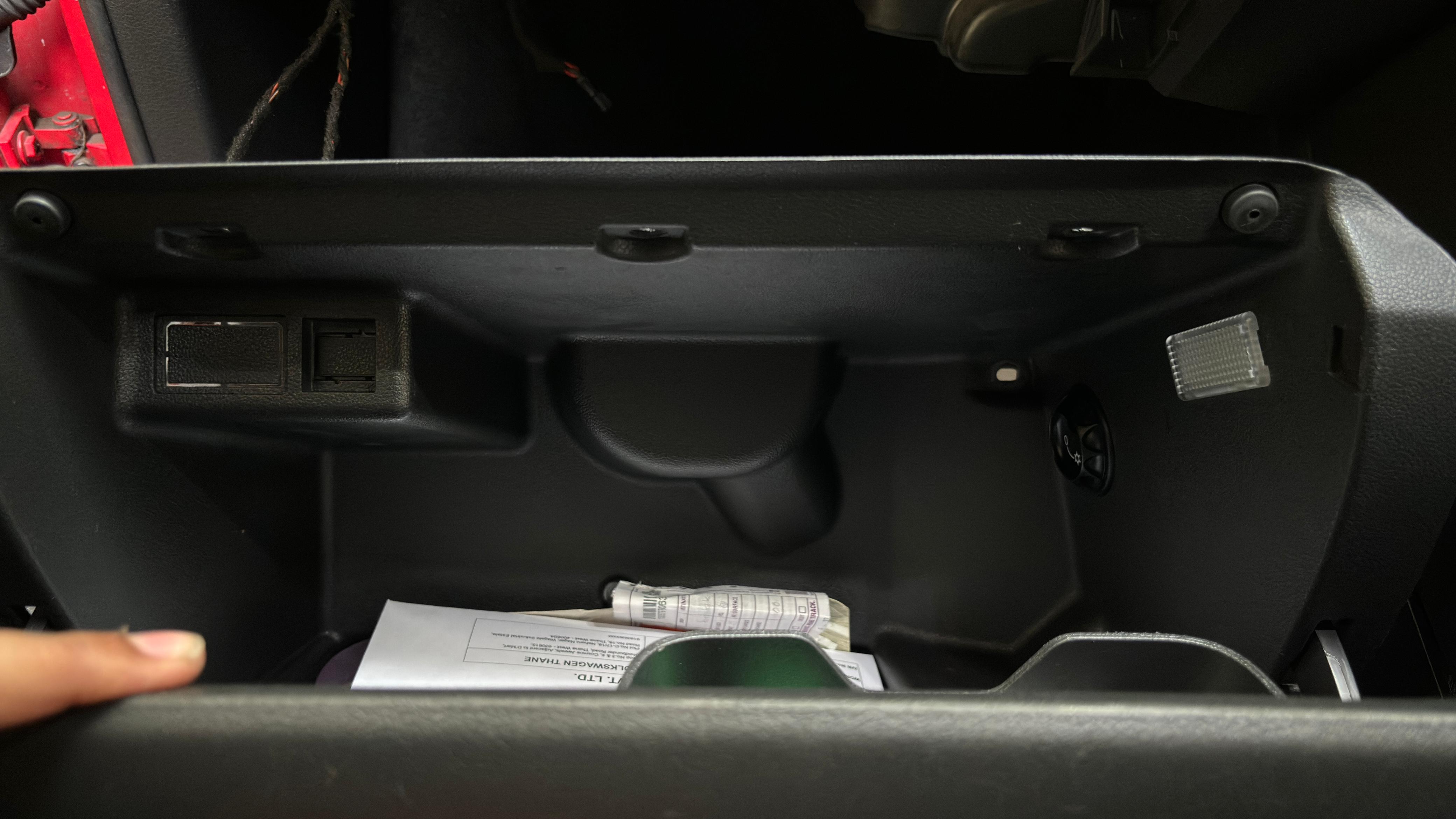

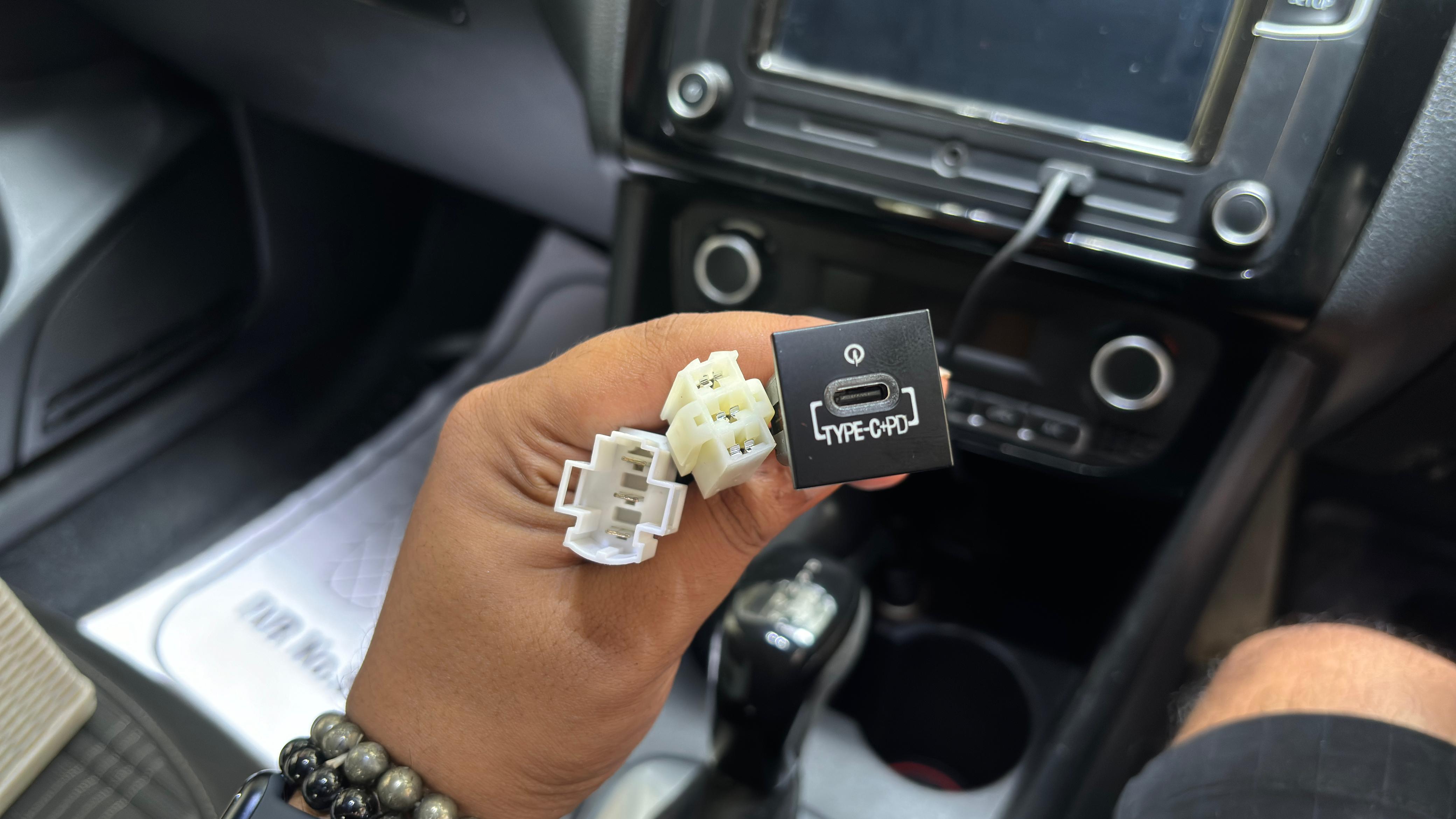

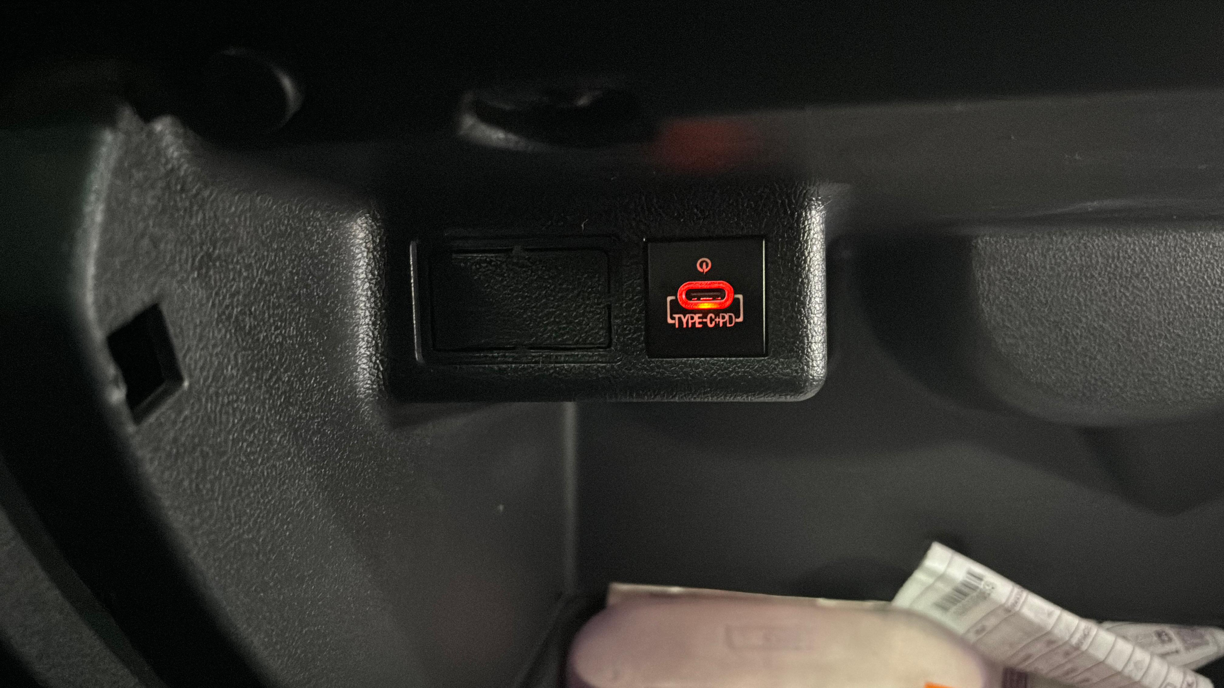

Type USB C Charger for Polo 6R

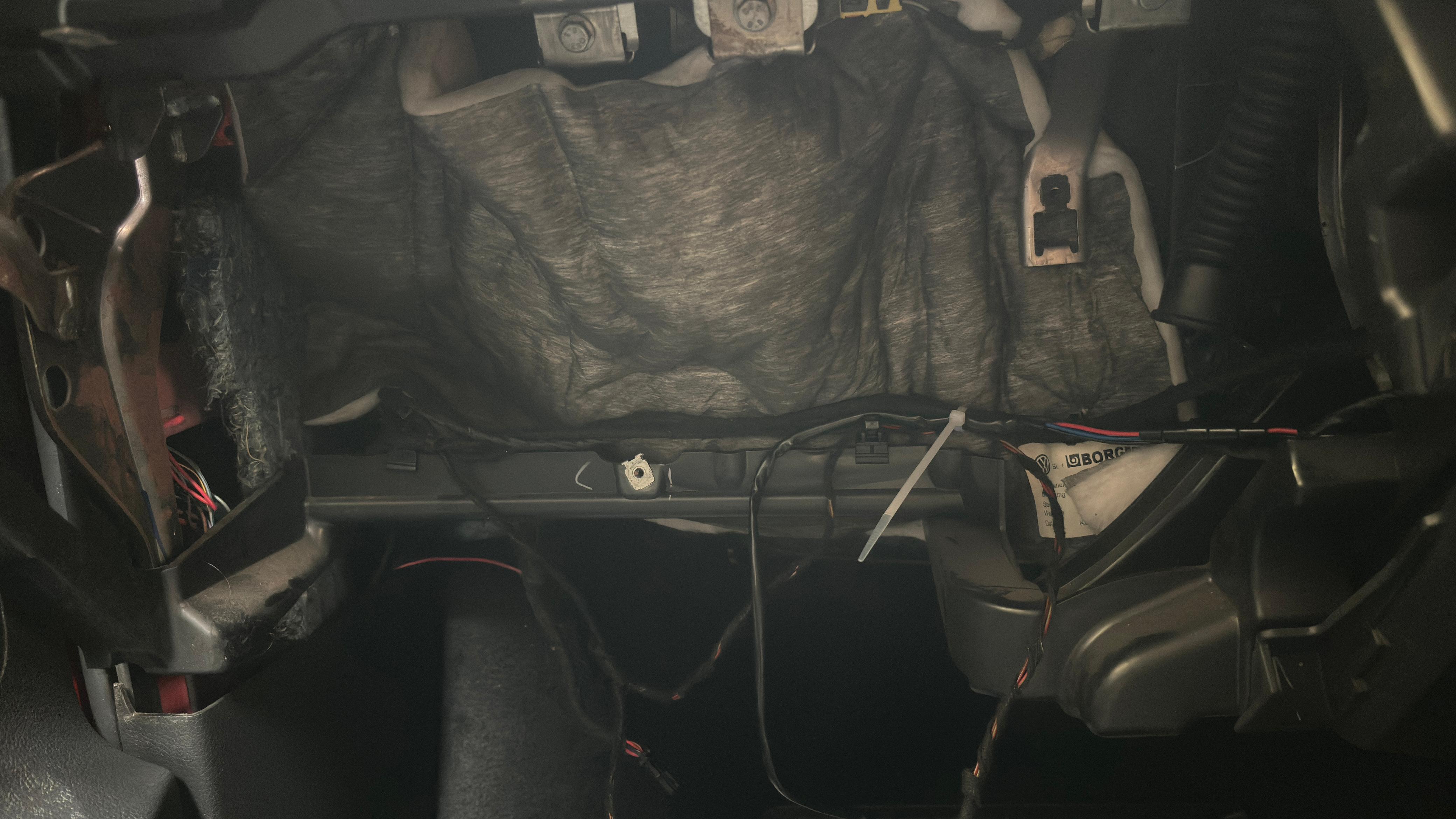

Type C USB Charger with red backlight. As I am using Direct Tpms, there was no point of installing Indirect Tpms. So decided to install this to fill that empty slot in the glovebox. From what I have observed First Generation of Polo 6R don't have this empty slots in glovebox. Regarding the charger, not sure about amp rating or does it support fast charging.
WhatsApp Image 2024-08-27 at 22.02.00_a855ce10.jpg (484.39 KiB) Viewed 4665 times
One end goes to the original 12v socket connector below the Hvac Panel and other end will go into the 12v socket. This way no wire cut is needed.
WhatsApp Image 2024-08-27 at 21.57.35_b710d800.jpg (869.1 KiB) Viewed 4665 times
Removed the glove box for better installation and cable management.
WhatsApp Image 2024-08-27 at 21.57.37_75ed9f9b.jpg (716.32 KiB) Viewed 4665 times
The small square dummy slot is where I plan to install this.
WhatsApp Image 2024-08-27 at 21.57.35_cfc34888.jpg (926.31 KiB) Viewed 4665 times
WhatsApp Image 2024-08-27 at 21.57.35_fe486b94.jpg (1.06 MiB) Viewed 4665 times
Results. The backlight can also be adjusted with the dimmer/rheostat switch.
:D
