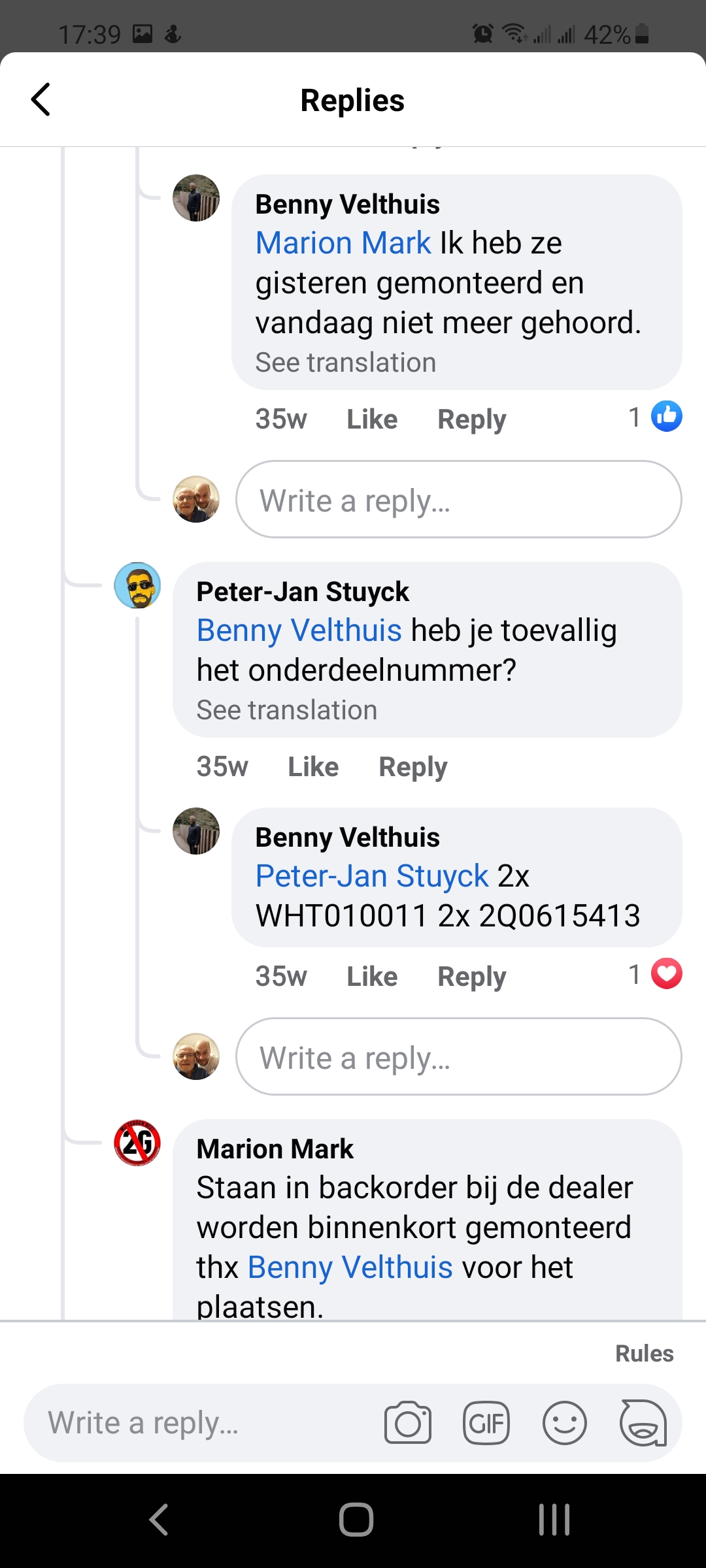

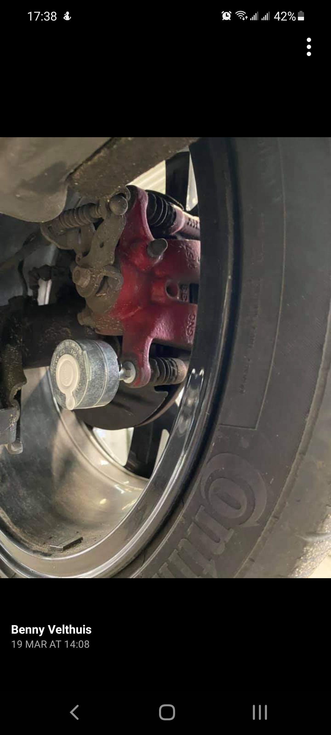

Re: Rear brake noise on reverse
Hi
Went to my local dealer today for yearly check. Told them of the noise and asked if they are aware of the VW solution. Guy looked at me like I was from the moon. Anyway he tried to make a search on parts numbers I provided, but they must have been wrong. In this thread I've seen three slightly different ones. Anyhow, found a similar thread on FB and there the solution and parts numbers are as following in photo. In the meantime they cleaned the brakes as their solution. Not sure how long it might last.
