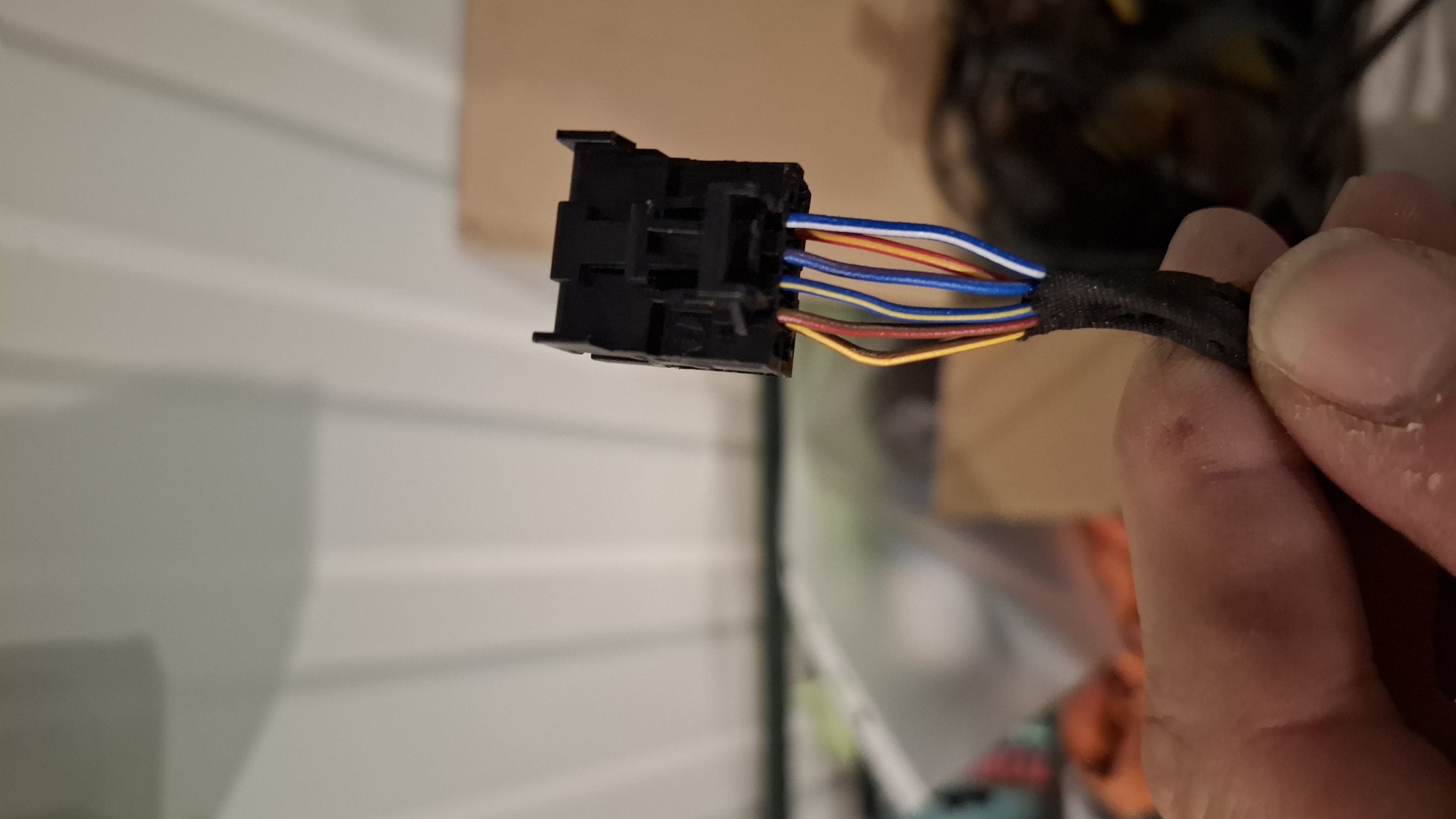

Hm..i been thinking. Maybe I should swap the wires on the rear senzors at the pdc conmector. Bur there are too many wires at the connector. At the parksenzors connectors theee are always three, all the same colour but at the end at the connector fhere are more than three. You said swap 4 to 1 but which wire is which?

How about using a multimeter?
In the image you showed of the T12 connector for rear PDC sensors, there's one wire for the positive signal of all four sensors, another is the ground signal for all four sensors, and the other four wires are the control signals for each sensor. It couldn't be simpler.
I gave you an example just for better understanding (1, 2, 3, 4). It's not a wire layout.
How on earth am I supposed to know how aftermarket wiring is made...?
Use the multimeter to find out which wires to swap.

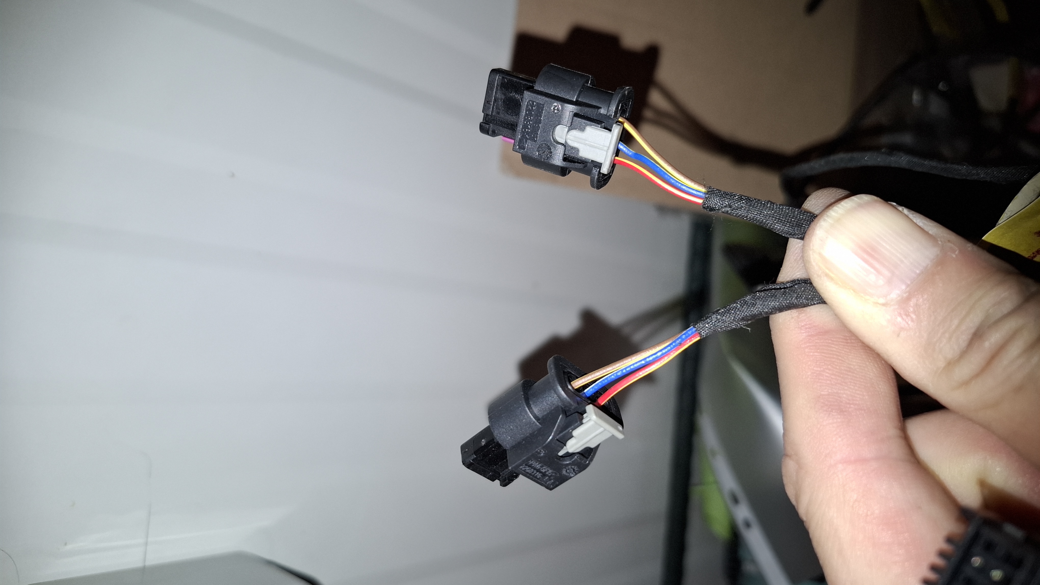

So we wait. Tomorrow is a weekend. I am driling the holes in the rear bumper. I am also repining the connecter that goes in pdc modul from the rear senzors. I opened it but how to pull out the wires?
