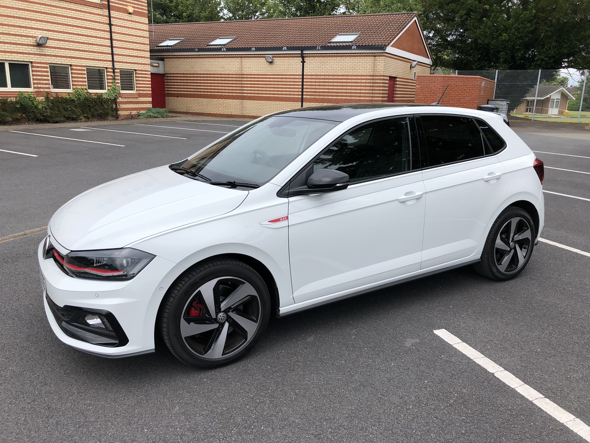

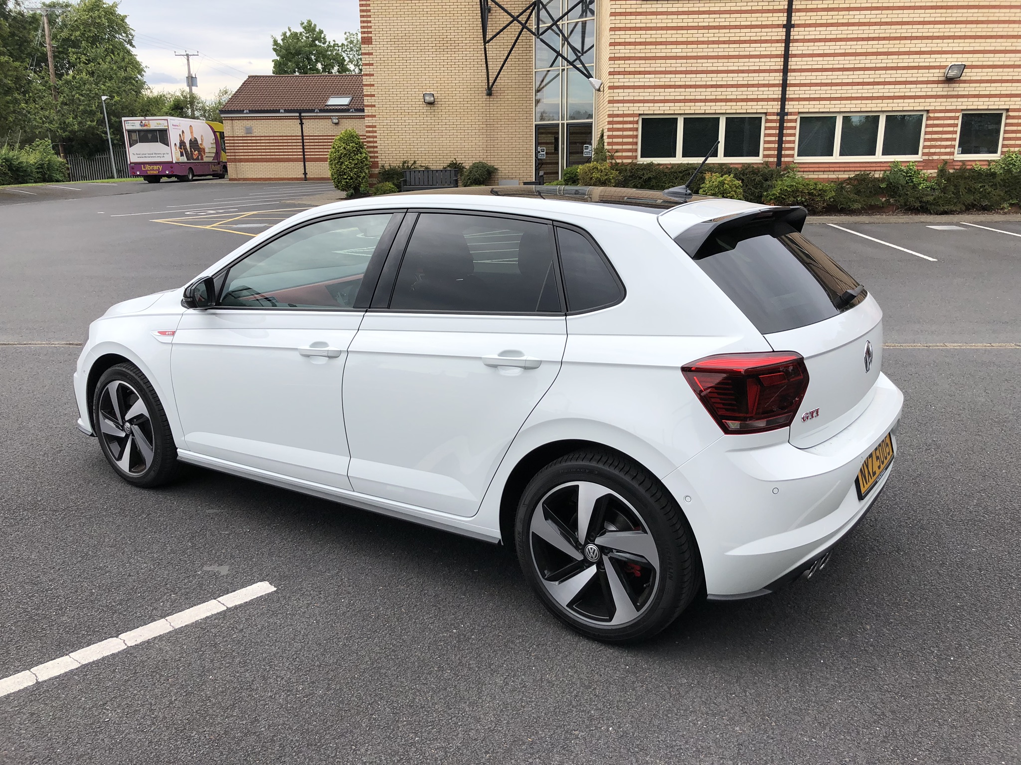

Hi there I just wanted to add a little update about my owners experience so far, I am 2 weeks in and 750 miles covered and I will have to say I am loving this car more and more everyday. This is my first ever GTi and my first automatic transmission and after driving manual for 25 years I will never go back to manual.
I just cannot convey how much I enjoy driving this motor, if I was to describe it in one word it word be ‘Effortless’
