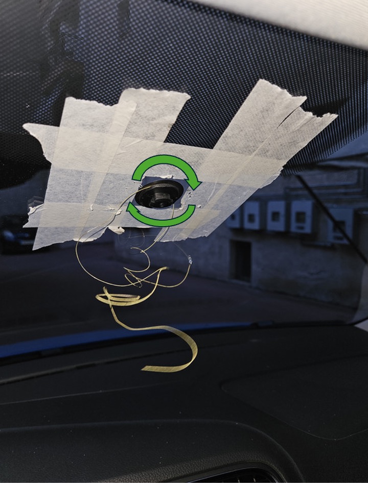

I always have this retrofit on my mind. That is, to put light and rain sensors as well as an automatic mirror. I have read several posts about how someone can detach the mirror base from the windshield.
TODAY I tried with the guitar string, but I didn't do much, I broke 3 strings without the cutting progressing much.
Does anyone have any different ideas on how this base could turn out?

giannis20vt wrote: Thu Jul 04, 2024 7:48 pm I always have this retrofit on my mind. That is, to put light and rain sensors as well as an automatic mirror. I have read several posts about how someone can detach the mirror base from the windshield.
TODAY I tried with the guitar string hole, but I didn't do much, I broke 3 strings without the cutting progressing much.
Hi Giannis,
I hope that you have already solved the problem, but if not I'd like to put my nose on the subject :-)
I have understood that it is important to avoid any force where one would try to rise the base from the window, but it should be rotted in the direction of the windshield surface. So in practise the base should be rotated either clockwise or to opposite direction to ge removed from the windshield. I'm not sure if anyone can get anything out from my poor explanation, but I also tried to illustrate that with the arrows on your original photo. This methodology should minimise the risk of damages to the windshield.
My plan is to try this very same procedure with my Transporter as I'm going to retrofit a RLS and HBA into it.

mrfield wrote: Mon Jul 15, 2024 11:41 pm
Hi Giannis,
Kind regards,
Jari
Hello, thanks for sharing, it's interesting idea but i am afraid not to break the windshield.
