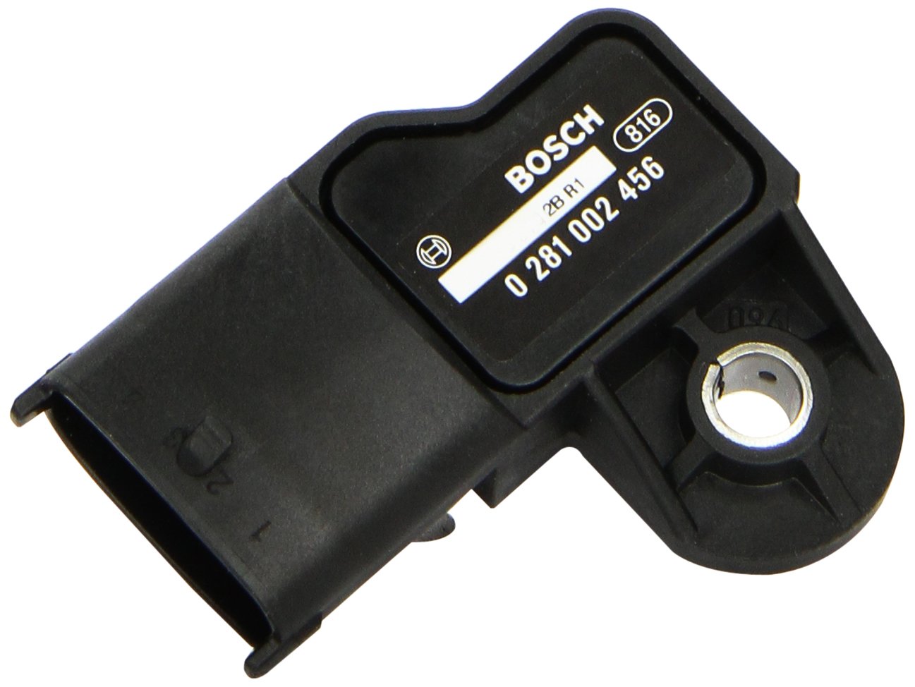

Hi guys, I am having some troubles with GPL: car auto switch to GPL and immediately switch back to petrol.
An extract from autoscan (full report below) shows that:
1 Fault Found:
013190 - Low Pressure Gas Sensor (G401)
4 months ago I had same problem which was solved replacing the GPL sensor named "Bosh 281002456"
I can't belive I have to replace it again after 4 months of use.. :(
Any suggestions what's happening?
Thanks :wink:

Maybe it's not a G401 sensor fault.

If the pressure in the gas fuel rail rises above the value 10.5bar or if the sensor signal fails, the vehicle will switch to back-up petrol mode.
http://www.volkspage.net/technik/ssp/ssp/SSP_373_d1.pdf
or search for leaks in the gas fuel rail.
If you want different results, do not do the same things. :lol:
Whatever you do, be careful, the gas injection system is dangerous.
There is a leak check tool for this job.

Thanks Ciclo will try to replace the sensor and see if it will solve the problem. :wink:
If not I will make it check by my dealer.
Anyway I do not understand why vcds shows "low gas pressure" error if pressure is too hight (above 10,5 bar).
Should not be the contrary if there's a leak?

I guess the sensor/switch G401 goes "short to plus" due to one of these reasons. (high/low pressure)
Take a look at the wiring that reaches the sensor.

Hi ciclo, I checked wirings and are ok.
I will try to clean up the sensor with specific product and see If it works. :wink:

Hi, i could finally replace the sensor and now i can confirm it was faulty!

8) Hopefully this time will last longer than the previous one.
