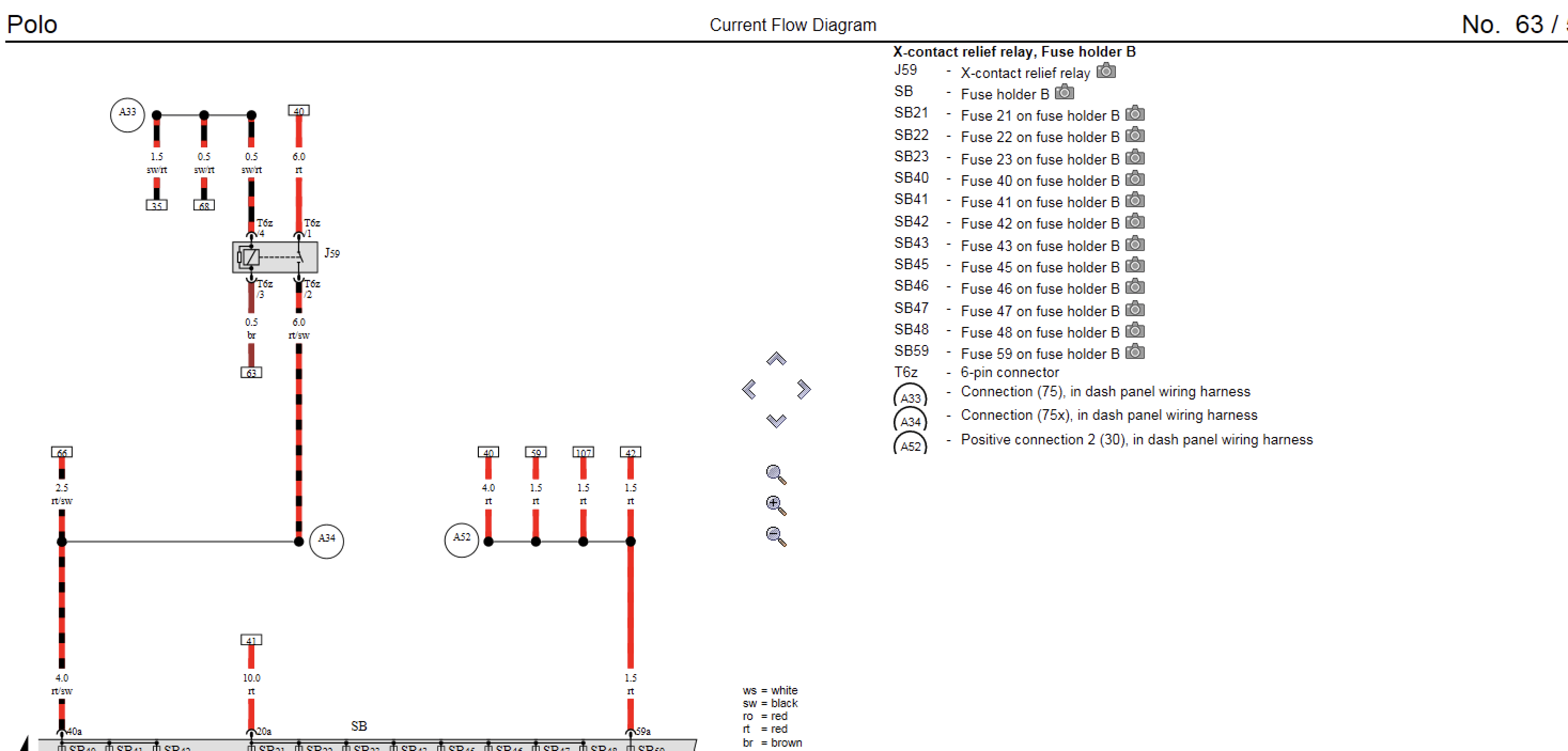

Probably, you need to add a new wire from the +75 rail to SB37a (input), otherwise your module is not receiving any power.
Fuse Box OEM.png (2.06 MiB) Viewed 4145 times

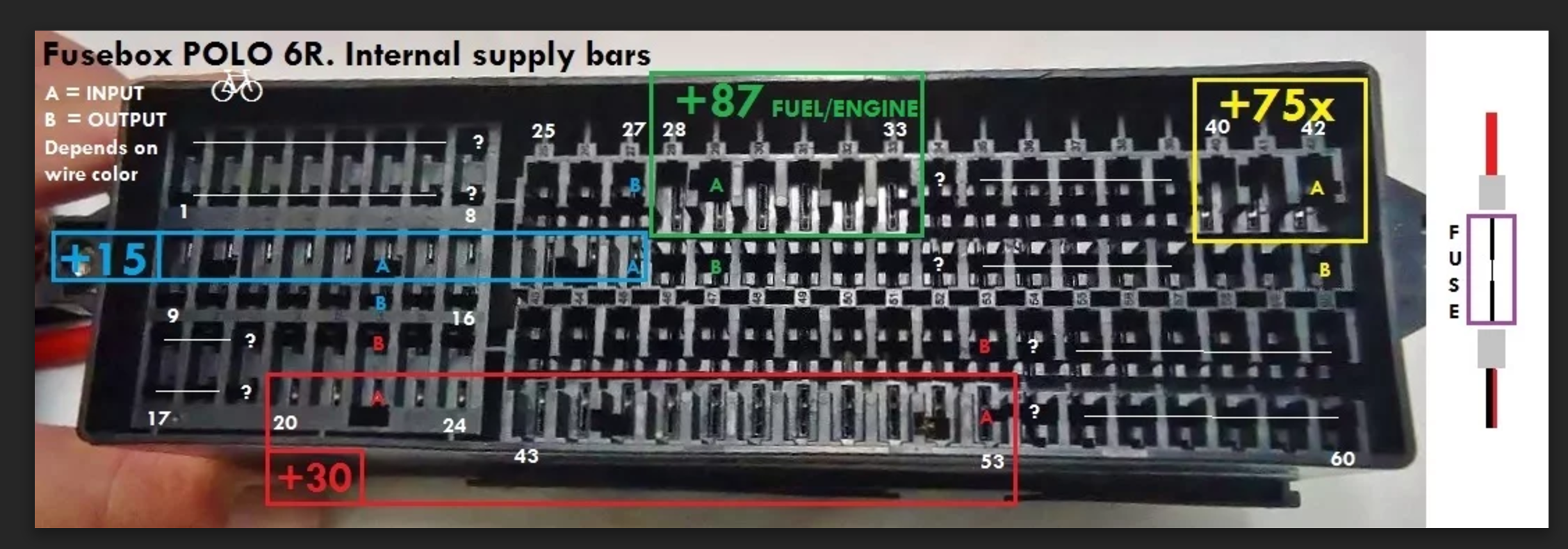

Have a look at this image by ciclo, you can see that only 40-41-42 have a +75 rail in factory setup.
It's a red + black wire feeding it. You need to attach a wire to either this wire or directly to the +75 relay.

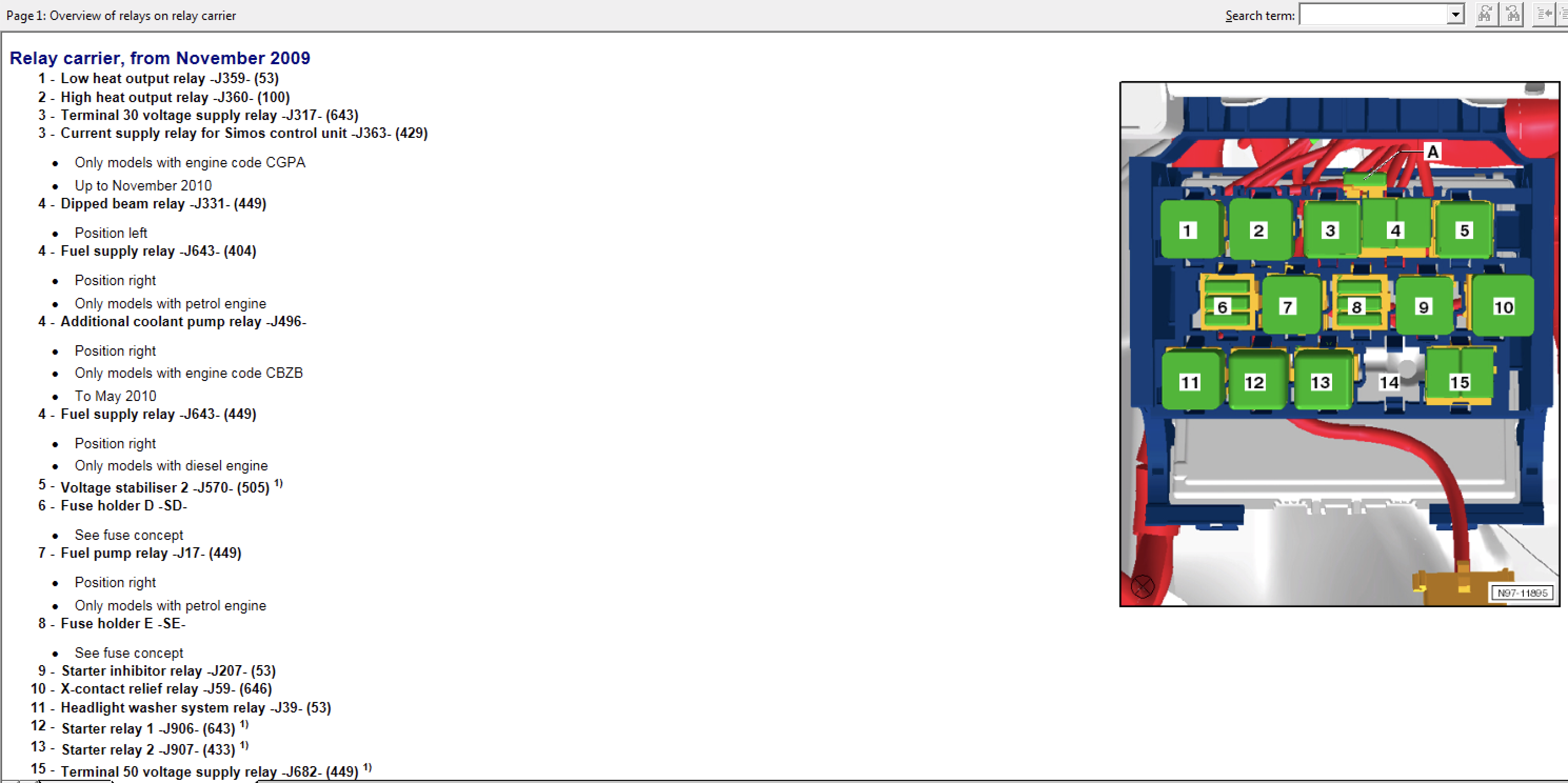

Here is the relay carrier for November 2009-April 2011.
2009 Nov.png (527.42 KiB) Viewed 4145 times
Remember, the x-relief relay is the Terminal 75 relay, the different name for the same device. It's number 10.

Anyway, this is like I understood it, you connected the power feed for the heated seat to an empty fuse box connection. Just add the power feed to SB37a and you're good to go.
