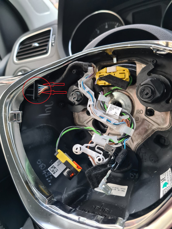

One small thing is that the brake pad wear indicator is permanently active. I couldn't figure out how to turn it off. Can someone help me with the change to long coding?
And the second it the MFSW, i have to search for it, i am not remember a lot from the installation of it.

MFSW: is the MFSW installed? Wires connected to slip ring? LIN wire to BCM and power cable to i.e. fuse box?

The MFSW is installed.iichel wrote: ↑Fri Dec 30, 2022 6:01 pm Old BCM coding: 000008404053005B4F844000400703000000580051010000000000000000
New BCM coding: 00000042C051005B0FA44004F00503800000000001010014030000000000
Did you check your BCM coding for these issues? There are a lot of differences.
I have to check the wiring, ιt's been a while since I installed it.

So i have to do the MFSW install from the begining, in fact i will check the wiring and change the wiring for the Horn plate. I have a "hybrid" wiring right now for the Horn plate.
I have a MFSW and i did the wiring for that, but i kept the old wire for the Horn Plate only.
- Posts: 6387
Re: Giannis20vt's Polo 6c 1.0MPI
the horn wire is fine, you can use vcds to code it via LIN (MFSW) or via direct wire to BCM.

At last, the MFSW is working
I had to push the MF connector more to click to its position.
I made the coding and it seems to work fine. Of course i don't have Cruise control, it is something that is useless for the use that is made in this car.
