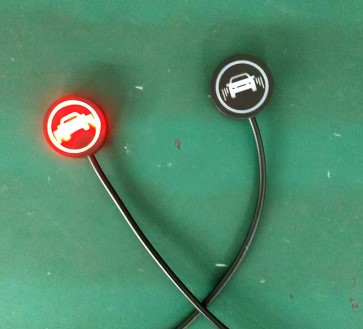

Of course i will have to find side mirror caps with opening for LED lights and of course the LED lights. But i am thinking to buy (at first) something like that:

As long as you use 12v LEDs you should have no problems, it is even an excellent idea to do tests with those LEDs before installing the original ones.👌

They are convenient, but my mirrors don't have the engraved design, so I think they are useless, unless I can find mirror glass for my car that has this design. There are no original ones, of course.
Anyway, with LED lights like the ones above, I will do my tests easily. Thanks for the info of 12V

Those LEDs you show us are 5v, they will not work. You must use 12v ones.

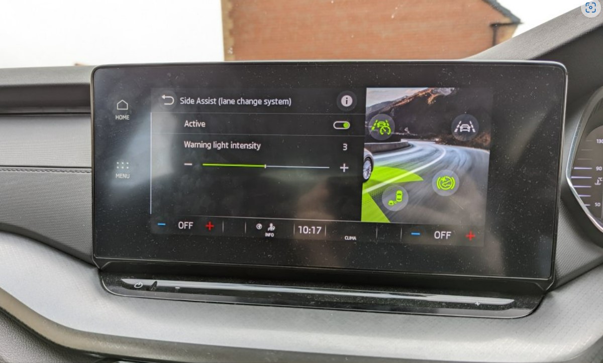

Photo from the net (SKODA OCTAVIA MK4 2022)

Nice screen, and lovely English sky. 😄 ... 🙏
I take comfort in knowing that the dust on these screens is similar everywhere on the planet.
2Q0 radars have the ability/function to modify the brightness of the BSD warning lights.

I'm thinking a lot about the warning light. The most OEM solution is to buy a new mirror cap (with the opening for the warning light) and the warning light itself. I have to paint them (the caps) and then install them. It's something that requires a certain amount of money, but less effort on my part (it's the OEM solution).
I looked for the solution you applied Fernando with the mirror glass but I didn't find it available anywhere, since they are not an OEM solution in the case of my car.
I found a DIY from SEAT LEON where the guy put a light behind a point of the mirror that was empty (it had no plastic) and the result says that he was satisfied.
Image Image
I don't know if there's such a gap in my mirror glass, but it's a thought.

The OEM solution is definitely the best and most satisfying option. It's a blessing to have it... money should never be a factor in your thoughts when retrofitting safety aids.🤷‍♂️.
I wouldn't install any other than the original ones for your Octavia, they look very good.
As another option, there are those who added small non-OEM LEDs to the plastic frame of the mirror assembly instead of machining the glass. There are some pictures of this in some Drive2.ru thread.
