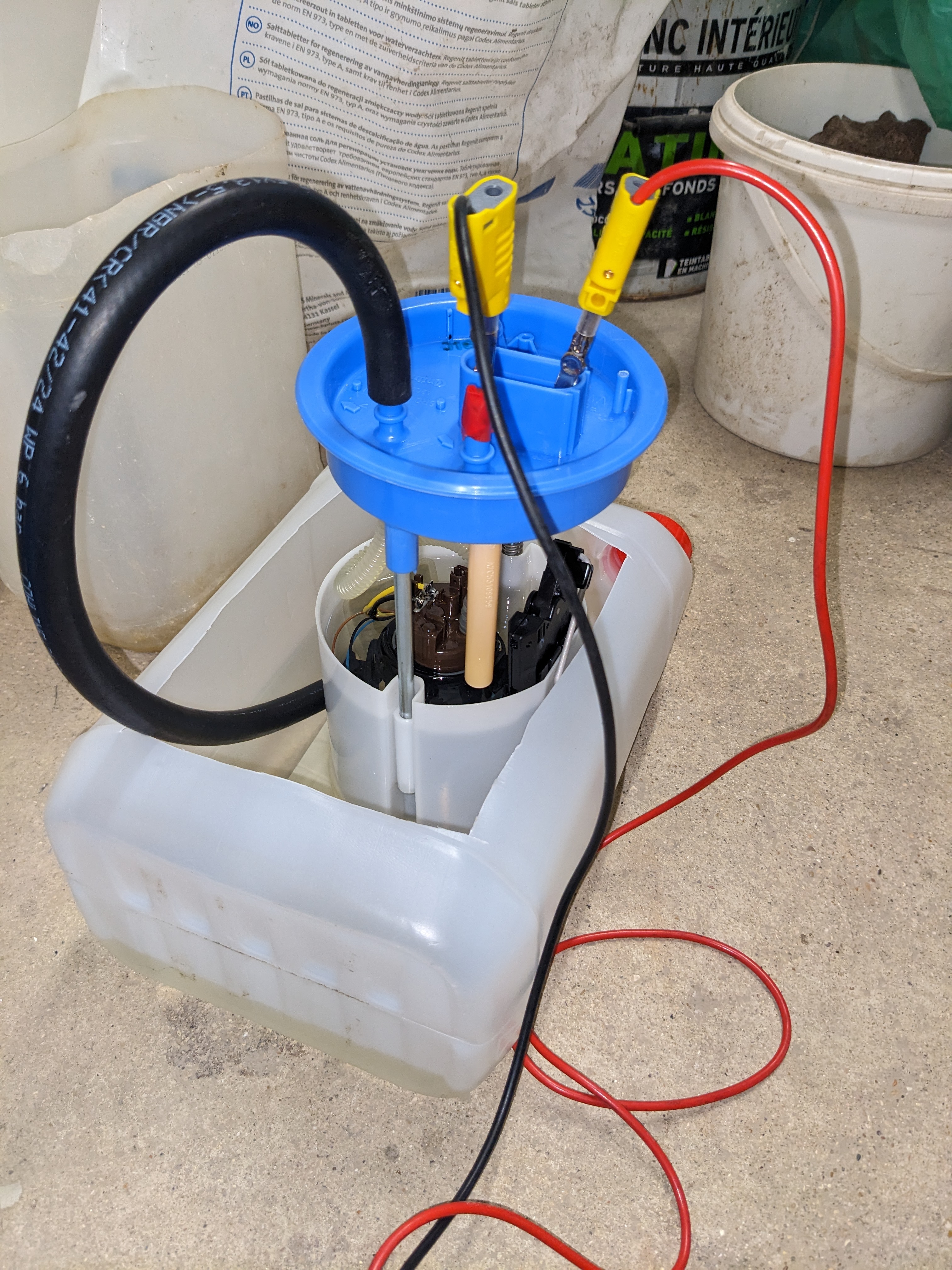

So I managed to make my "brand new" pump running with direct connection with my battery removed from the car.
Not the best plan in term of safety but, It worked :lol:
Short video:
https://youtube.com/shorts/Ne2hkL8yxAs?feature=share
Pump is running smooth and without any special noise. I hope it will solves my issue...
If the weather is no too rainy tomorrow, I will replace it.

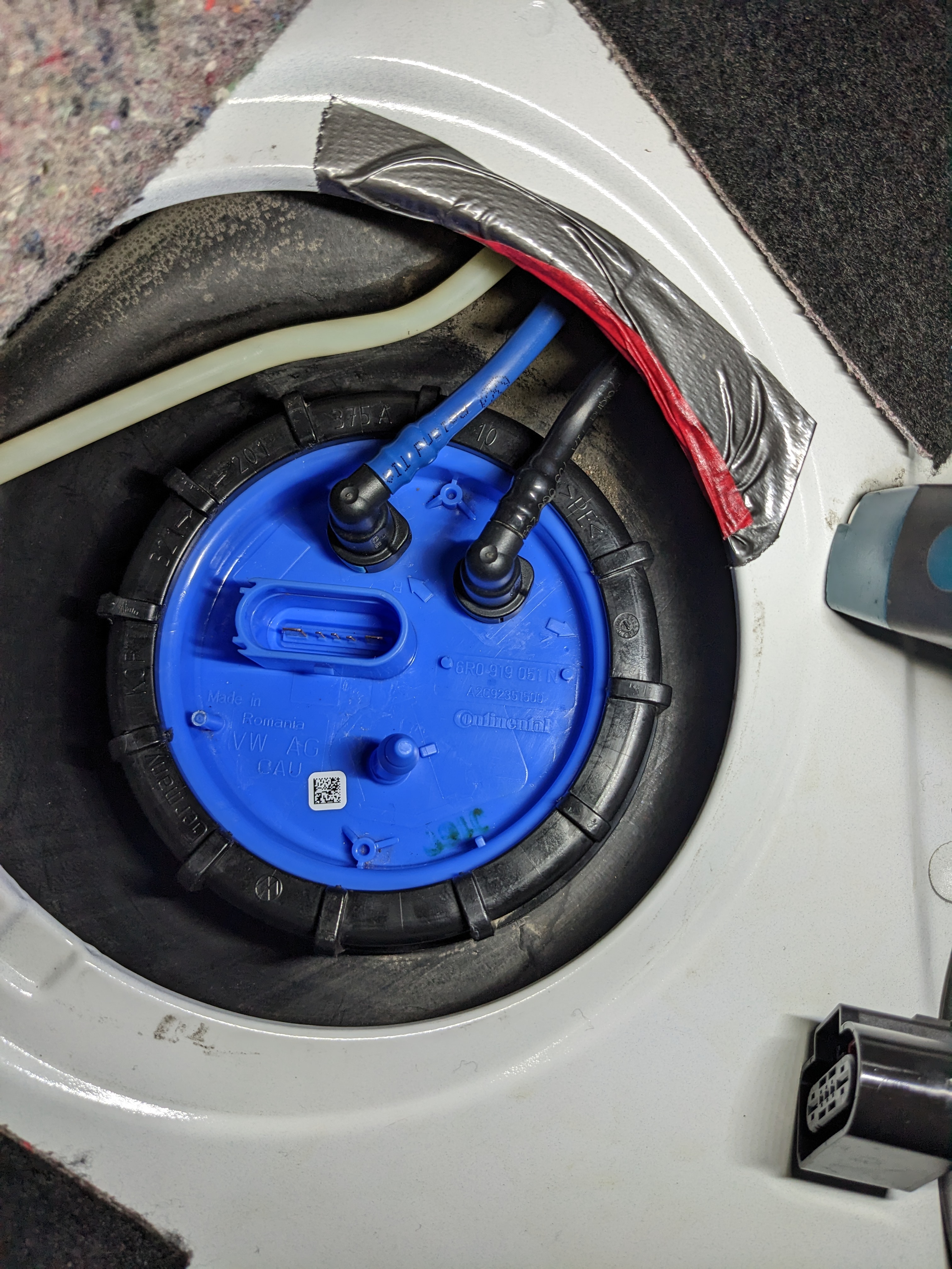

So finally, the fuel pump is replaced (temporally).
The dismantling went smoothly. I had taken care not to fill the tank to avoid any unpleasant surprises.
With the tool, the ring came loose without any difficulty.

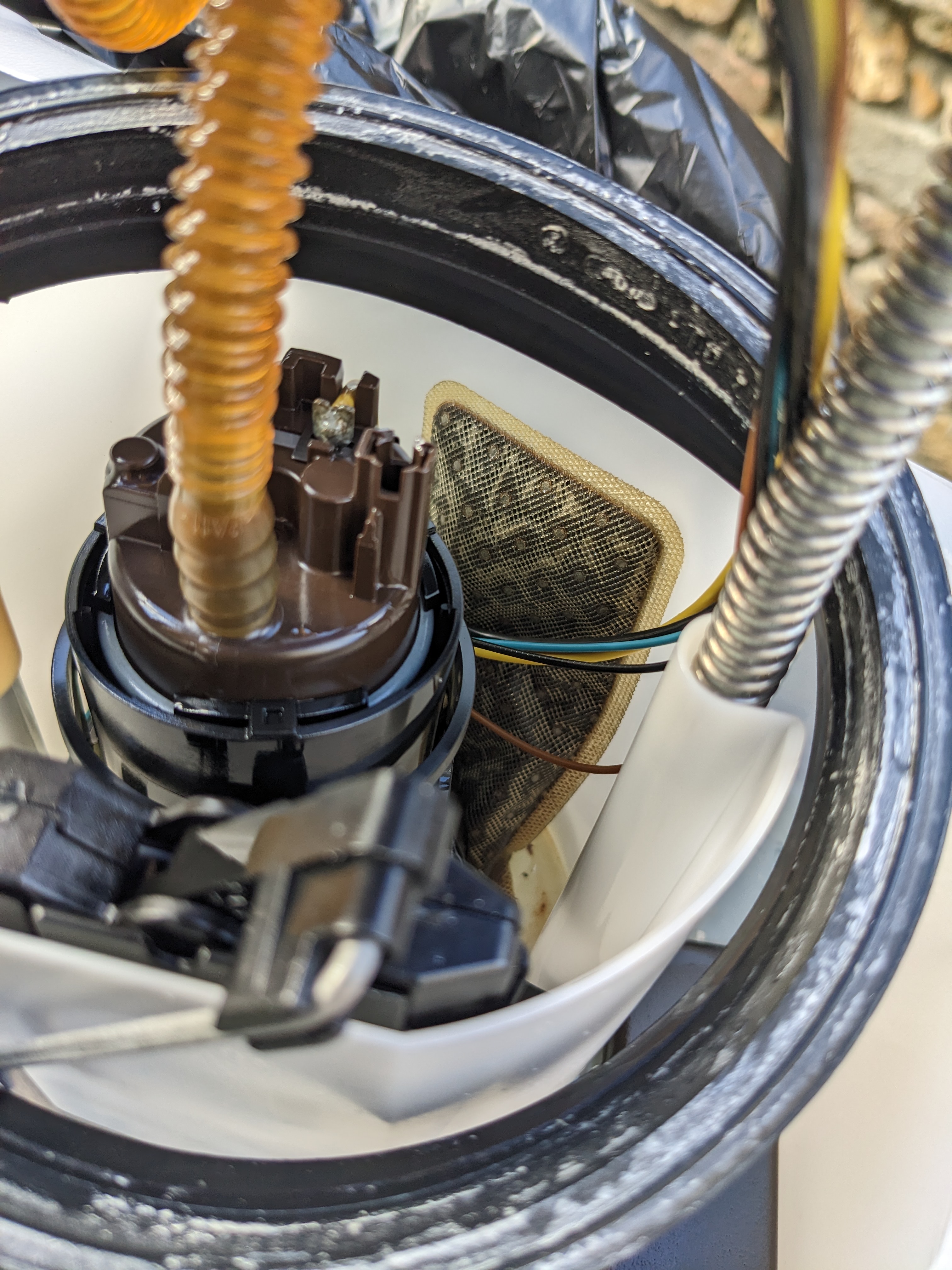

No comment on the condition of the filter...

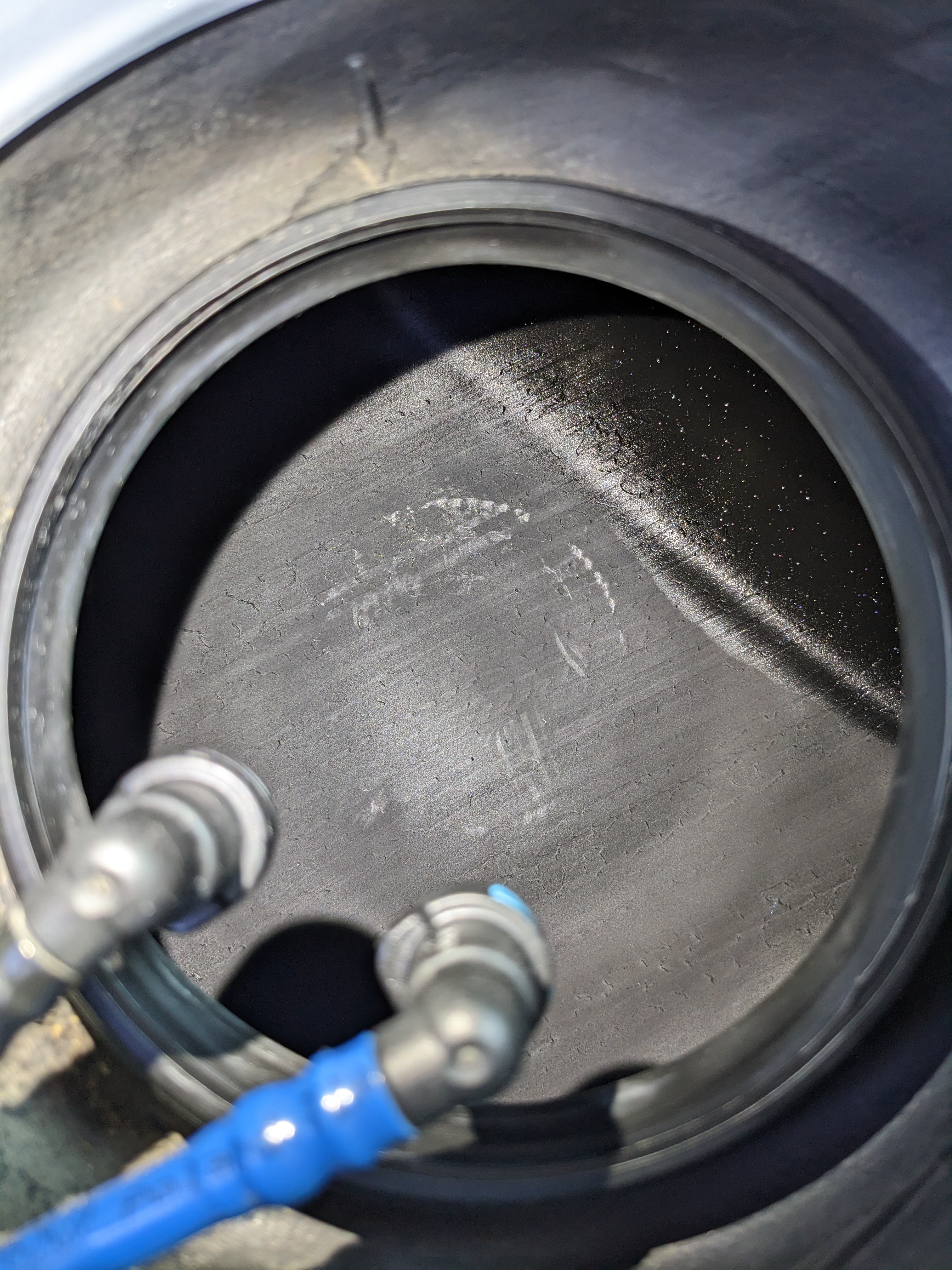

The bottom was covered in brown particles in some places. Like powder or dirt.
For the bottom of the tank, very slight deposit just below the pump:

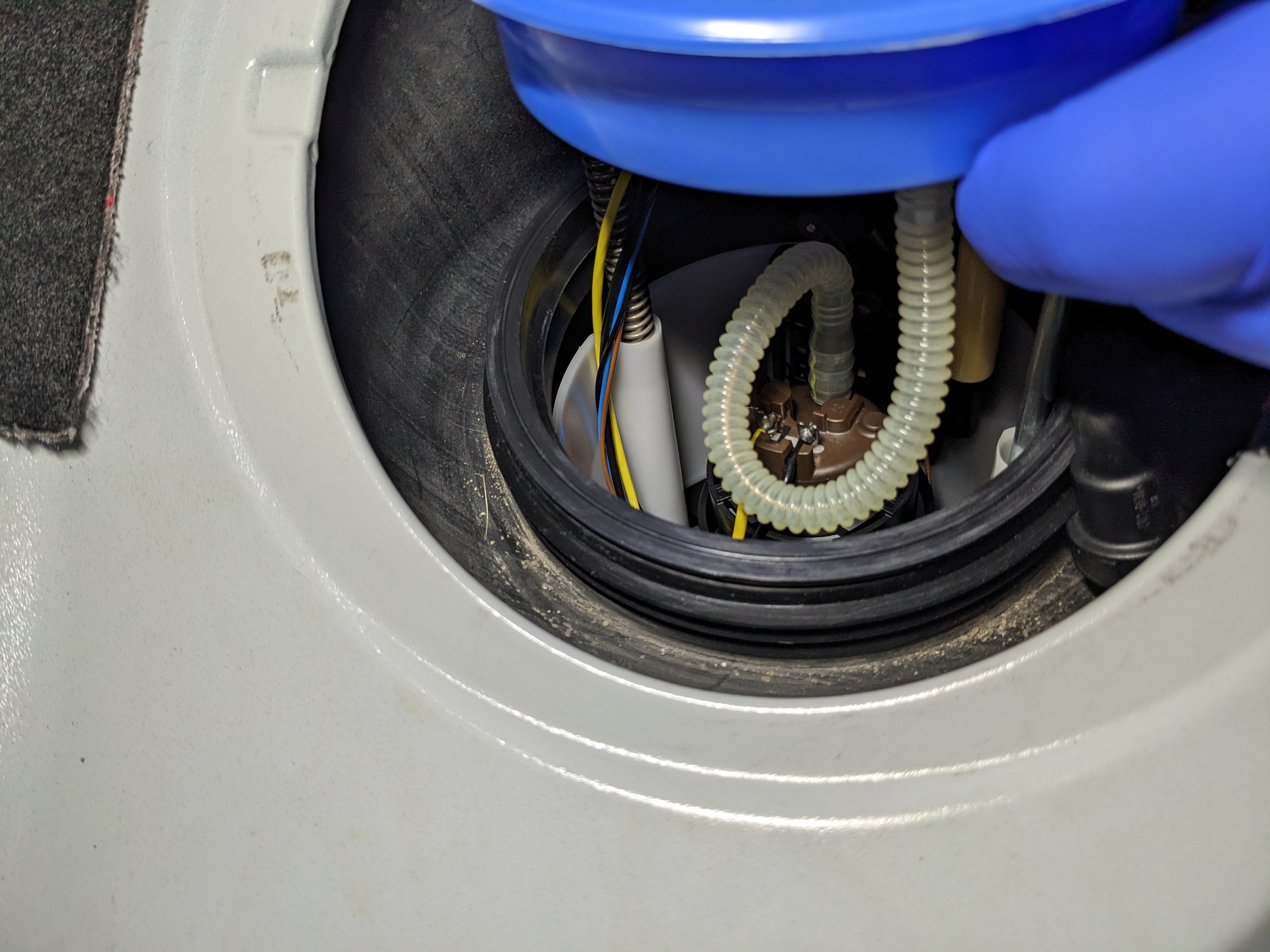

Reassembly was a bit more difficult.
The new seal, even though lubricated with fuel, was very difficult to insert.
But once in place, I was able to reassemble the clamping ring, albeit with some difficulty.

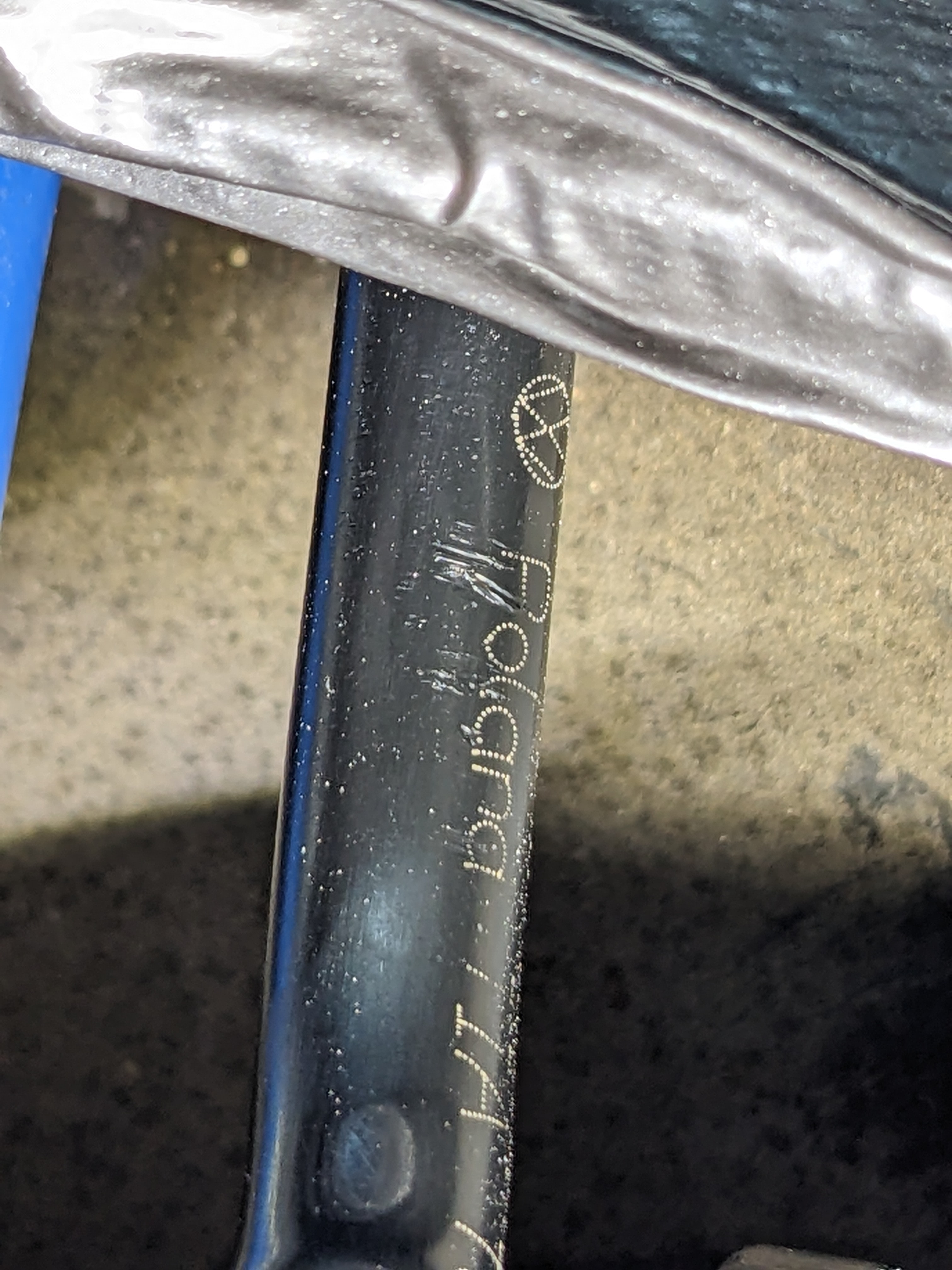

This little battle caused some damage to the fuel hose:
The metal plate around the opening is not rounded, but rough and slightly sharp.
When the clamping ring was fitted, the fuel hose came into contact with this metal plate, causing this mark.
It's not deep, but I would have preferred to avoid it happening.
Replacing it is not particularly complicated. Without removing the rear suspension, you would simply need to ‘loosen’ the tank fasteners to obtain sufficient clearance.

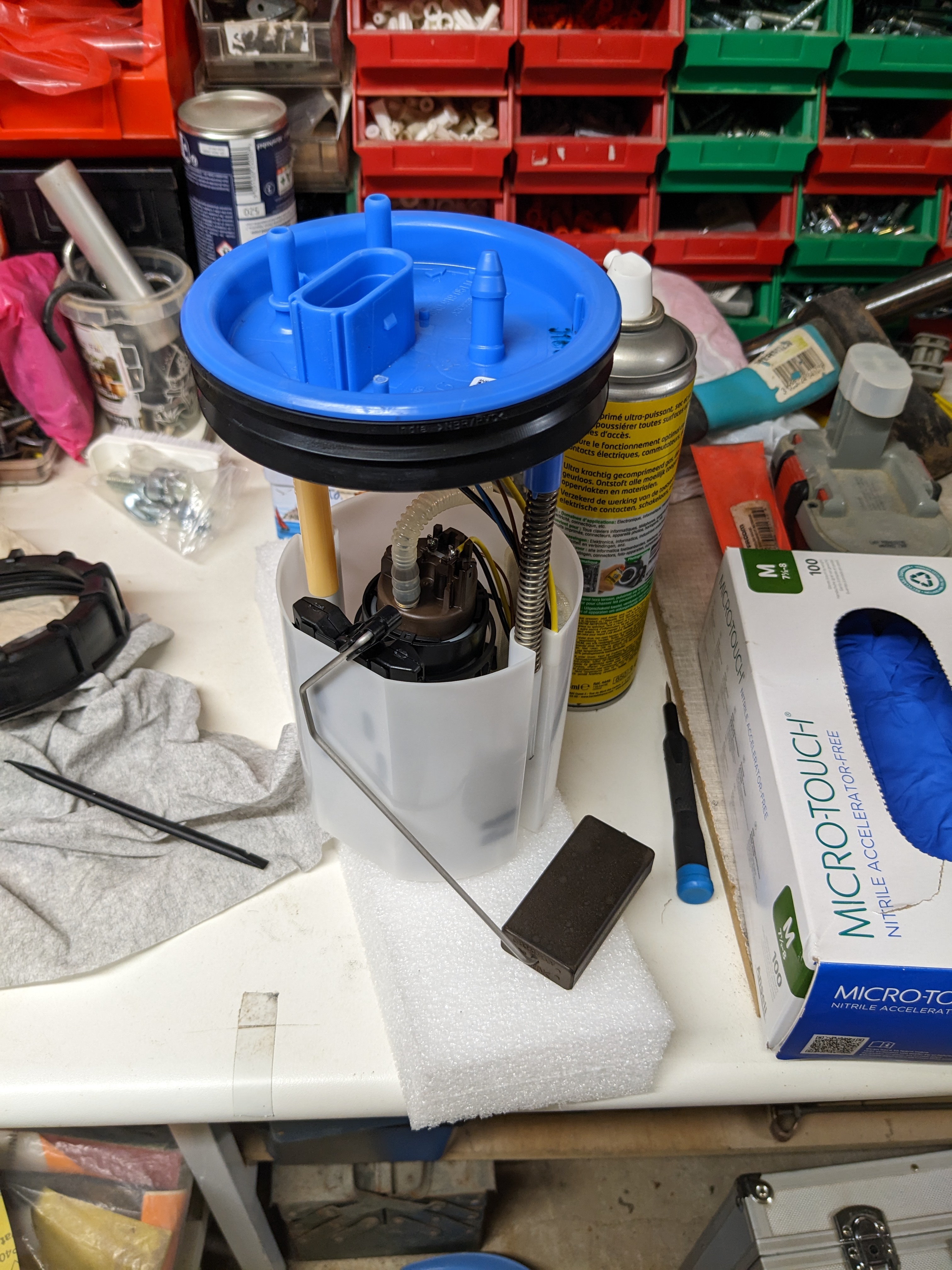

So finally, the LPFP replacement is done.
Last week I installed temporally the "new low mileage" pump in the fuel tank to test it. The car runs good, seems to have more torque but still lack of power on a specific hill.
So yeah, temporally because of two things
-Cleaning of the bottom of the fuel tank
-Fuel gauge sender swapp
I take care about those steps yesterday:

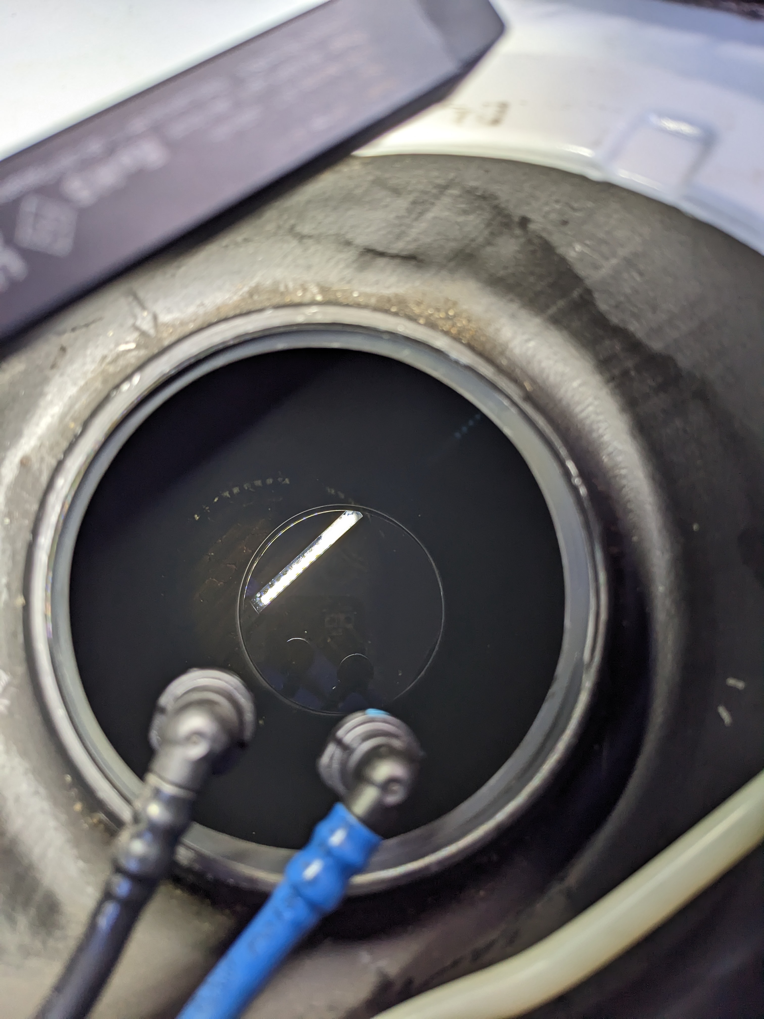

Cleaning was straight forward. I was expecting more dirt:
But now, it's looks perfect.

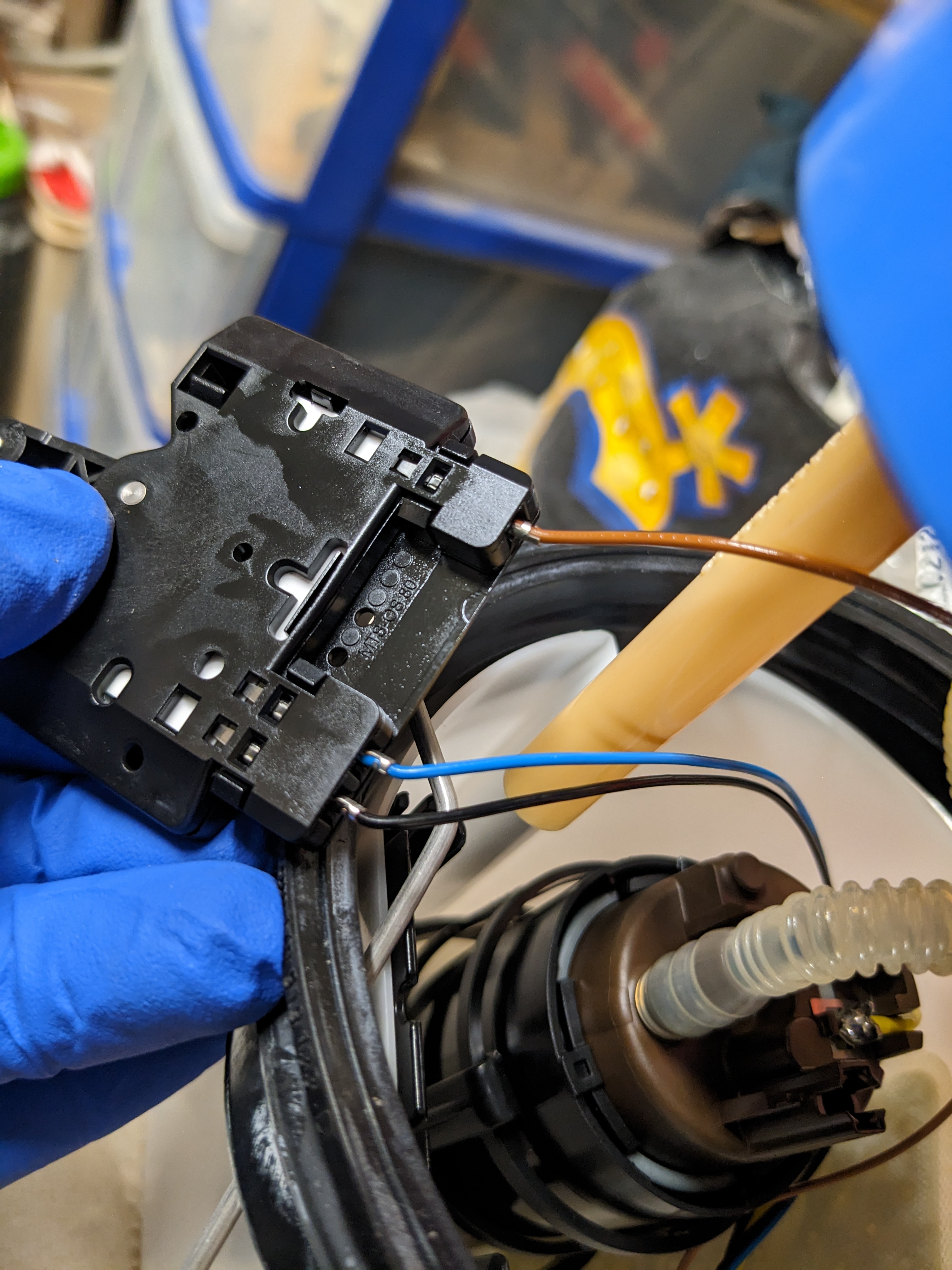

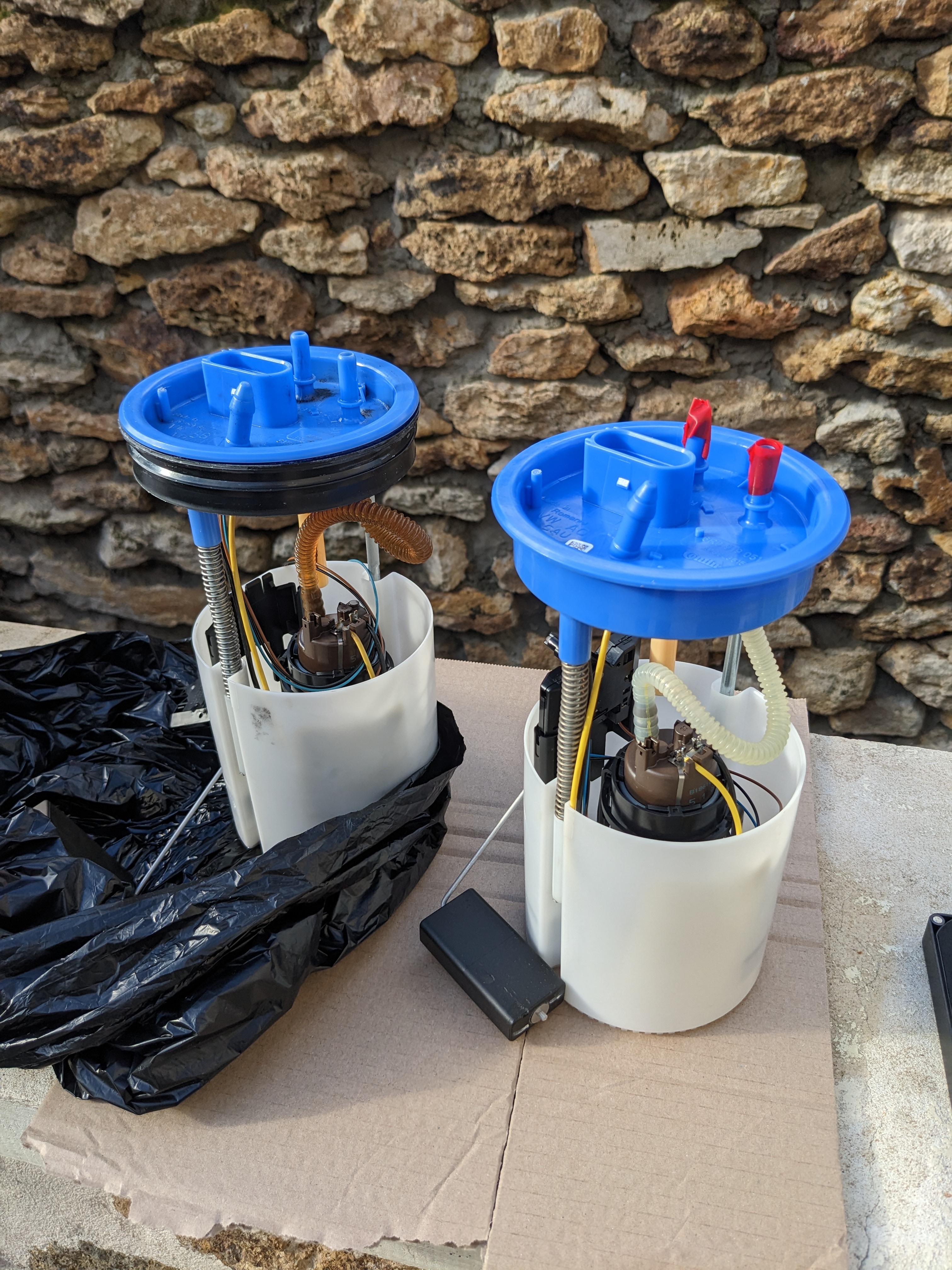

Next step was the fuel gauge sender module swapp. Since the one I received was slightly bended, I prefered to take the one from my original fuel pump.
Simple as hell: You have to push on each terminals two clips side to side and pull the cable outs.
Color codes make things easier.
And now, we have a hybride, almost brand new fuel pump:

So again, I removed the fuel pump and I saw that the floatting part was stuck (?) From what, I didn't know. After making sure it was moving freely, I installed everything back and start again.
Hura ! Now everything work.
