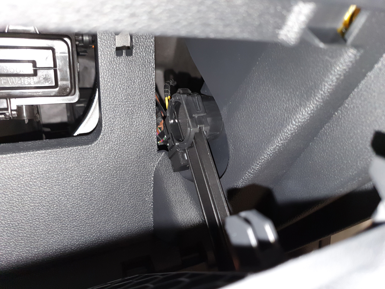

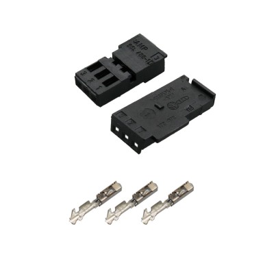

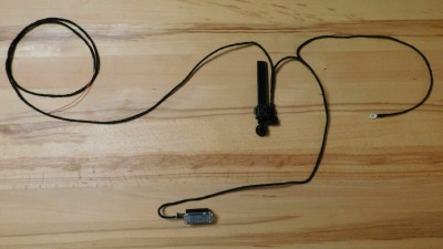

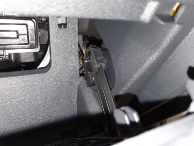

Yesterday the remaining parts finally arrived, today was the day to put them in the car.
Small upgrade but I'm satisfied with the final result.
The idea was to create something like this...
But I want to thank the user J+silva for his magnificent idea of connecting to a battery, because I didn't really feel comfortable working on the car's wiring. :(
In addition to the part already mentioned 5G1858309 and a Luggage Lamp 8J0 947 409 and the wiring that I had from my previous VW Golf, I also used...
1 plug 1C0 973 119 B
2 connectors N 907 649.02
And wire to make the rest of the cabling, and lots of fabric tape. :lol:
This was the result... :D
It wasn't difficult, I just wasted some time passing the wires because I didn’t disassemble anything.
I hope with this I can help future interested in doing this simple upgrade.

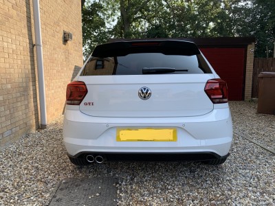

I've fitted a resonator delete pipe to my 2018 non opf gti+, happy with the results and it now sounds a bit more like a gti. I was worried it would be too loud but its turned out great, seems to have more pops when coming off the accelerator :D

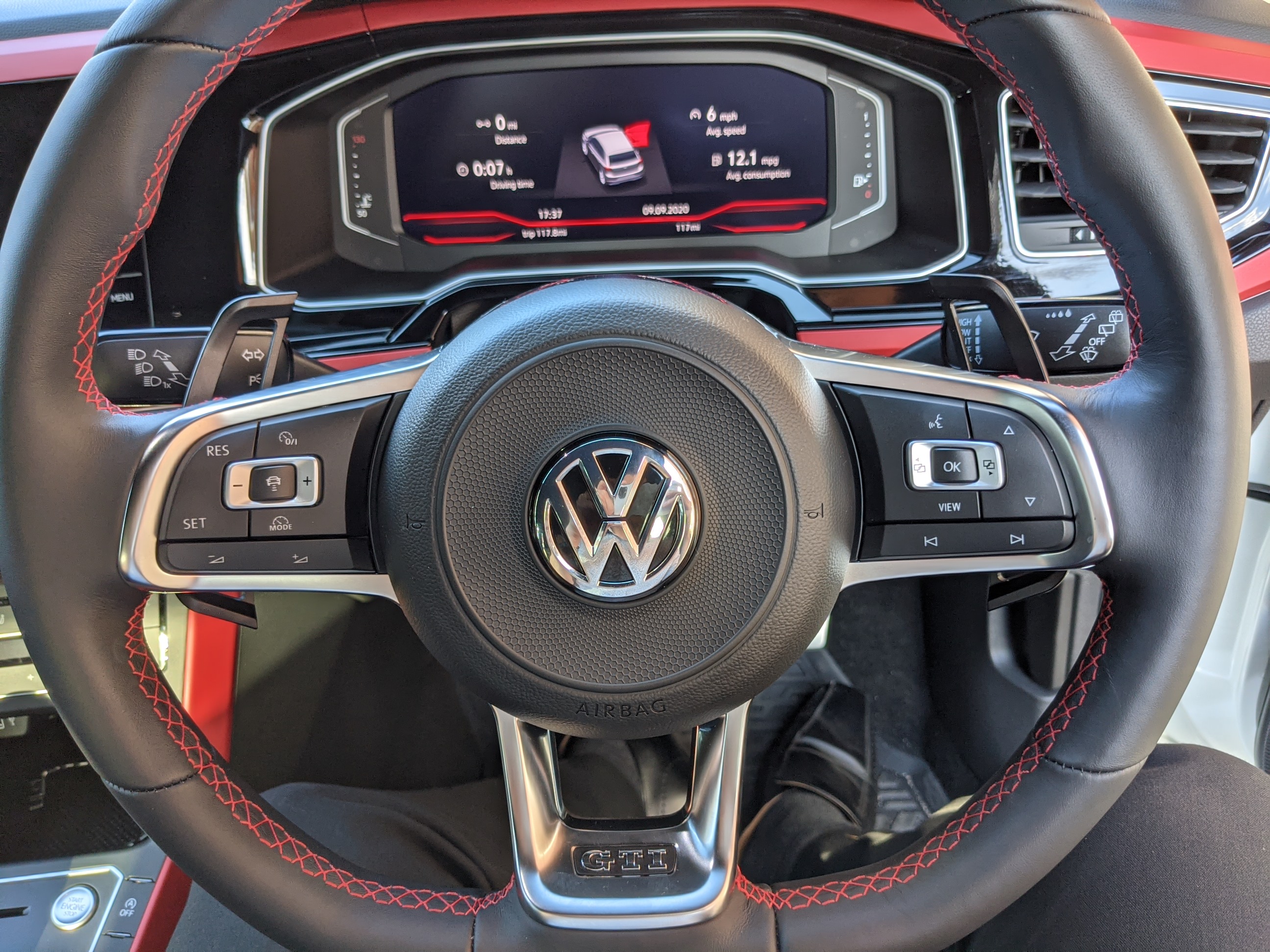

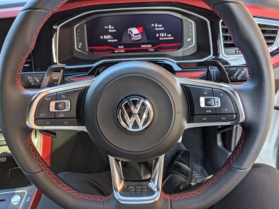

Fitted some paddle extensions too, really suit the car well I think

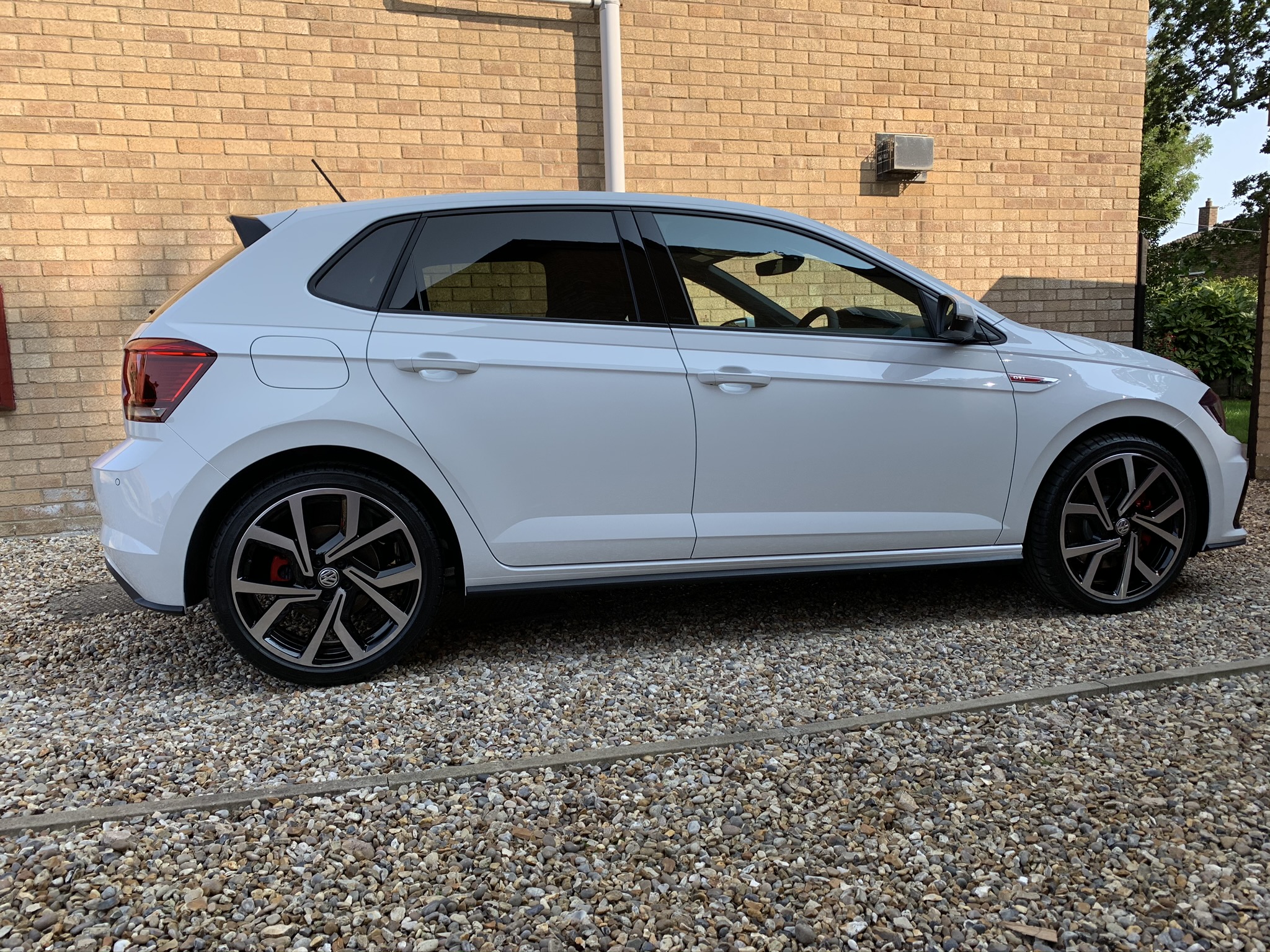

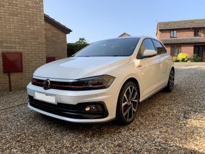

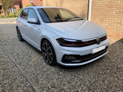

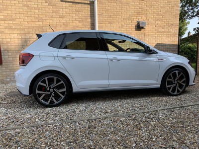

Not today, but over the weekend - gave my GTI Plus it’s first good clean, decontamination and a couple of coats of wax (a synthetic wax, so I suppose really, it’s a sealant 🙂). I used Fusso Light Coat 12 Month’s Wax. There’s a dark and light version of this product and used the dark version on my previous car and was very impressed with the durability and it seems to be highly hydrophobic. Water was still beading up pretty well on my last car nearly a year after applying it.
Things I noticed when cleaning this car compared to my previous generation GTI;
  • It is noticeably larger than the previous generation Polo.
  • the 18” Brescia alloys have an annoying ridge that runs around the circumference of the wheel behind the spokes which collects water. I was able to blast it out with my Metro Vac Sidekick Blaster warm air dryer though! 😀
  • The honeycomb lower section on the rear bumper looks as if it’ll be a dirt trap in the winter and will need cleaning with a small detailing brush to effectively remove the dirt.
  • There doesn’t seem to be as many annoying water traps that continue to drip after you think you’ve finished drying the car.
  • When washing the car, the door mirrors have an annoying habit of unfolding and the folding if you have the key fob with you. Even hosing the car down, they kept doing this when a water jet made contact with the door handle. I solved it by taking the key fob indoors out of range of the car.
Here are the results;
Oh, and here was the final stage of the cleaning process - for me, not for the car!
Posted: Mon Sep 14, 2020 11:49 am
by S_94
Looks brilliant mate! 8)

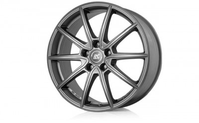

Just wheels. I’m on a number of different VAG forums and I’ve expressed my dislike of diamond cut alloys from a practicality and durability point of view on those forums many, many times 🙂. I’m not a big fan of the white worm corrosion look for my wheels.
I bookmarked these either early this year or late last year - before I even decided to get the car. These are probably what I’ll go for (RC Design RC32’s)
They’re available in exactly the same size / spec as Brescia’s (7.5Jx18”, offset ET51, bolt pattern 5x100, centre bore 57.1), and they use existing VW wheel bolts, so they’re a straight swap. I think grey alloys and white car is a good combination. I don’t know if VW centre caps will fit, but if they don’t, that’s not a big issue IMO. They’re also available in grey with diamond cut face (a big no-no for me), and satin black. Forum member @stuartrendall has the 17” satin black version of these on his Reef Blue GTI.
It’ll probably be 2-3 months before I get them, and I’ll also use that as an opportunity to fit new tyres at the same time.

Those are exactly the wheels I have in a matt black except mine are 17's not 18's. Had them for 3 months+ and they still look incredible.

Stuart, yes I agree, they do look good.
There was another forum member on here (sorry, can’t remember their forum name) who got the diamond cut version fitted to their white GTI - maybe a couple of years ago. I think this is their car in the photo gallery over on brock.de website;
https://www.brock.de/felgen/vw-polo-gti/
It was then that I decided if I ever got a current model GTI+, it would be those wheels I’d get in grey, but not the diamond cut version.
I see that you have the RC Design centre caps on yours. Do you know whether or not VW centre caps will fit?
