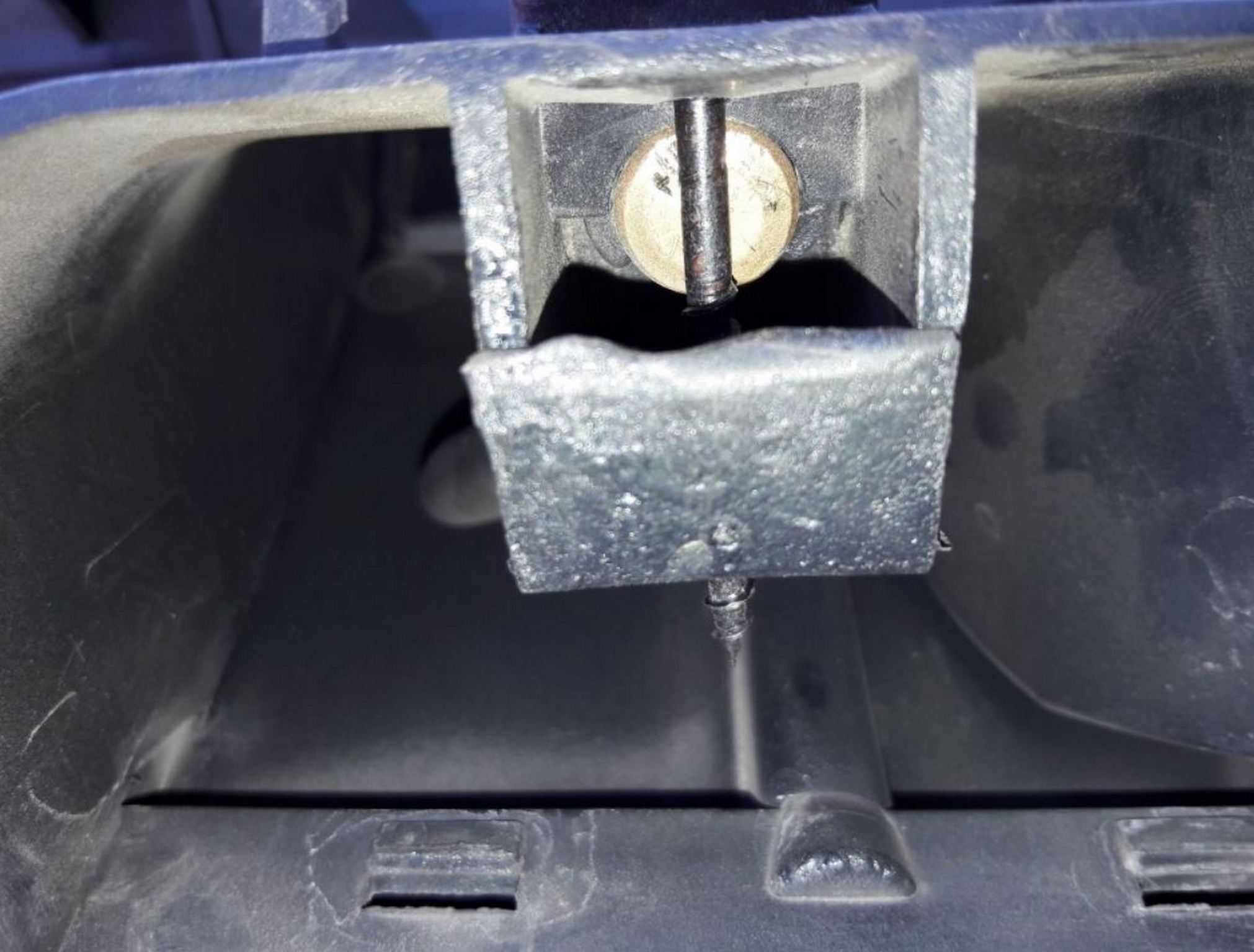

I contacted Wino (Pete) on briskoda and he supplied details about the Volvo part he used to fix the Air Flap capsule.
The capsule part number is Wahler 1266826
But he also said that he would not bother doing it again and the alternative is to push the capsule right 'in' with a screwdriver and then fit a woodscrew down behind it to lock it on the cold air setting.
Another couple of guys have also used their car in sub zero temps and not had a problem,although obviously that is not an exhaustive study of the problem,on aircraft engines one can get venturi icing in fairly warm/humid conditions.But anyway I decided to go the woodscrew route (as in it doesnae cost anything LOL).
This is the pic that Wino supplied.It shows the screw fitted just aft of the capsule and thereby locking it forward into the 'cold' air position for the flap

That assembly looks different to my BBY.

littlepolo wrote: Tue Feb 26, 2019 9:11 am
That picture I think, was taken after the housing was removed from inside the air filter, maybe only early cars had a group of maybe security Torx headed screws fixing that inner cover on to the inside of the top part of the air cleaner, I think that within that thread in Briskoda, someone posted that their air cleaner looked different or had no screws - but the inner mechanism cover was bonded to the inside of the top cover. If that helps at all, if I'm right and it is Torx security screws that were used to secure this small inner cover, then that is exactly what car makers tend to do to minimise the chances of the owner etc removing something that should not need removing, ie not a servicable part in their minds - which is true as VW Group require you to replace the complete air cleaner to fix this issue - which is what lead "wino" on Briskoda to resort to sourcing a suitable part elsewhere, he like lots of us likes to solve problems in an economic and "less waste" way!
Sorry LP - yes this pic was taken on the inside of an engine cover of a different engine code - with the air filter cover + filter removed (Fabia 1.2 I think).
It is very similar though to the AUB engine cover/air flap design,the only real difference on our engine is that there is a vertical support on the underside of the capsule housing.On ours I enlisted the help of the boss - she held the capsule right forward (away from us) with a screwdriver (strong spring to overcome) and there was just room to drill through behind the capsule and then fit a screw to 'trap' the capsule full forward (ie towards the front of the car).
I will try the car out tomorrow and report back here

Just to clarify that we only had to remove the (11 ?) normal cross head air filter access screws,no need to touch the torx type screws attaching the air intake 'trumpet/duct' to the front edge of the engine cover.
