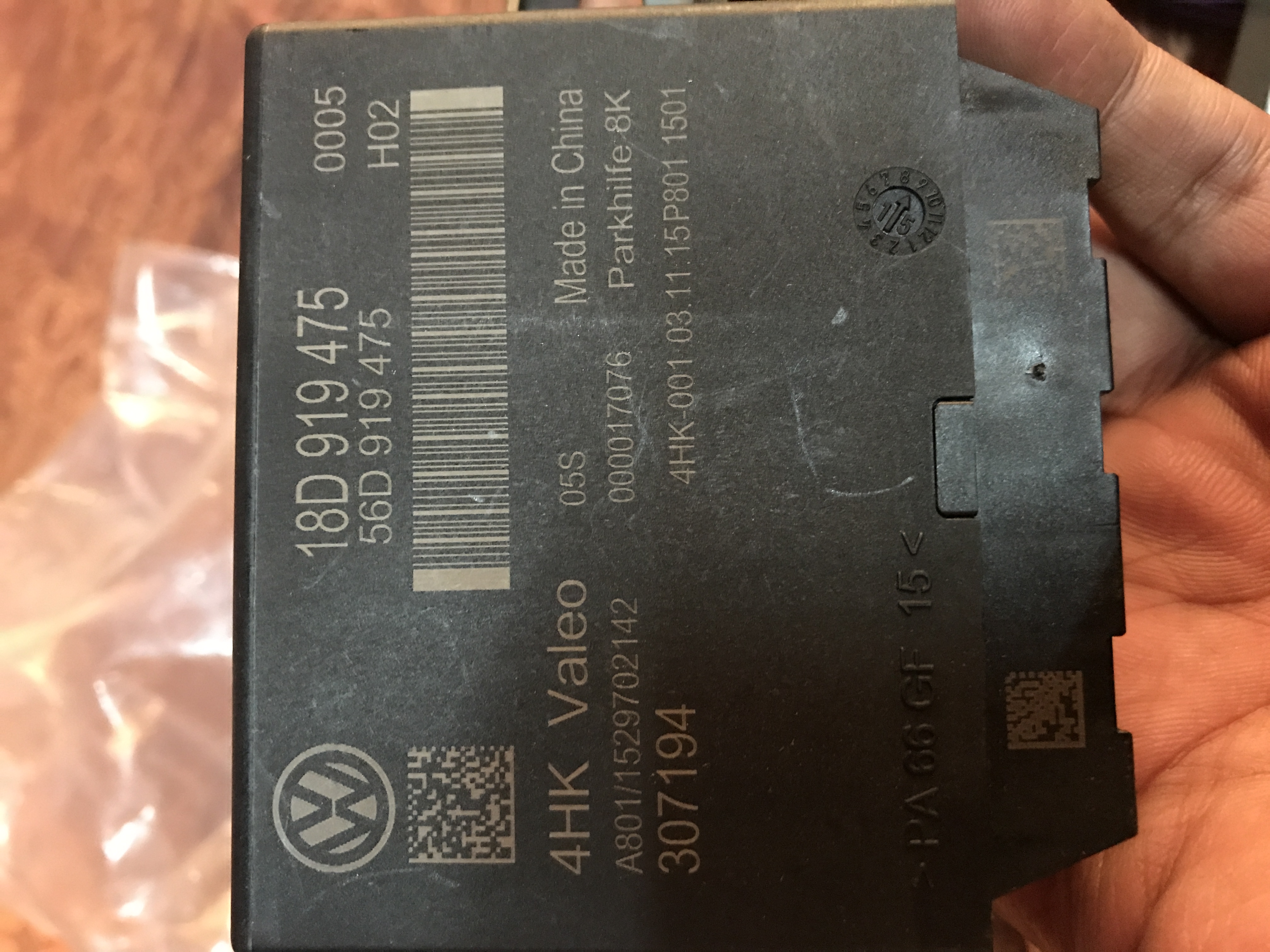

rdasadia wrote: Sun Jul 01, 2018 2:33 pm @ciclo
I have just installed the MIB Discover Media Headunit in my Polo along with a 8K OPS which has the moving lines interface.
But the ops is not working.
The most important issue is that I cannot get maps working on the unit. Can you help how to put india map on the unit.
I tried with Discover Care Software but no luck here.
Even Android auto won't work on the unit.
For PDC put coding 108101 and let me know the result
PDC won't accept any coding. I tried a lot but all coding gets rejected.
I even tried security login but even after that it rejects any coding changes.
I have installed this module  <br />This module is from Passat and coding is 108101 and it's working fine .

This is for China Passat I think.
Don't you get error of control module incorrectly coded as polo does not have electronic parking brake

rdasadia wrote: Mon Jul 02, 2018 11:07 am This is for China Passat I think.
No I am not getting any errors it's working fine...
