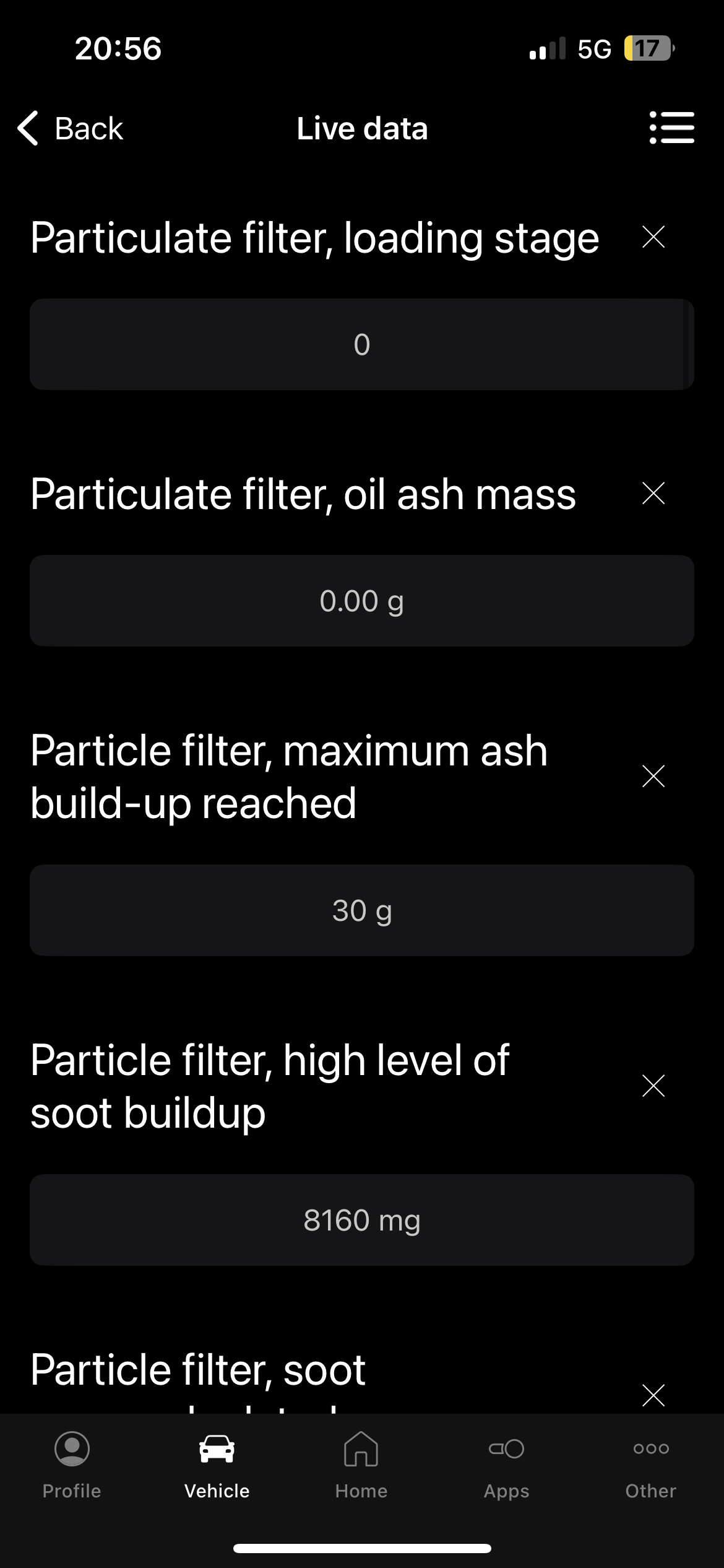

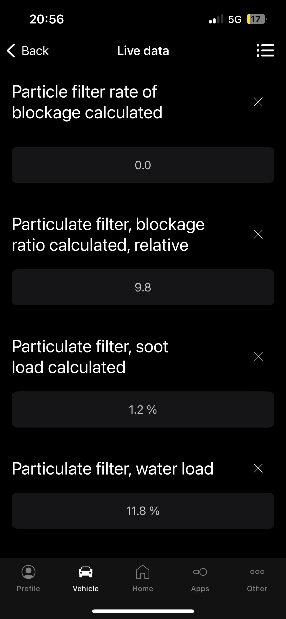

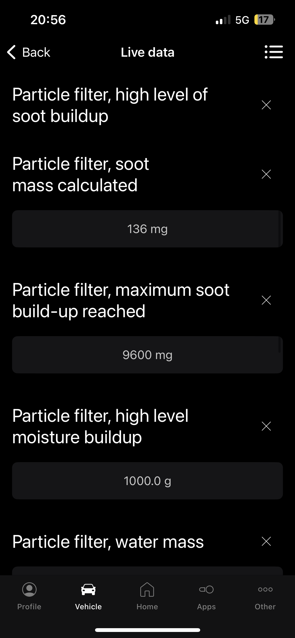

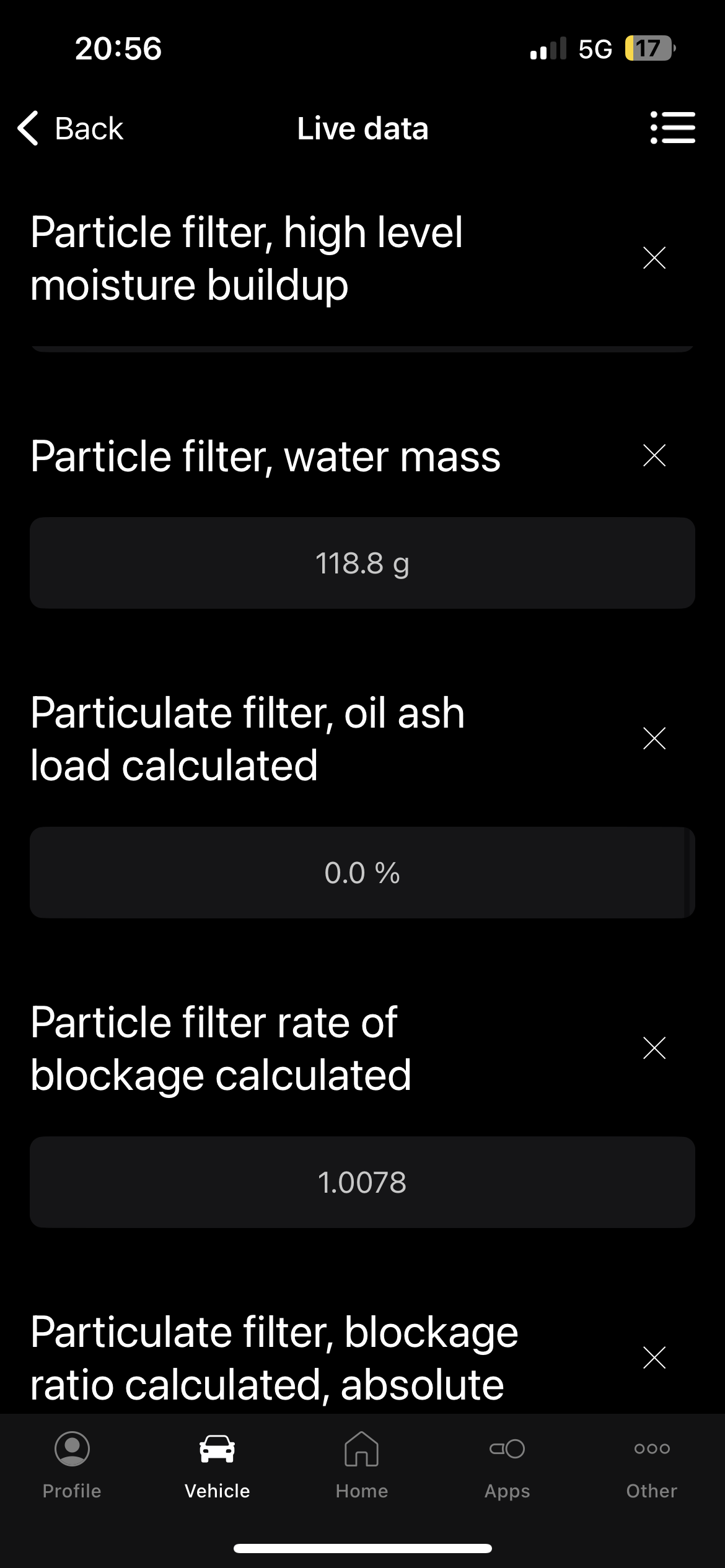

What’s the best way to force a regen? Just so I can at least rule that out.
Took from screenshots last week from OBDeleven live data on engine block, after seeing this thread, not sure if it means much. Not exactly sure what I’m looking for and was taken shortly after starting car hadn’t driven it.
Been to a Main dealer about this fuel economy issue but seems they won’t investigate if they don’t see any fault codes which is annoying.
Definitely something wrong here what it is I don’t know.
