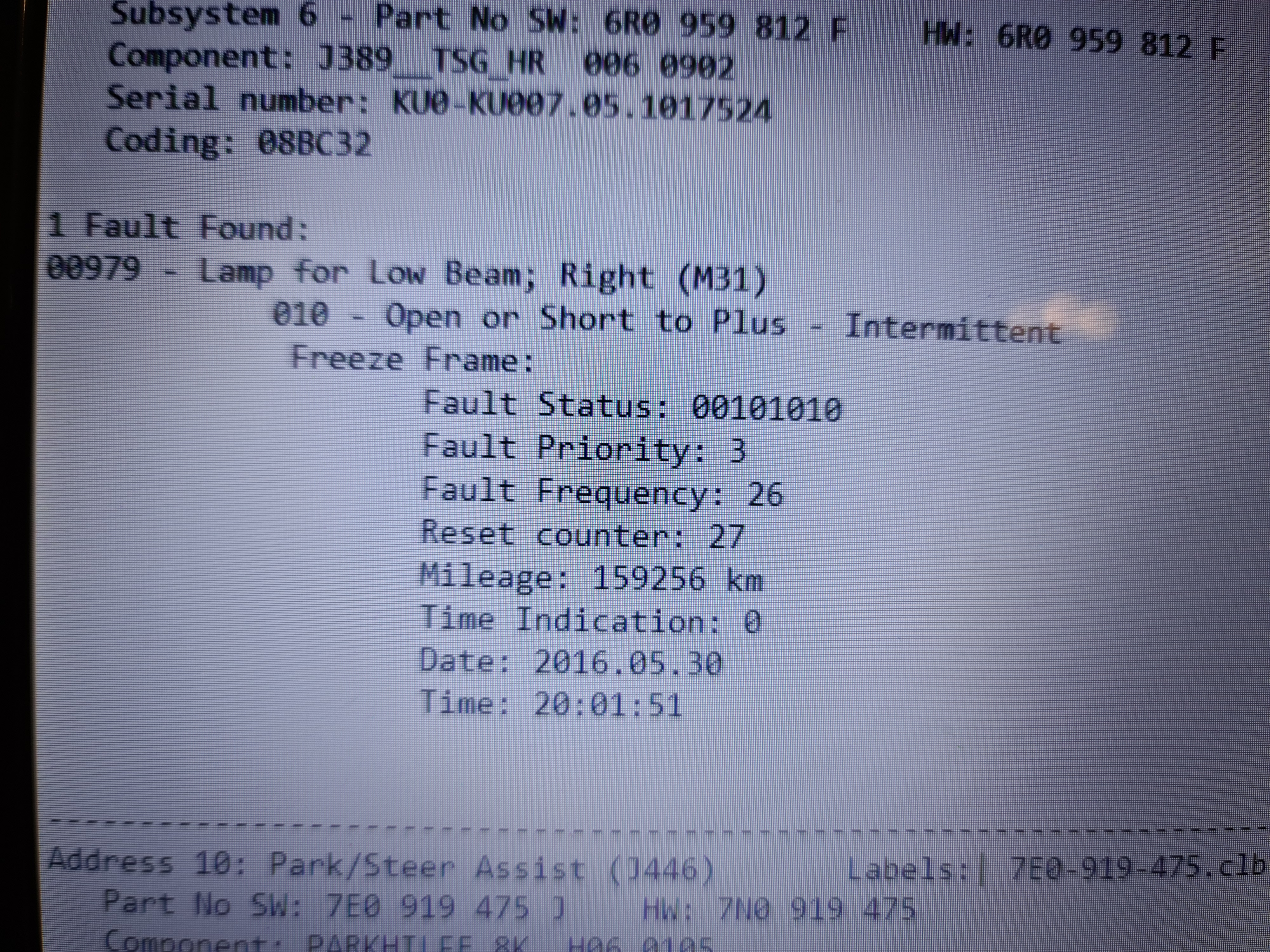

Little step forward!
I try this new BCM code and everything start to work normal, test all lights, and they work without flashing....finally, but that test was in the garage, i start to get the car out of it, lights was on auto position, and when the sensor fell the daylight, turn off the low beam and go on DRL, as it should be, but immediately got flashing yellow lamp on instrument cluster :( all lights continue working, and i stop and then start again the engine, no more flashing lamps on IC :?
After that i do an auto scan and got this error:
Will wait for tonight for long test drive and gonna report back.
So far so god :)

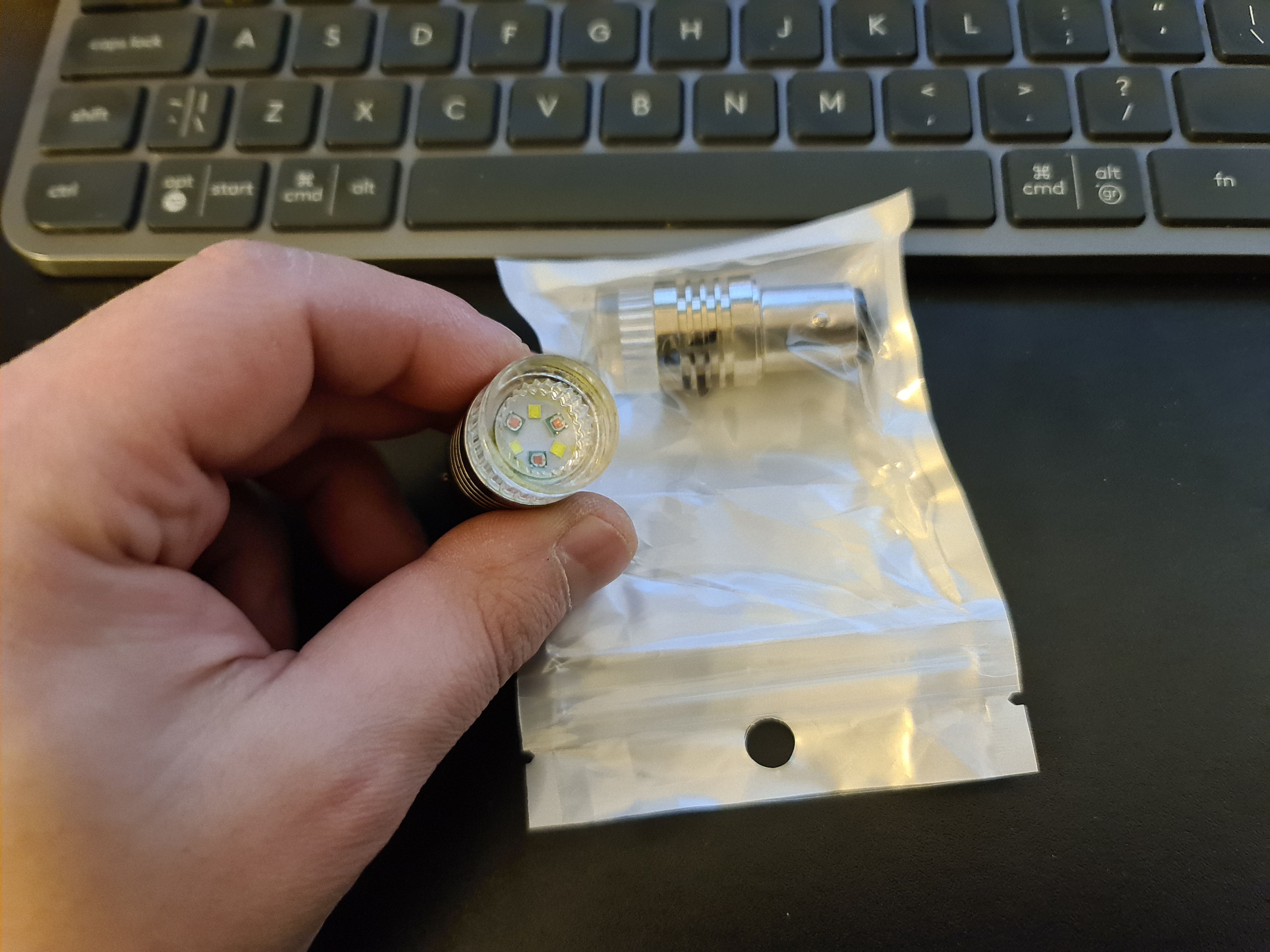

Image - For that double reverse and fog lights, I am prepared :D

After driving approximately ~ 50 km during the dark part of the day, i can say that there is no more flashing low beams!!, and the headlights are working almost prefect. Only the led stripes are still so bright when the switch is on parking light position and on auto position during the day, with the previous code they was a little bit darker on those positions.
And the auto scan says this:
Address 09: Cent. Elect. (J519)
1 Fault Found:
00979 - Lamp for Low Beam; Right (M31)
010 - Open or Short to Plus - Intermittent
Fault Status: 00101010
Fault Priority: 3
Fault Frequency: 254
Reset counter: 28
Mileage: 159256 km
Time Indication: 0
Date: 2016.05.29
Time: 20:01:51
But the right lamp was working all the time, and there is no problem with it, i clear that fault, I drove a little after that and the same fault was there :cry:
Posts: 9037
Re: 6C Full LED Headlights number
Assuming the wiring installation is correct, there are two possibilities for that INTERMITTENT fault:
- Battery in bad condition or not suitable for LED headlights.
- Deficiencies in the right headlight control module (behavior of electronic components, -the wonderful universe of electricity-👨‍🎓).

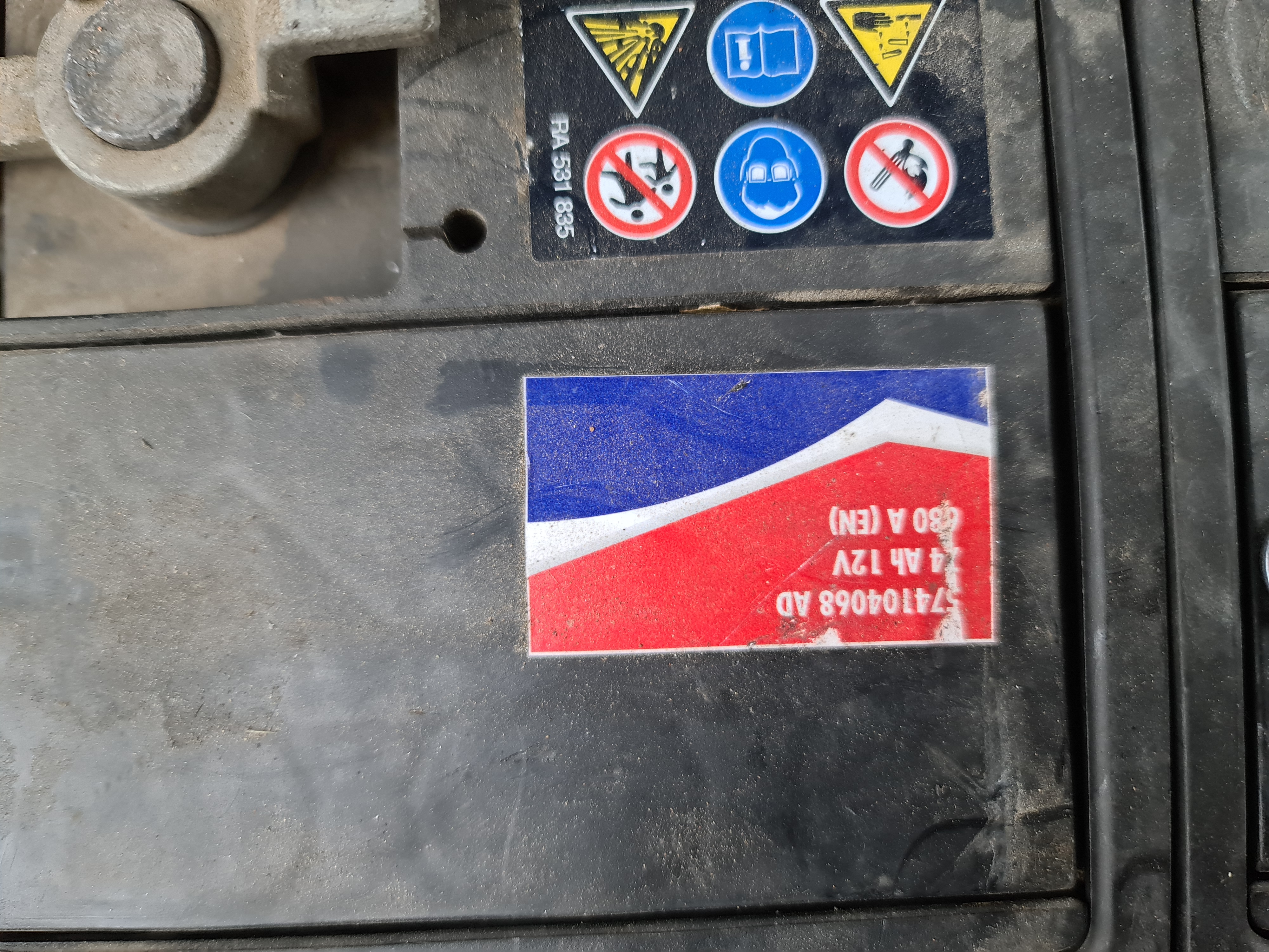

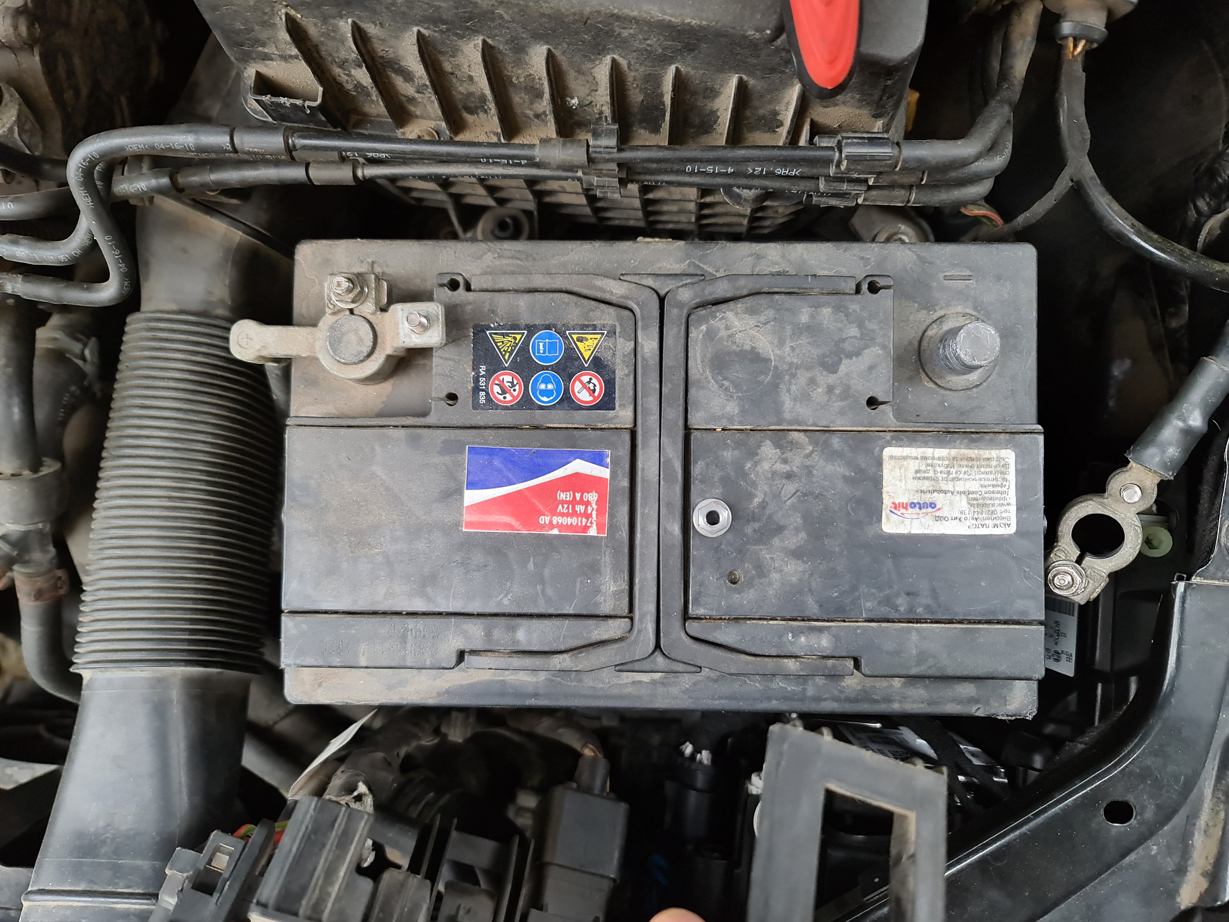

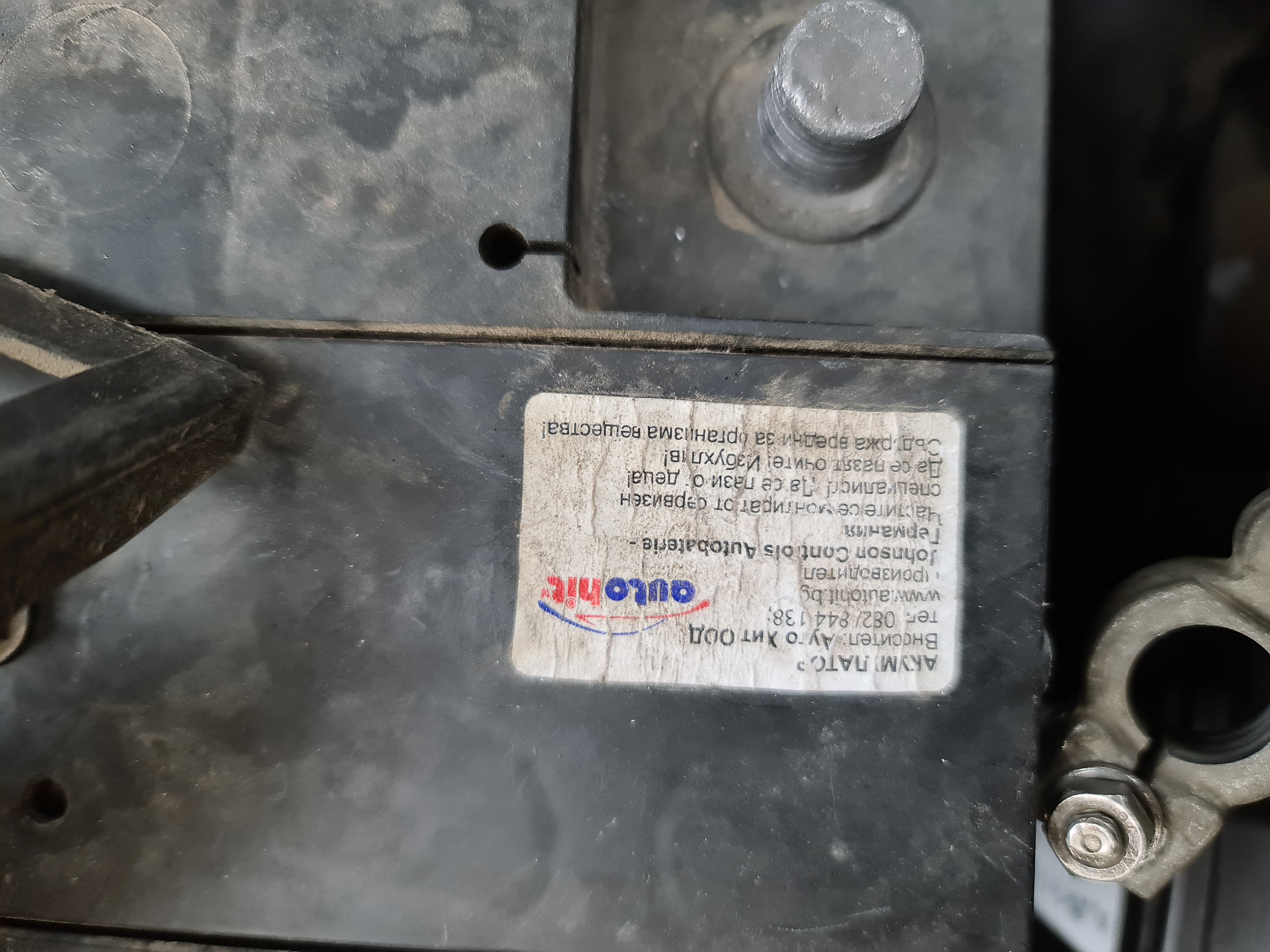

What battery is installed? Please take a picture of the Battery Reference.
Are the headlight control modules new? where you bought them?.
To avoid the intermittent fault, BCM Byte16 Bit4 ... enable.✅
(Note: you only avoid the diagnosis)

Actually my battery was dead one month ago, and i charge it up. Here are some pictures of it:
The control moduls for the headlighs are second hand. I brought them from allegro.pl from a specialized service for Xenons- repairs. They was in perfect condition.
