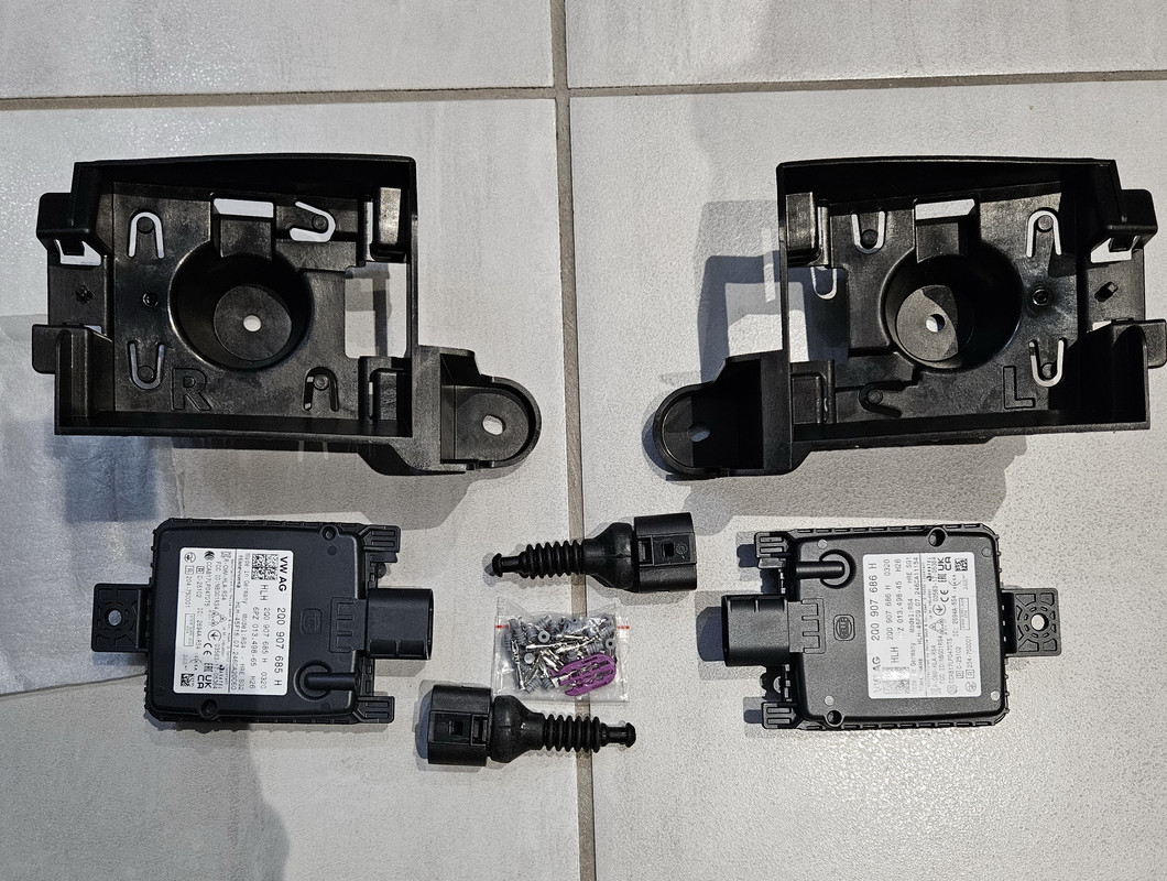

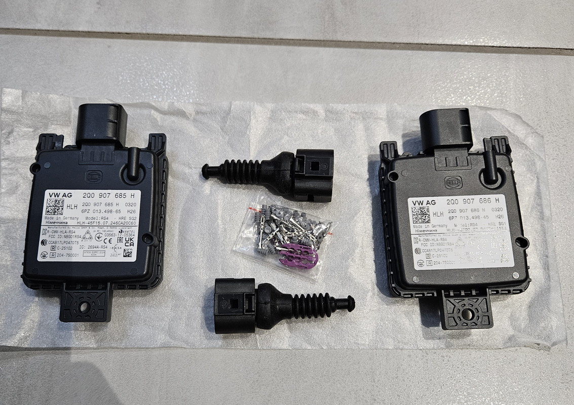

Well, it looks like I have a few pieces, enough to slowly start wiring and installing.
Thanks to Ciclo (Fernando) i have new radars and the correct connectors for them, thank you Fernando, you are so kind.
I also have the brackets for those radars...
So it's time for me to start thinking about wiring and preparing the installation.
It will be a slow process, but there is a saying that says that the beginning is half of everything.
Stay tuned....

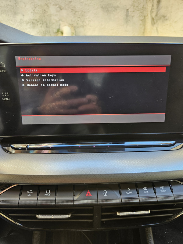

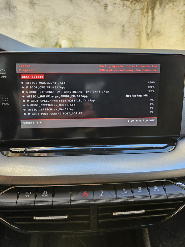

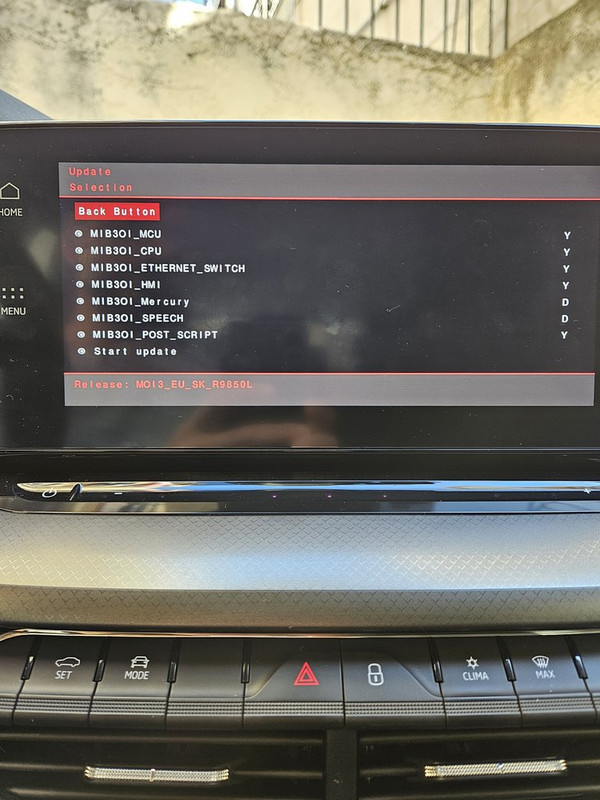

#Infotainment Update MOI3 MU_1985
Newer version for infotainment from SKODA.
ver:1985
Image Image Image
Τhe process is easy, if anyone is interested, here is a video that explains it.
https://www.youtube.com/watch?v=4AsSbGd3caU

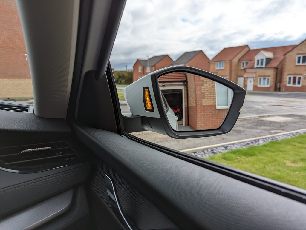

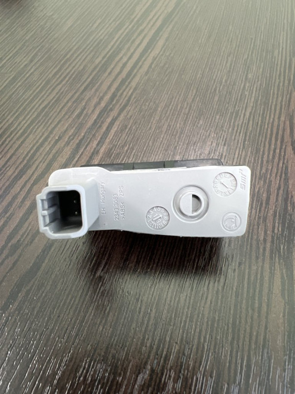

I am keep thinking about the warning light for the BSD.
The OEM way is a light on the outside mirror cover.
I didn't find the type of the connector, this LED light has.
Any ideas ?
Posts: 8907
Re: Skoda Octavia MK4 2023, 2.0TDi DSG Ambition
https://www.drive2.ru/l/687347050794202605/
:arrow: https://a.d-cd.net/Guw3ZcFO3uz-eckpOLv1u0vbkt0-1920.jpg
Image from the thread we mentioned earlier on Drive2.ru
I think it's this one:
MX19002S51
giannis20vt
Posts: 425
Location: Greece
Post by giannis20vt »
Great, thanks.
I didn't know the code for this connector.
Posts: 8907
It wasn't easy to find out (a couple of minutes thanks to the image posted on D2).
It's possible that generally only those who make the mirrors with BSD for the SK Octavia knew about it.🤷‍♂️

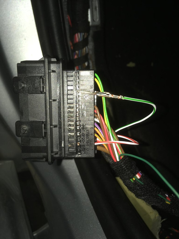

ciclo wrote: Sun Nov 10, 2024 5:42 am It wasn't easy to find out (a couple of minutes thanks to the image posted on D2).
Yes indeed. And another think, just to make sure. The pins for the door connectors are 000979034E and 000979035E (actually those are the codes from the repair wires which have those pins).
Posts: 8907
Yes, those are the correct contact terminals.
They have several applications in the MQB.

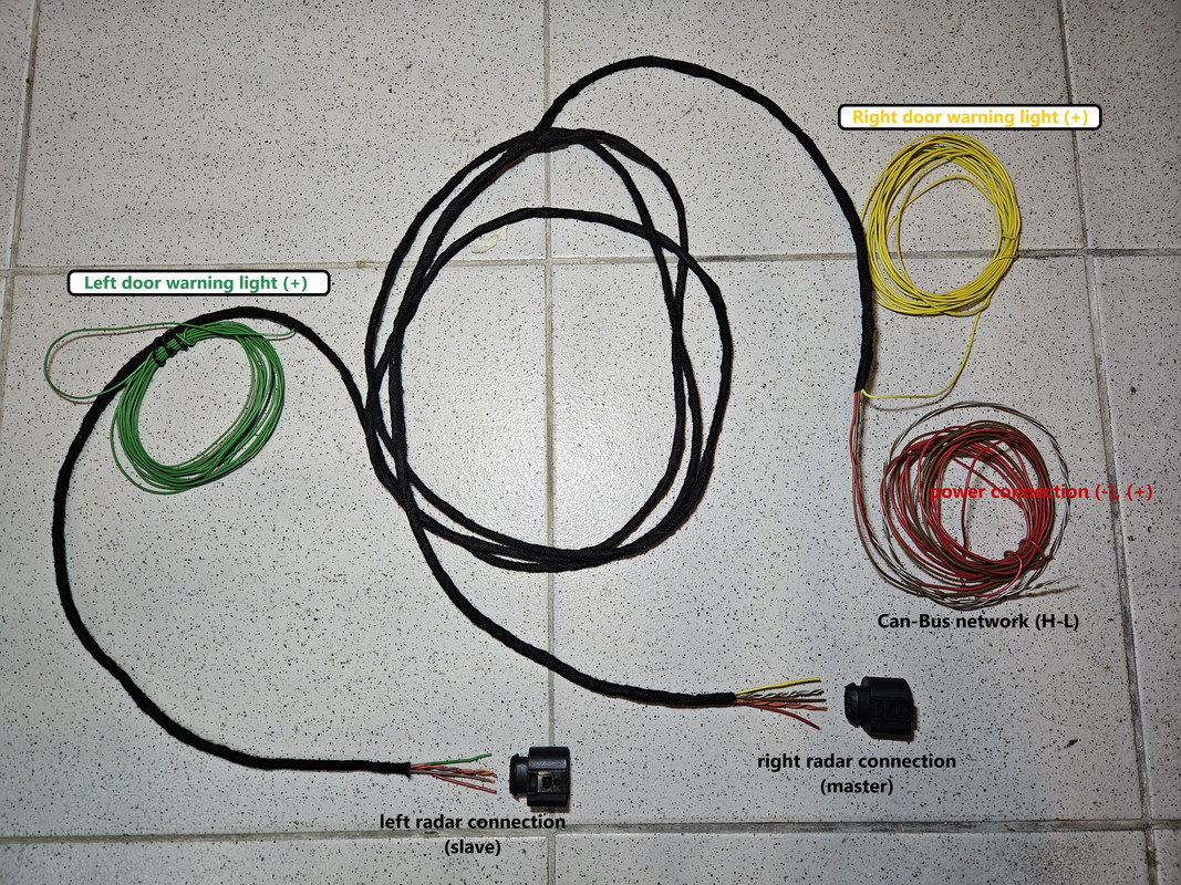

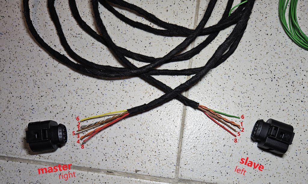

#BSD retrofit
Just a small update:
Posts: 8907
In the images you posted it is not clear to me which wire (yellow or green) is for the right door and which is for the left door.🤔
ciclo wrote: Tue Nov 19, 2024 7:30 am In the images you posted it is not clear to me which wire (yellow or green) is for the right door and which is for the left door.🤔
I made a mistake in the titles. Thank you for noticing. I changed the image so that no problems arise in the future.

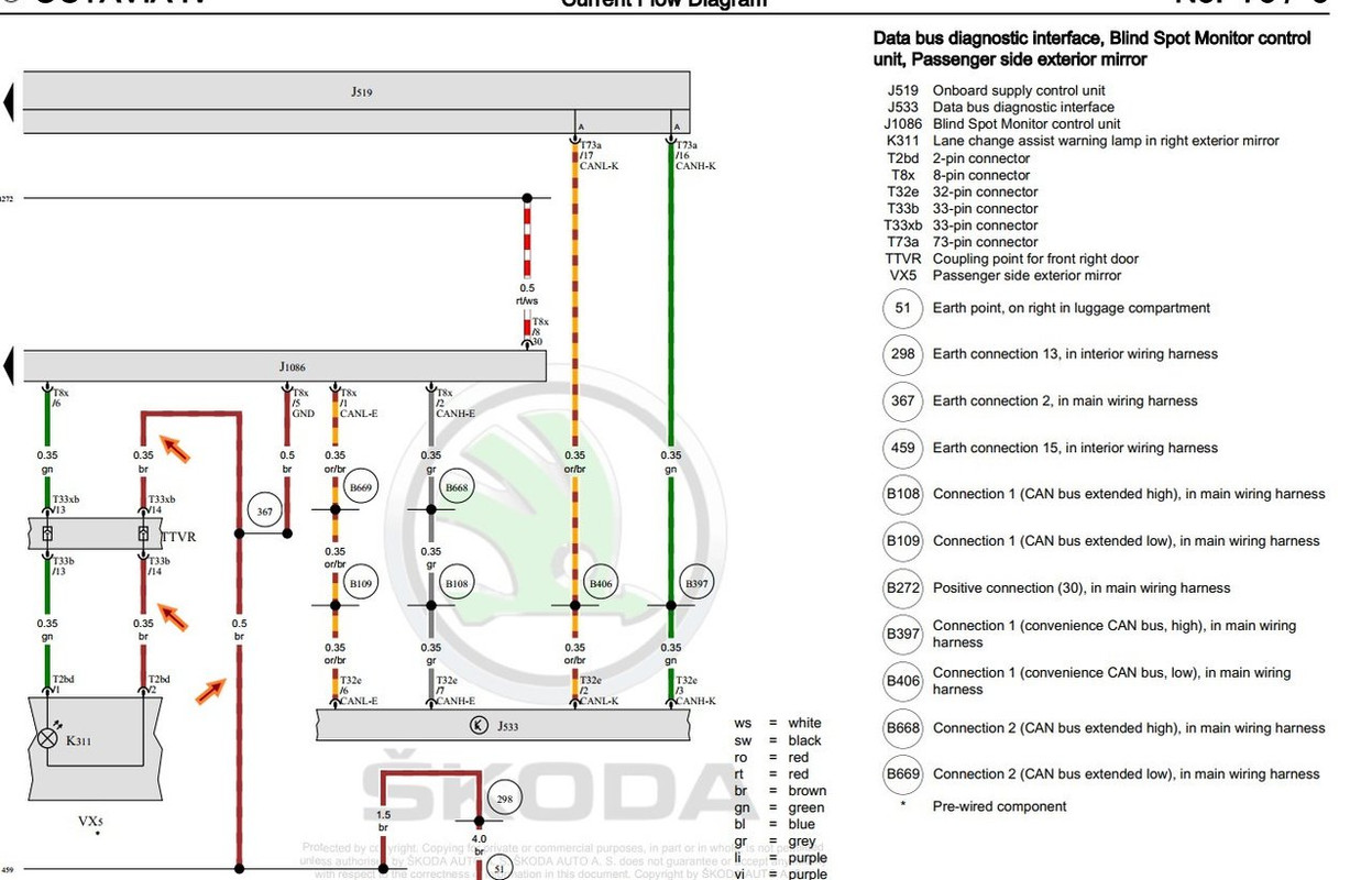

I have a question, maybe Fernando or someone else has the experience to answer.
This is a prt of the wiring schematic.
I notice that the ground wire of the LED lighting, the wiring shows it going through the door connector and ending up in the central ground somewhere inside the chassis.
And I wonder why this is happening. I have in mind to use whichever wire inside the door already goes to ground.
What do you think?
