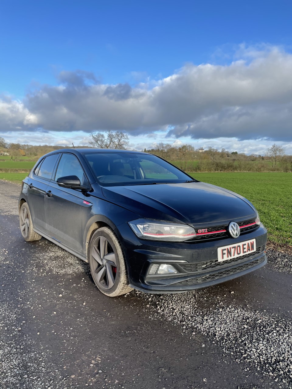

Went for a drive down to Birmingham over the weekend, they've got lots of fields and dirt, which fits nicely with the theme of my car currently.

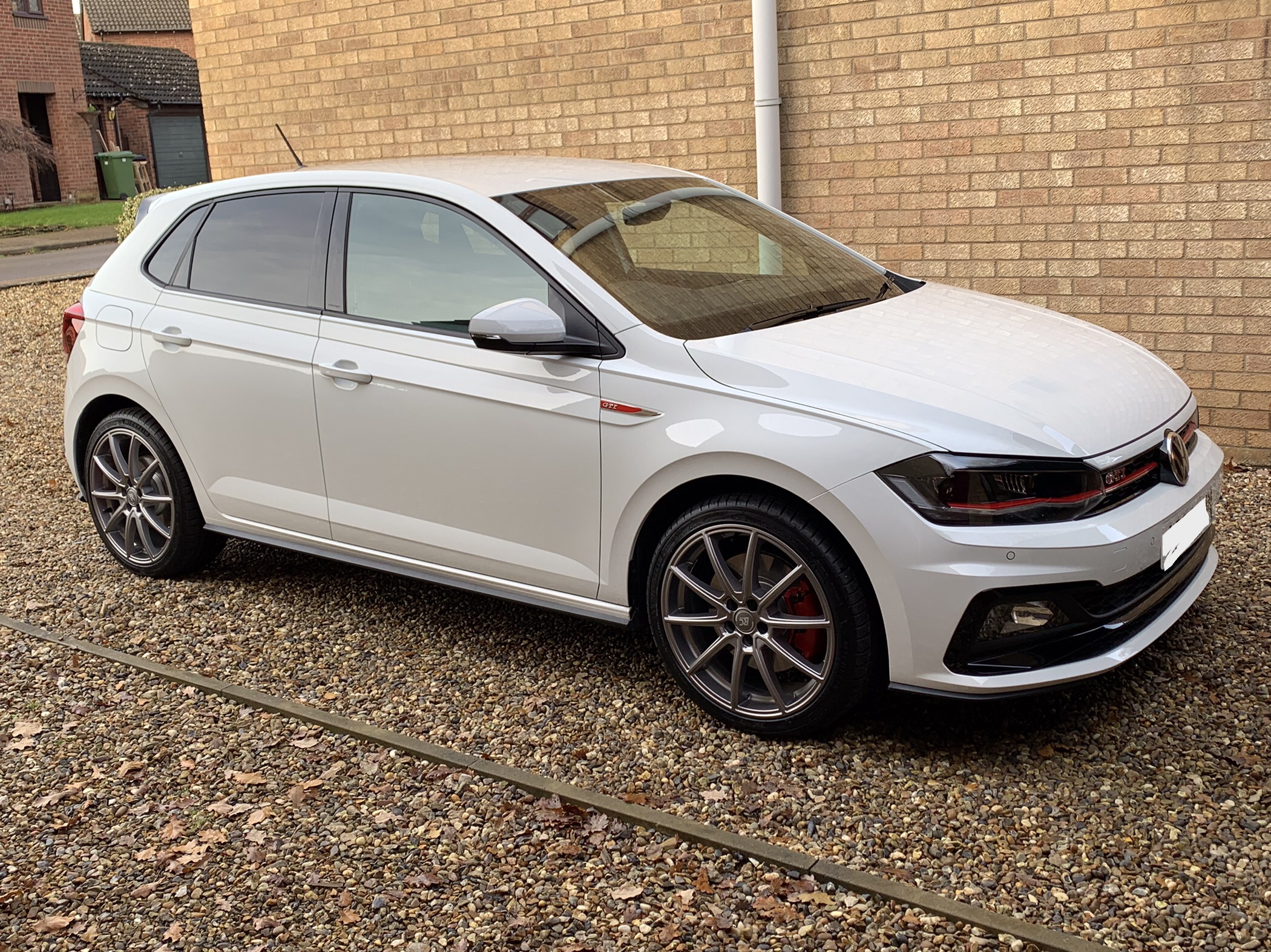

Posts: 3847

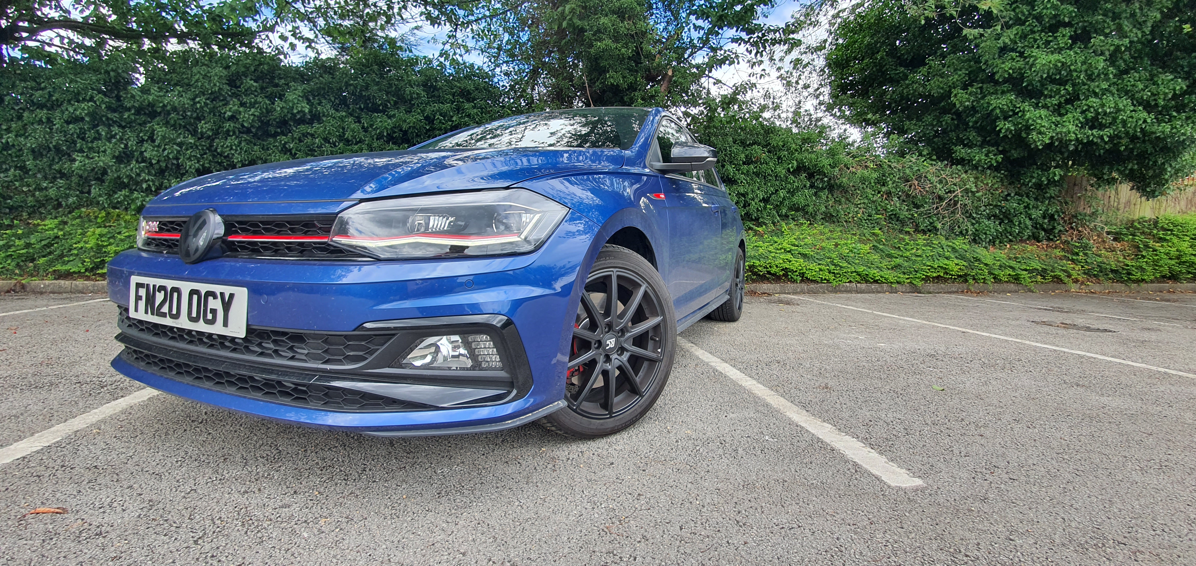

New wheels fitted to my GTI+; RC Design RC32, 7.5J x 18” ET51 in Ferric Grey Matt powder coat finish, which replace the original Brescia diamond cut alloys. I was going to wait until after Christmas to get them fitted, but couldn’t wait that long! 🙂. I also gave the car a pre winter clean and wax (Collinite 845 Insulator Wax) a couple of days ago.
A ‘plus’ for me with the new wheels is they’re easier to clean than the Brescias. Another plus is that being powder coated, they won’t suffer from white worm corrosion, which unfortunately seems to be pretty common with VW’s diamond cut alloys at around 2+ years, and sometimes sooner.

They look brilliant mate. 8)
Posts: 3847
S_94 wrote: Thu Dec 17, 2020 11:45 pm They look brilliant mate. 8)
Thanks. I’m pleased with how they look. They’re a bit lighter in colour than the anthracite grey Motorsport alloys I had on my previous model GTI - I’d probably describe them as being a dark silver rather than grey.
I have to agree with @Stuart_Rendall that they do have quite an OEM look to them. If VW had offered a similar style of painted / powder coated wheel on the GTI when I bought mine, it would definitely have been my choice.

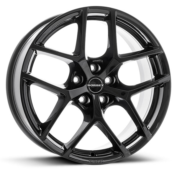

I've been looking at the Borbet Y Alloys in Gloss Black but can't decide if they'll go well with a White car. Don't get me wrong I love the Brescia alloys but do fancy a change... :roll:

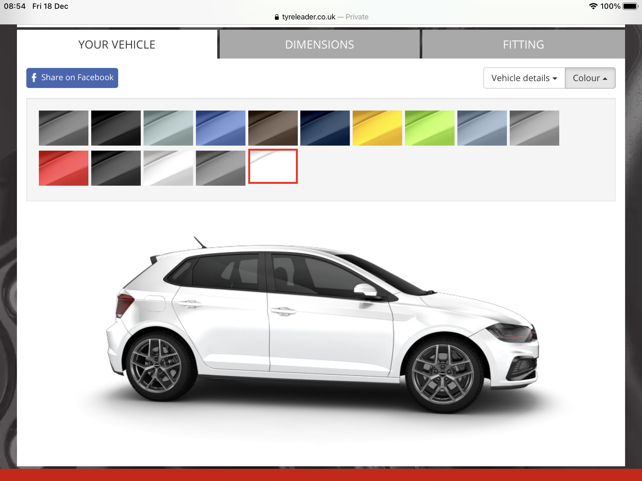

Black does generally tend to go well with White cars IMO. There are some of the alloy wheel retailer websites that have a configurator on them, so you can see what the wheels you’re thinking of buying will look like on your car before you actually buy them.
There’s a configurator on the Tyreleader website and they do have Borbet Y alloys to fit the Polo (8J x 18” ET40), although they’re not gloss black (they’re a Matt Titan Grey, which I think looks good) but it gives you an idea of what they’d look like on the car. Here’s a picture of a screen shot from their configurator of a White Polo GTI with Titan Grey Borbet Y alloys;

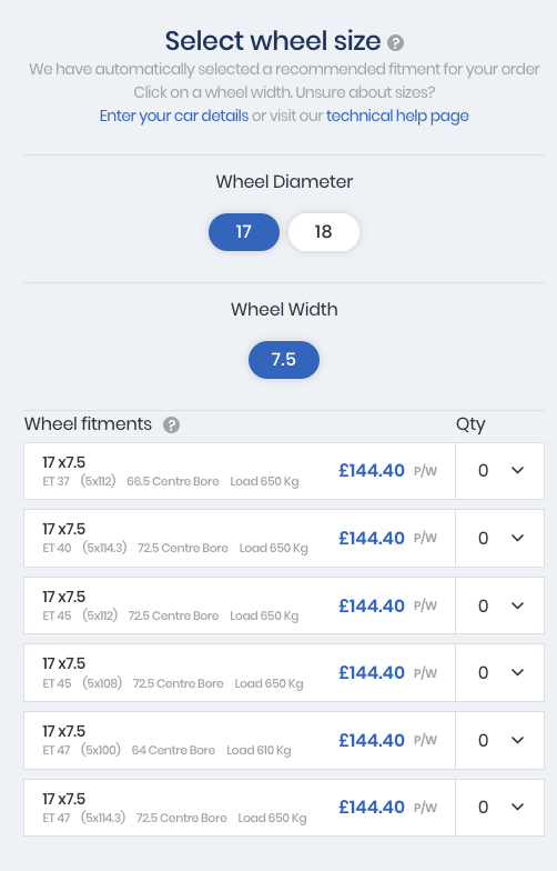

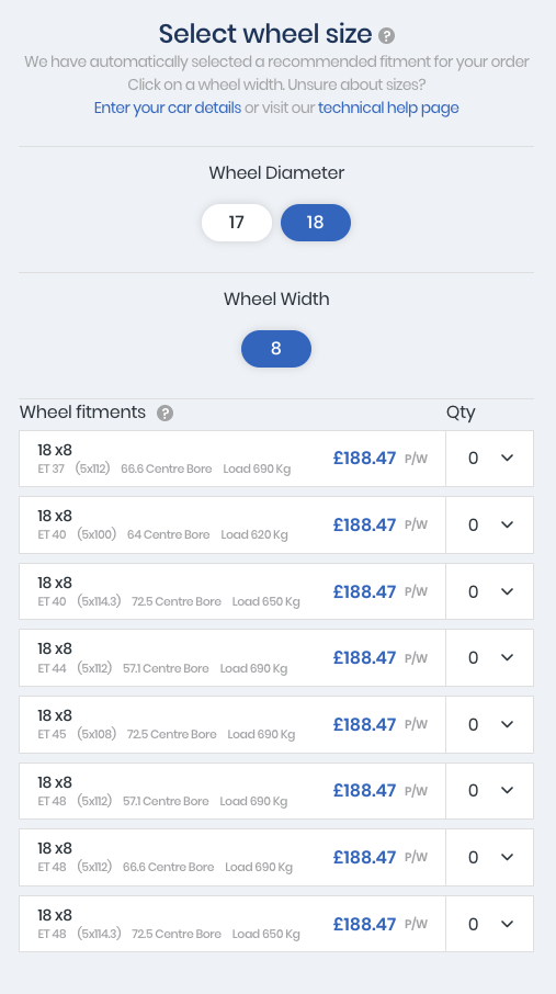

This may sound like a stupid question, but as I've got Michelin Pilot Sport 4s in the size 225/40/18 does that mean I would only be able to fit 18' Alloys to that tyre? Reason I ask is because you can get the Borbet Y in a 17' for a bit cheaper.
Also struggling to understand offset and what would fit on the Polo. The Brescia's have an offset of 51 if I'm not mistaken, so I'm wondering if a lower offset Alloy would fit okay on the car.

Yes, only 18” wheels would fit your existing tyres.
As for offset; the lower the ‘ET’ number, the more aggressive the offset, which means the wheel will protrude / ‘poke’ outwards further, so an aggressive offset does increase the risk of the tyres rubbing the edge of the wheel arches, depending on how aggressive the offset is. There’s a really useful calculator on www.willtheyfit.com. If you input the details of both your existing and new wheel / tyre set up, it’ll calculate the critical clearance differences between your existing and new set up, which will help you determine whether or not you’d have any fitment issues with specific wheel / tyre combinations you might be considering. Pretty much all the reputable on line wheel retailers will only show you details of wheels that will fit your car when you input details of what car you have on their website, but don’t forget that your tyres are wider than a 7.5J or 8J wheel, so this additional tyre width needs to be factored in when considering rubbing / clearance issues.
I wanted wheels that were as close as possible to the spec of the Brescias so I wouldn’t have any clearance / rubbing issues. My wheels are exactly the same size / spec as the Brescias (7.5J x 18” with an offset of ET51), so they fitted fine. The centre bore was also the same size as VW’s ‘standard’ centre bore size (57.1), so there was no need to fit spigot rings to ensure the wheel fitted snugly on the hubs. The bolt holes in the wheels also took the standard VW radius seat bolts as well. With many aftermarket wheels, the bolt holes either have a tapered or flat profile, so new bolts are needed with a seat that correctly fits the bolt hole profile in the wheel. The wheel retailer should supply a fitting kit that includes new bolts if these are required, along with spigot rings if any wheels you’re thinking of buying have a centre bore that’s larger than the Polo’s 57.1.
