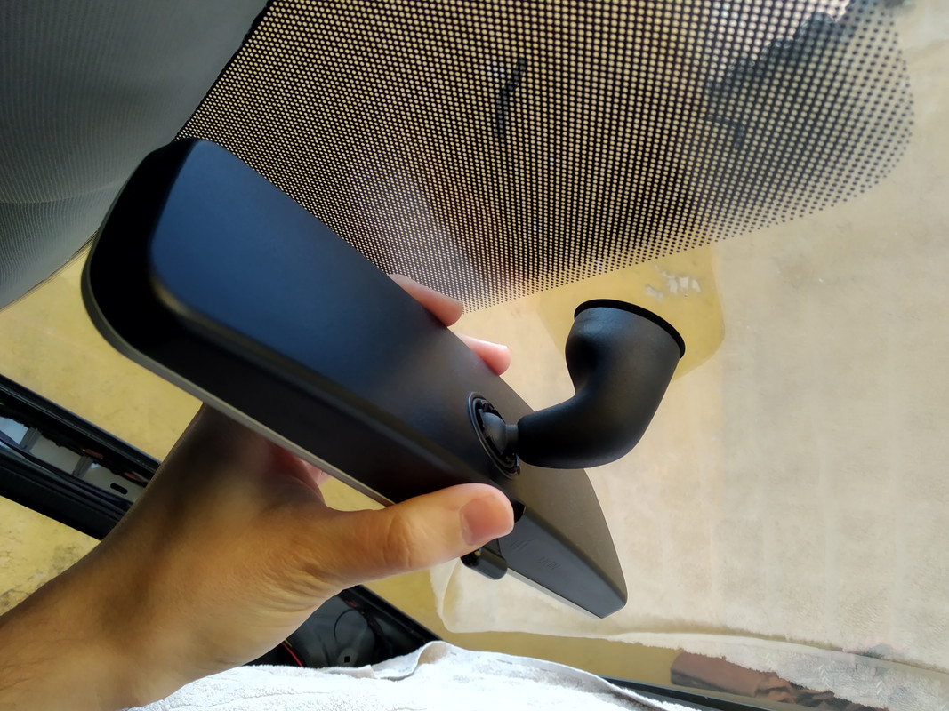

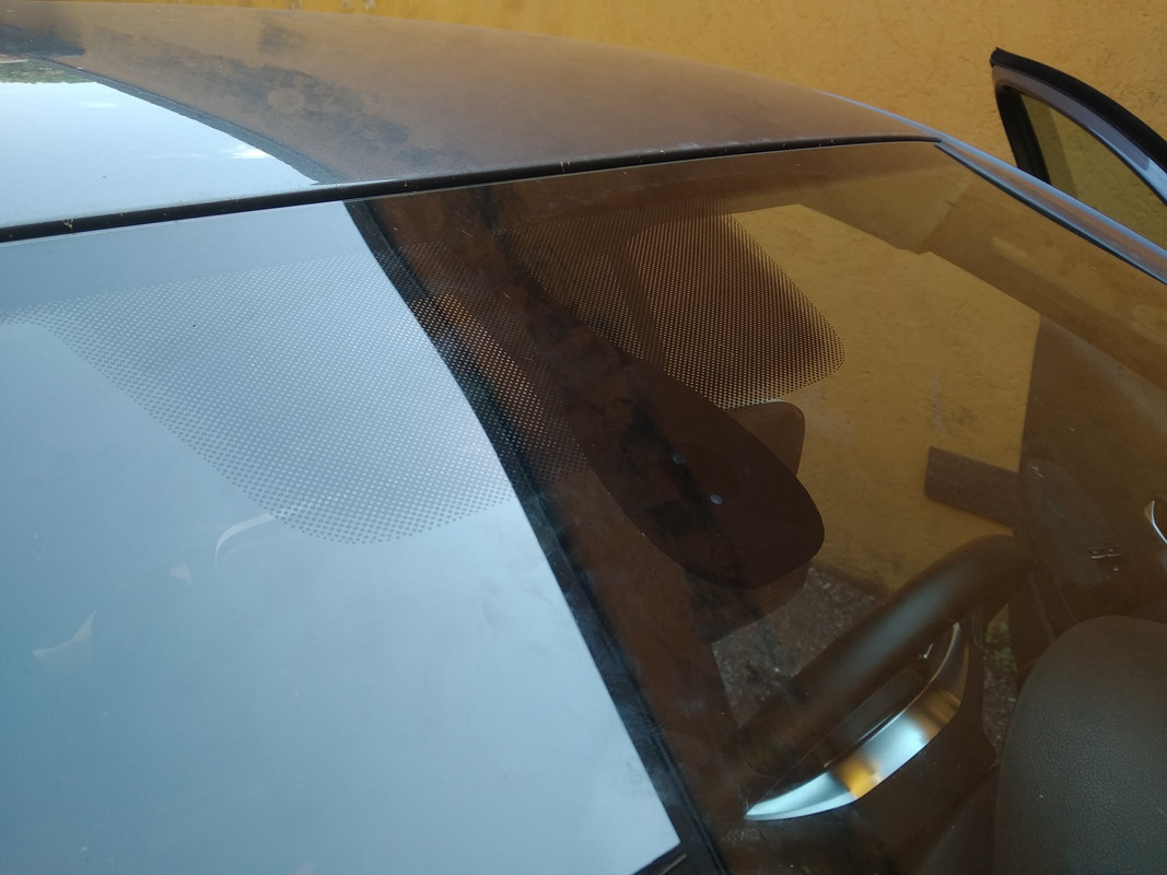

Now, as I anticipated here are some pictures of my retroit of photocromatic mirror with RLS.
Start by removing old mirror from windshield (easy part). :lol:

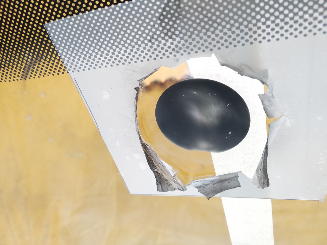

Next step is removing the metal bracket which is glued to a ceramic disk on the windshield (difficoult part). :)

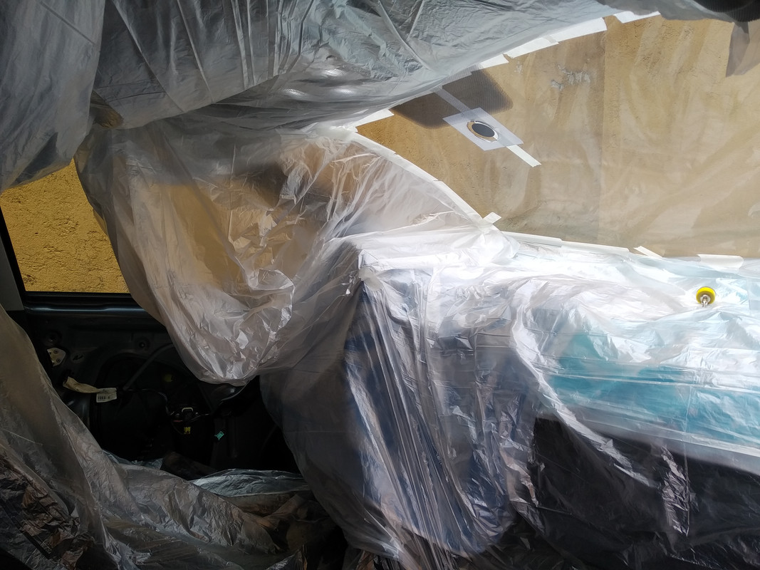

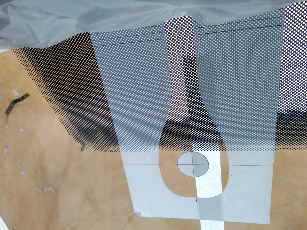

Let's first protect the car for the next work.
Mask the windshield to delimit the area where to work on.

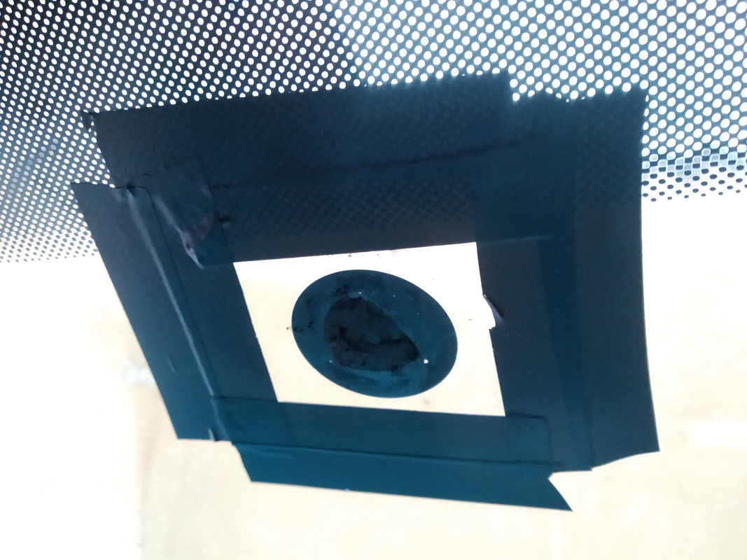

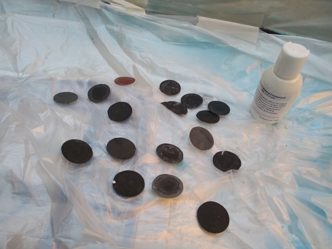

Now with sandpaper disks we have to remove the ceramic disk on the windshield (eternal work). :lol: :lol: :lol:

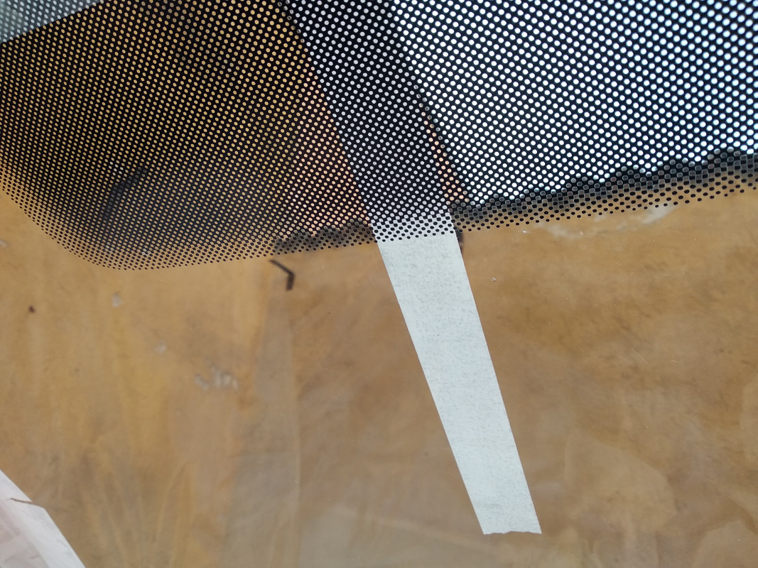

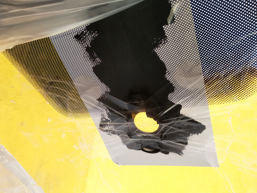

Using glass polish the windshield back to being perfectly clear.
I used a plastified adhesive to mask the area before painting with black glass primer from VW.
Within 1 hour from painting the new braket has to be glued to the windshield using epoxy glue from VW.

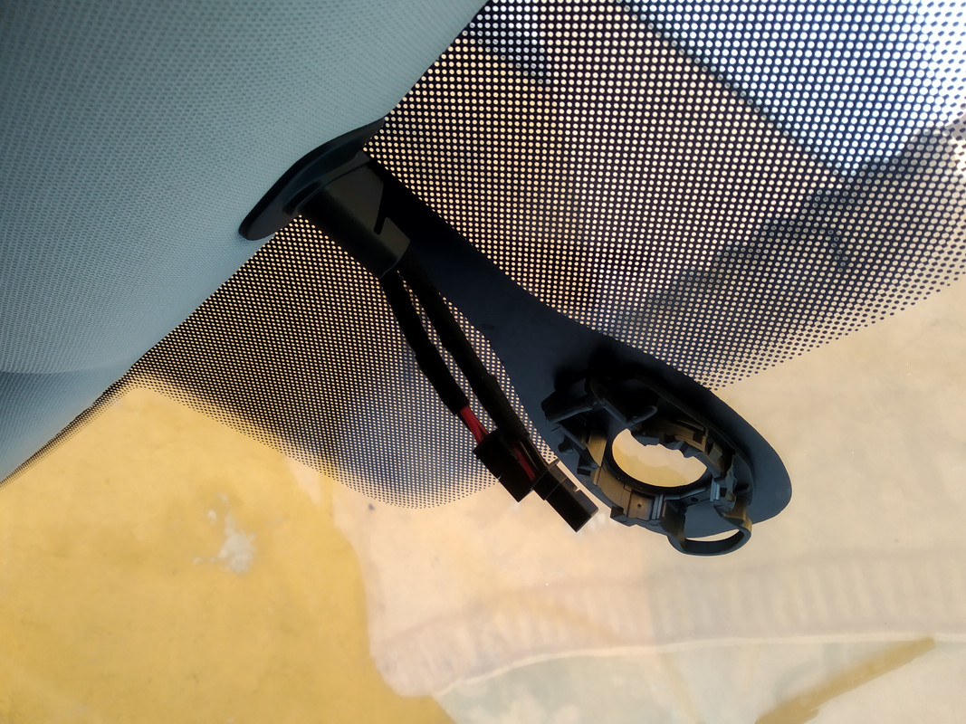

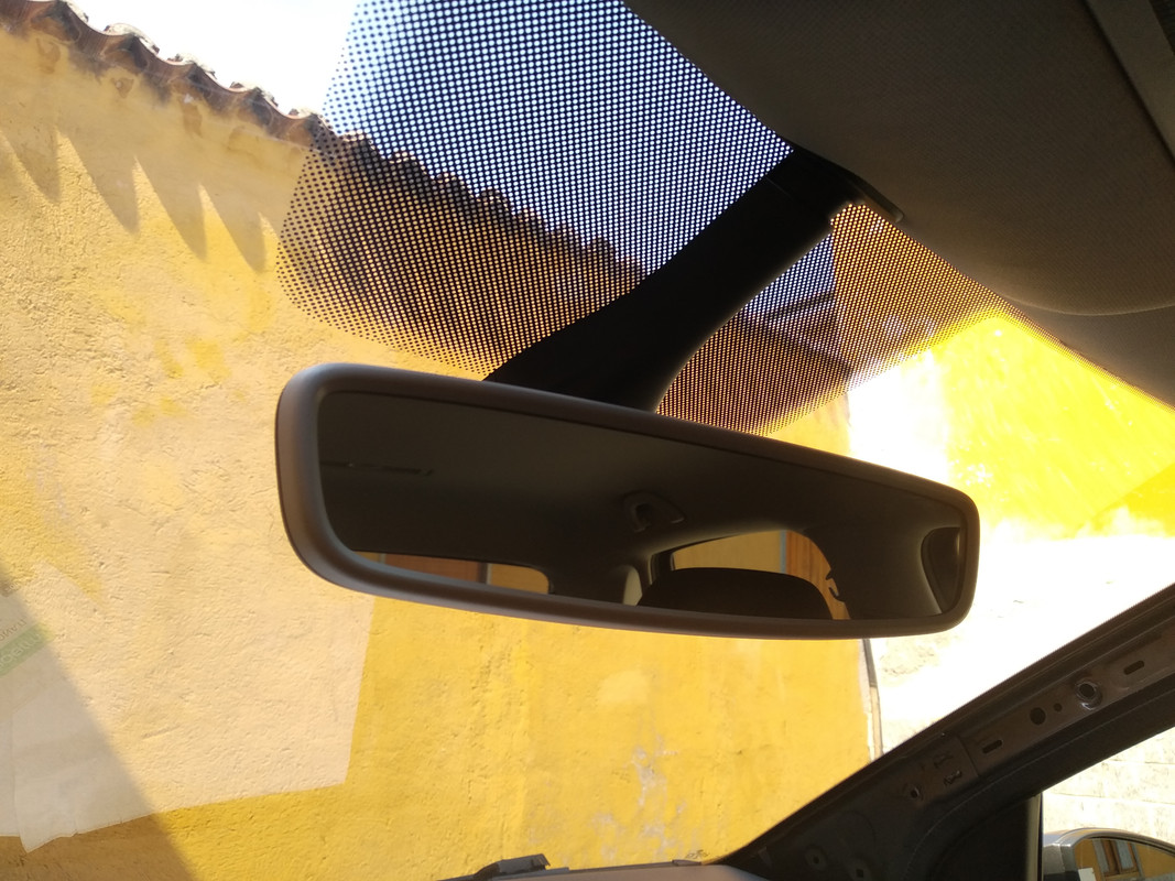

Here's the 6C photocromatic mirror with RLS.
Let's fit the RLS first.
And then mount the mirror. Job is done!
Rain sensor works fine.
