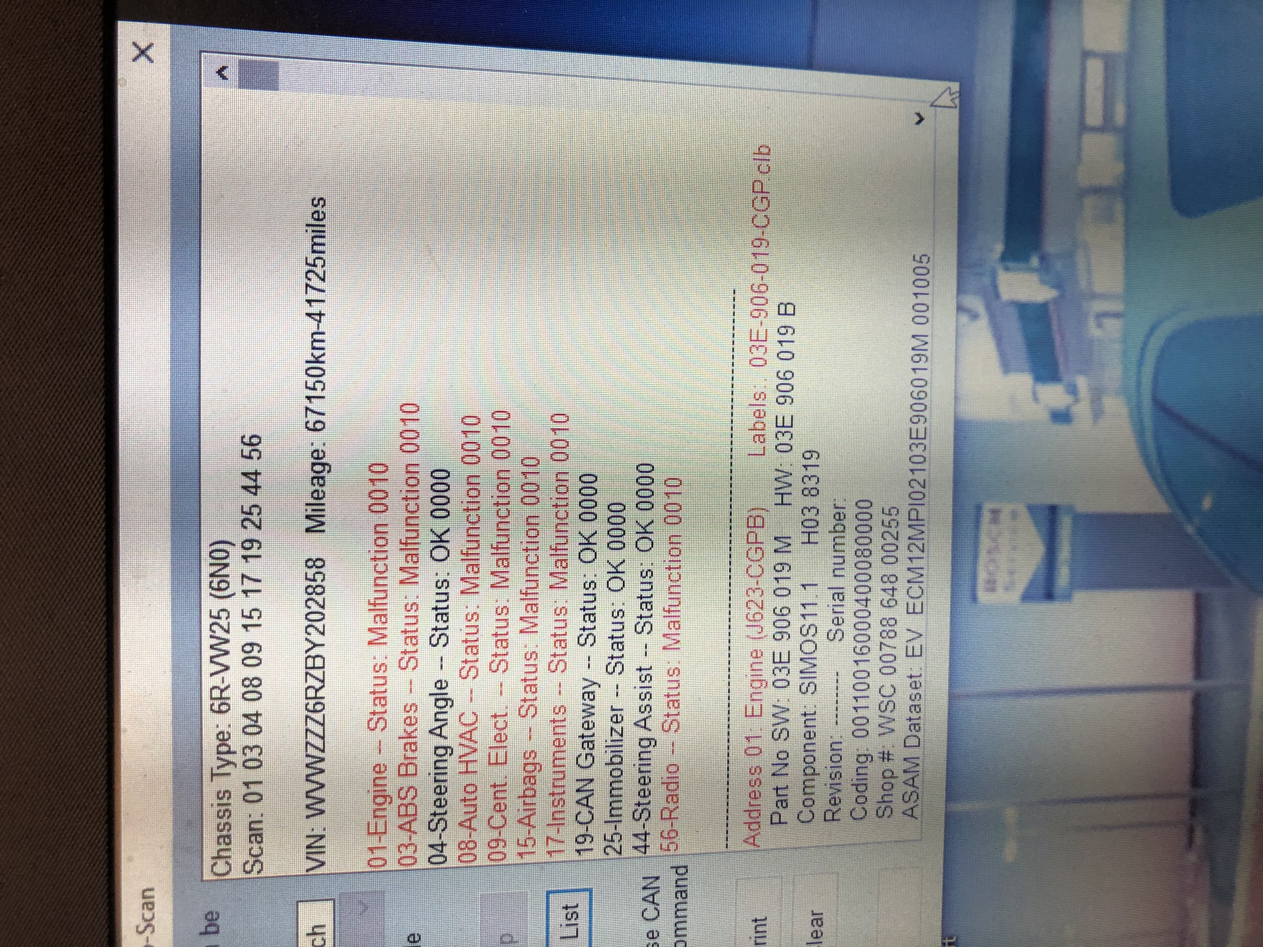

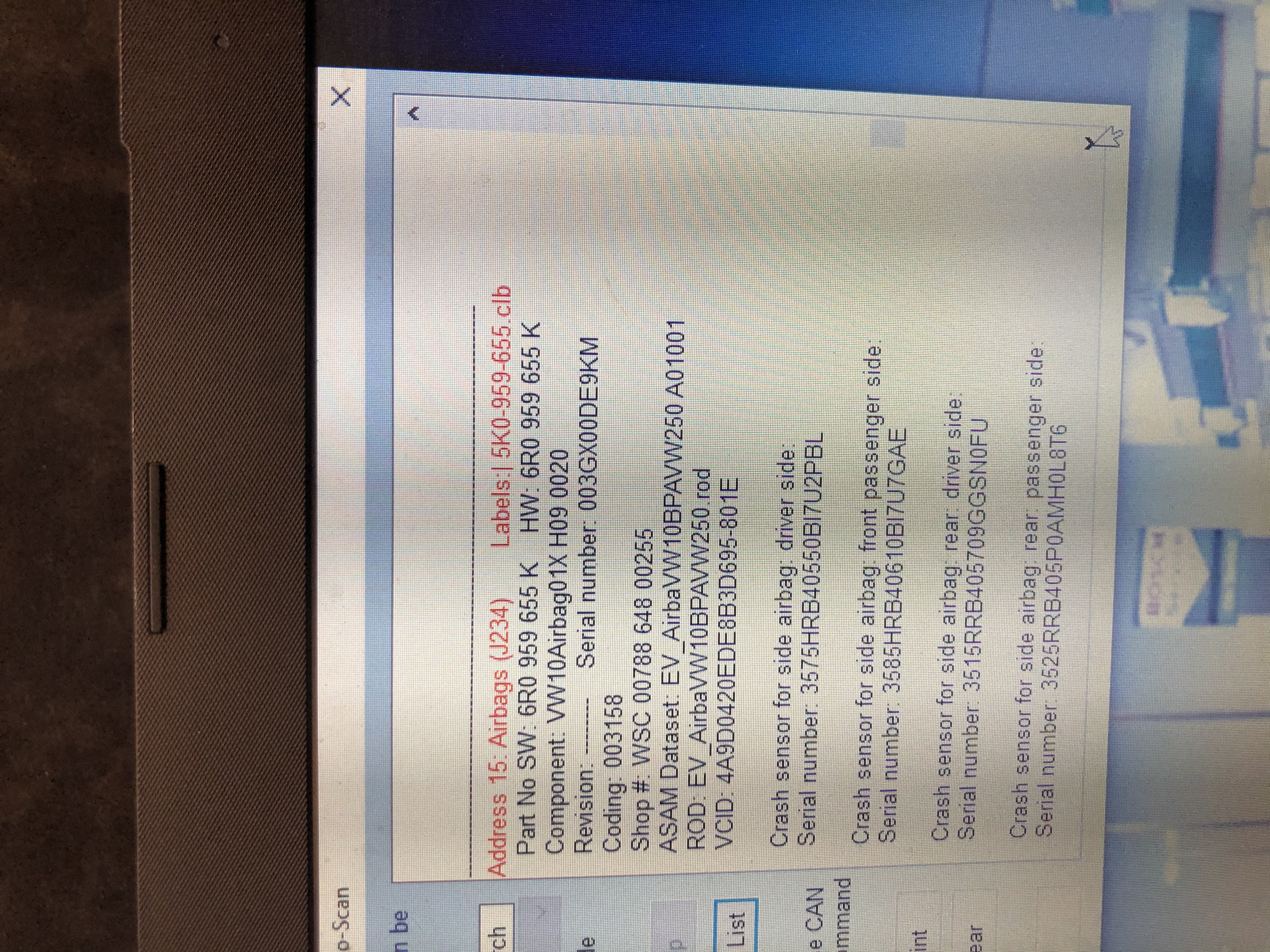

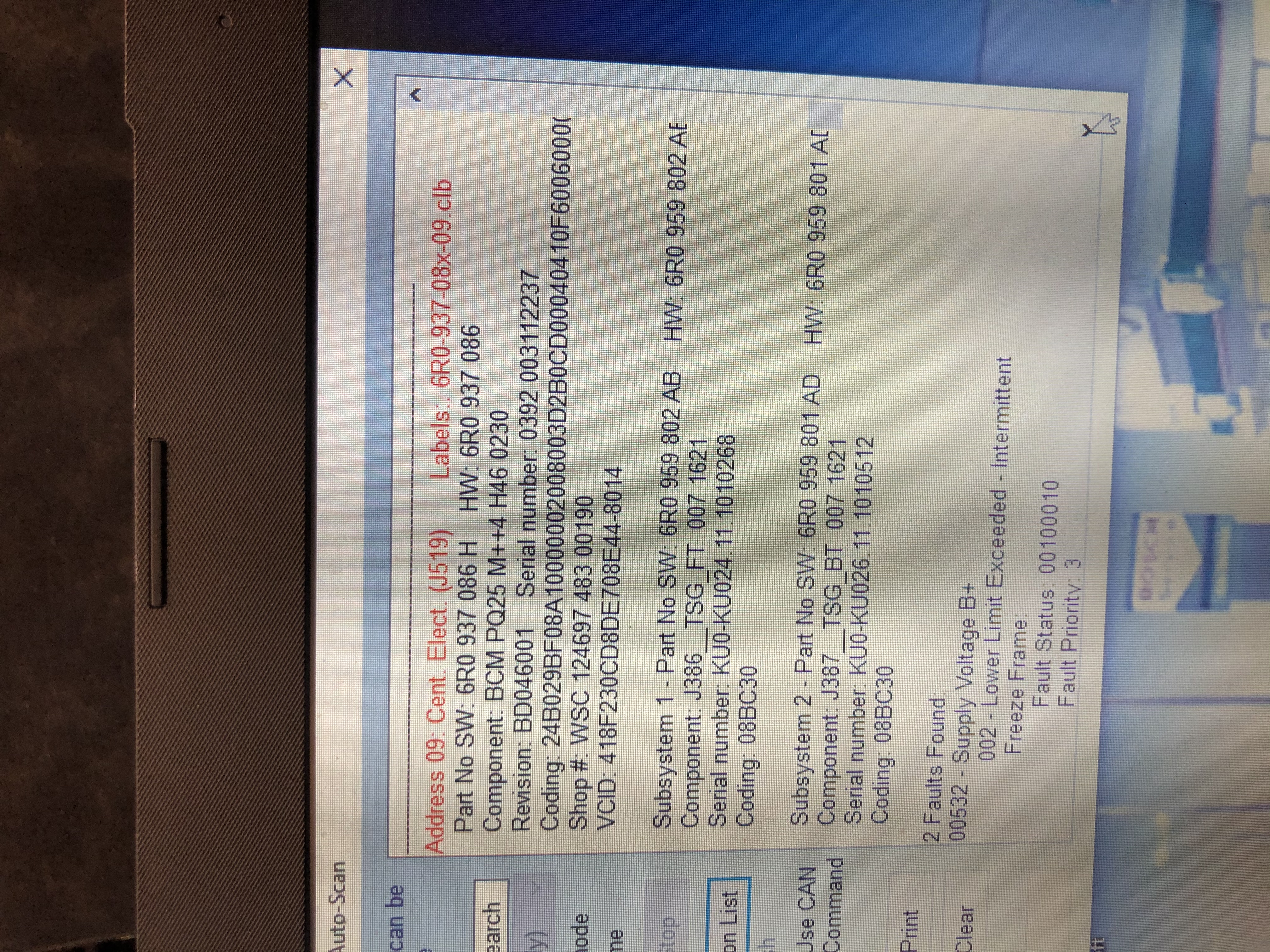

Any chance you could post an autoscan with the current configuration?
- Posts: 6378
Re: Restoring lost abs long code with new vcds hex v2 pro
I'm going to need a full autoscan please

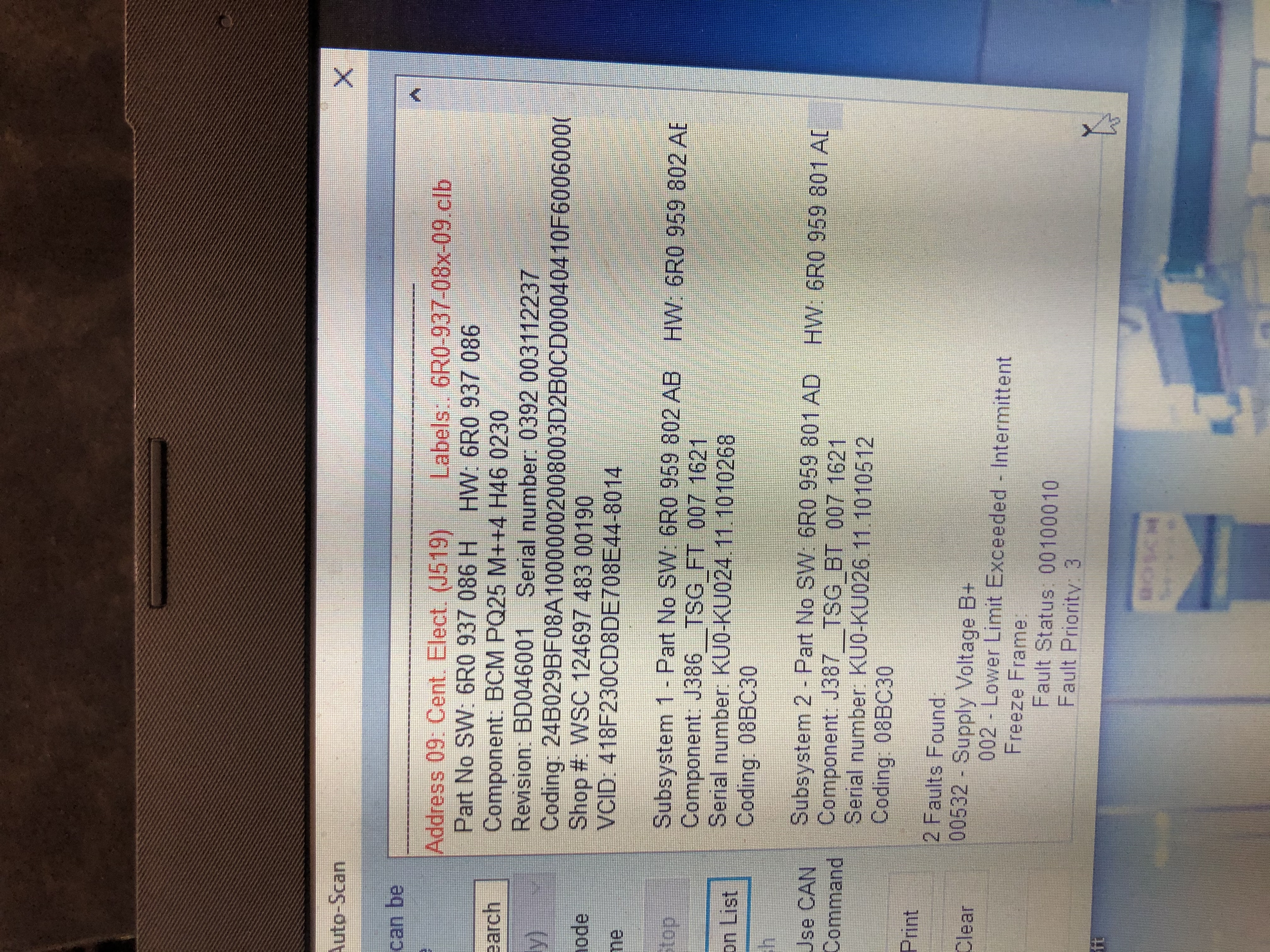

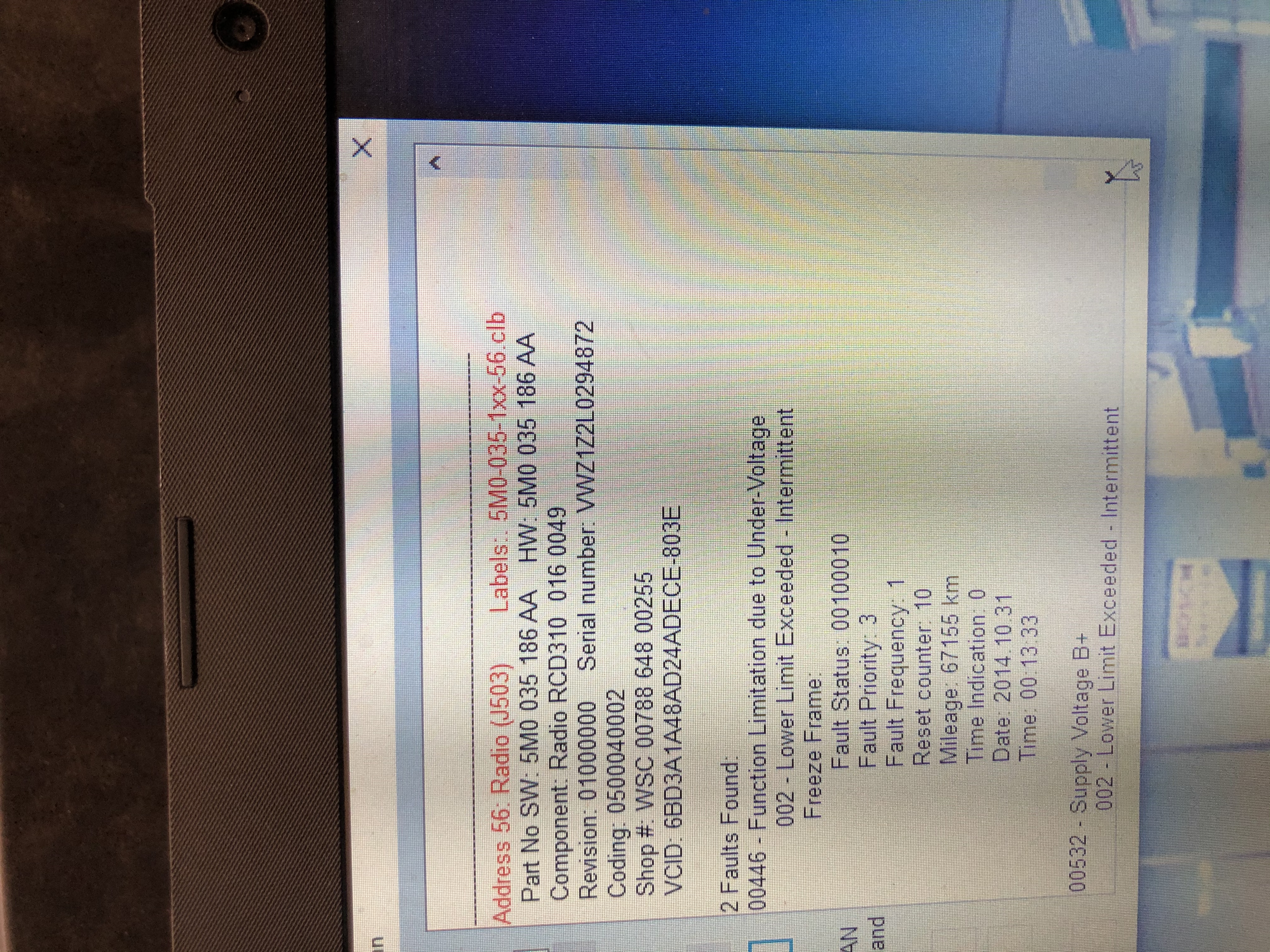

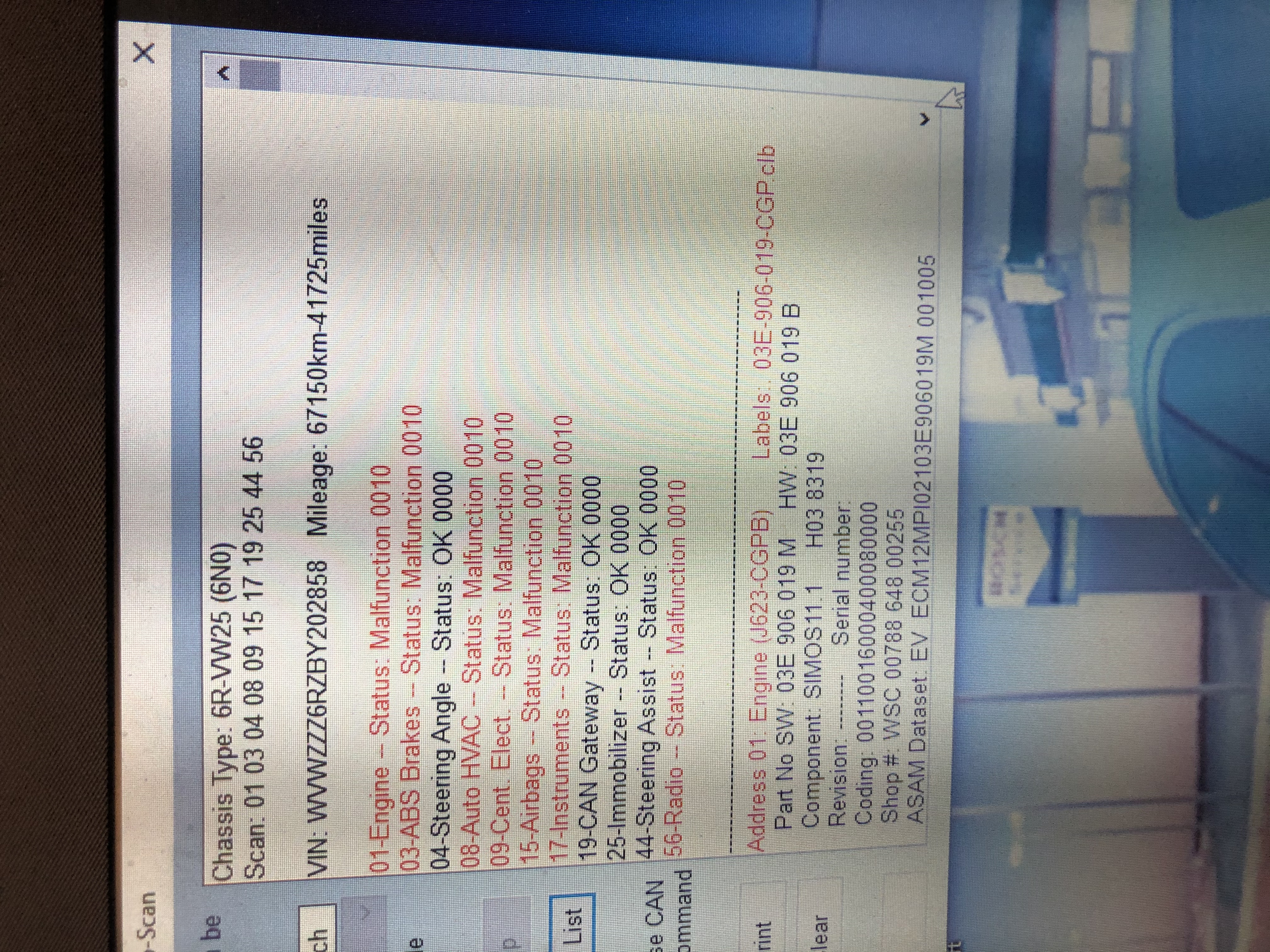

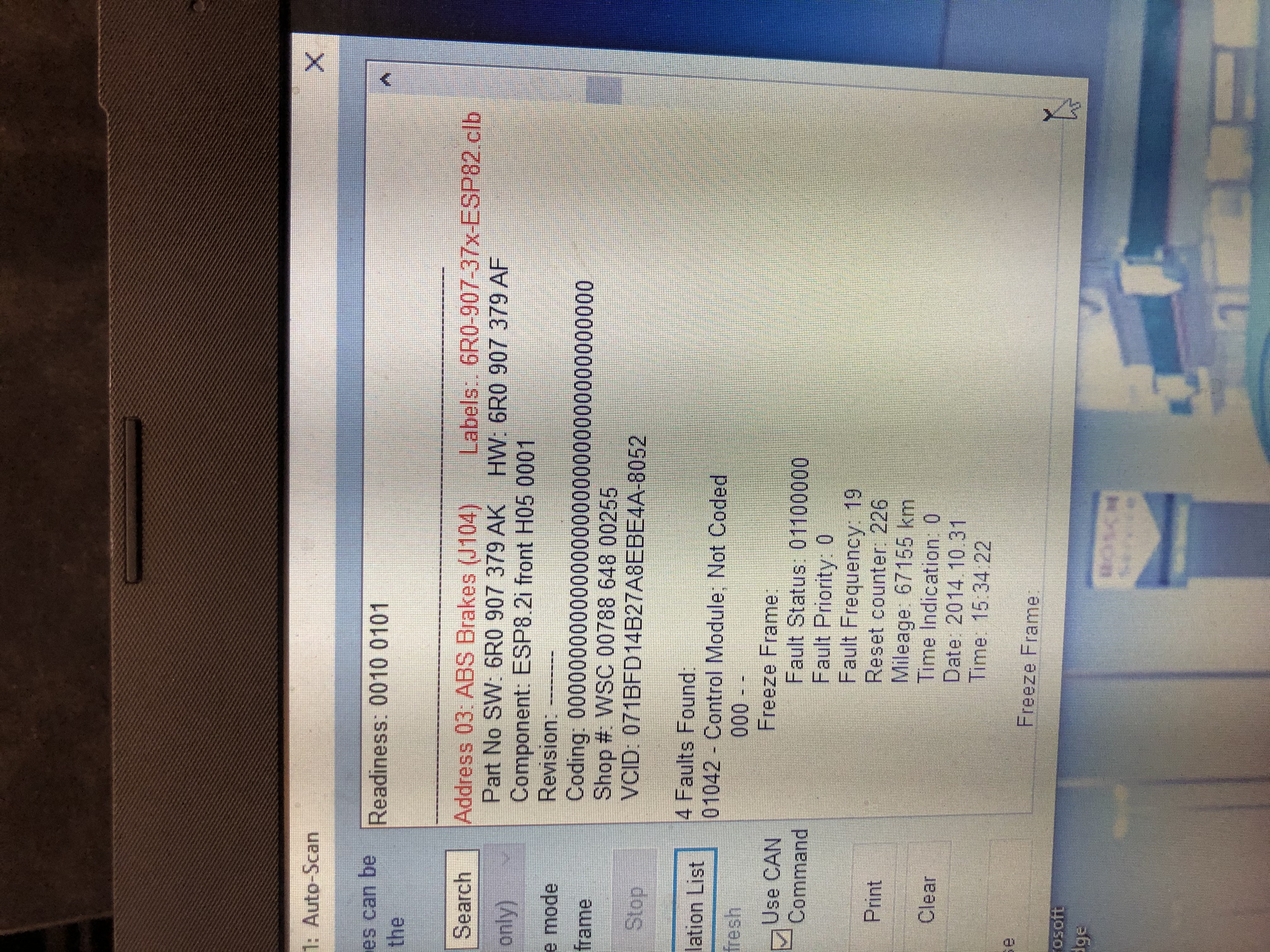

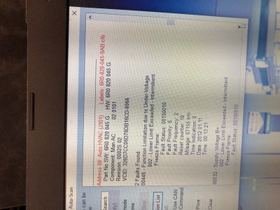

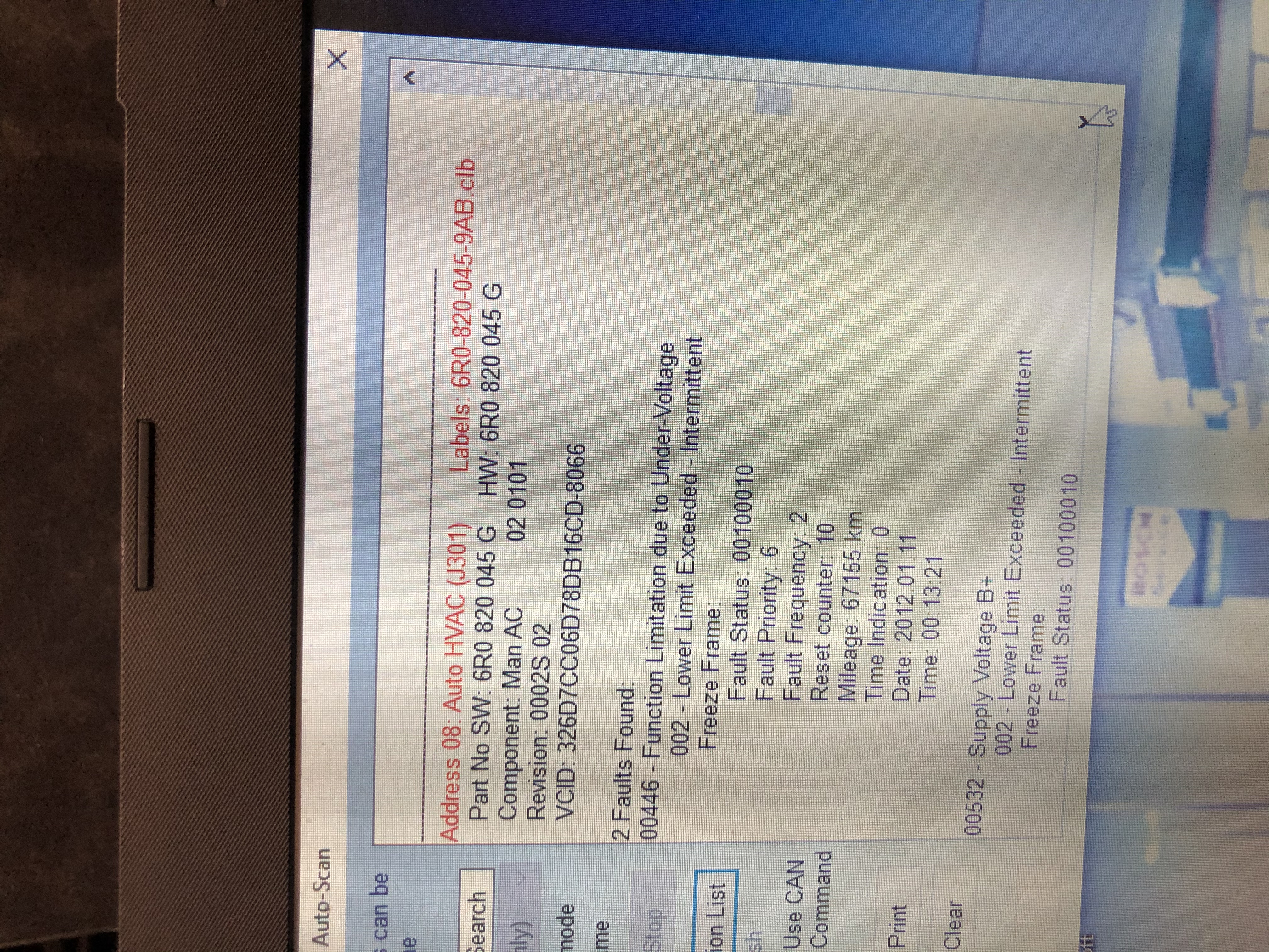

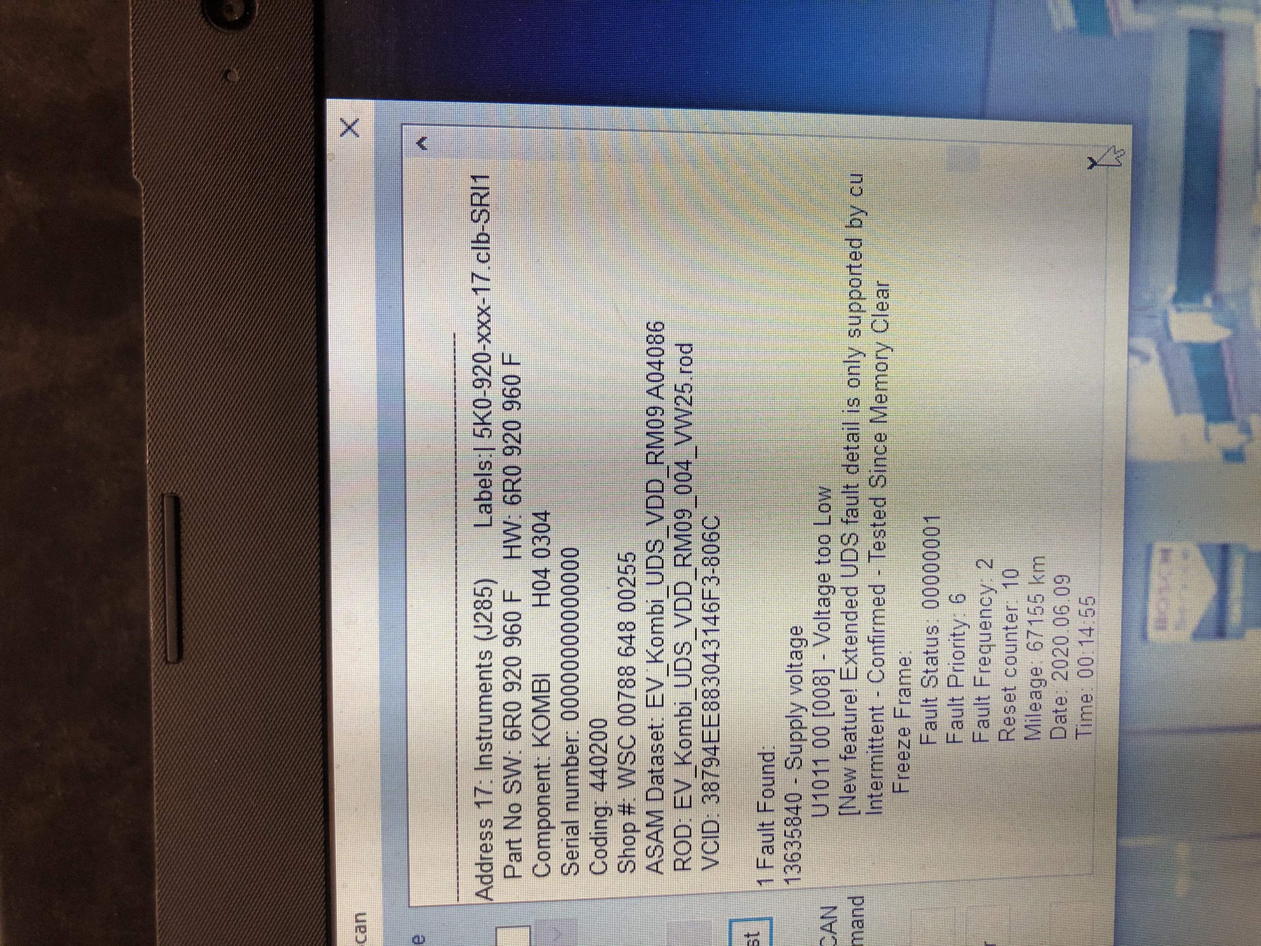

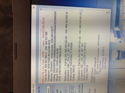

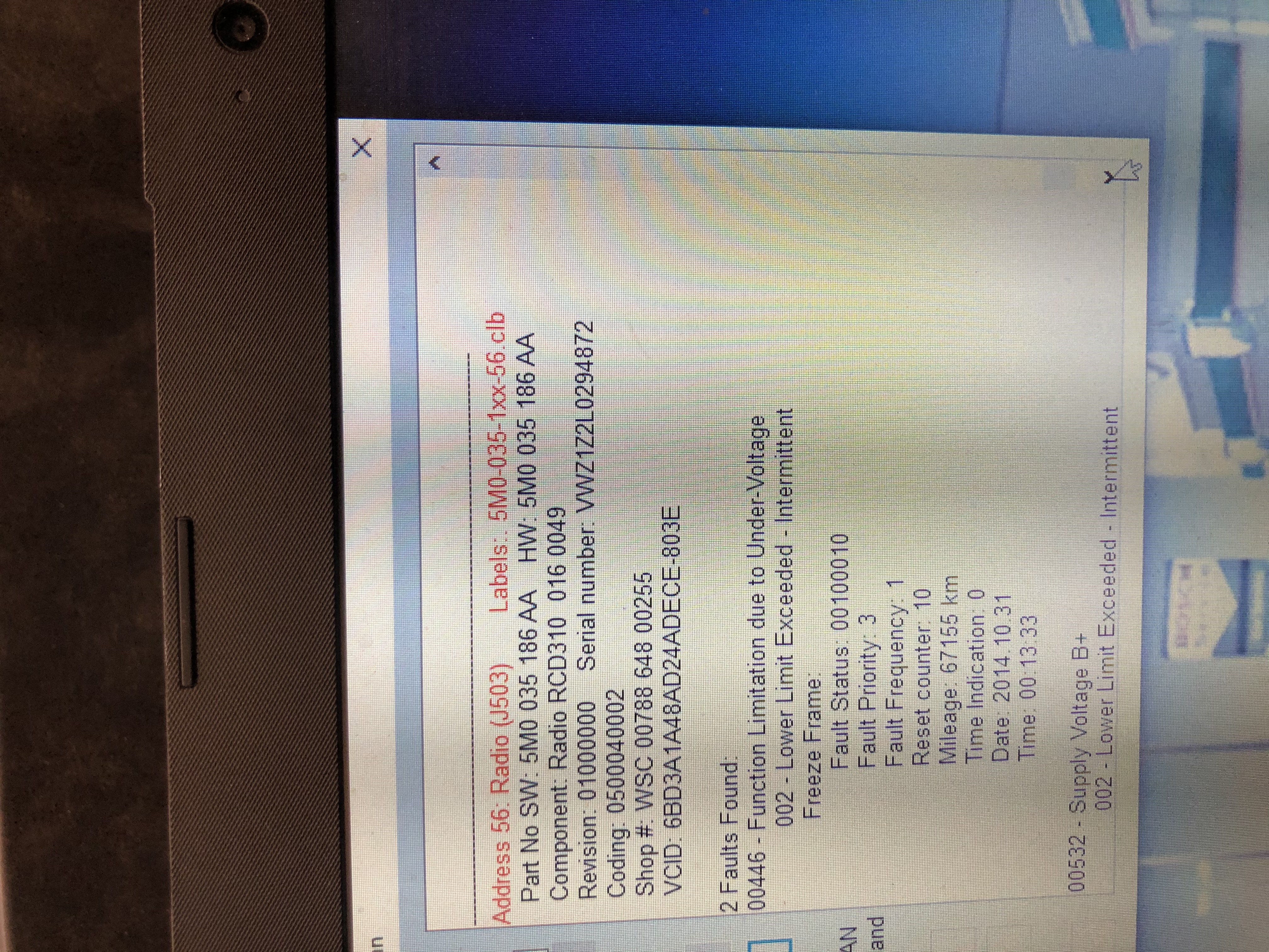

Not really too sure how to do it how others were doing it and I’m on this site on my phone, hope these pictures give you what you need. Thank you in advance
- Posts: 6378
Press save on the window you're seeing.

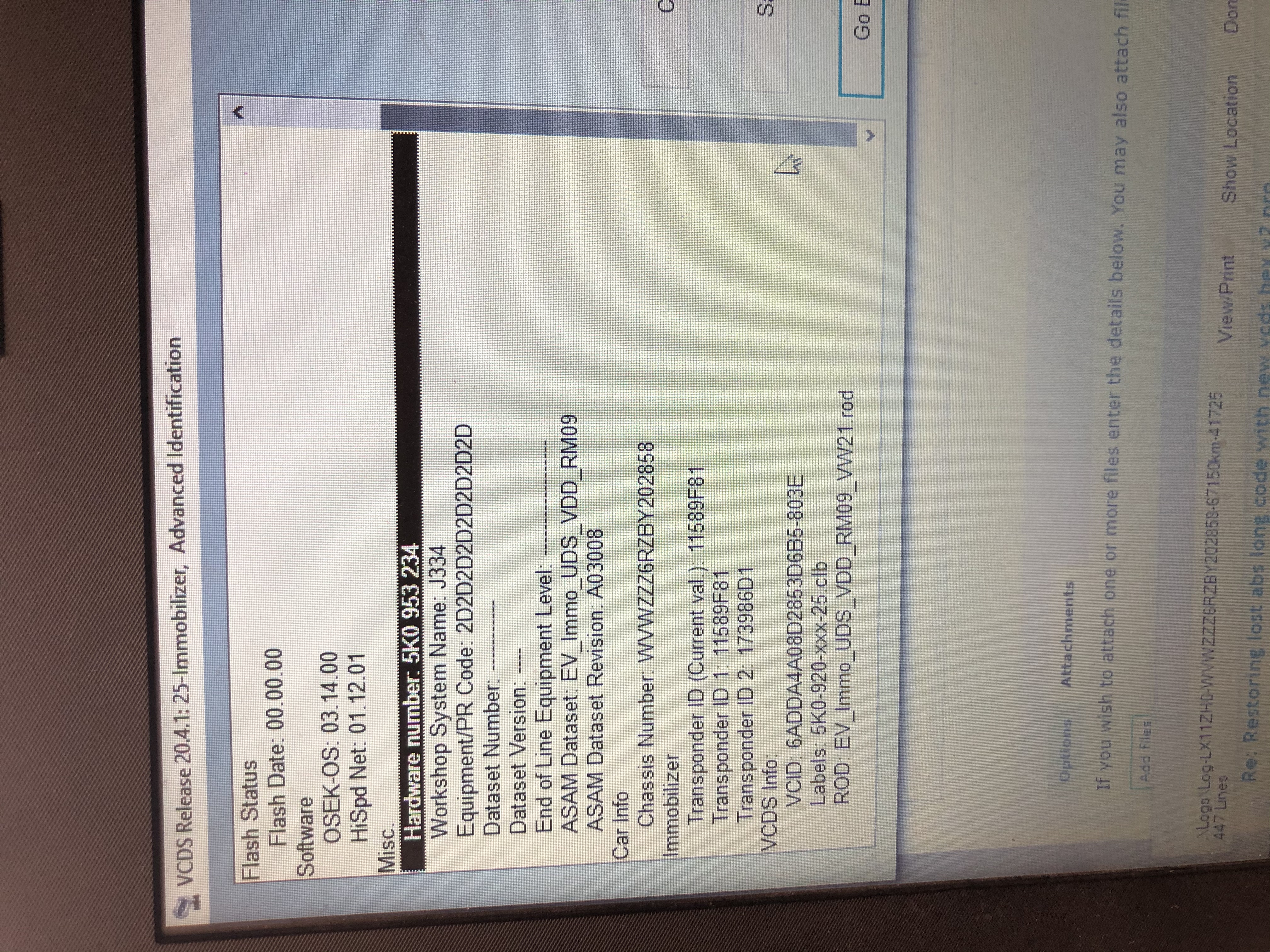

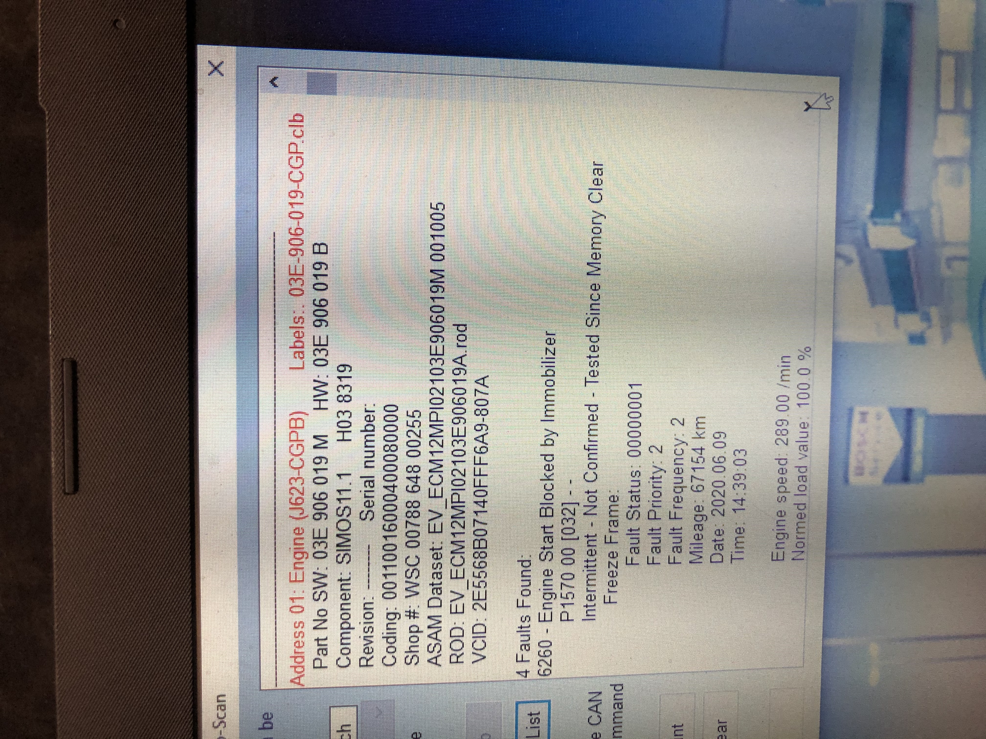

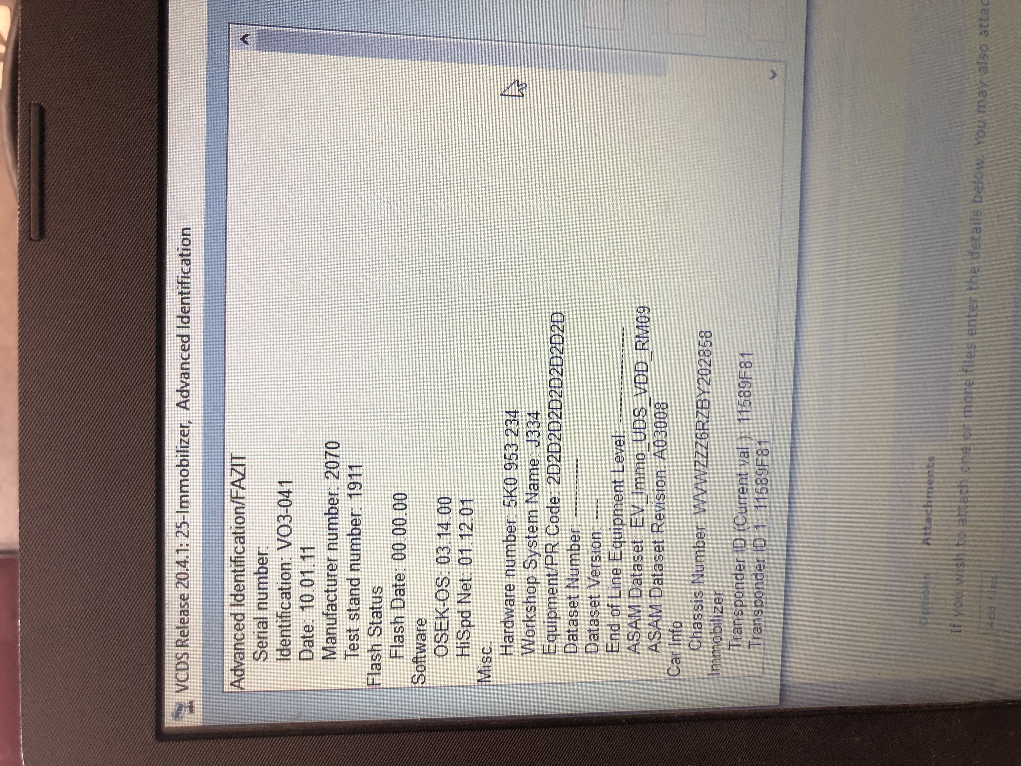

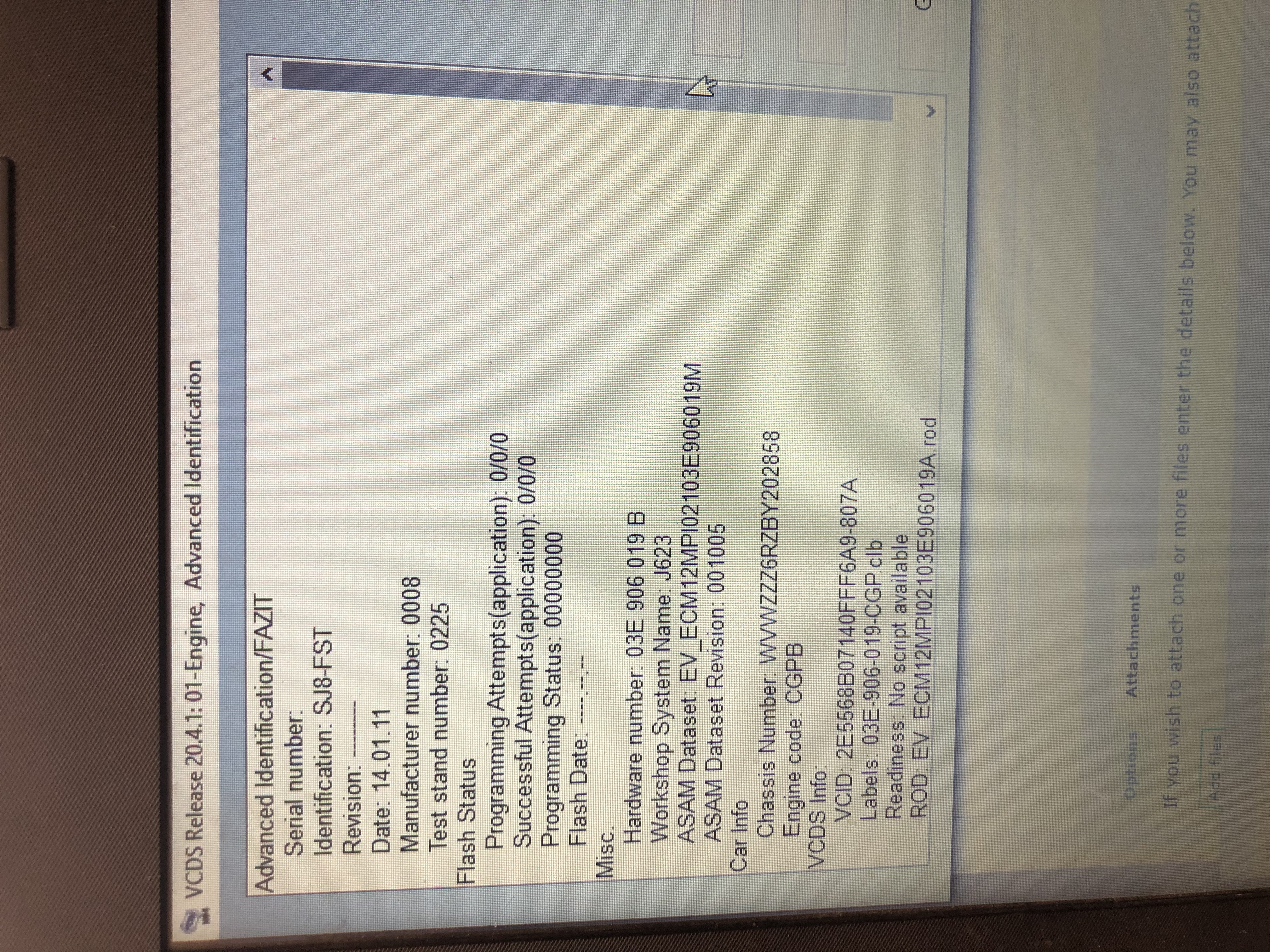

Also please show me the advanced of the immobiliser and the engine please.
It came up with an error every time I tried to send the saved log, on this website when attaching it. So I’ve taken a picture of the advanced ID’s you needed and enclosed the pictures in this message
