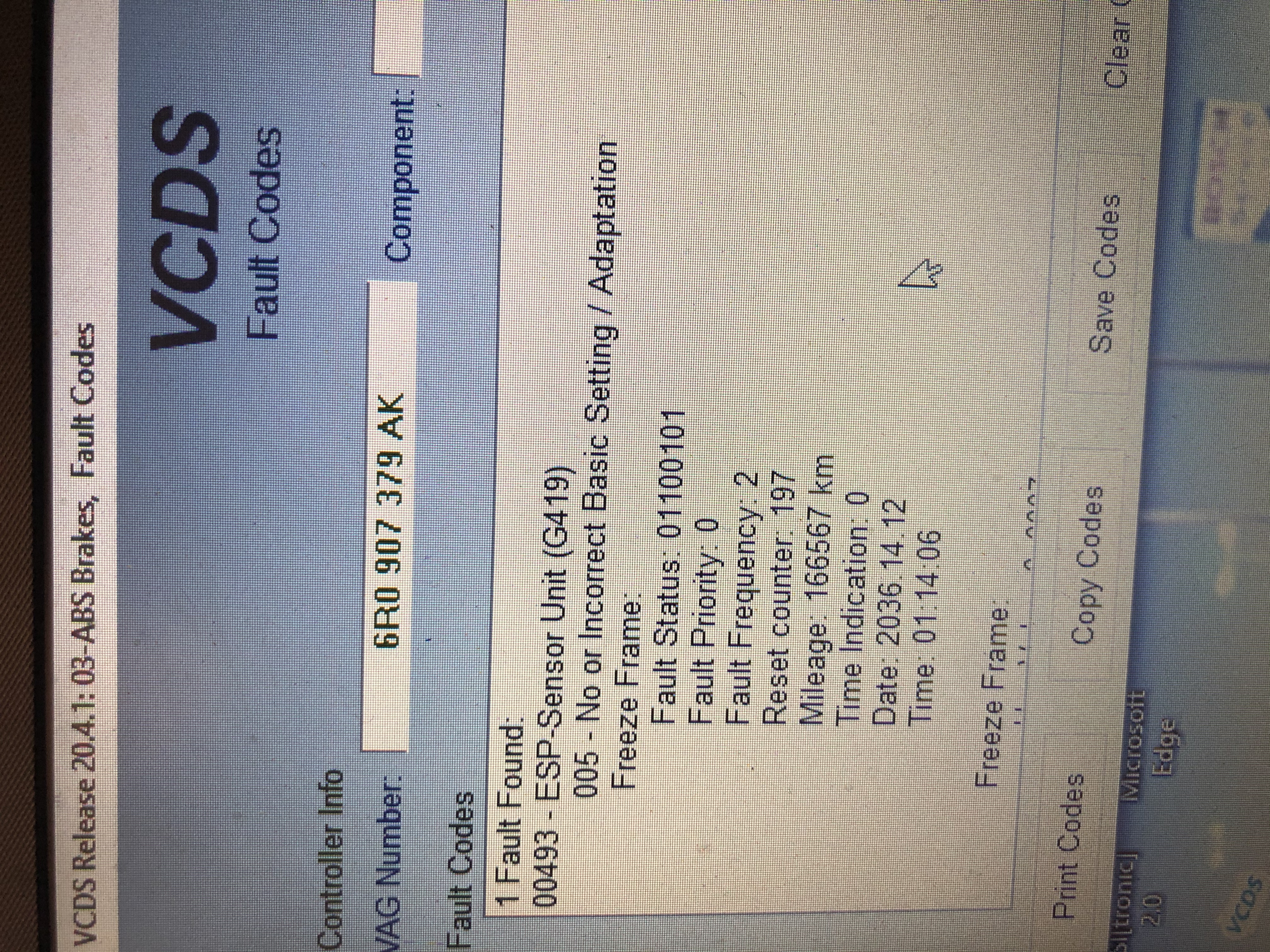

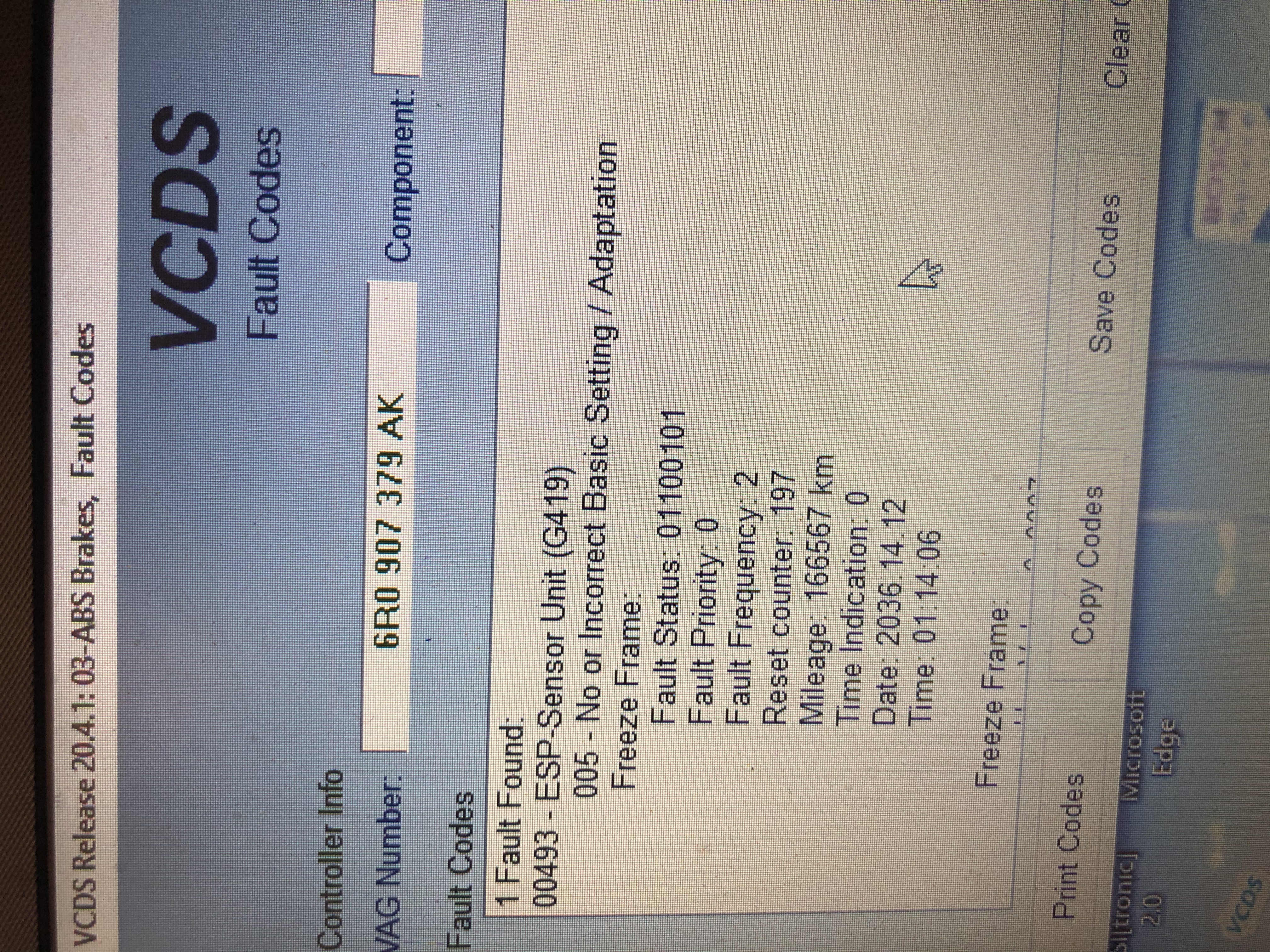

Okay I’ve now got the TPMS light to go out but the TC light is still stuck on, it’s got 1 fault code in the ABS module, I’ve reset the steering angle sensor. Any ideas?
Posts: 6379
Re: Restoring lost abs long code with new vcds hex v2 pro
Go to the abs module, security access, 40168, basic settings, basic setting of ESP unit.

Just realised I forgot to reply! Ever so sorry! It worked a dream and it’s all sorted. Couldn’t thank you enough, would have never got there without your help and guidance. Top man. Thanks again.
