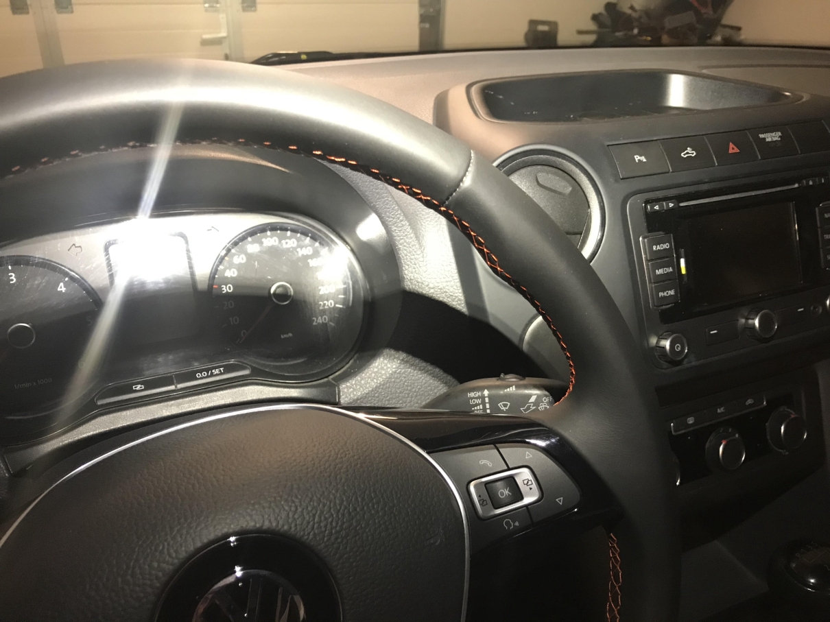

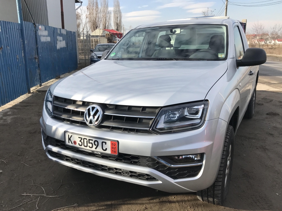

I have changed the front of the car with 2017 facelift. I have yet to change the grille and the Vw badge. The foglights connectors must be changed.
I have also retrofitted front, rear Park distance control (OPS is working with my RNS 315).

Looks very nice your Amarok with the new front bumper. 8)

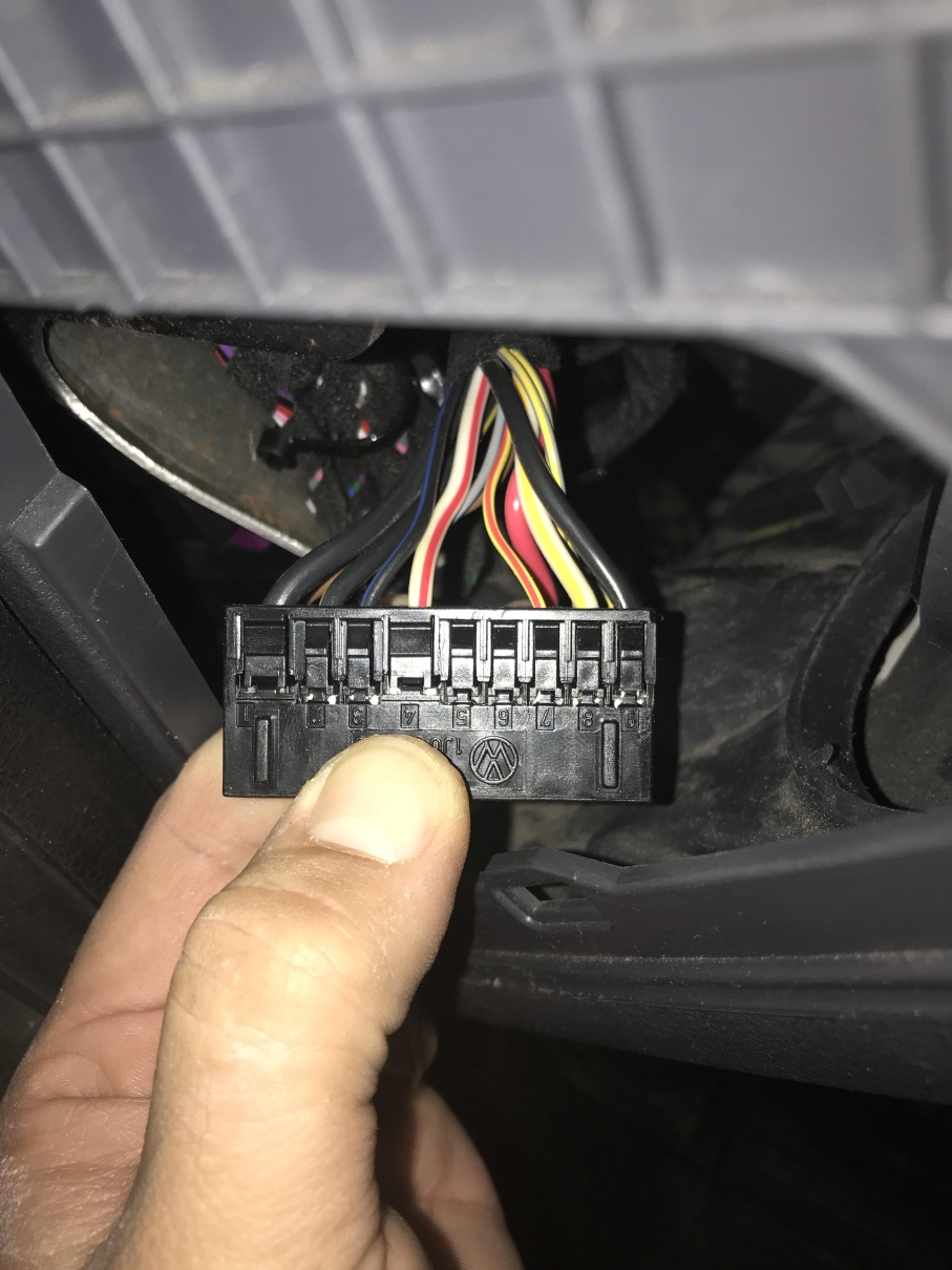

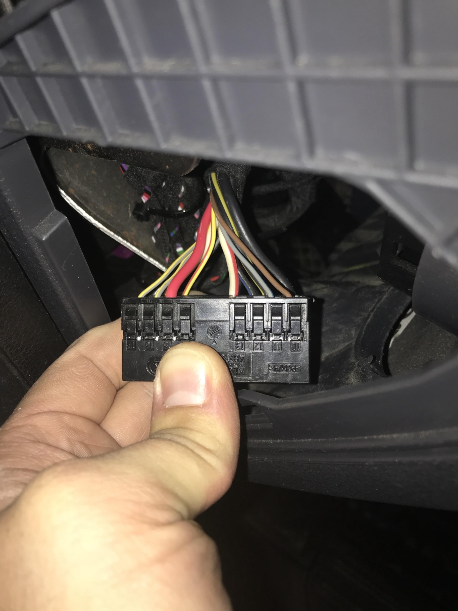

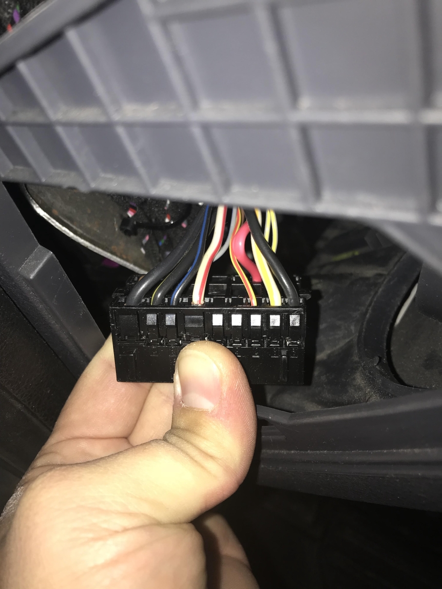

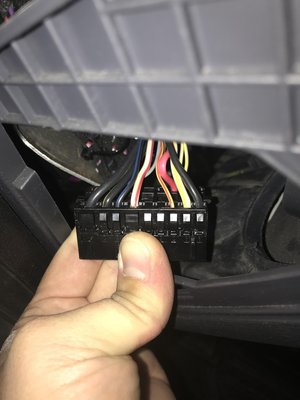

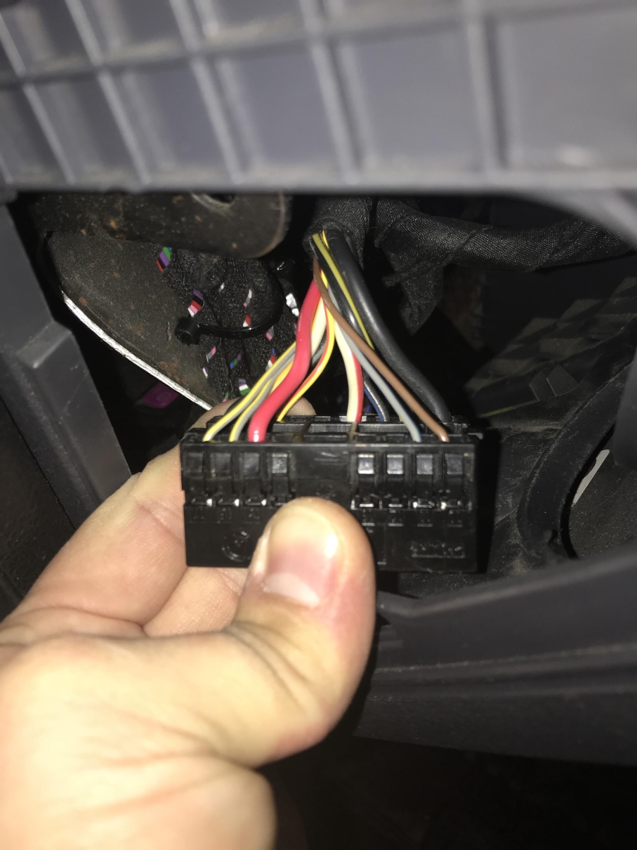

To get rid of doubts, you have to show us two images from the 17-pin light switch connector -both sides- to clearly see the wires that reach it, both by color and thickness.

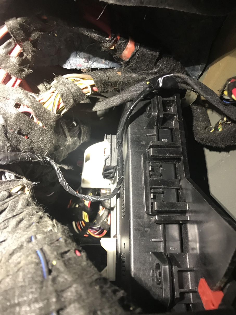

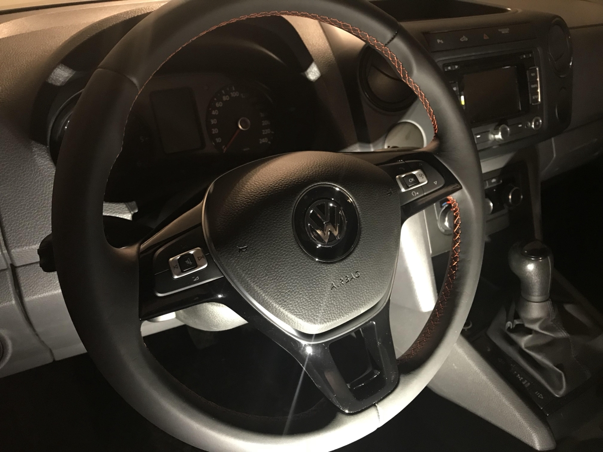

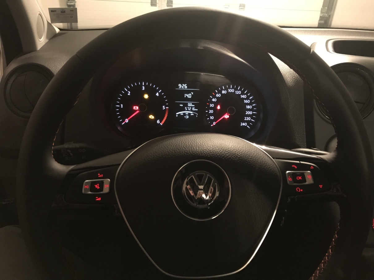

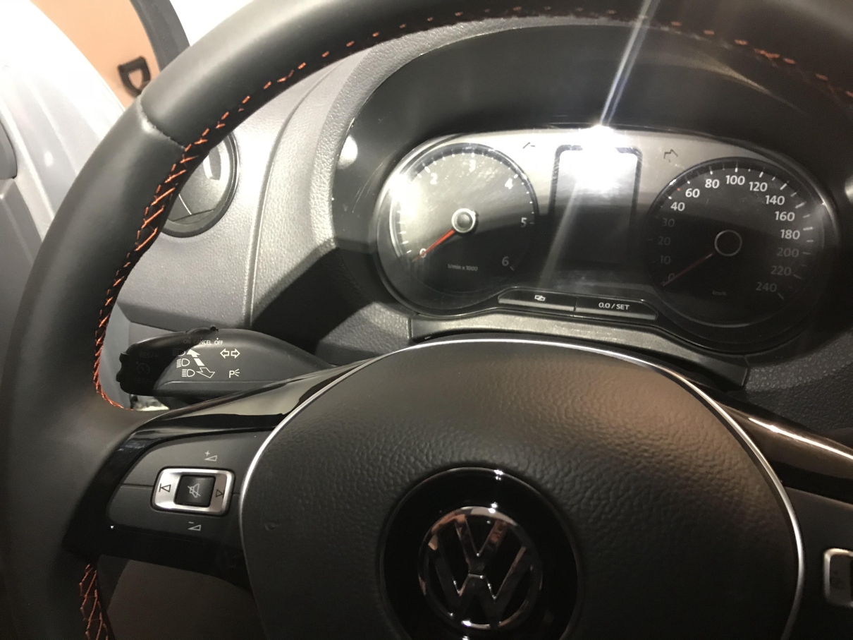

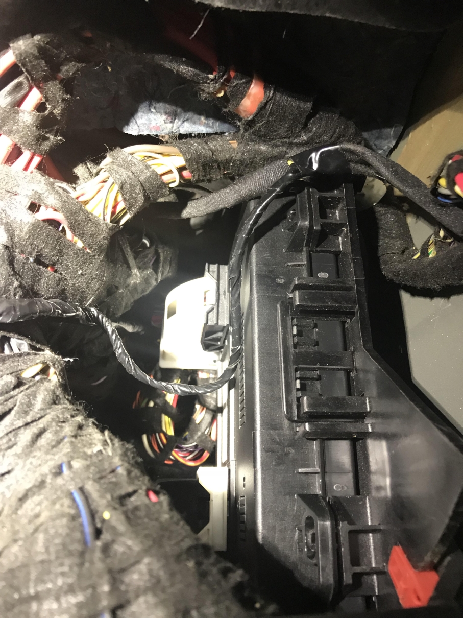

It would also be very interesting if you took two pictures of the places where the BCM and Relays carrier/holder are installed in your/the Amarok (as you have seen for T5). Also from the dashboard (general view) with your MFSW, Light switch, etc.
I have this information in my elsawin, but it is better to see the real images, ...due to same reason as for light switch connector.

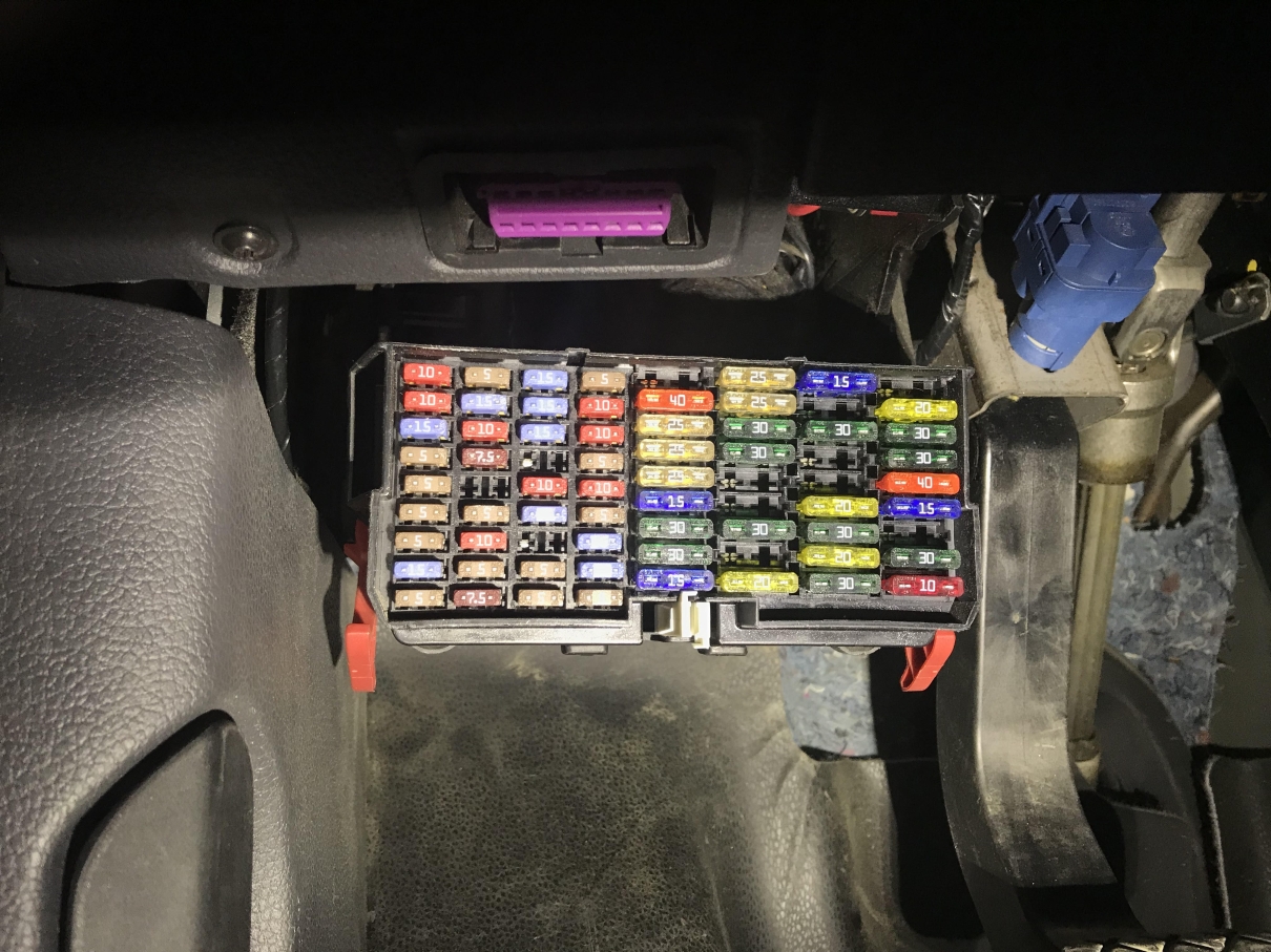

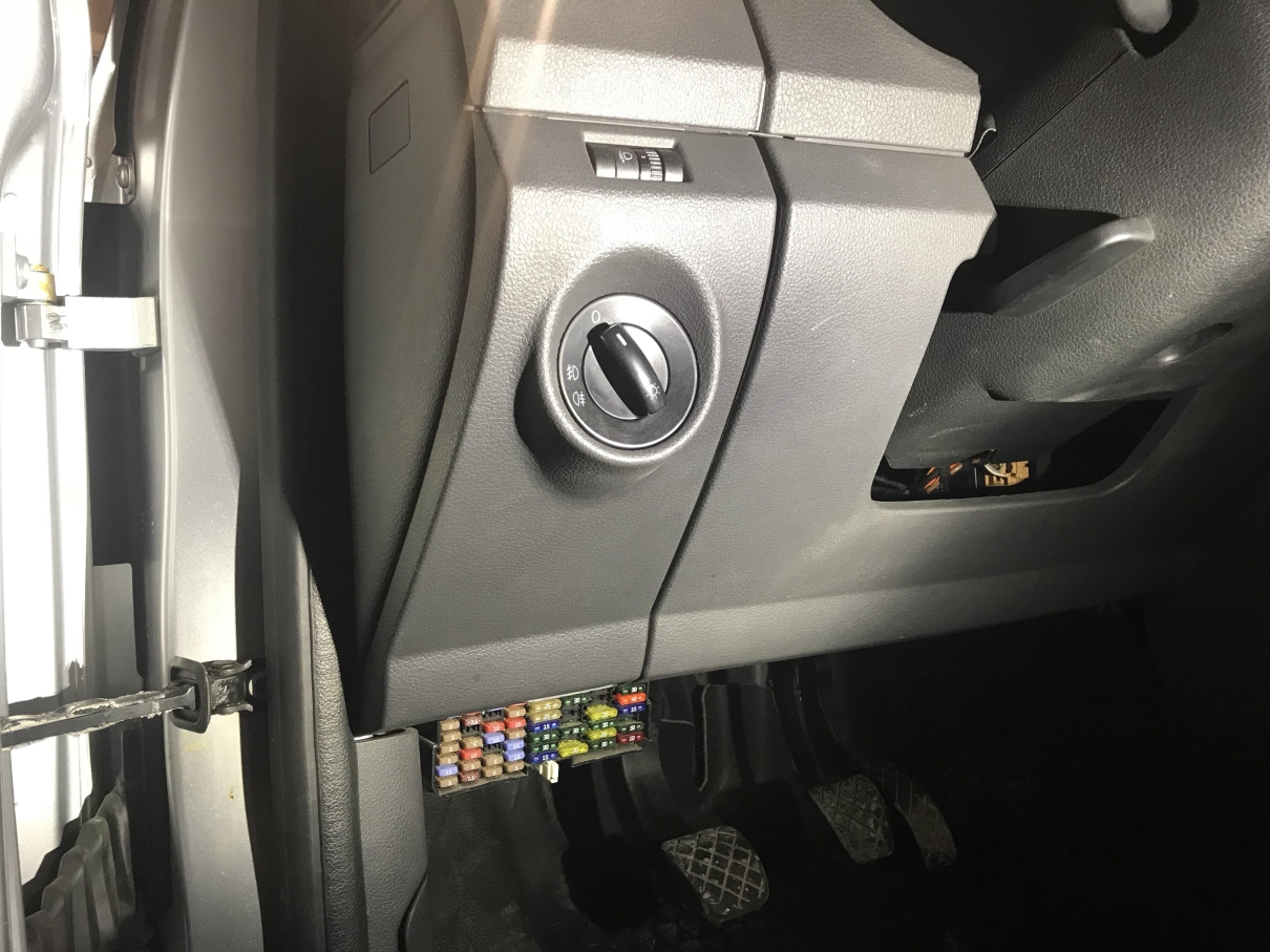

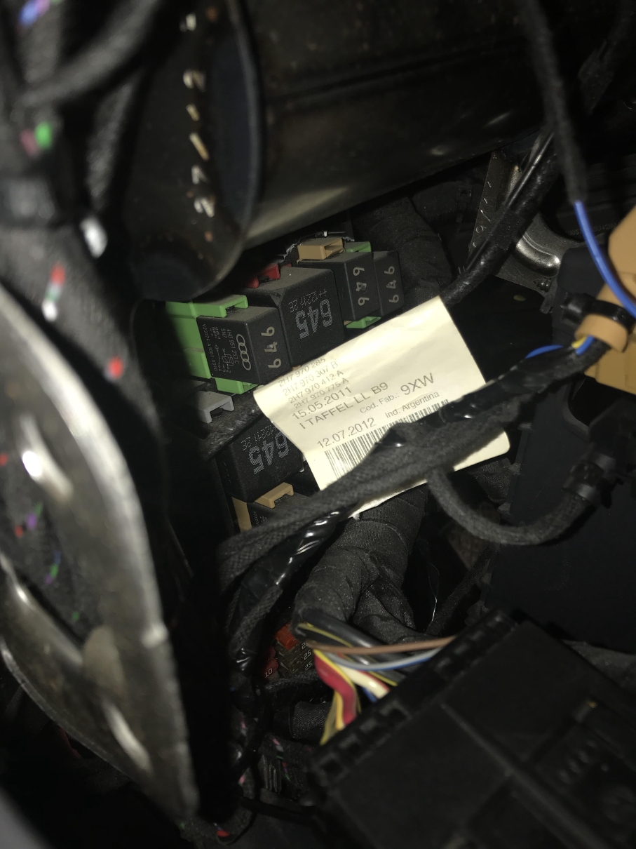

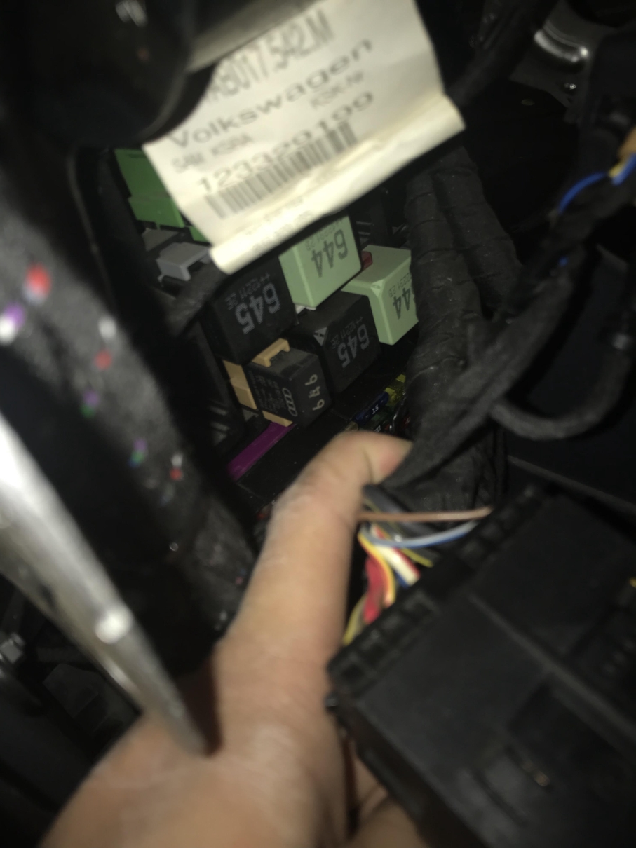

I have taken the photos. The BCM is a little hiden, on the lateral of left side pillar. The part nummer of cruise control/signal lever is 6Q0953513AM9B9

Posts: 8982
Re: Amarok Oem Bixenon retrofit
Thank you very much for all these images.
georgenis wrote: Wed Feb 07, 2018 9:41 am I have the electrical wiring of my car. It is from Vw service special for my car.
https://drive.google.com/open?id=1LD1nu ... GEDACyyU7P
To summarize and as I mentioned, those diagrams are not correct for your Amarok.
- T17 connector reveals that your Amarok is prior to January 2013.
- Your fuse box is 72 positions/fuses -June 2012 to January 2013-. From January 2013 the fuse box is 68 positions/fuses.
