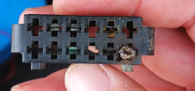

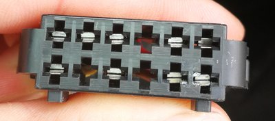

I will look for the part number the new one has the plug aswell but on the old connector there are 6 or 7 wires in total and the new one there is a few more maybe 10

- Old connector
old one
- New one
new one

Ok, the original is a mk3 golf cabriolet one. Youll want to get another of those as this 6n2 one wont work in your car, as this pump cannot be modified to work.
Ill check the pin differences later on
