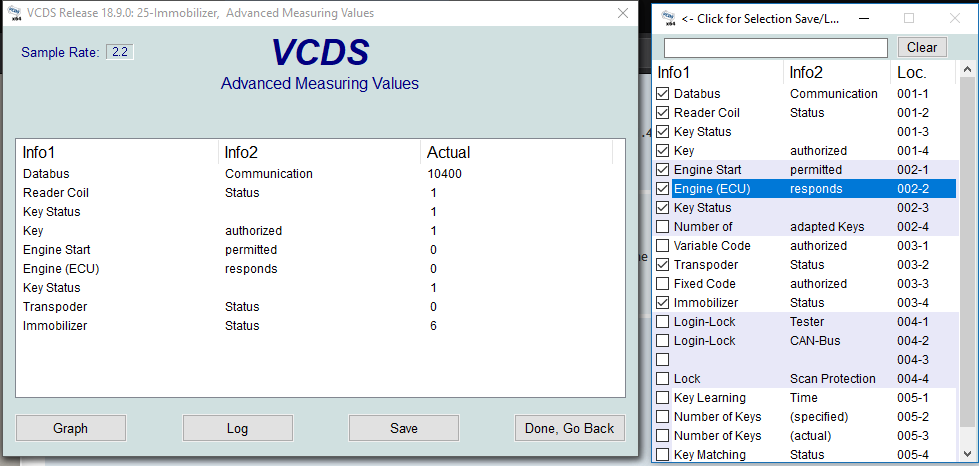

Took my car to get new tyres and when I tried to start the key it would not. After 6 attempts it did. Got back and scanned with VCDS and saw this

When I turn the key to the ignition position I can hear the pump is not priming, but sometimes it does (seems random). I've tried a spare key and got the same result.
Any suggestions?
