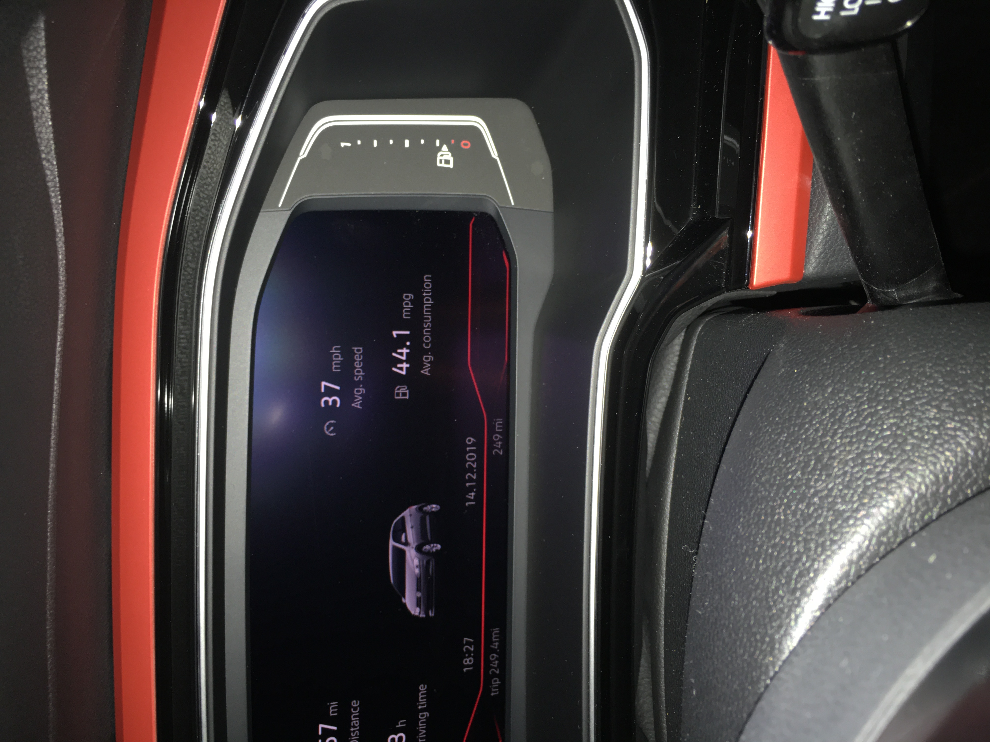

wish you luck Actualy my work commute is responsible for that big peek in consumption (that 9,xL/100km) that was week or two where I was driving only to work (8km). I have around 14 shifts per month so around 3000km per year ... rest was mostly driving for fun so no consumption in mind. That is why I was expecting higher consumption and was nicely suprisedmonkeyhanger wrote: ↑Sat Dec 21, 2019 6:30 pmThat's 34.7mpg in UK measurements.
My 2018 DSG variant has averaged 33mpg over 11500 miles (18500km) and it is markedly more powerful and responsive than my wife's 2019 model with a GPF/OPF.
Mpg completely depends on your driving style and congestion.
My commute is 13 miles long, traffic is awful for the middle 3 Mike's. On a really bad day, it can be as low as 28mpg. On a pretty empty commute (Like yesterday - so many people off work yesterday), I had 38mpg.
Recently I have taken a different route home, it's 15 miles (2 miles longer), and I'm consistently getting 36-38mpg when the other way would be 32mpg.
I had a job Interview Wednesday afternoon, it was 32 miles home (so doubling my commute) on busy but flowing dual carriageway that lets me average 60mph/97kmph - I got 47mpg, despite a 10mph crawl for 3 miles (they're putting a massive flyover in to go straight over the roundabout that serves the Sunderland Nissan plant).
