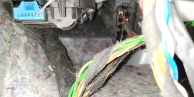

Is there CAN wires behind the "glove box" for passenger airbag?
How about this ( blue plug top image)?
Behind glove box plug
Re: From where take the CAN signal (+/-) [Polo 6c 2015]
Posted: Fri Jan 25, 2019 1:11 pm
by iichel
No.
